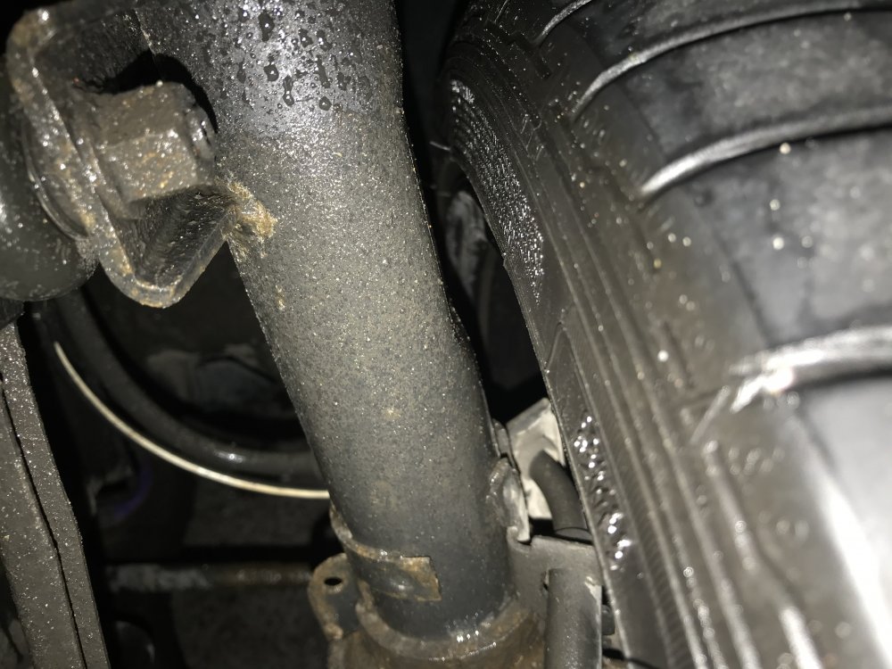

Ill take a look at the clearance on mine tomorrow as it is currently stock, to see how far back in it could go.
Ideally, to stay flush/under the arch, don't want to be pushing out by much more than 15mm. Any further out than that can you risk damaging the tyres and arch when doing sharp corners or going over speed bumps or bad roads.

17x7J OE alloys with ET46 offset. Stock suspension.
Thanks! I have a hard time judging the distance but that seems reaaally close. I have no idea how steslatt was able to mount 8j ET42s, that must be more than 9mm then.

I think its around 13-14mm, I was able to get my pinky finger past the gap but nothing more without it being a squeeze, haven't got anything to properly measure it though. Dunlop SP Sport Maxx tyres. Other tyres might not stick out quite so much (avons being one that doesn't stick out much).
