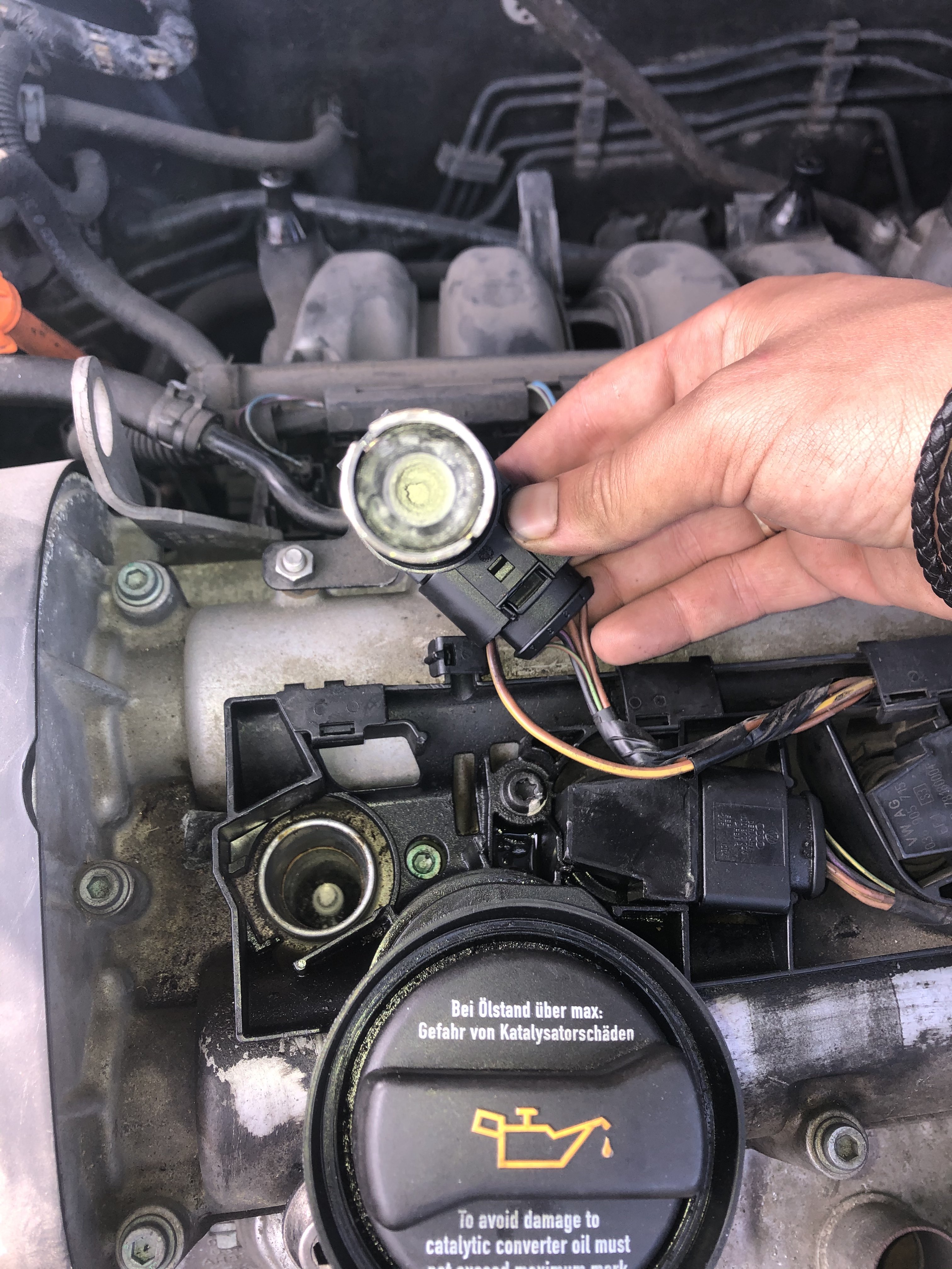

I have just put new air filter in and was about to do spark plugs when i noticed was full of white powder in no.1 and lead was not on properly since i first start driving it no. 2 seems to be oil on top havent checked since cant remove spark plug 1 to change but car is working perfectly fine to my knowledge. Thank you
Plug has probably been loose for some time, allowing combustion gases to escape up the thread clearance clogging it up with aluminium oxide as those gases corrode the aluminium and have now jammed the plug in.  Drip some oil or penetrating fluid in there, wait a few hours, then gently try alternately tightening and loosening the plug just a little. Then add a few more drops of oil and keep working it back and forth a little more.  Patience and a gentle touch should eventually allow the plug out without damaging the thread in the head.

Photos of what you're seeing are always helpful to let us know what we're dealing with. :)
There’s rubber and oil and it’s a big mess I don’t even see a spark plug to be honest

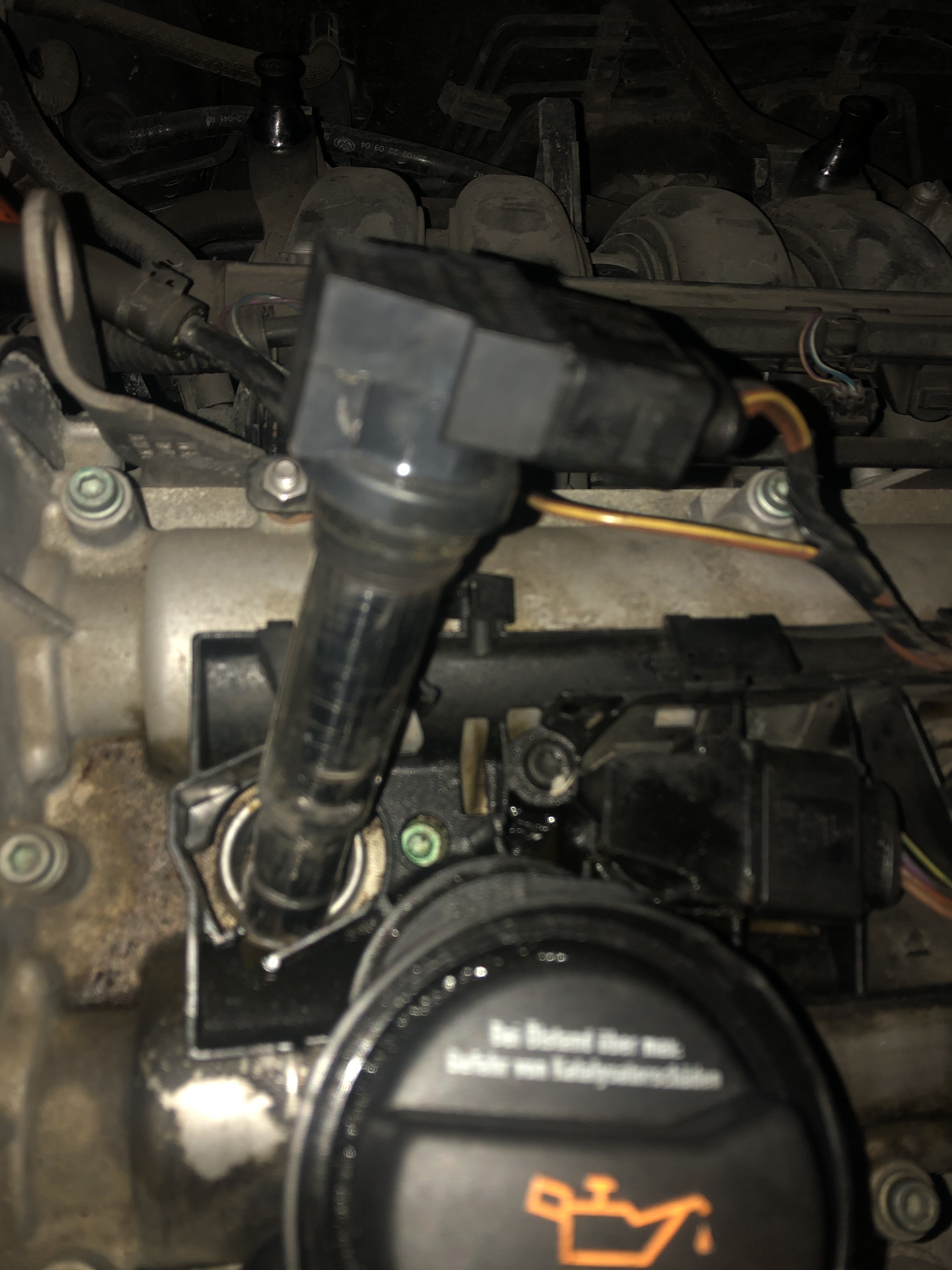

If you look up that coil pack from the tip, compared to one of the others are there bits pulled or broken off, and stuck to the spark plug?

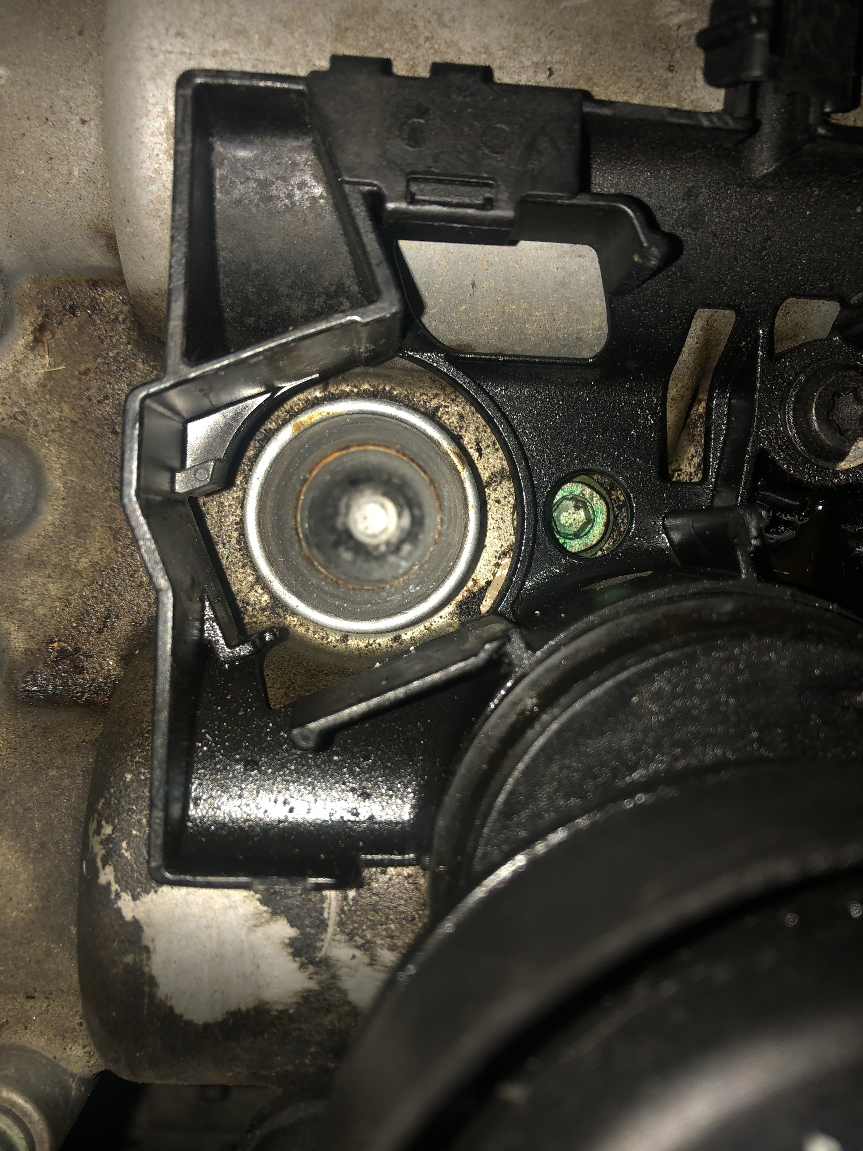

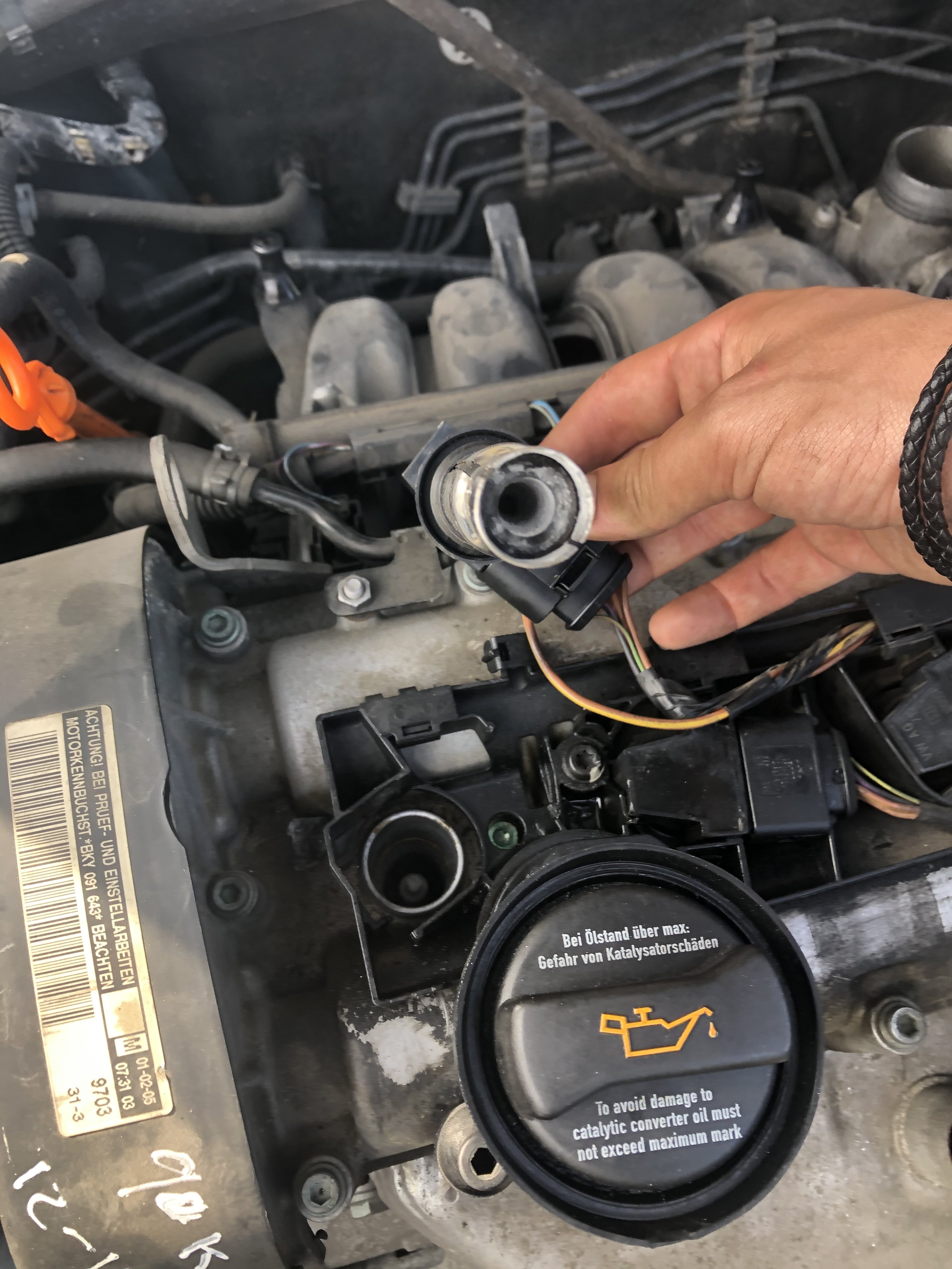

It looks like the alloy cap on the plug has corroded, possibly due to the coilpack not being correctly fitted and spark eroding the alloy leading to the white oxide powder forming.
Try blowing the plug clean with a high pressure air jet to get all that crap out of there then add some penetrating oil to soak the thread before trying to remove the plug as Wino suggests.
I imagine the coil pack contact may also show signs of erosion if you look into that end.
That looks horrible.

gave it a spray of compressed air. I did not have much. Also a drop or 3 in there it seems that there may be bits of rubber on top of where spark plug goes?

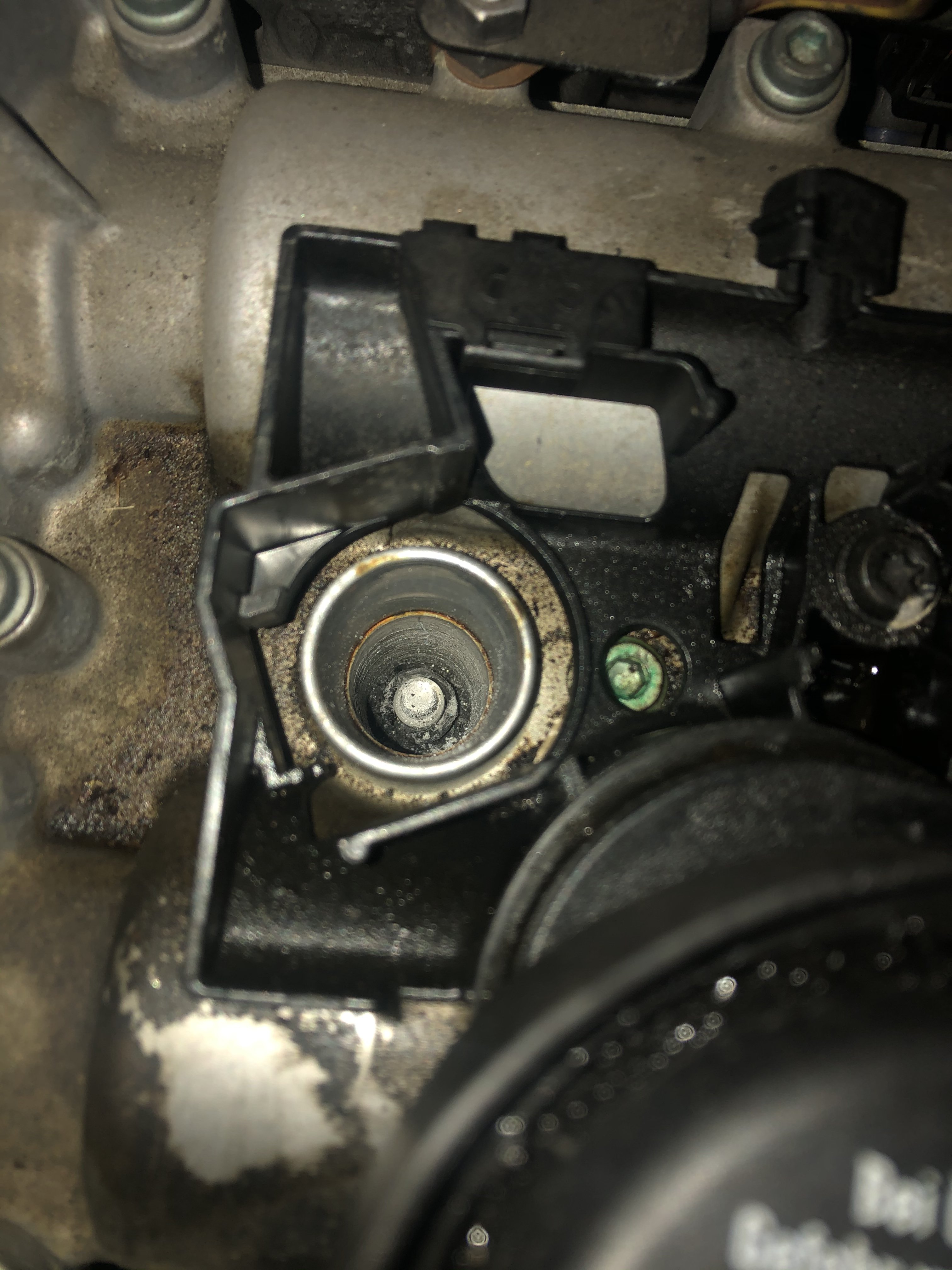

I think you may have to improvise some kind of hook-ended tool to remove debris from no.1, to hopefully reveal the spark plug.
You will have a bit more room for moving leads about if you unclip the latches on the plastic cable management frame.
It looks like you'll need at one new coilpack so go ahead and remove all the others in case there are more problems, as Wino suggests you need some sort of pick tool to loosen the debris around that spark plug and maybe vacuum it out as you go until you expose the hex on the sparkplug and you can get a socket onto it to remove it, get it as clean as possible so debris doesn't fall into the cylinder when you finally take it out.

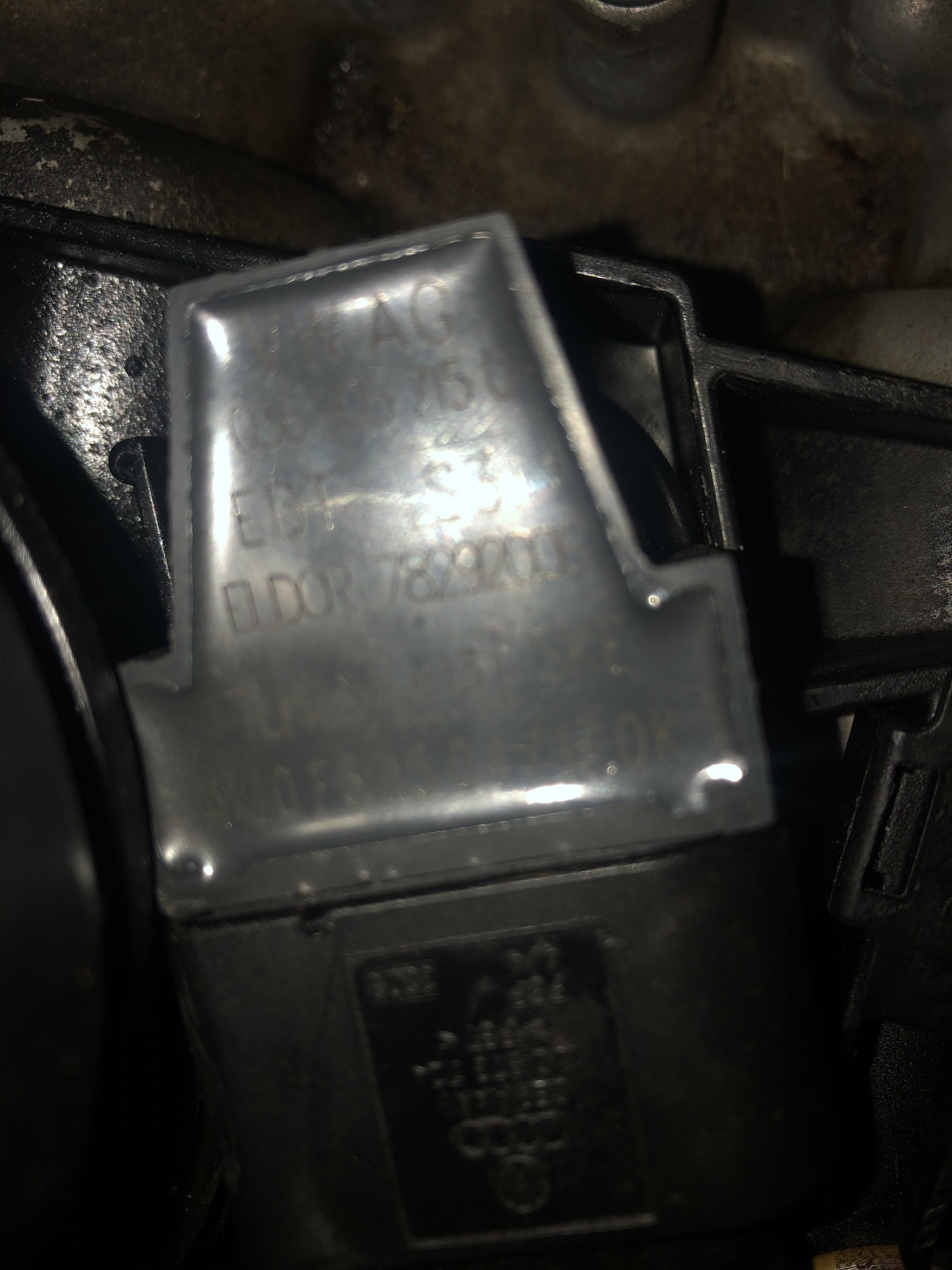

Going back to that cylinder 1 and its COP, now correct me if I've got the wrong end of the stick here, but:- COP 1 would not fit down fully onto that plug, but I think the cleaned up end of COP 1 looks okay, so I think that a previous owner/servicer had a spot of trouble with the original coil in cylinder 1, left a bit of the rubber on that plug, then either swopped coils or fitted another coil - and that bit of rubber stopped it getting down as far as it should have - no?
Either way that extra bit of rubber needs to be removed from there and then examine the ends of all the coils/COPs just in case one of them is missing a bit of rubber, I like Eldor coils for these engines, seems to be the more reliable factory fitted one.

Thanks folks, managed to get No. 1 out. Had no compressor so i used 2 straws together and blew as best i could used a pick aswell. Changed spark plug but misfired.
