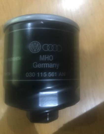

Btw I’ve had the tools before just not now felt the oil filter socket to be the best song with the strap and last the chain
  • Sponsor
Genuine and good copy parts should have a 30mm hex on the end of the oil filter, so a 30mm socket or spanner should be the tool of choice.
