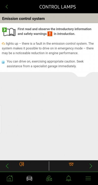

Is this is a serious problem? Should i take it only to the Skoda authorised dealer or can it be sorted with Halfords service centre / kwik fit. I have attached a screenshot of the manual.

I guess it's a fuel problem.. you should see the attachment and the manual
@DHarry

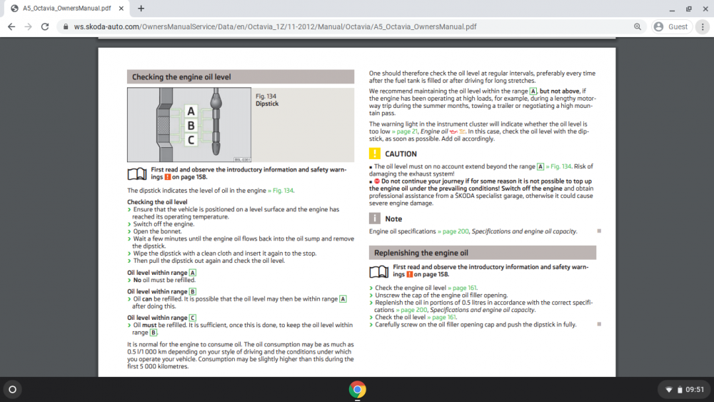

So how much oil did your car require to have the oil level on the dipstick back up to where it should be when the oil is checked 'At normal operating temperature' parked on the flat after a few minutes.  (That is not cold or warm oil being checked, but you can do that before starting the car if you want.)

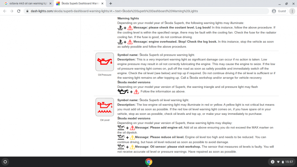

Edited by e-Roottoot
@e-Roottoot

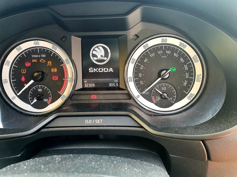

Guess its a old model you are referring to. From the web address i can guess its a manual for 2011-12.
I have attached the cluster of lights on the dash of 2017-18(my model)
@DHarry
What you have shown in the picture is what is done on the 'Check' on the ignition going on,
but the Yellow & Red oil cans do not show then.
There are still ones that light when they are triggered. And there is a Low Oil & Low Oil Pressure Warning message.
Is there nothing on them in the Owners Manual for your car as in this Superb's Manual?
The Exhaust Emissions Light (Engine Light) and the EPC light (Electrical Power Control light.)  really is different from a 'Low Oil' or Low Oil Pressure light.

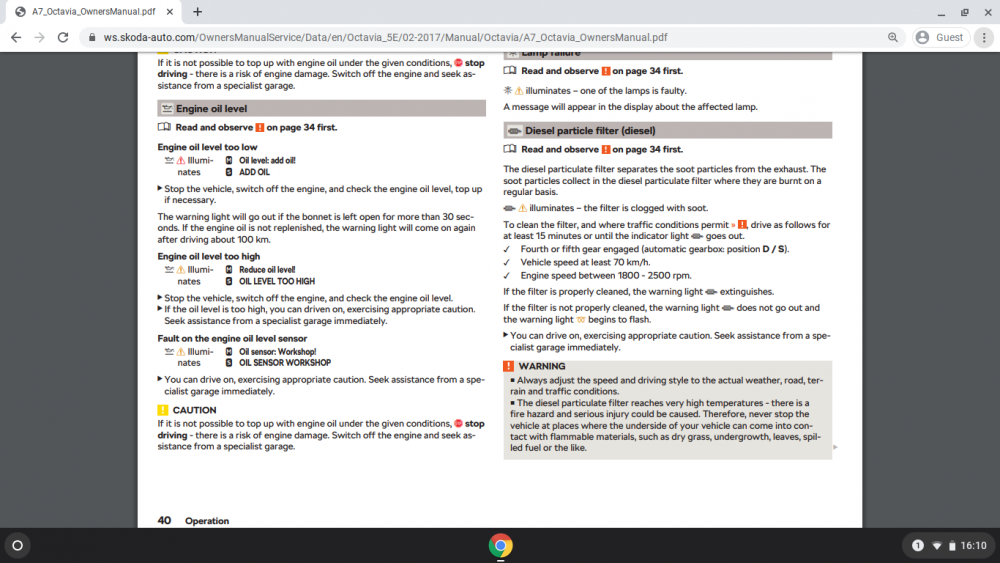

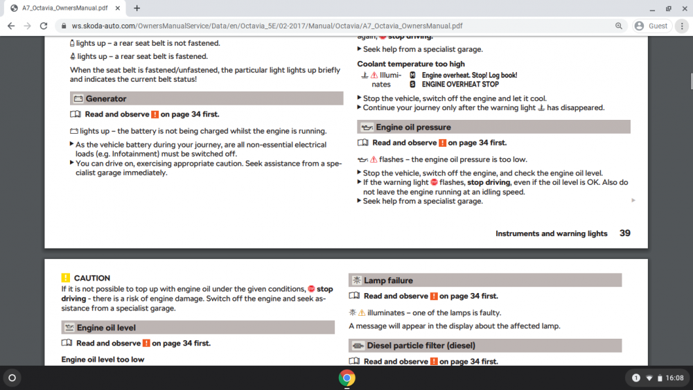

A 2017 Octavia Owners Manual.
