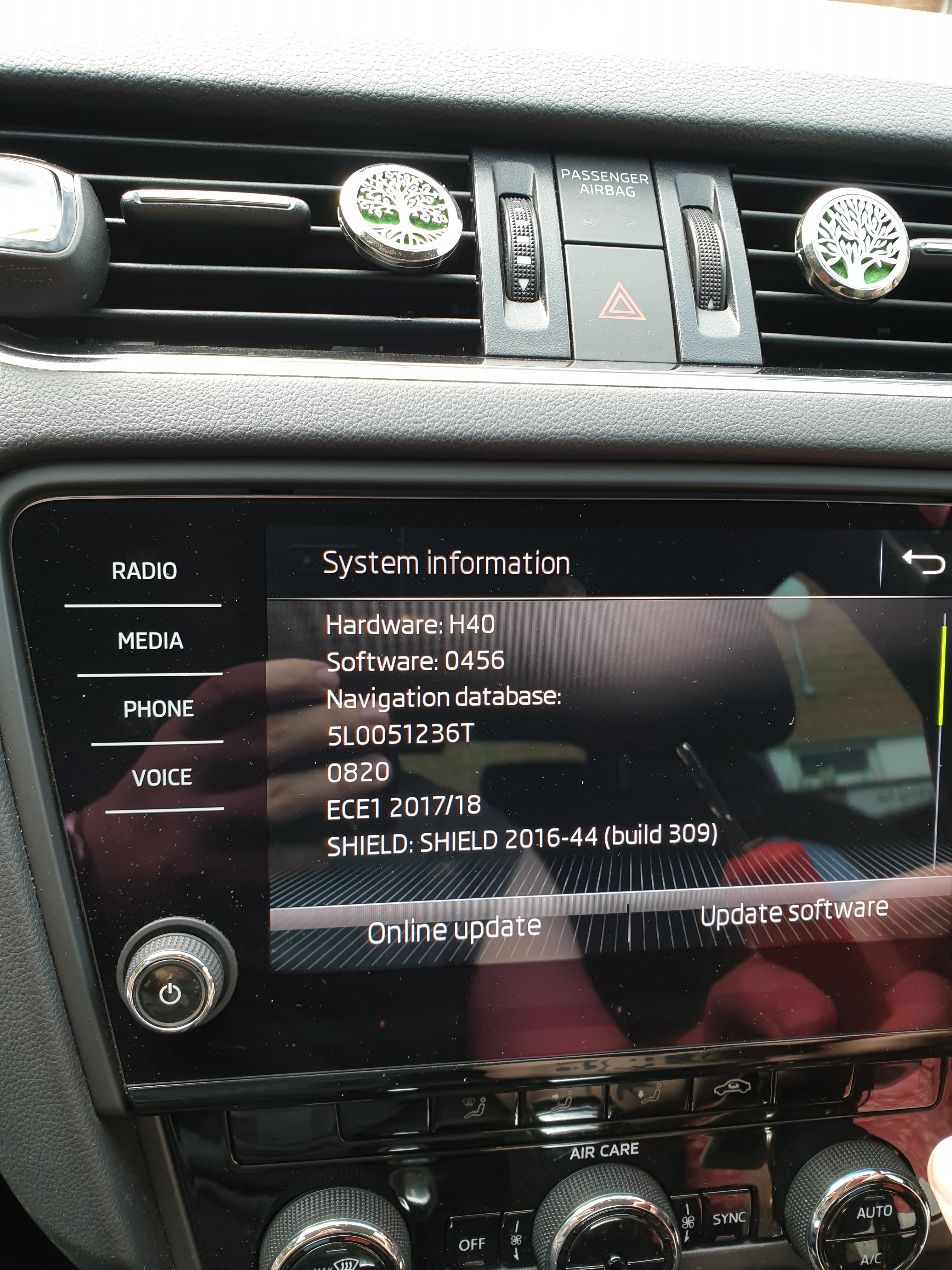

witaj
Is this the info you need? If it isn't how do I get it?
