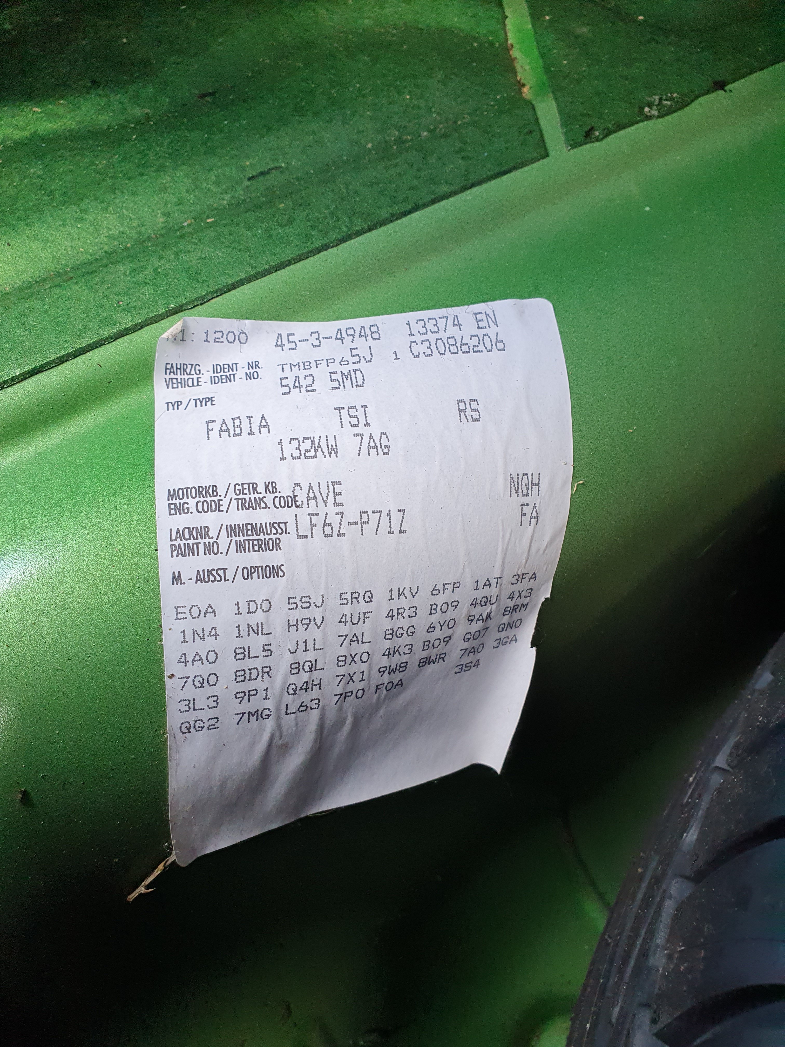

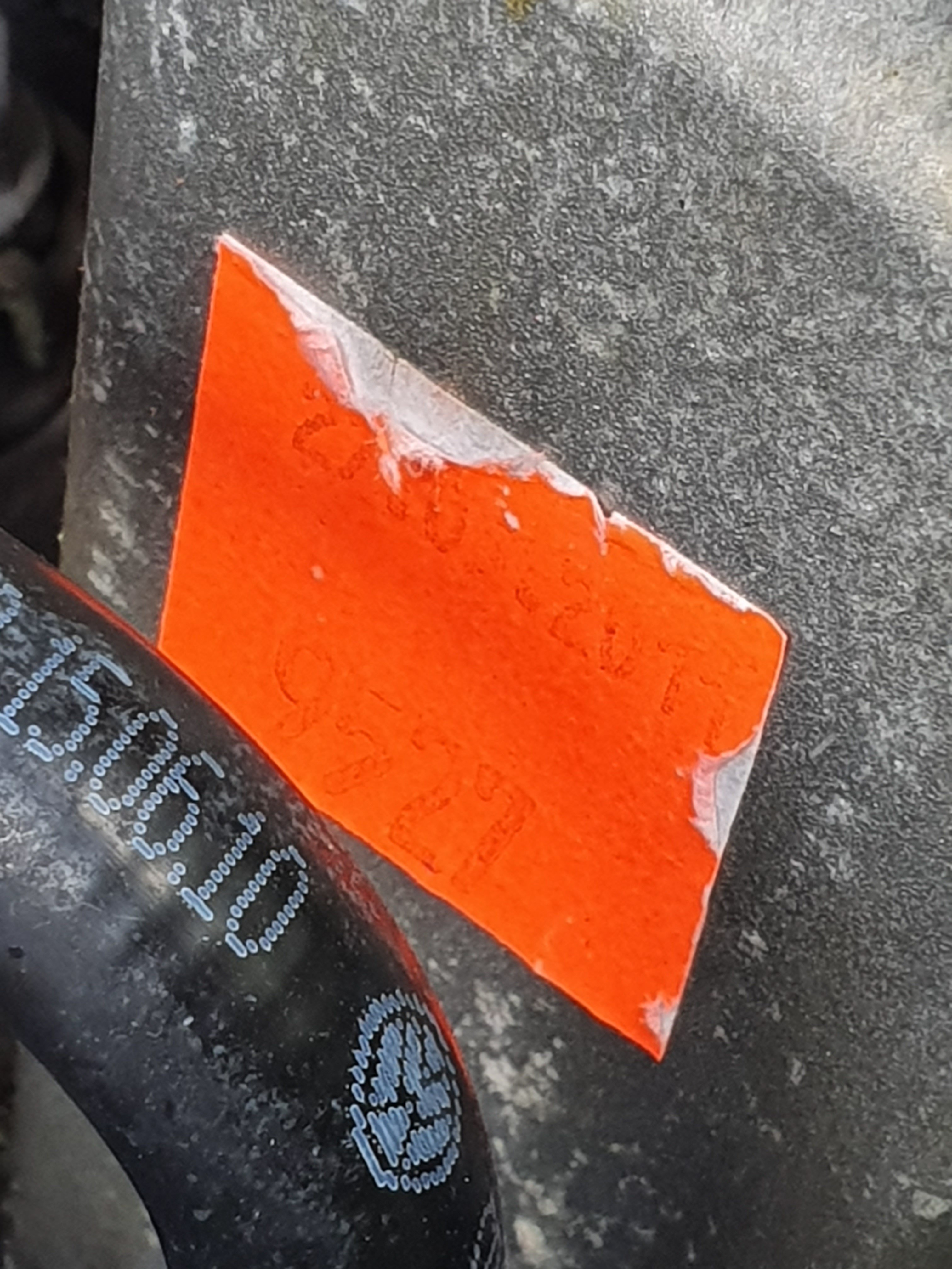

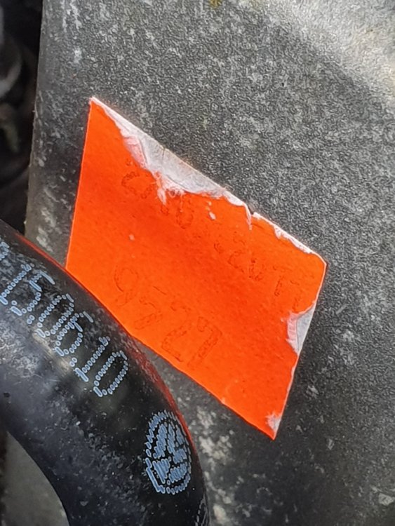

I've got the orange sticker  on engine Feb 2011 the ECU says cave on it yet the 34f7 wasn't done until sept 2014 not sure if that timescale is right was it down to the owner at the time to demand a replacement engine or was Skoda more than happy to inform you

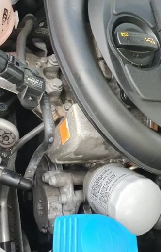

    Oil is still above the hatched area, is still a golden colour, albeit, not as clean as it was obviously.   I filled the coolant at the same time too, that is also still at the max level.

'34F7' did not start in the UK until March 2014.
Late 2012 cars never had that.
Then in 2017 '34H5' started on cars 2013-2015.    It was not only vRS, it was any DQ200's in any Model. and SEAT, Audi & VW's

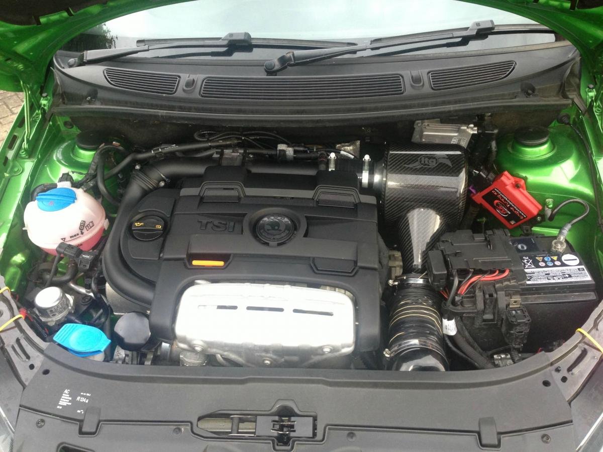

Have you looked to see if the exhaust is a standard one.  Or standard springs?
Have you put in 99 ron Super Unleaded yet?
Exhaust looks standard to me. Just looking at it.
Ride height suggests springs are also standard, not actually looked for any marks on them.
I ran it till it was nearly empty yesterday and brimmed it with momentum this morning

Thanks 👍 was just trying to figure out if first owner ever had engine replaced as had from sept 11 until at least sept 15

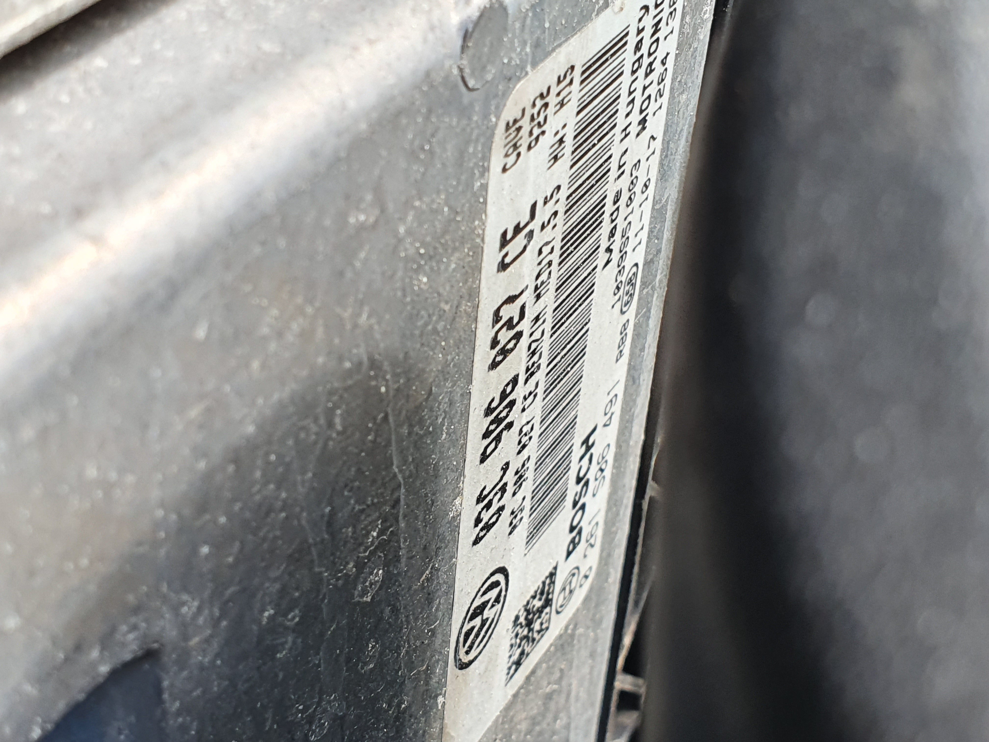

This is all I have that I can see without taking things off
That is OK, the orange sticker is not on your engine because it is a new / refurbished block.
But your ECU had a Orange Sticker with a matching number to the orange sticker on the old engine,
so is there an orange sticker on the ECU on it now?
There is a date code on the ECU on a sticker.     (Not the 4 number that an orange sticker has.)

ECU Behind the Air Box on Fire Wall.

Picture's not amazing, but thank you!
It says CAVE.
But the engine should have the latest parts, oil spray jets etc.
The date is on the ECU.
New one from 2017.   Good stuff.

So if its had a new ecu, what does that mean about the engine mess?
It means chill.   Engine and a ECU were sent and things are as they should be.
Feed it not long life oil, 99 ron fuel, good spark plugs and filters and enjoy it.
