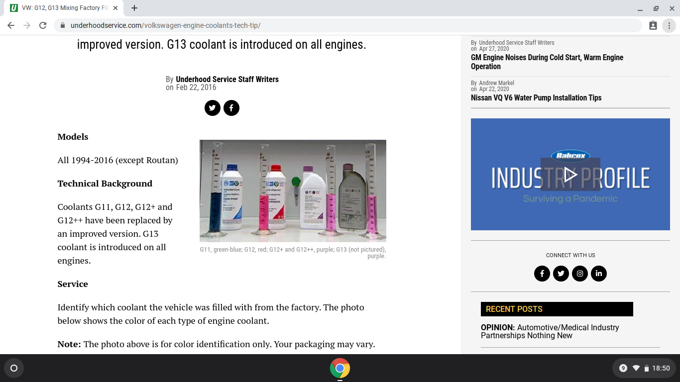

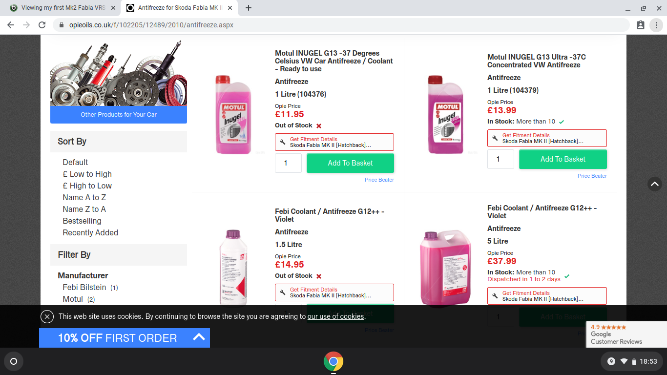

Coolant.  VW G12+.
 As long as between Min & Max it is fine as there is no 'FILL TO THIS LEVEL'  & if you fill to MAX it might then set it's own level.
Watch for any Coolant Loss as that can be a sign the water pump needs replacing.
Sorry, where can I buy that from?

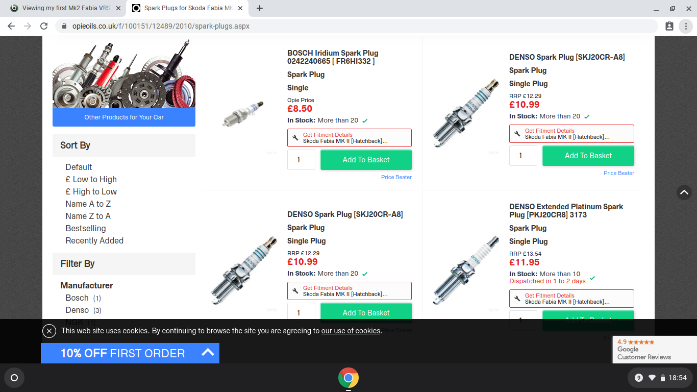

Ebay / Amazon, Motor Factors, Dealership parts departments.
Spark Plugs, coolant etc.    Maybe a discount code available.
http://opieoils.co.uk
You will get G13.
