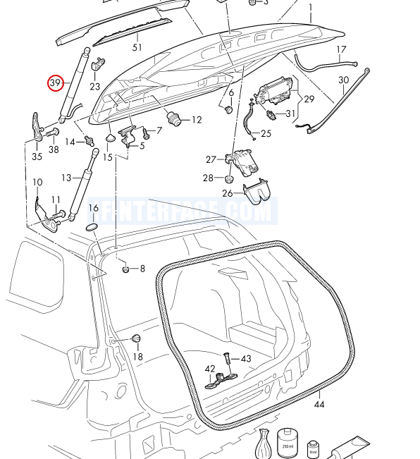

Drive Unit - Part No. 3G9827851C should be the latest revision.
