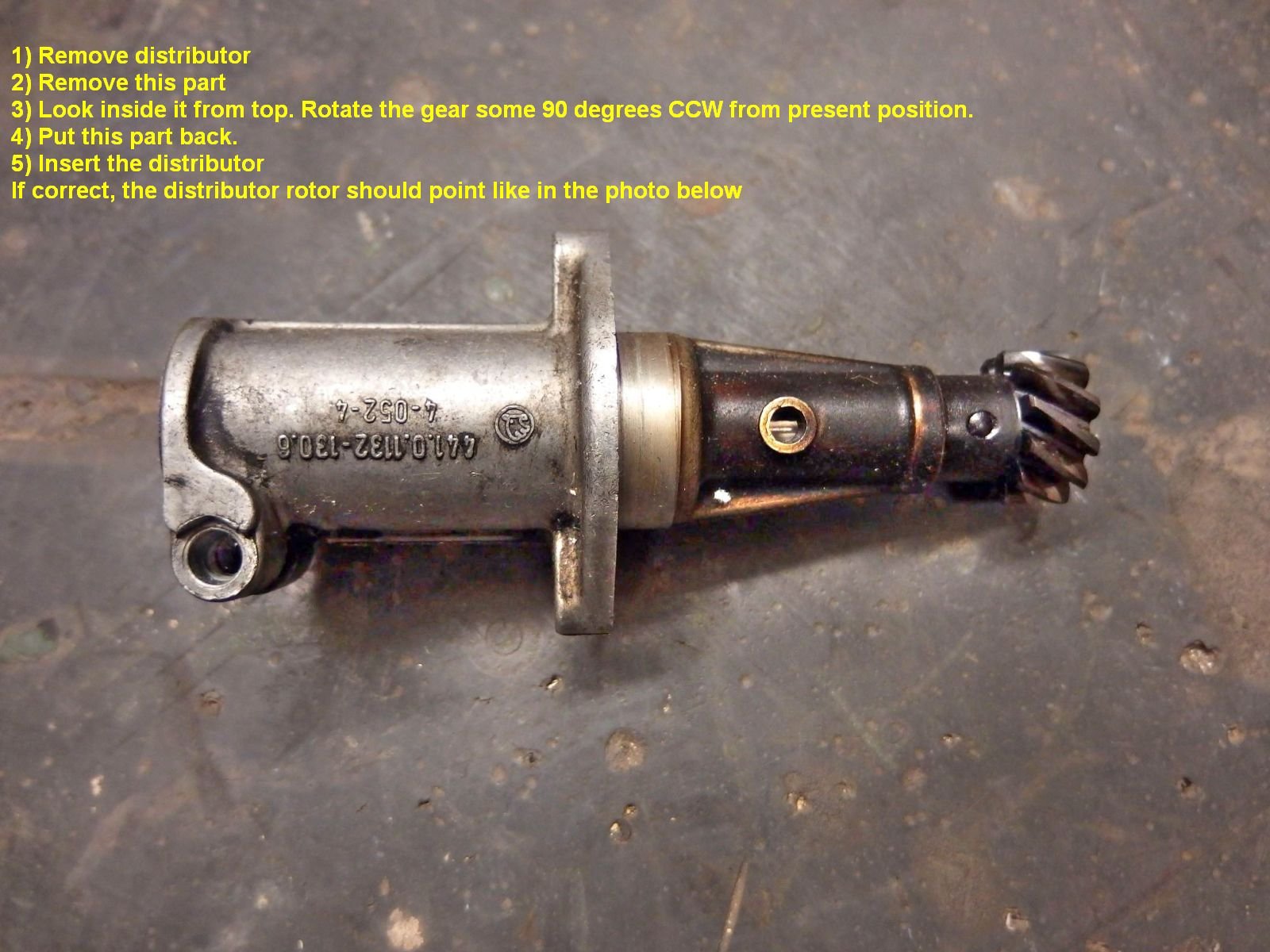

  • Steps for correct ignition timing: put piston 1 to Top Dead Center on compression stroke see photos below and follow explanation. It's a fiddly job because when you insert the base of t

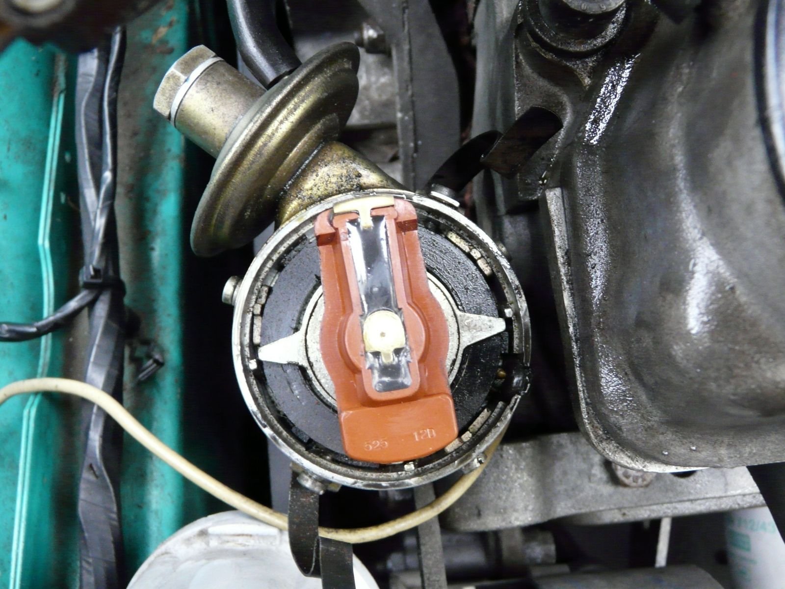

I have just done some testing, good compression on all cylinders 130-140psi which means my valve job/piston replacement is good. I havent messed with the timing chain at all. I also tried with another coil and igniter, cap and rotor, ignition cables, there is spark always. Here are some pics of everything I hooked up, I'm concerned with the distributor, when the engine is at 0 degrees the rotor is way off its mark?

Oh yeah. Bad ignition timing. You have inserted the distributor wrong.
The weird thing is I haven't messed with the distributor itself at all, its only been removed off the engine to be cleaned and put back... how do I get it right? I aligned the little slot on the bottom with the slot inside the case... do I need to loosen the nut on the distributor housing and rotate it?

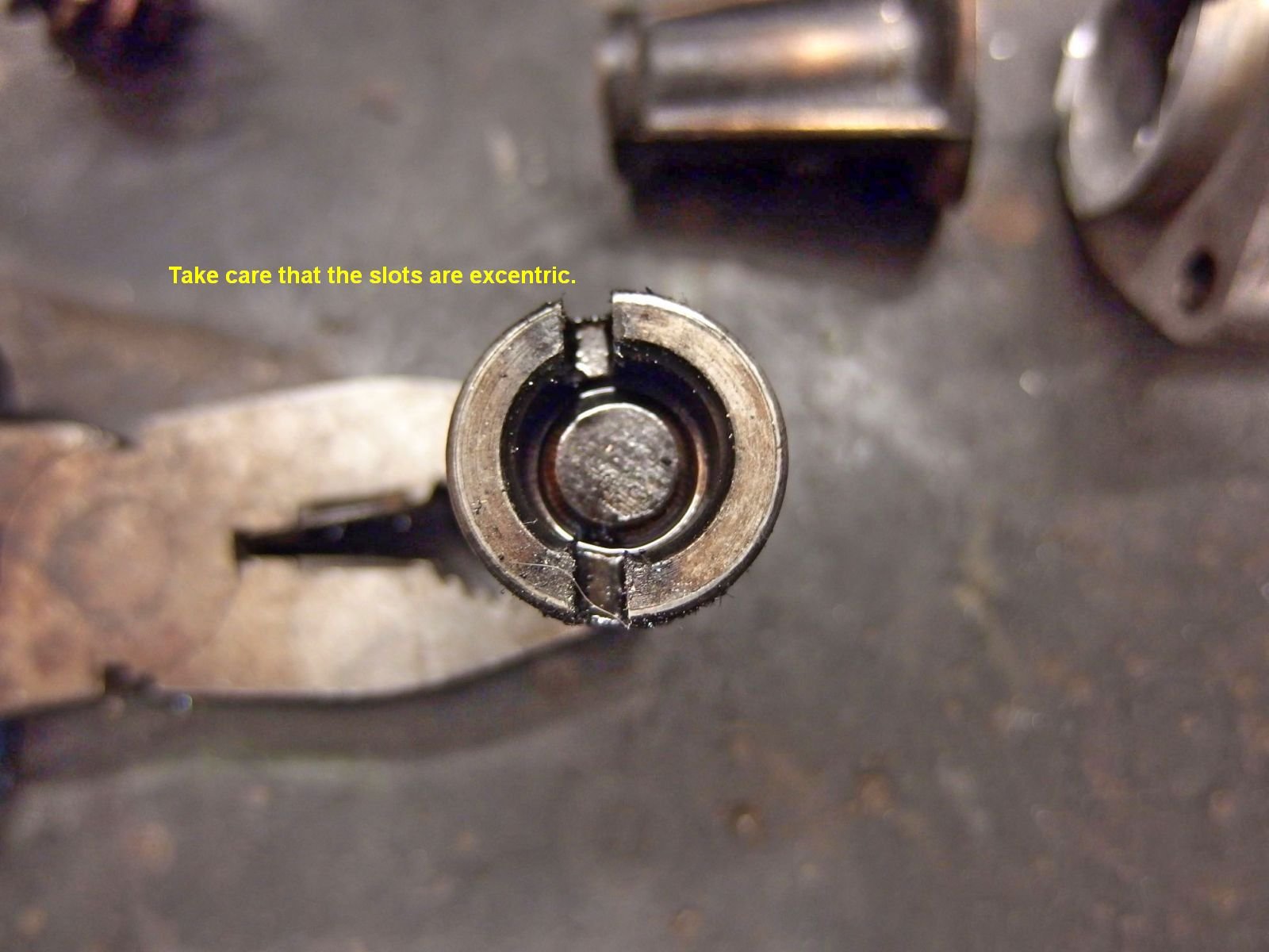

  • put piston 1 to Top Dead Center on compression stroke
  • see photos below and follow explanation. It's a fiddly job because when you insert the base of the distributor, the gear will rotate. But you will know what to do to align the distributor rotor.

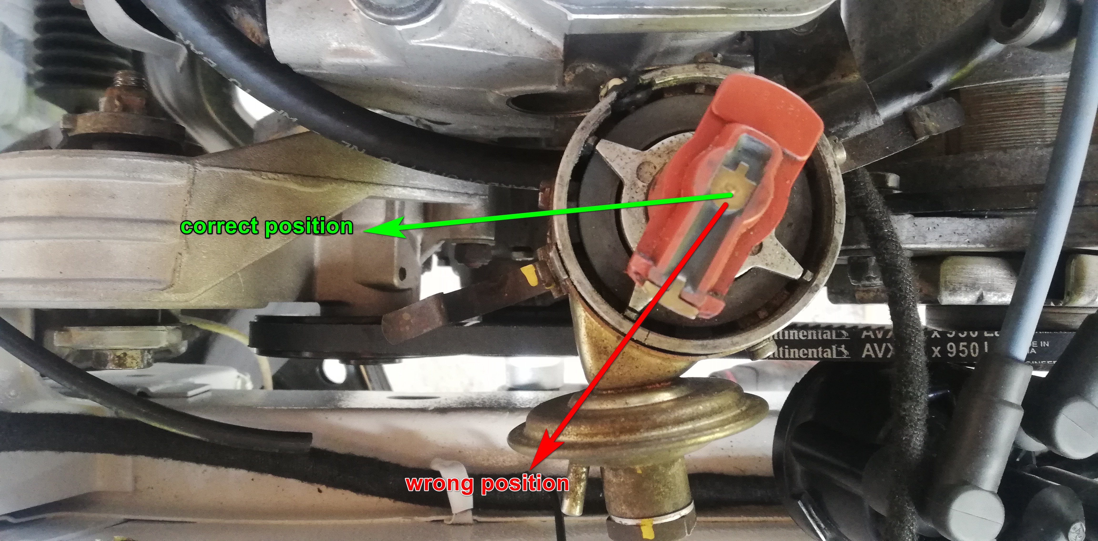

Have a look at the input for the vacuum advance diaphragm. It points totally wrong.
Trust me. I know what is the correct position of the distributor.

Nice topic.
Just two thing 1- i also had a similar problem once, not during no matter what i did. Turns out that there was a problem with a switch (my car has been fitted with LPG aftermarket).
2- my distributor is also in the same direction right now facing the left wheel. i will try to change it and put it in the original way like RicardoM told (facing the car) when ı will readjust the valves.

Yes I agree, but this is a nearly 45 degree angle, and this seems to much for me. I will adjust the valve setting this week (I think it need adjustement because I lost a little bit of power and I have been hearing valve noises- typical click noise at idle).
After Adjusting It I will check If I can move the distributor in Original way (toward car and not left wheel), and keep you guys updated.
