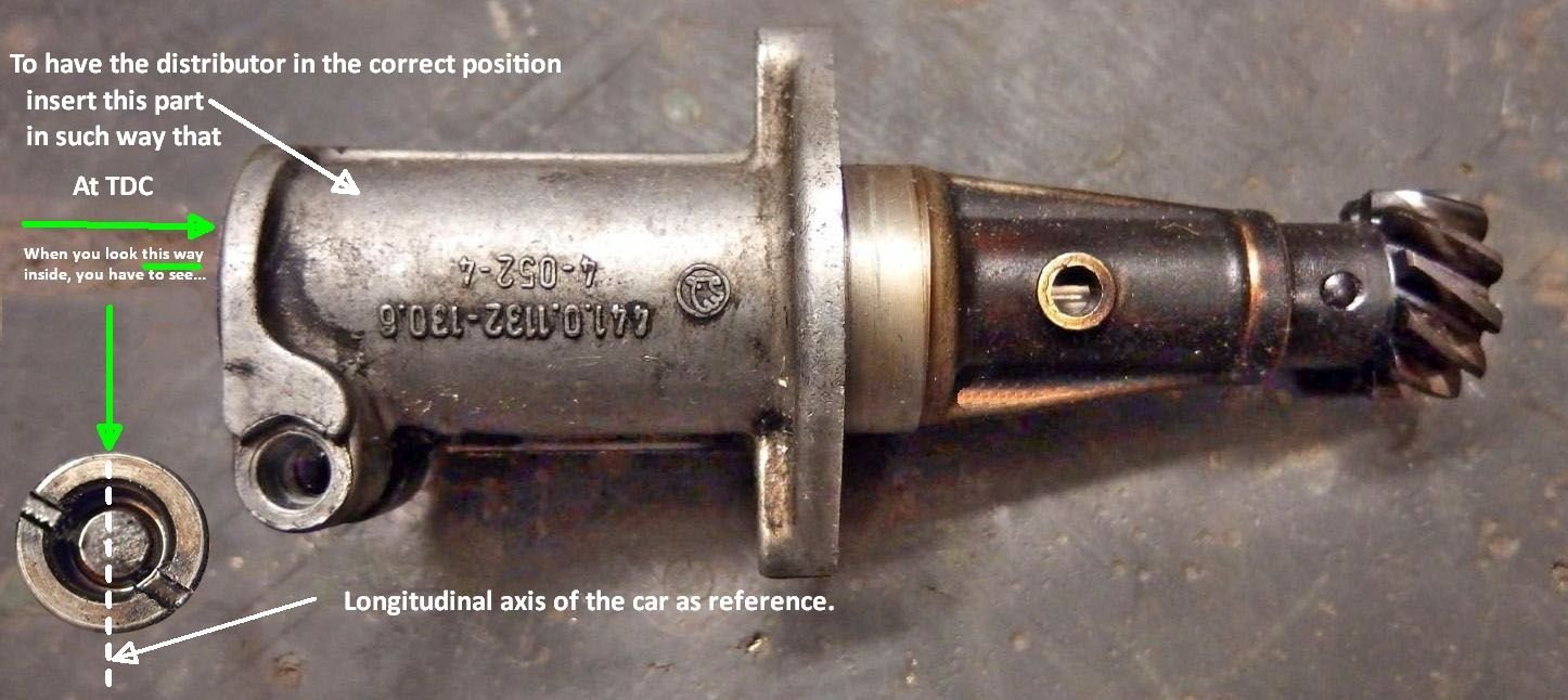

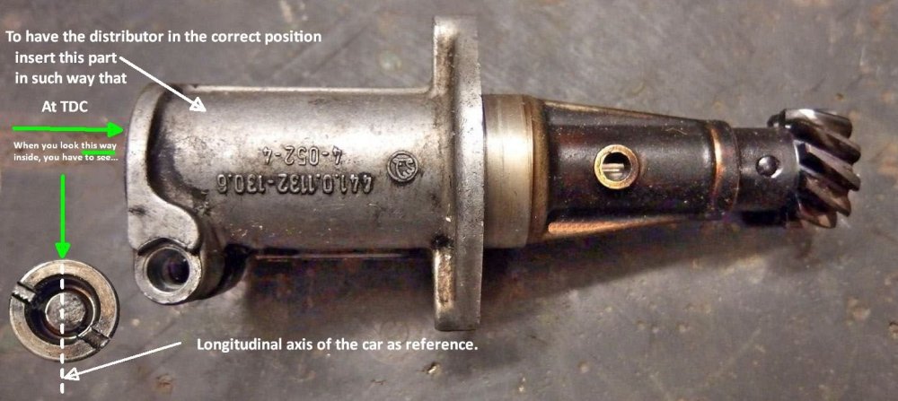

  • Steps for correct ignition timing: put piston 1 to Top Dead Center on compression stroke see photos below and follow explanation. It's a fiddly job because when you insert the base of t
  • The rubber gasket below the carburetor should make a PERFECT seal. I insist. A PERFECT seal. If the engine sputters and backfires it is a clear sign of bad ignition timing. I gave you all th
The main problem is still bad timing. It's not that I say so, but the factory manual says so. All Favorit/Felicia cars on carburetor that I worked on (over 50) have the timing and the distributor positioned as explained. It is YOUR problem that you still don't understand how to position the distributor correctly.
The secondary issue, about bad idle, is 100% bad vacuum related. The carburetor is VERY sensitive to any vacuum leak. New third party gaskets are a mess. They are not perfectly flat on any side, or they are made of bad rubber, depending on gasket type. It took me a month of testing various gaskets and fastening solutions to finally find a reliable solution for getting a perfect vacuum in the intake manifold.

On the distributor position issue: I hope that you agree the actual position of the distributor is wrong. Failing to admit it will not encourage me to give you more advice. I will never struggle for doing good against people's will...

@RicardoM I set the distributor exactly how you pictured it on TDC at compression stroke (removed 1st cylinder sparkplug and after it blew out air and the mark was aligned on the crank).
Starting it up only ends with pops which means its not right, no clue why.
