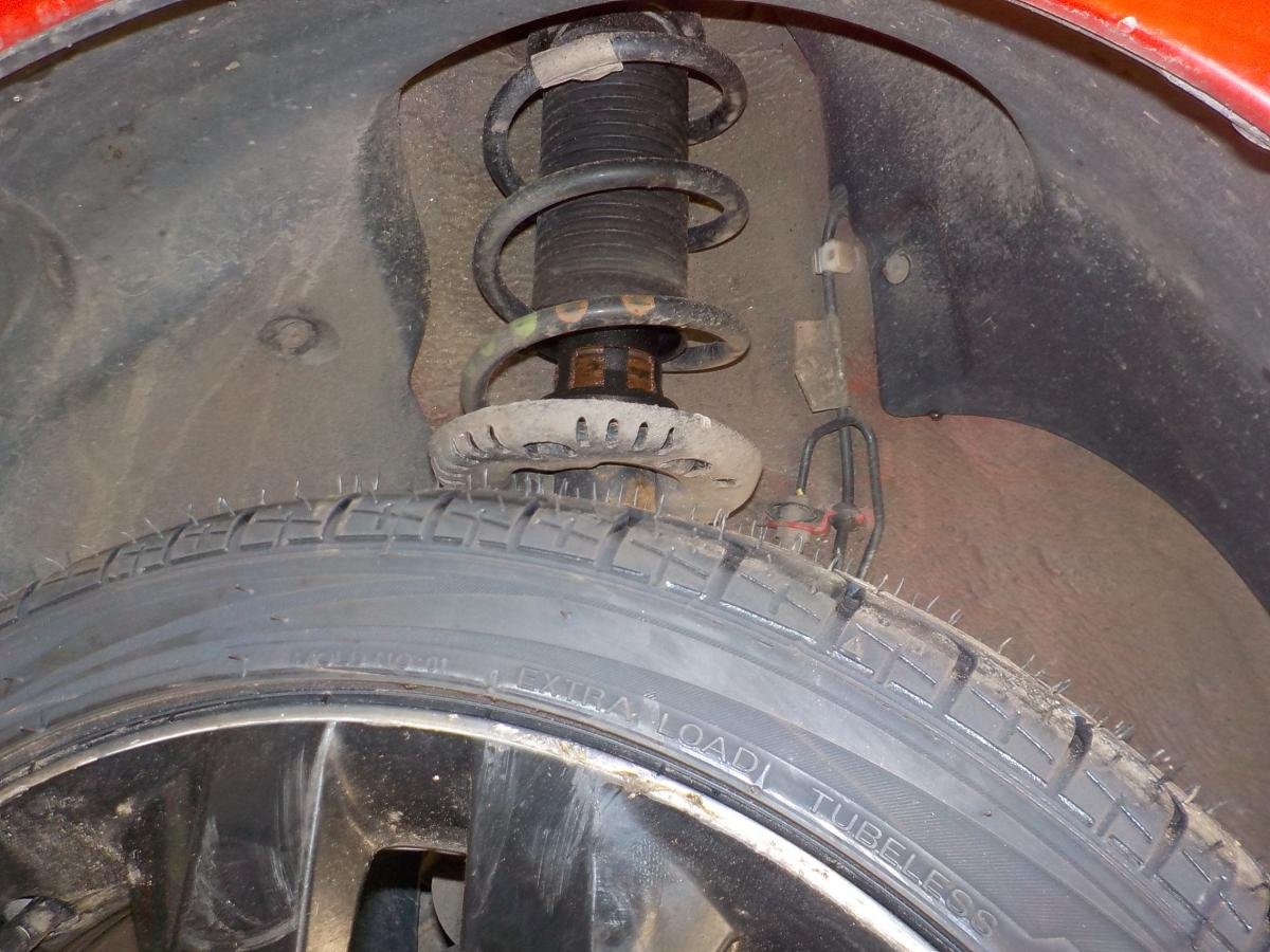

Nevermind. Spring has snapped at the front instead, so will be getting that sorted first 😪
I had a snapped spring after 25,000 miles, car only just had first MOT........ most disappointing..............
Hard to pin point the reason, could be poor spring quality or our wonderful roads in super condition !! 😡
Must be quite common just replaced front offside spring just  recently
Very common front drivers side with UK Mk2 Fabia vRS.
If replacing a new pair of fronts be sure to check when they arrive they are a pair, i have seen TPS deliver wrong ones, and OEM can be silly priced more expensive than decent after market ones.
Same goes with the rears.   Maybe best upgrading all round.
These are standard not Dealer fit options which were Eibach.

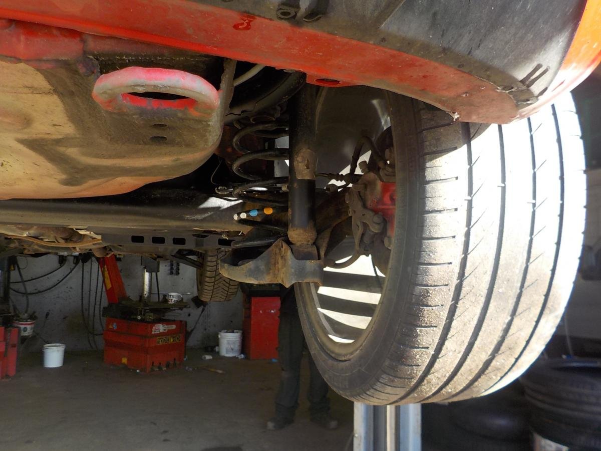

Need it on the road. So took it to a Halfords as they were the only place near me with space on a Saturday. Sachs springs, and wounded me to the tune of £385
