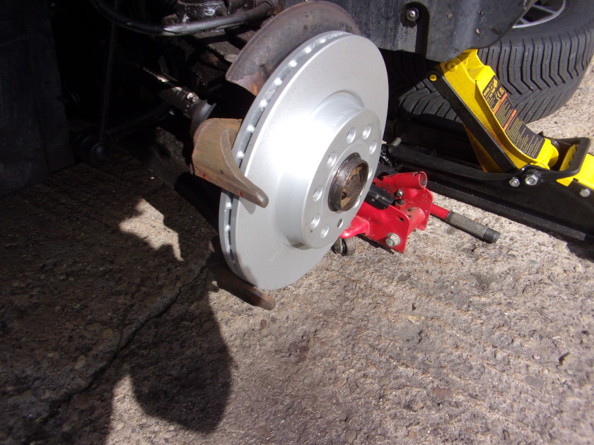

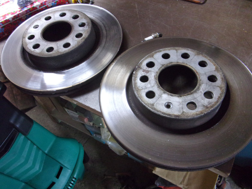

In July this year our seven year old Yeti 2.0L diesel SE L sailed through the MOT with a clean bill of health this done at the same time as the service carried out by DM Keith Wakefield who have maintained the Yeti from new as they did with our previous Fabia Monte Carlo; it's done a gentle well looked after 32,000 miles and I drive on the gears not the brakes.
With a clear MOT I was more than surprised to find an impending bill for new front discs & pads total of £352 had been recorded on the service sheet? A few days ago I checked Ferodo website for local  suppliers and visited A-Z Motor Factors here in Huddersfield; A two minute phone call and a bit of time with dirty hands has saved me £252; A-Z were brilliant and the Borg & Beck discs & pads came to exactly £100 over the counter.
They are now fitted and I took my time cleaning and greasing; the original discs were proving a real pain to remove they were rusted absolutely solid; in the end I visited YouTube; I'm an NCB trained mechanical engineer and given how tight these discs were I didn't want to use excessive force.
Just give a few heavy sharp clouts on the front face outer rim of the disc with a 4lb club hammer; hitting the disc a number of times in different places shocks the disc free; put the Torx screw back in loosely to save the disc flying off. It works a treat saving no end of hassle and frustration.
A new disc in place it's a shame to get it dirty.
The original discs in excellent condition.
With the original discs on the bench out of curiosity I measured with a micrometer; they are exactly 21mm thick; new discs are 22mm thick and require replacing at 18mm thick. 1mm wear in 32,000 miles if they were to wear equally over the next few years then  they would easily last for a further 50,000 miles. The pads yes they were worn but still had many thousands of miles in them. I've found a local independent service garage with an excellent reputation for future work on our beloved Yeti. The £352 I thought reasonable considering a main dealership's overheads what I don't think reasonable is replacing perfectly good used parts  with new.

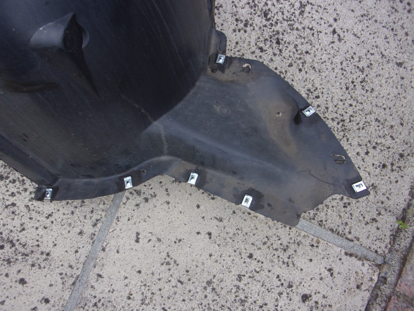

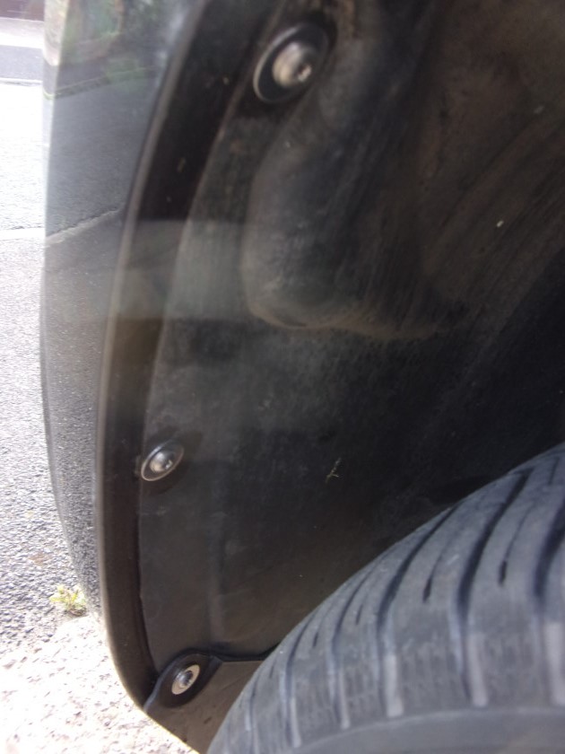

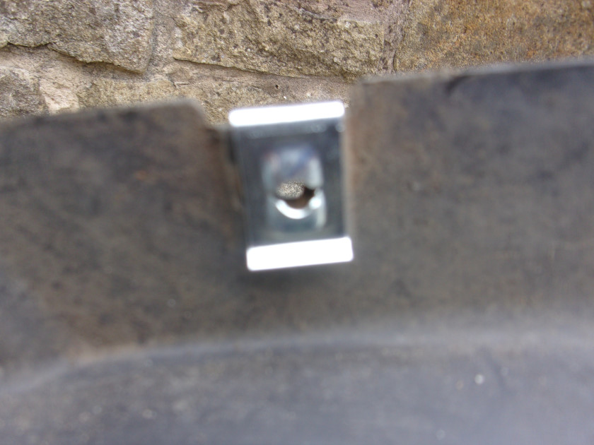

I've posted elsewhere but we intend to keep our Yeti so I've also been rustproofing with Bilt Hamber products; all four inner wings and suspension now treated; I dropped the wing liners and have replaced the fixings using heavy duty zinc plated U nuts and also Stainless self tapping Pozi screws with stainless penny washers.
Very heavy duty U nuts.
U nuts in place.
I don't need to rustproof these they being stainless and I've got a good stock of these U nuts; Pozi self tappers and washers. These Pozi self tapping flange screws have a smaller flange the the T25 they replaced so penny washers made an even better job.
Worth posting again if I've already posted the pictures of the wing liner fixings.
U nuts in place.

Why did you go to the trouble of replacing perfectly sound and serviceable brake discs?
That shouldn't really be described as a monetary saving of £252 but saving yourself from being ripped off like all the others who believe what is simply a standard line added to an invoice "brake disks and pads 75% worn"

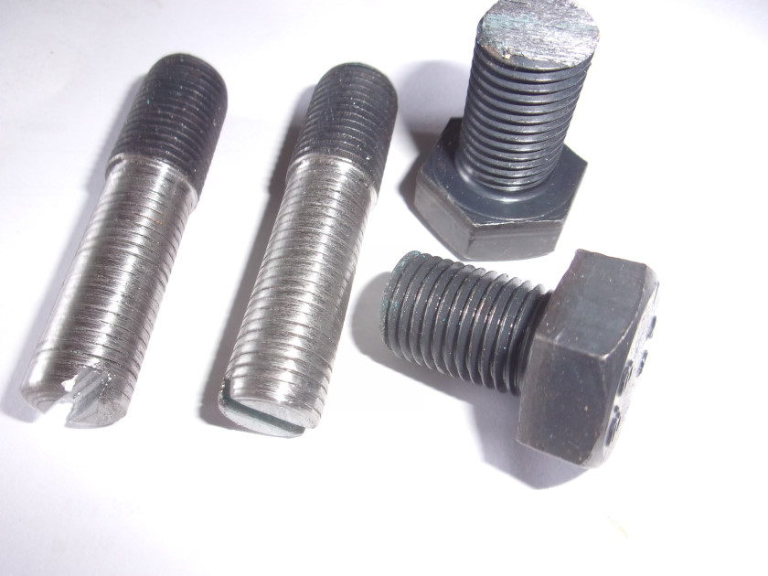

Re the cut down bolt for holding wheel in place while fitting real bolts, you will struggle to find one as its a non standard fine pitch, however there are loads of knurled and slotted ones on Ali-Express for much cheapness, mine came as a pair in a robust case, I gave one to my neighbour and use the space in the box for the locking wheel bolt adaptor, tool to remove plastic bolt head covers etc.
Using one works but having 2 makes wheel-changing much easier hence why they also sell them as pairs.
Hi,
Thanks for asking J.R.  I'd already bought the discs & pads so rather than just fit the pads I did both; I could have damaged the original discs getting them off because they were incredibly tight being rusted on then I can forget them for many years to come.
Thanks also for the information regarding the wheel stud size; it was just a thought but we have a local store called Danlett who do all things fasteners; https://www.bolts.co.uk/ I have both woodturning and metal turning lathes; I don't even need them threaded just a close sliding fit will do and I've got plenty of round bar stock so can make my own plain; threaded and even knurled in a number of designs. Two could well be better as you kindly suggest. Rain is forecast again for tomorrow so I could spend a bit of time in the workshop. I've also got plenty of thread gauges.
I do regard it as money saving though because had I not known just being a normal customer I'd have believed it and had the work carried out; anyway it's done; next week I think is going to be hotter so fingers crossed I can resume rustproofing; I want to complete the rustproofing as much as I can before winter kicks in.
Kind regards, Colin.

The Yeti wheels being so heavy take a lot of effort to refit them so this morning I popped over to Danlett in Huddersfield and as you rightly pointed out J.R. the threads are an unusual size; I wanted a bolt which would have an unthreaded section but all they had was Hex head set screws;
I bought two these being M14x1.5x80 HEX SETS   DIN961  GD 8.8.
Back home I quickly modified them cutting the hex heads off leaving a threaded 55mm length; in the lathe I removed most of the thread to give a smoother length of 35mm; screwdriver slots were cut using a hacksaw and all sharp edges removed;
These will now screw into the wheel hub allowing the wheel to slide on; they are a very loose fit in the wheel holes but I don't think it will matter; I'm unable to try them due to our wet weather although next week is forecast dry and warm.

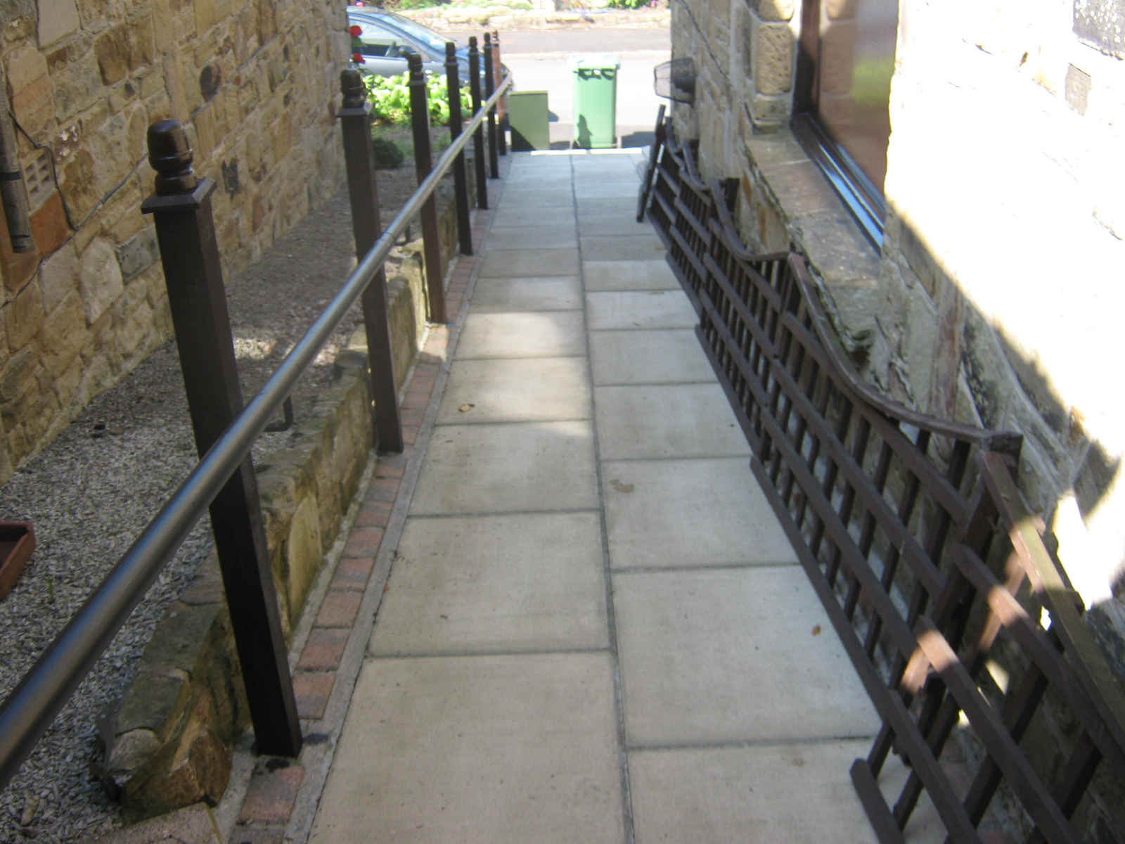

A quick update. I've collected 2 gallons of old engine oil this afternoon; when I asked how much I owed  it was free of charge in fact the guy was glad to get rid of it because it now costs to dispose of old oil; I can have as much as I like but this mixed with diesel at 50/50 will last years for the fences I want to treat; usually I brush it on taking ages this time I'll use a spray gun.

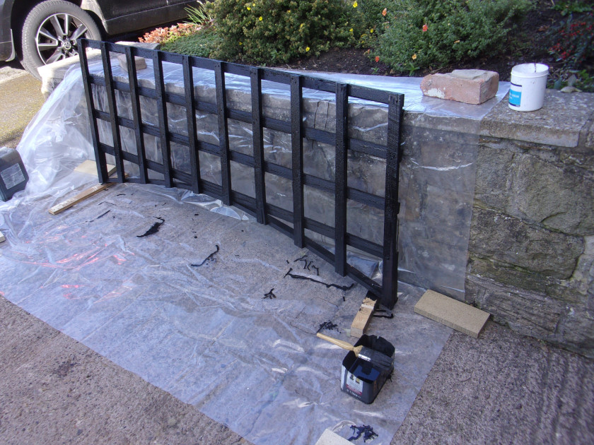

This is a bespoke fence I made about twenty years ago when I installed the new pathway; it's made to suit the slope and made from treated roof tiling battens costing very little indeed other than thought to design and time to make; each panel is secured by four hex head 75mm long turbo screws enabling the panels to be removed allowing a proper treatment.
The fence still looks like new because I treat it every three years or so. These panels cannot be bought; the acorn finials are wood-turned from the post top offcuts with oak capping blocks. Just adding this for interest.
I never want anything for nothing so I took along a box of chocs on the back seat of the car which were welcomed as I handed them over.

I did apply the diesel/old oil to the fence using a brush; a very messy but rather therapeutic job on a nice warm dry day but with heavy rain forecast the day after so I was in a bit of a rush; normally I allow each panel a few minutes to drip but needed to get the job done in the day hence the panels dripped then a pressure cleaning job was needed.

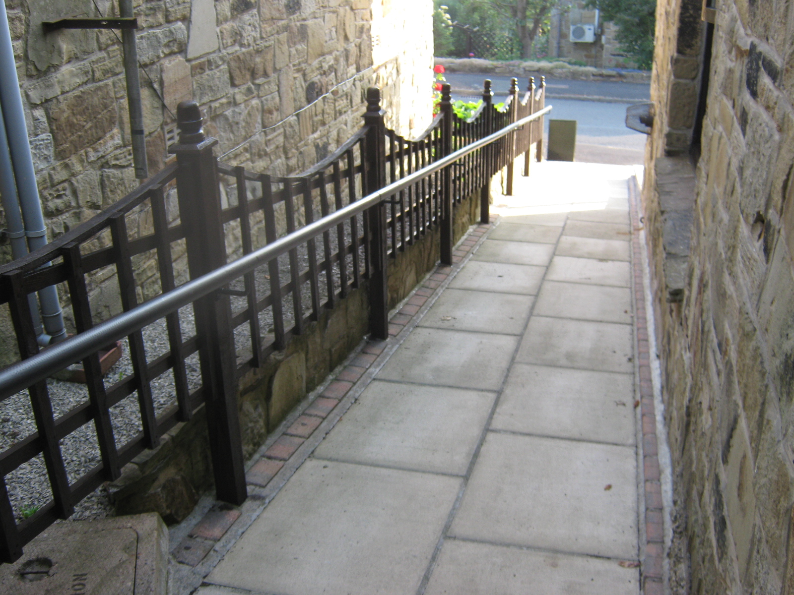

Seven panels so eight posts. Treating these posts highlighted today's tradespeople at least the the builder working (?) directly across the street; just as I started this builder arrived in his battered truck; I treated all eight posts; caps & finials taking just an hour; I felt sorry for this builder; he must struggle a great deal with his mobile phone; cigarette; food & drink he simply doesn't have enough hands in order to cope. He finally got out of the truck as I was putting my brush away; he went into the house then shortly after he drove away; In the afternoon the builder arrived once again but this time only spent three quarters of an hour on his backside in his truck. I wouldn't want him on our site.

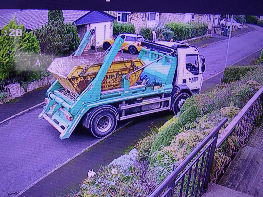

Two weeks ago the skip lorry shattered the manhole cast iron cover in front of our garden wall on the pavement; these things happen and it was quickly replaced. On Monday this week here's what happened;
747168057_Myersemailsentwiththesefourpicturesat231pm.JPG.3205978c11848440fd22a745f3213649.JPG
The new manhole covered not only shattered but the whole manhole structure now compromised.
CCTV is very useful; here's the lorry on top of the cover. This damage occurred in the morning; 3pm I became involved; I sent camera images together with CCTV slides to Myers the skip company; Myer's were totally unaware of this damage but they were brilliant thanking me and another skip wagon quickly arrived; it was hugely dangerous and the driver causing the damage didn't report it; the debris was cleared and as I type there's a big safety cover over the hole with a traffic cone at each corner. We wonder if the builder is on the clock or on a fixed price quote.
