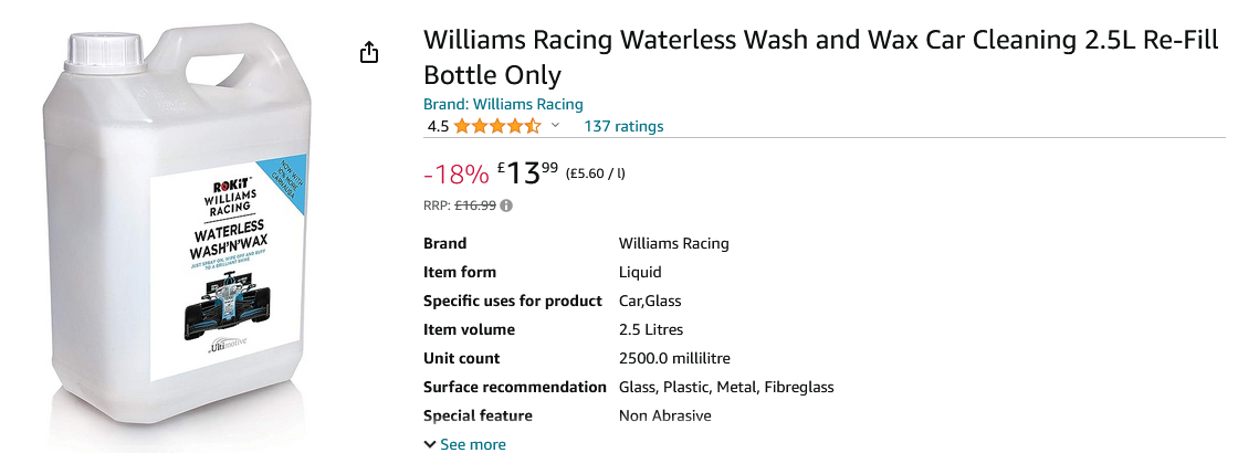

For years I firstly used Showroom Shine then Williams both having carnauba;
I think I paid over £20 a few years ago for 5L and still have lots left; it's incredibly easy to apply and buff up but I find it doesn't last long although freshly applied it does look good. I want to use the Bilt Auto Balm but the rain won't let me.

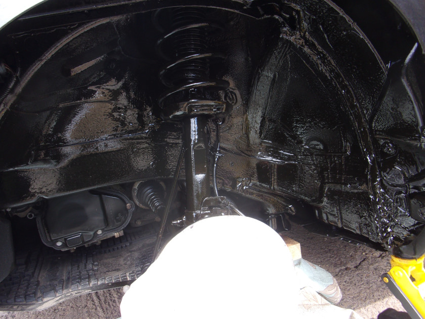

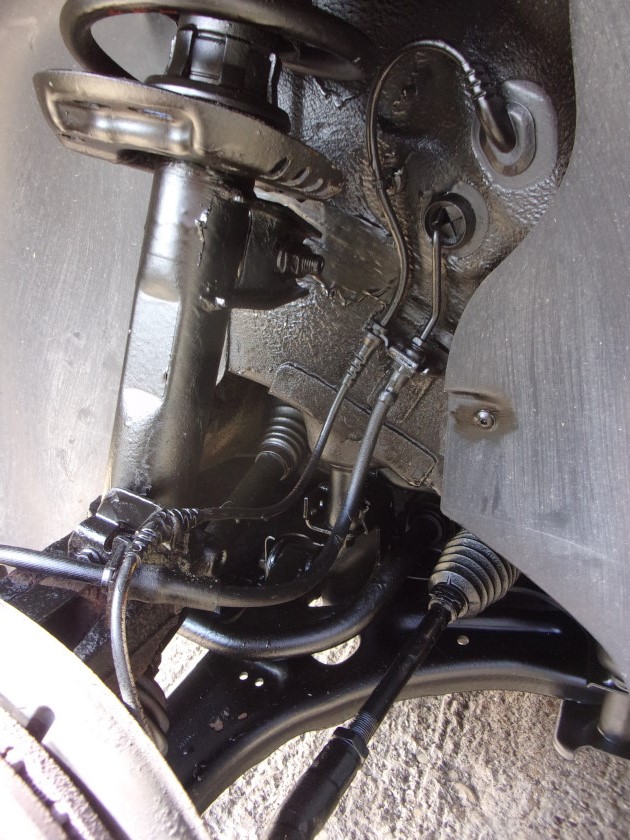

Hi,
Our Yeti rustproofing under way
7 years old it was rusting badly.
      This looks much better.
This Bilt Hamber isn't cheap but well worth it.
Rustproofing under both front wings has taken two days; wire brushes; scrapers; and coarse abrasive paper were used to remove loose rust; items not to be sprayed were masked off;  pedal bin liners were perfect to cover the brake disks and was secured with masking tape; other areas covered with paper and cloth; an old heavy duty lined curtain protected the driveway; it's an incredibly messy; sticky job. The axle stands I bought through eBay still haven't arrived so I used two trolley jacks for safety; one under the jacking point on the cill the other very near under the chassis; both wheels on the opposite side were chocked with bricks.
The wing liners were fun to remove having found all 19 T25 Torx screws but a great deal more fun to replace; I've ordered new screws and fasteners and will replace all once they arrive; I'm going to try these stainless self tappers and bought 50 to experiment with;
I'm not in a hurry but am worried about our usual dire wet climate; I hope the rain holds off for another two days; if I get all four under wings done I'll be happy but I'd like to rustproof the cavities too.  I emailed the eBay seller of the Bilt Hamber asking if it had a shelf life but fortunately the reply was good news; 7 years if in the container. White spirit gives easy clean up; I'll start on the rear end tomorrow; it's tiring work and for a change it's been 25C today so no complaints from me; fingers crossed it will last. This is the story so far.

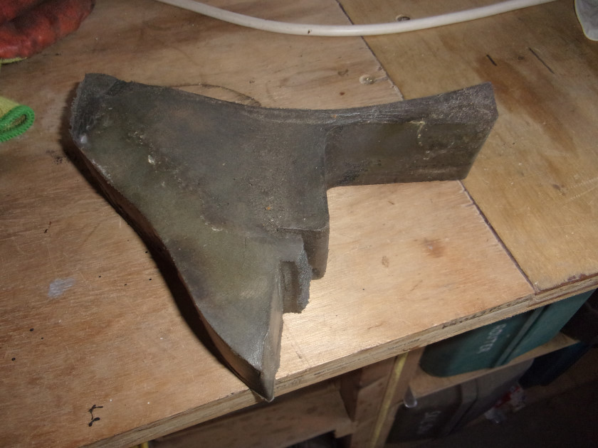

Before I forget; I was discussing rust proofing with a local top end car restoration guy and he told me he gets lots of VW's in with rotten front wings stating there's a large foam packing piece glued to the under wing at the top; this is shown above removed from our Yeti and both are now removed; these accelerate rotting.
Kind regards, Colin.

Yes, Golfs used to have them for sound deadening, they fill with water like a sponge and rot from the inside out.
Hi,
Thanks Prezafab; I'd rather have slightly more sound than rusted out front wings.

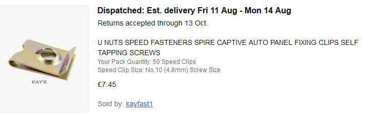

The clips on the Yeti are poor and rusting so I bought 50 of these and they sure are very strong; I'm giving them a good dose of rustproofing so these together with stainless screws should last a while.  They are so strong they're a pain to install. Some of the original T25 Torq screws are badly rusted.

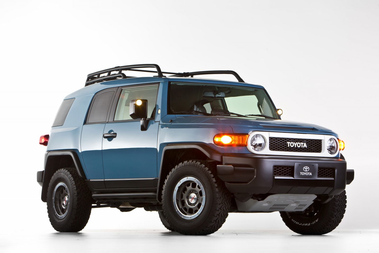

Potential Yeti replacements.
Toyota FJ Cruiser
Jeep Renegade
I think not.

Slightly tongue in cheek perhaps but in jest, absolutely not. Were I looking for a Yeti replacement, which I'm not, then both would definitely be on my list of possible candidates.
If the quirkiness of the Yeti is one of it's appeals then the Toyota outdoes it in spades.
I wonder do you say the same about the Kia Soul which has previously been mentioned?
I saw one of those Toyota FJ s parked on the Blue Ridge Parkway in the US, years ago. Had a good look, and thought it was style over substance to be honest, even back then.

No, strangely enough, I don't say the same about the Kia Soul.  I was in one just a few weeks ago and could easily have been tempted had they still made one with a petrol or petrol hybrid engine, but they don't, and I don't want an EV.
The Toyota FJ . :-
* Isn't available in the UK (and isn't manufactured anywhere any more) and most of the subscribers to Briskoda who have been discussing the alternatives to the Yeti are in the UK.
* It's got a 4 litre engine in it which does 16 miles per gallon.
* It's 4670mm long and 1900mm wide compared to the Yeti which is 4223mm long by 1793 mm wide.
