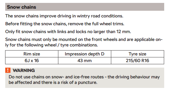

Reading the handbook it says you can only use snow chains on 16” 7j wheels with 215/60 tyres? Hence the car must be able to fit 16” wheels?
My car has 19” wheels but could I use the set of 16” wheels and winter tyres that I have from my previous Yeti?
In the handbook it say cars with 19” wheels use a spacer and this has to be added if upgrading a car with smaller wheels? What is this?

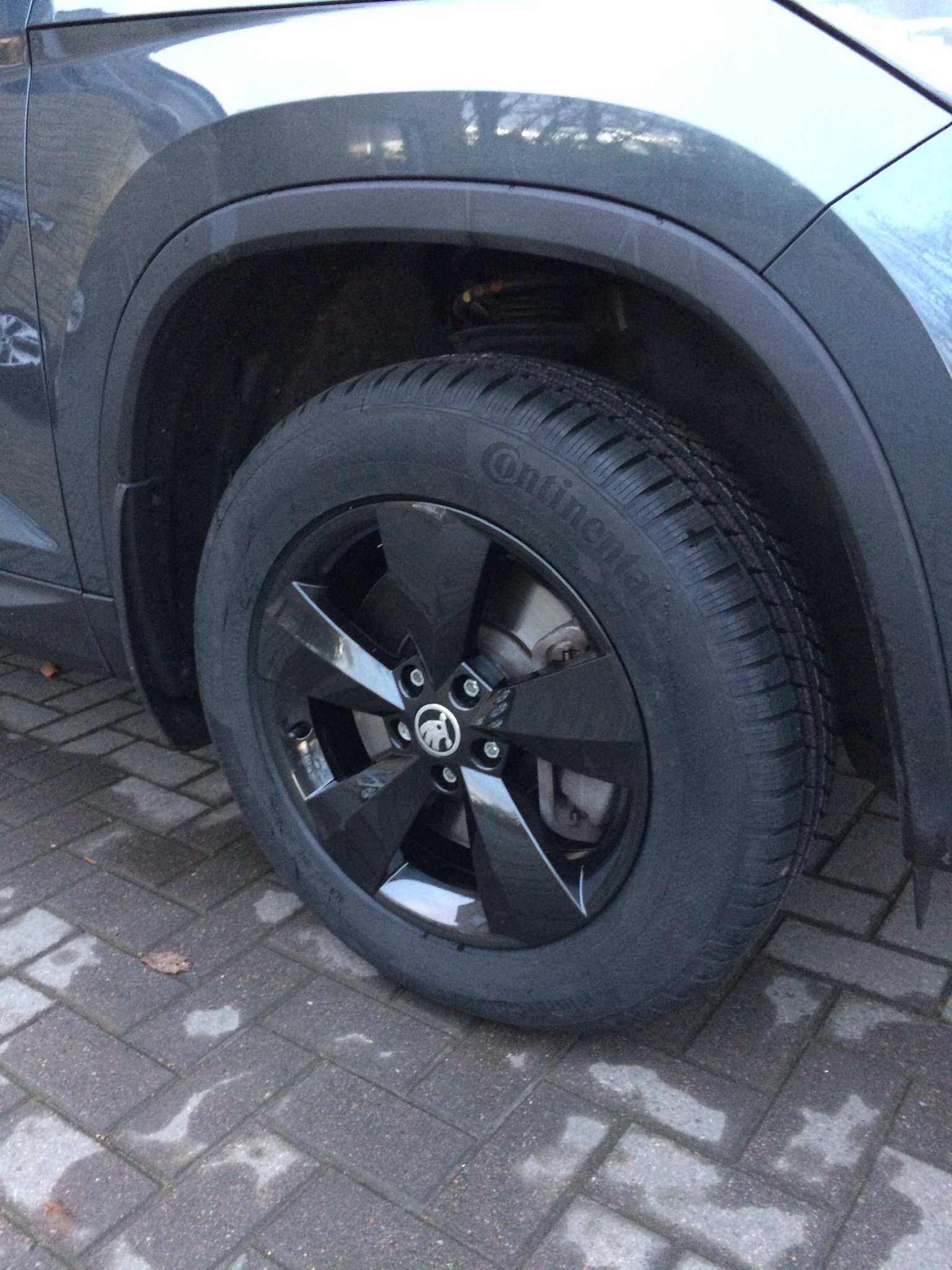

19” summer and 17” winter on my Kodiaq.
All good. No mods needed.
Daft question but what type are those?  Rapids?
The Karoq online manual says 6J:
if you were asking me, then they’re Nanuqs.

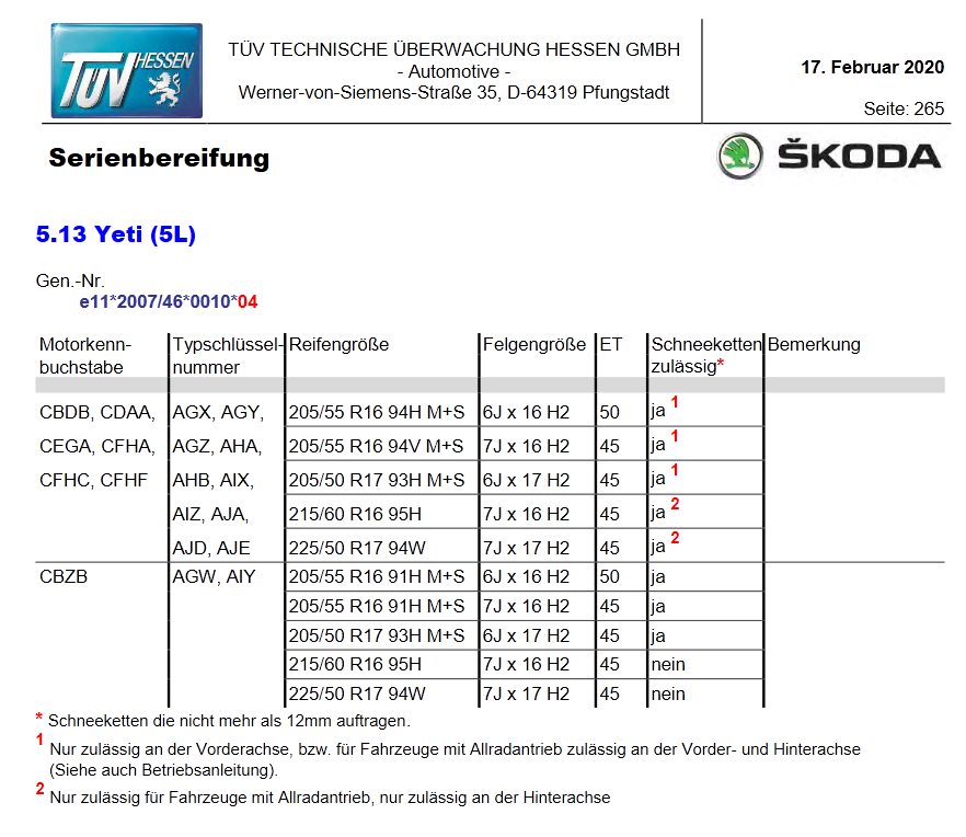

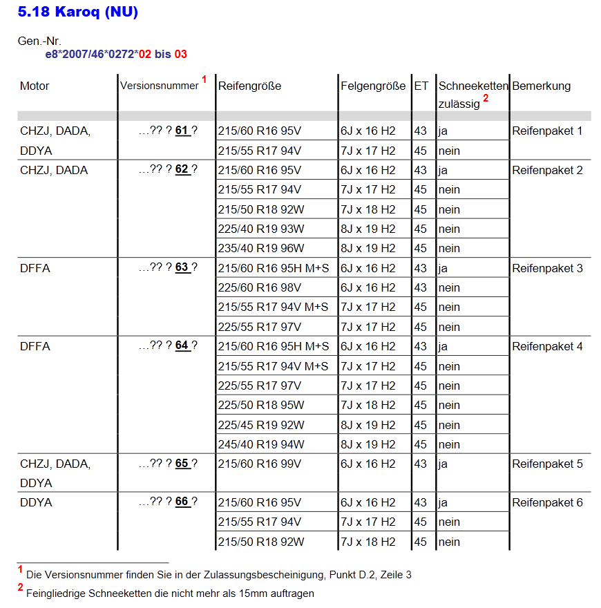

I have checked and my Yeti winter wheels are 215/60R16 with 6j steel rims, offset et43, so exactly correct to use on the Karoq. Indeed it lists this wheel and tyre size on the filler flap as an option.
All the tyres still have 8mm tread left after 2 winters use so should last a few more winters. How deep would the tread have been when new? I know they are supposed to be replaced at 4mm left.
I thought from previous posts in a different thread, it was established that the Yeti 16" wheels had a different offset - can't remember what - & that it was risky using them on the Karoq.  Maybe I misunderstood.
I do have a set of rather nice 'Rial' matt black 16" wheels from my previous Yeti - fitted with Cross Climates that have a fair amount of wear left   They're in a cellar that I can't get to for a week or so - I was going to try to sell them, or if not, scrap them.  It would be great if I could use them on the Karoq.
Actually just found the invoice from late 2016.  They're 6.5 x 16  ET33 - maybe the 6 x 16s were also an option for the Yeti.  For me, looks like it's back to plan A + I'll buy some steel 6 x 16s in a year's time - pity.
Edited by croquemonsieur
ET33 is the wrong offset for a Yeti, as well as the Karoq.
