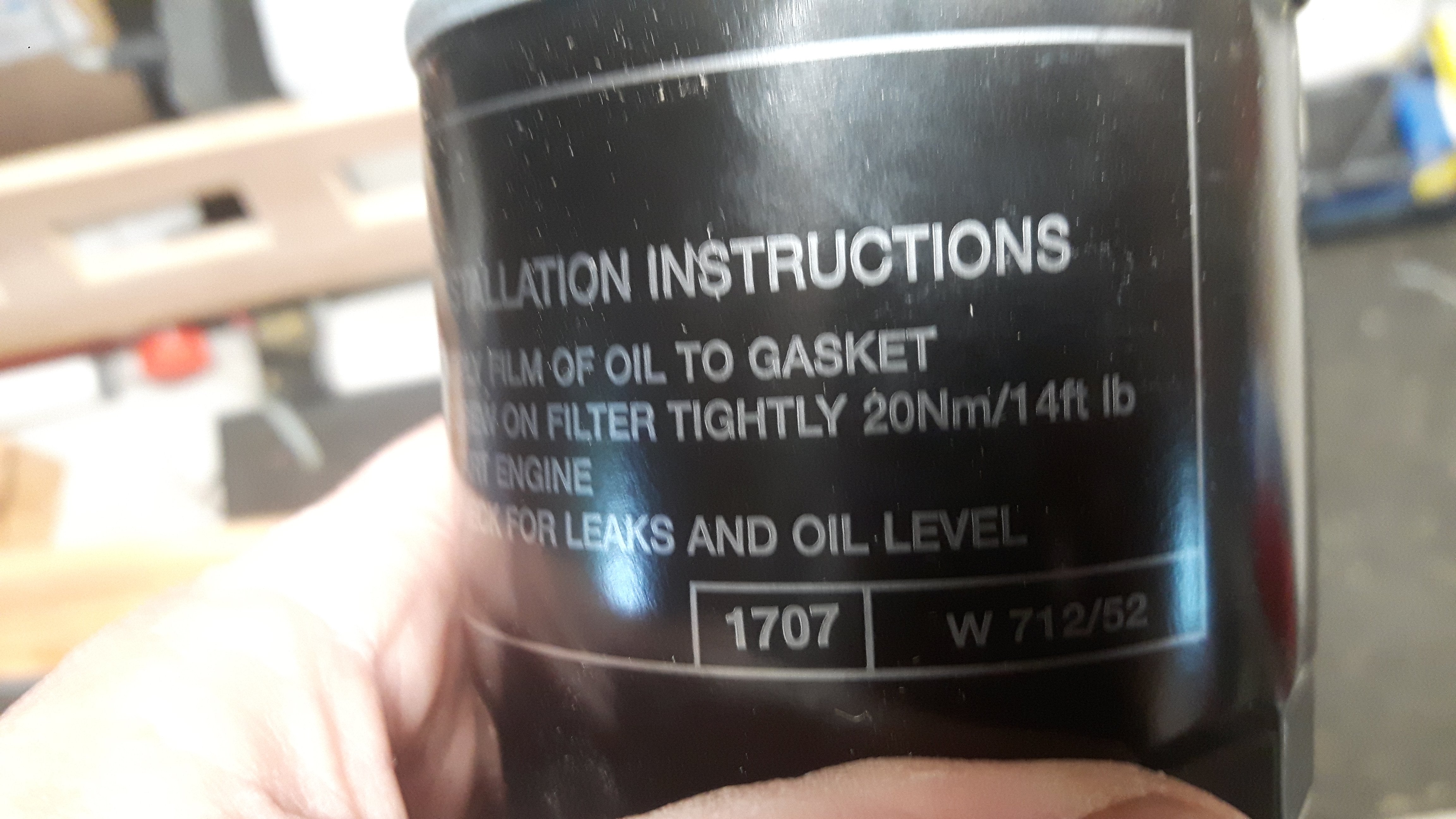

Funnily enough I was just trying to find a picture of a genuine filter with the 20Nm on it, and failed thus far.  Wonder if I made that up?! I've got one at home I'll look at this evening which should confirm my insanity or otherwise.

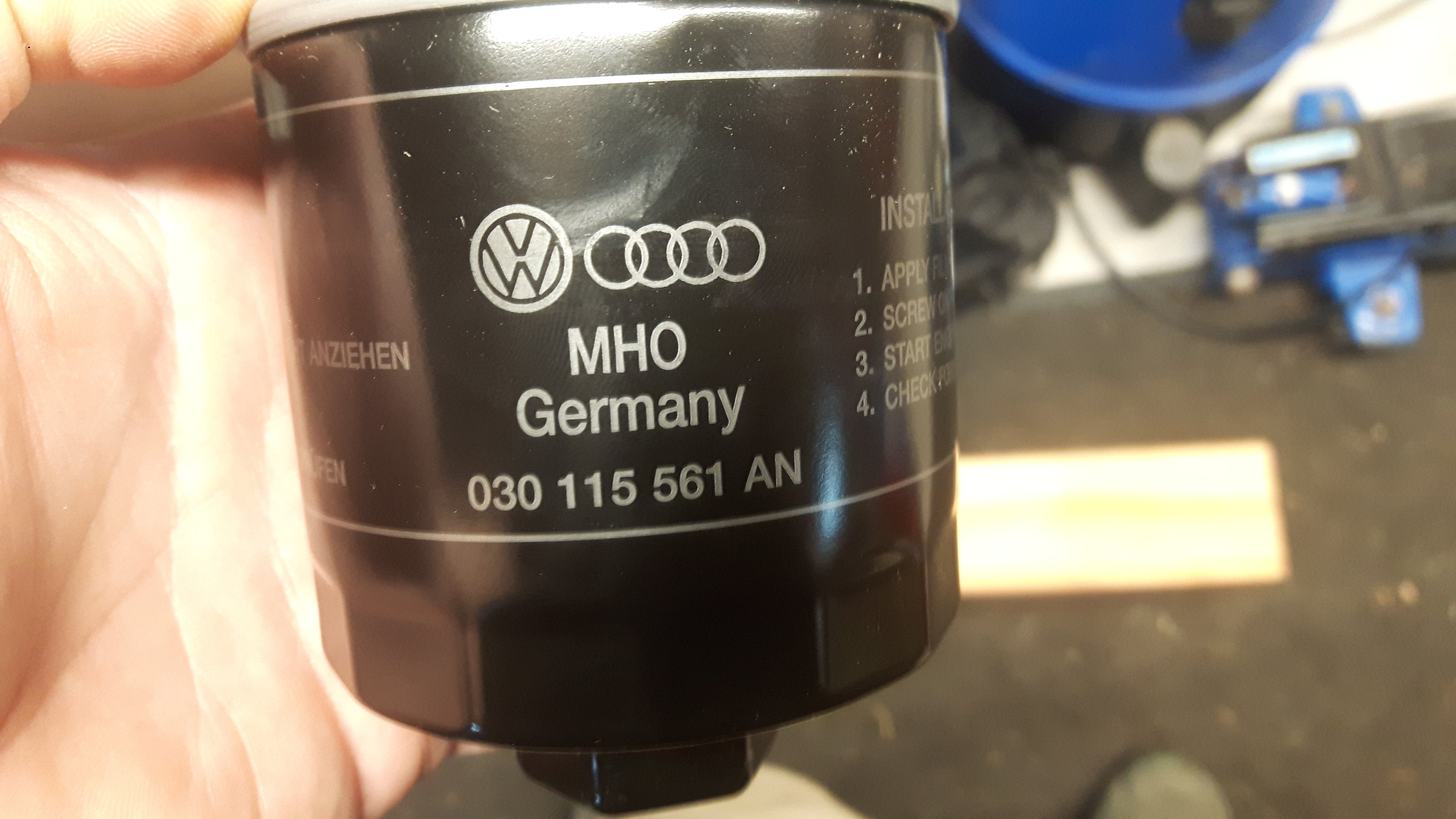

As I remembered:
451289641_2020-09-1718_08_03.thumb.jpg.7dc49b11e5439c78303d88ec1d3f3742.jpg2135713635_2020-09-1718_07_30.thumb.jpg.7901063fb17dc78ada13a99a05cdcb74.jpg
But when you think about, it's more in the interests of MHO that these filters never come undone accidentally/unintentionally than it is to make things easier for the technician/person who has to remove them at the end of their life. So it makes sense for them to err on the side of tight, but known tightness.
These filters are clearly designed to be used by the official dealer technicians. The fact it has a 'nut' on the end for the torque wrench and the actual torque setting is written on the filter. This also means you can easily put an air wrench on it for removal. Think MHO figured that in a professional setting a technician would have access to the proper tools required to tighten and undo them.
  • Sponsor
It's the standard genuine filter for the 16-valve petrols.
Of that i had no doubt :D

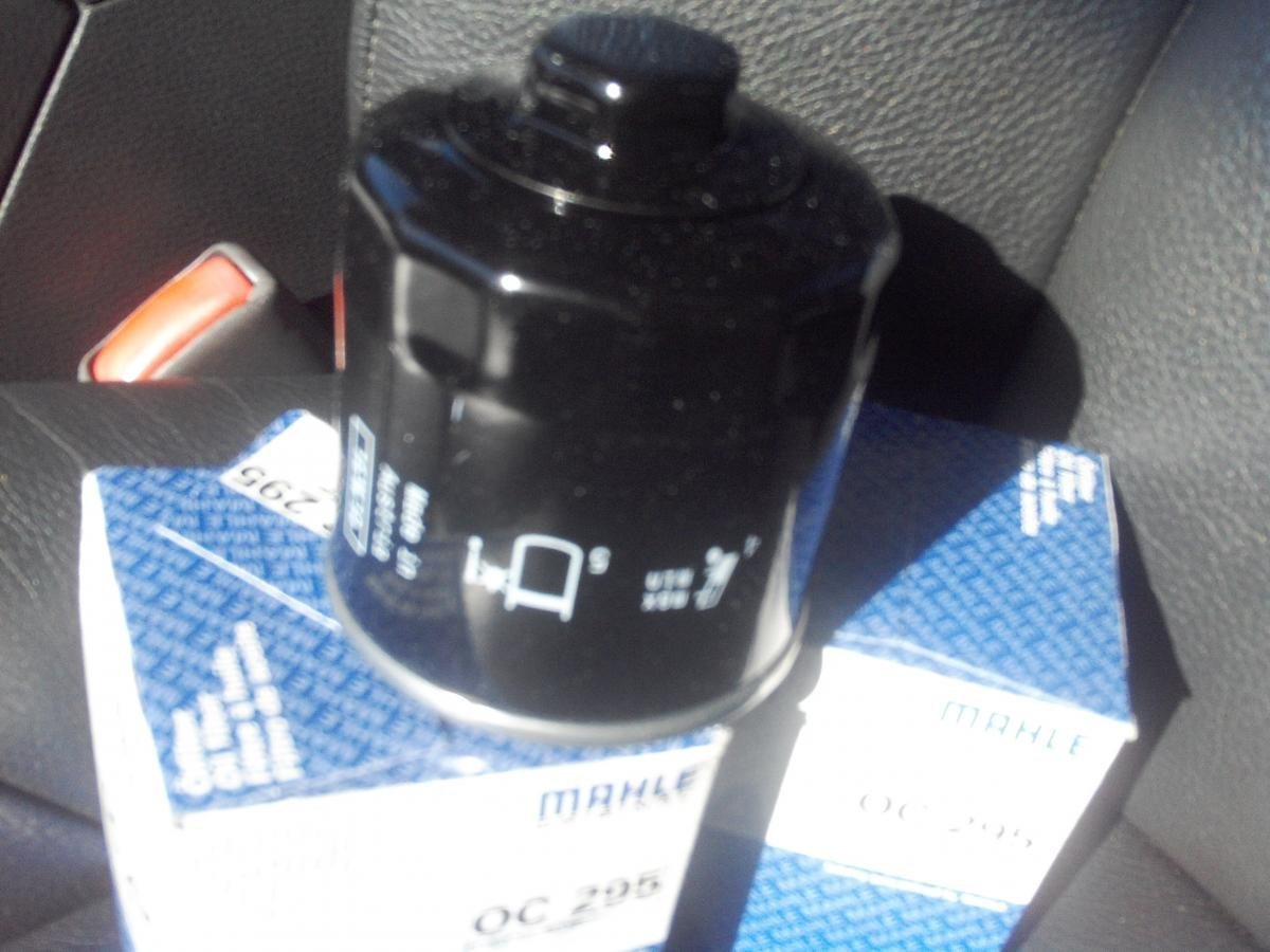

@Xsr
The filters like that are clearly suitable to be used by anyone doing an oil filter change.
The Mahle filters i get at my local motor factors are the same as the Black VW Group ones as shown.
The Silver VW Group ones are not the same as that.
I was debating it from a design standpoint. That it shows it was designed with an idea in mind. Not questioning who actually uses it.
  • Sponsor
I guess the 8v filter lacks that feature then? So Skoda's general instructions couldn't specify a torque.
