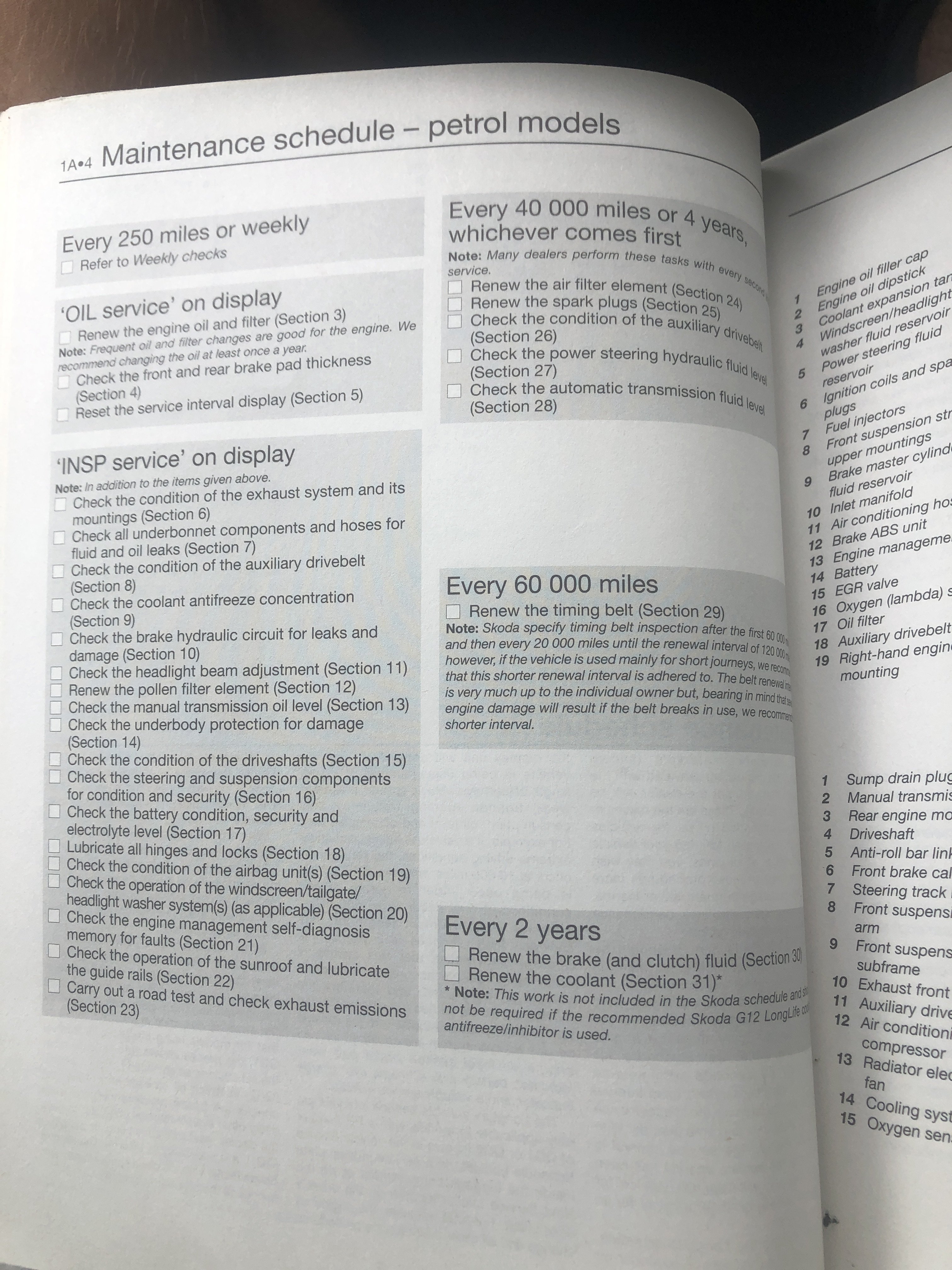

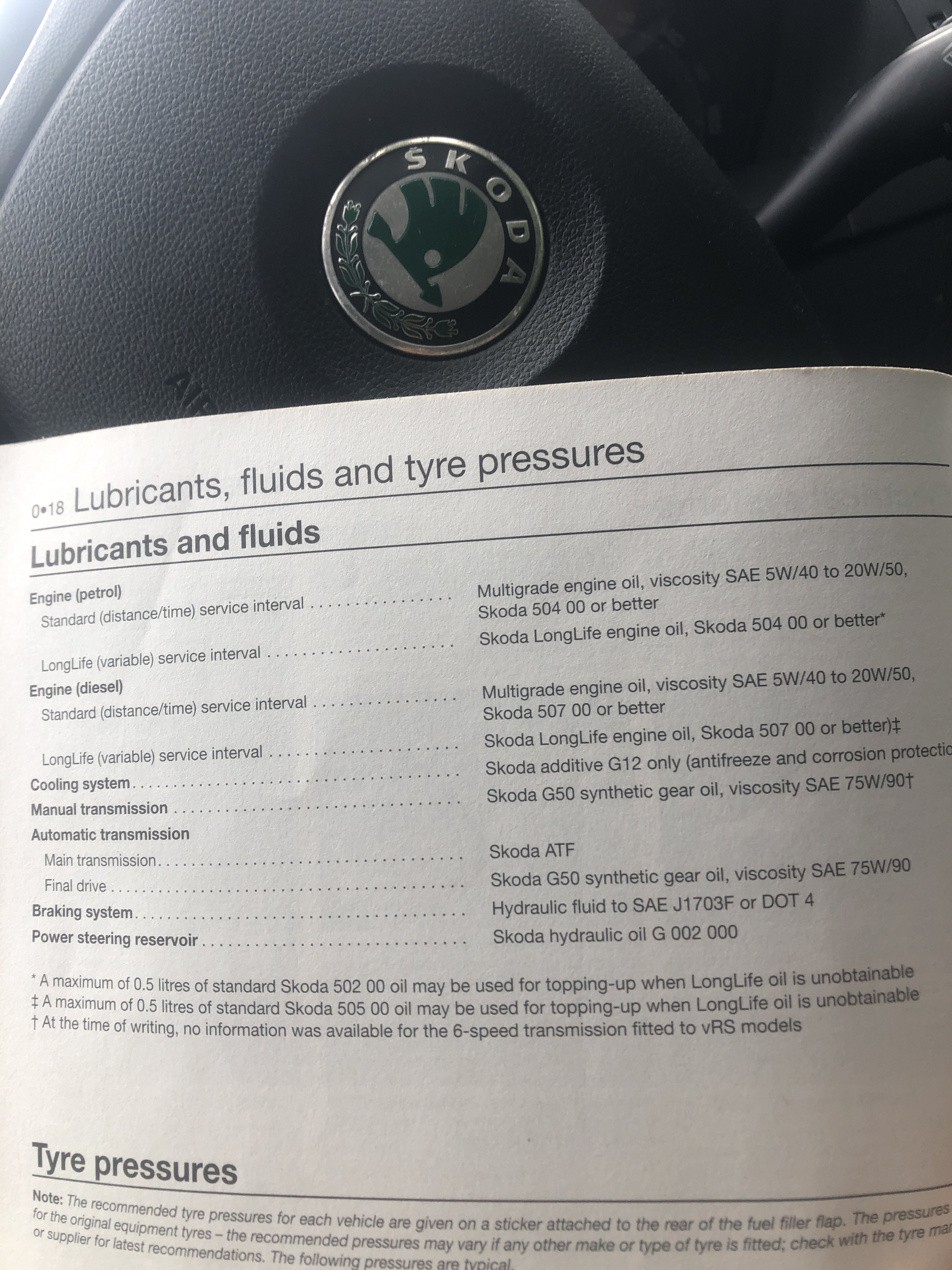

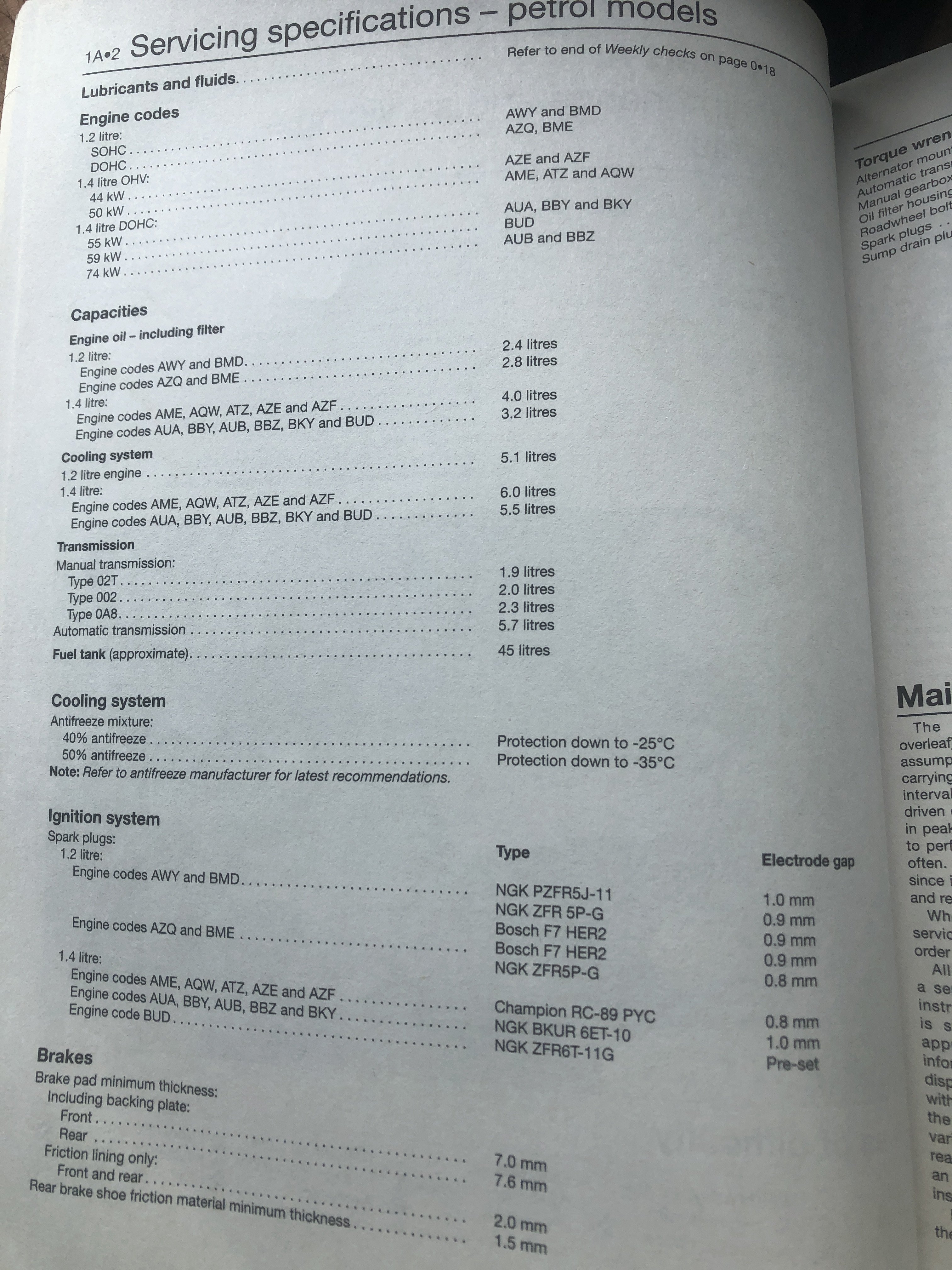

Don't shoot me but it really isn't that important on a NA petrol engine, far better to change it regularly, semi-syn is 10W40, when these cars were made that was totally acceptable, normal even.
I have the fabia owners workshop manual and I will show you
No pressure
Edited by Skrrrda
Forgot pic
There are a lot of 'oil fairies' on these fora, there are even 'brand fairies' who swear by one companies advertising over all others.
As Skrrrda has shown you, it really doesn't matter. Just change it according to schedule and you can't go wrong.

7 hours ago, Skrrrda said:
No pressure
Gosh, contradictory/inconsistent information in a Haynes manual, whatever next?
Show me an oil that meets or exceeds Skoda 504 00 or 507 00 spec that is within the range of the quoted viscosity pairings...
Not that either of those are the correct specs for these cars on fixed service schedule, but never mind.
