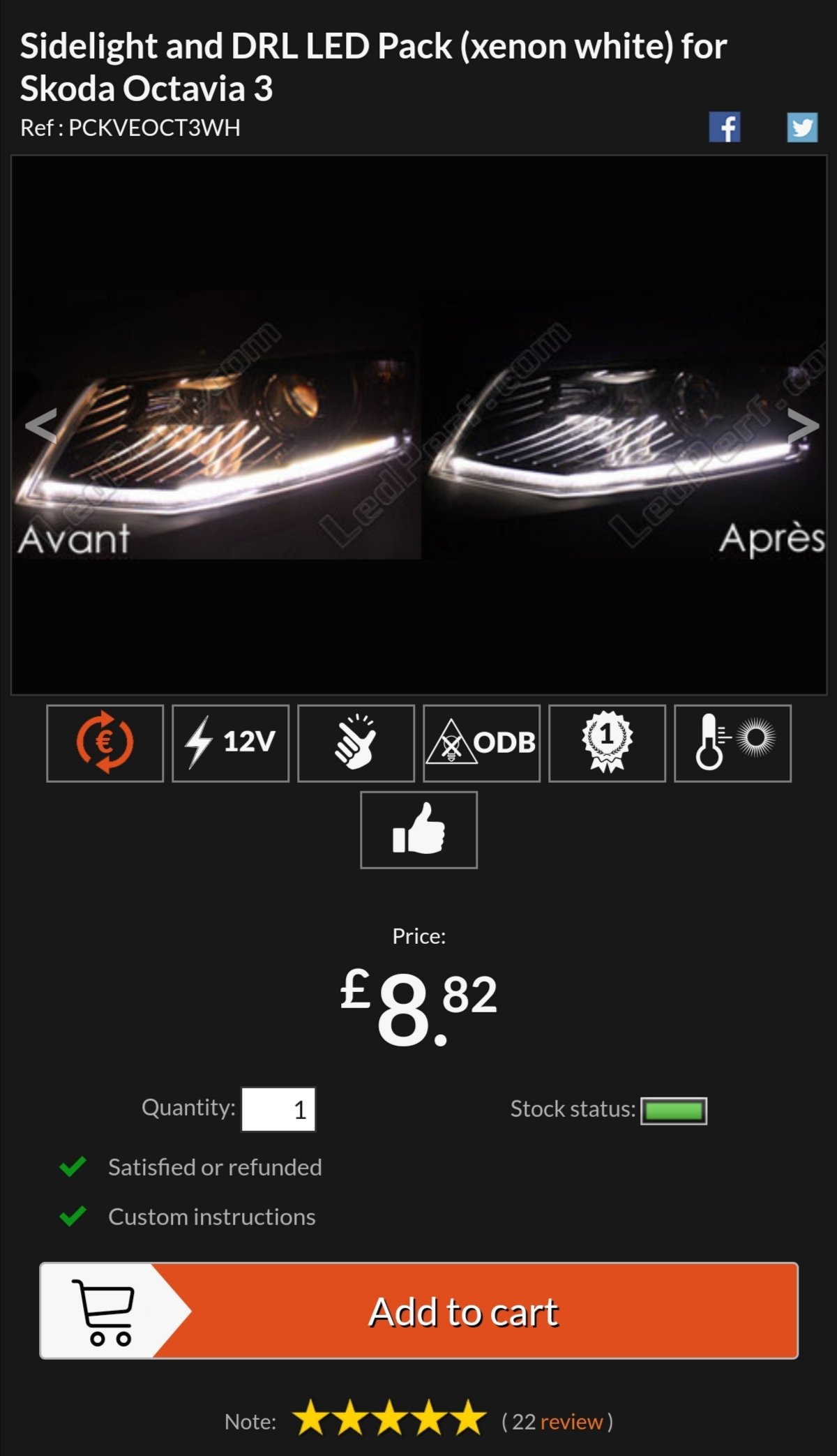

Is this the sort of thing?
https://www.ledperf.co.uk/pack-sidelights-led-xenon-white-for-skoda-octavia-3-5e-with-bixenon-afs-p-4950.html?gclid=EAIaIQobChMI7_Lph8nU6wIVybTtCh1uZA_AEAQYBCABEgLTrvD_BwE
My concern is that if you leave the crack you will just get moisture again. I think you will need to get the casing replaced if that is where the crack is.
Thats the ones i am looking for , thanks alot , yea as you state , need to change the hole thing , or can you just change the "plastic glass" front cover ?
