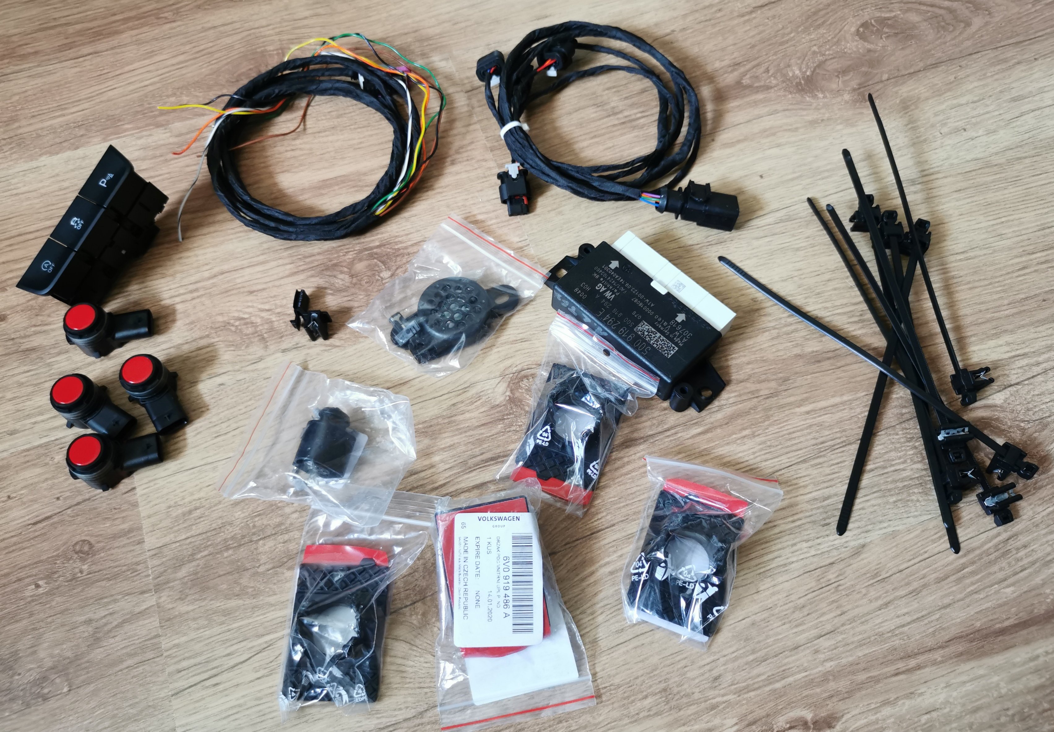

Hi Guys,
Anybody here attempted on Front PDC retrofit on their Mk3 Fabia?
I have the rears from factory and looking to get this retrofitted to my wife's Mk3.
Wirer (I believe he is on this forum) has done a great write up https://wirer.sk/f3_pdc-predok/
Trying to do this on a budget...getting the switch and PDC module (8K) are no biggie as decently priced on ebay.
Only big money is to get the wire harness. Kufatec do a kit.....
Would like to know if anybody here done this mod successfully?

  • 1x - 6V1 927 238 E - buttons
  • 1x - 5Q0 919 294 E - control unit front + rear sensors
  • 1x - 5Q0 972 718 A - connector control unit T18
  • 10x - 000 979 009 E - pins of the control unit connector
  • 2x - 000 979 009 E - pins of button connector
  • 4x - 5Q0 919 275 B GRU - front sensors
  • 4x - 5Q0 919 133 - sealing ring
  • 1x - 6V0 919 485 - sensor holder - left outside
  • 1x - 6V0 919 485 A - sensor holder - left inside
  • 1x - 6V0 919 486 A - sensor holder - right inside
  • 1x - 6V0 919 486 - sensor holder - right outside
  • 4x - 4F0 973 703 - sensor connector
  • 12x - 000 979 034 E - pin to sensor
  • 12x - 357 972 740 E - sealing rubber
  • 1x - 1J0 973 813 (3B0 973 813) - connect the engine compartment to the bumper
  • 6x - 000 979 132 E - pin for the connector connecting the engine compartment to the bumper
  • 1x - 1J0 973 713 - connect the engine compartment to the bumper
  • 6x - 000 979 131 E - pin for the connector connecting the engine compartment to the bumper
  • 6x + 6x - 357 972 740 E - sealing rubbers
  • 1x - 5Q0 919 279 - speaker for front sensors
  • 1x - 4B0 972 623 - speaker connector
  • 2x - 000 979 009 E - pin for speaker connector
  • 10x - 3D0 971 838 L - binding tape 4,6 × 200, 1-3mm
  • 3D0 971 497 B - bumper connector holder (not necessary, can be replaced by 3D0 971 838 L)
  • textile insulating tape

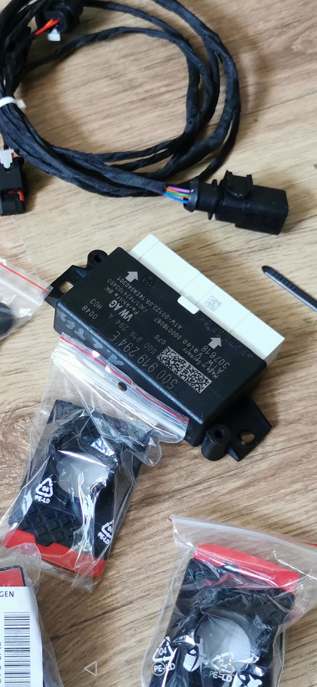

Thanks wirer so have I bought the correct unit then? 5Q0 919 294 E
This is the exact one I have bought....
The my photo above also shows the 294E. Well, I definitely have it adapted for Fabia 7K. So just mount it. It has happened to me twice that the promised 7K unit from Octavia came instead. Then it didn't work because the Octavia had 8K
Screenshot_20200916_103359_com.android.gallery3d.thumb.jpg.7e8c621e076065189240e9b773bb5dde.jpg
Thanks wirer so the 294E should be working in my Fabia 3 then :) Phew!!!
I thought I bought the wrong module :sweat:
I am following your tutorial here https://wirer.sk/f3_pdc-predok/ so hopefully all goes well

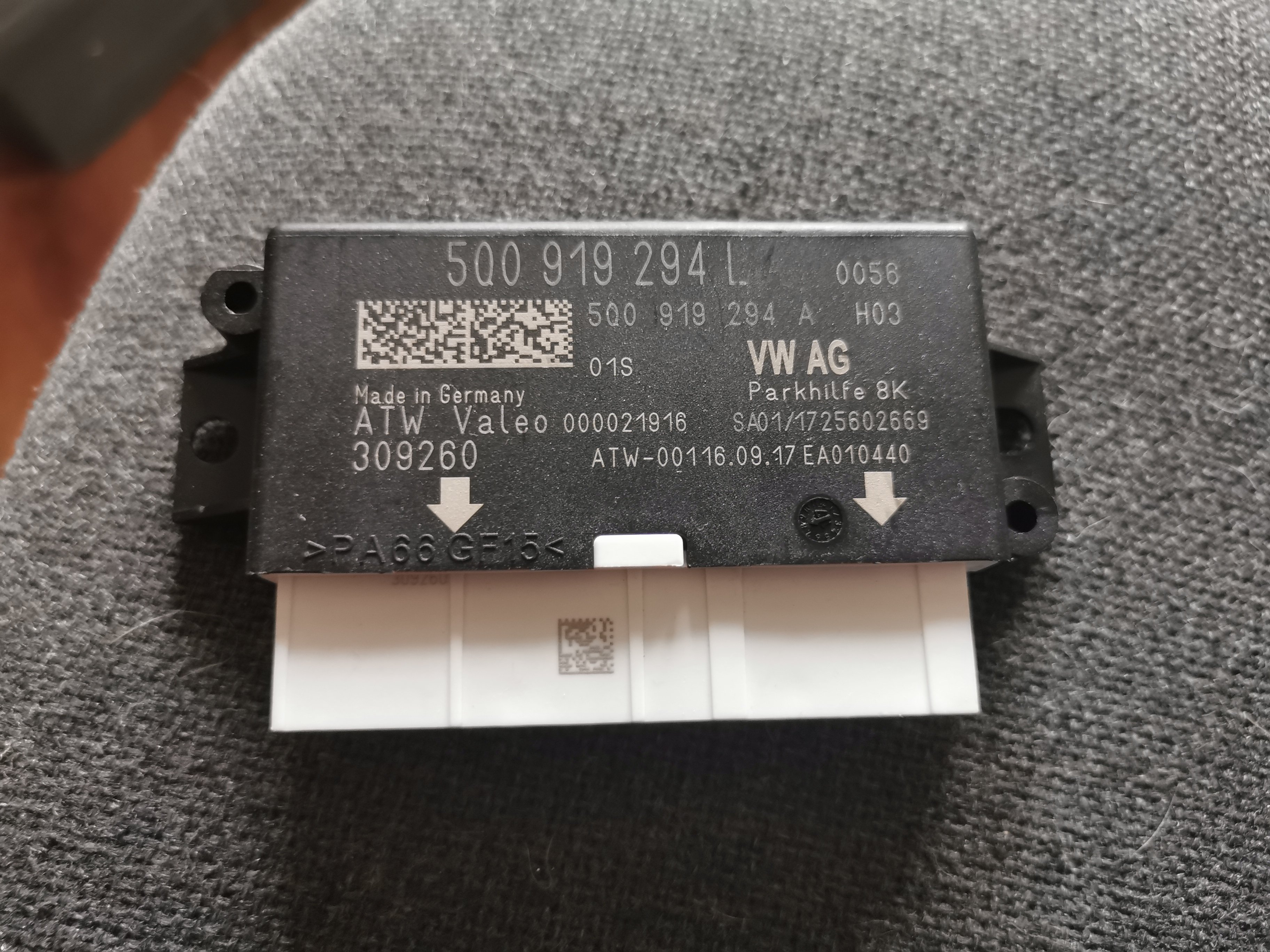

Ah, some people are using VW Group model platform designations like 8K to mean 8 channel, not good, a bit misleading, I'm glad that you have bought a suitable one, ie a 5Q version as long as it is only looking for 3 rear sensors!
Edit:- one completely insignificant comment, Audi offer I think 3 different colours of sensor seal - ie you can pick one that best suits the car's body colour, I think BLACK and WHITE and NEUTRAL, my wife's VW Polo is silver and VW, like Skoda only offer a single colour - BLACK!

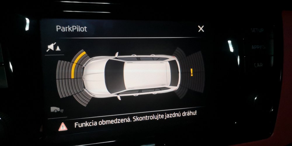

I also found a photo where an 8K unit was mounted in Fabia 3/Rapid - it reports an error in the back
Awesome find wirer :)
Let's hope 5Q0 919 294 E works in mine :) I am sure it will as it works for you.
