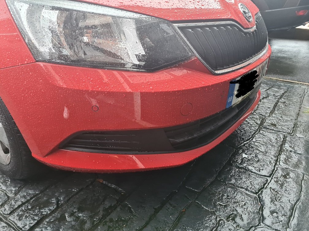

The finished product :)
@wirer thank you so lets hope the new module doesn't need adaptation. I really hope it works :( The wiring harness I bought from carsystems was the best. Everything worked from the start go :)

Ok I have success, so finally got the new module 5Q0919294K  delivered which was from a 2016 Fabia (luckily) and it was basically plug and play (no coding needed).
So everything works as it is meant to. Lesson learned make sure module is from same brand and if possible same car :D
