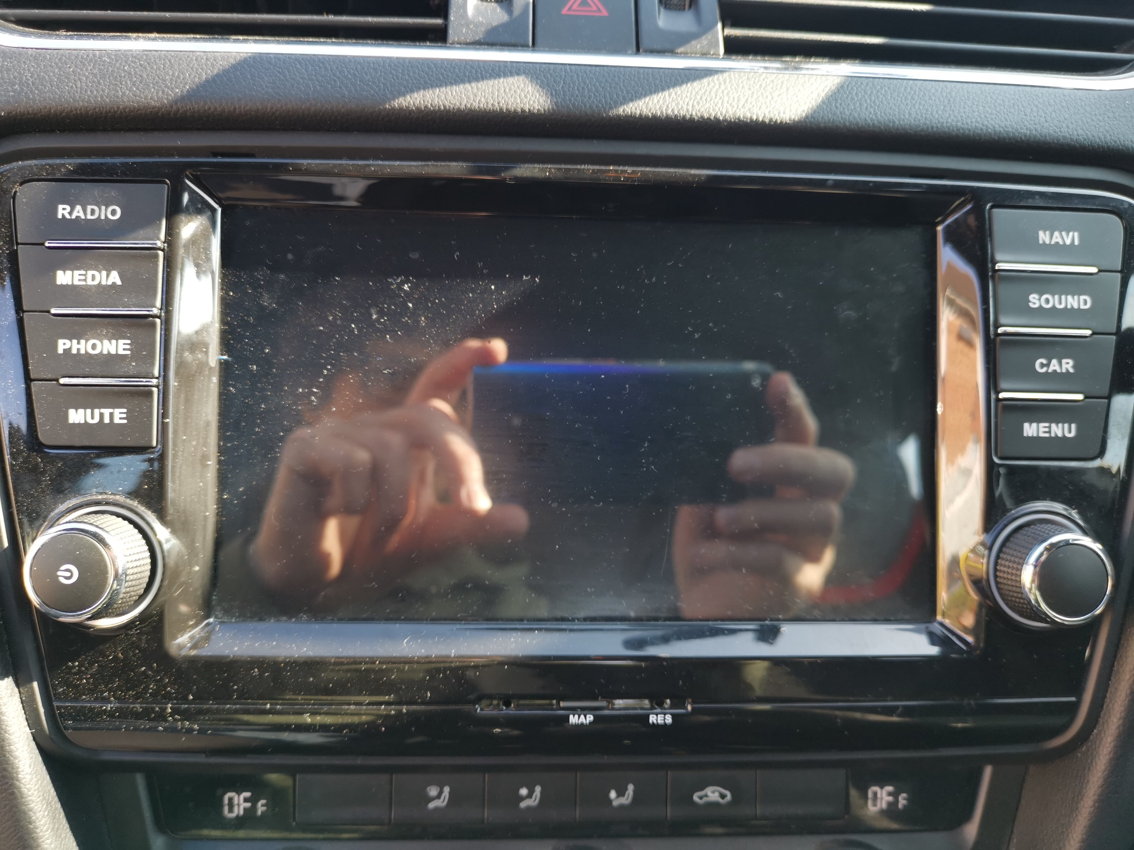

Only bought the car from a main dealer recently (2 months ago) - 2014 Mk3 TFSI vRS
Not even sure what model of screen it is (see photo).  It has DAB, Nav and Car information.
I have searched the internet for solutions but nothing has worked.  It was fine and then suddenly went off yesterday and will not turn on.  My steering wheel can still control the audio options and I can see them on the maxidot - i.e. change stations, inputs etc - but I can't see any of the screens car information or change modes or toggle anything on or off.  The volume control still works - and I think the screen is registering inputs because I heard a bing when I touched something on the screen - god knows what I've pushed....
None of the buttons will produce any picture.

Not seen a screen like that before with the map and res bits.  Also the font looks slightly thicker than standard.  I suspect its an aftermarket screen or even a standalone unit.  What do you have in the glovebox?  A pic would help identify it.
Edit:  Also original screens tend to say NAV not NAVI.
Hi - it's DVD/CD player I think - I've not used it.  I'll get a photo.
The glovebox unit is the main headunit.  The screen is usually just a screen.  Bit like a PC and monitor setup.  There are different models of unit.  I would suggest that the screen is not original and identifying the main unit will help with this.

That could be a mib1 bolero. In which case the screen does not match as it is too big.
@SashaGrace any idea what's going on here?
That’s a MIB1 Bolero in the glovebox. Screen is aftermarket so I couldn’t say what’s up. Take the screen out and see what’s what. Is the ‘screen’ a standalone unit or is there some connection to the radio?

From factory the screen and radio are separate units. Some of these aftermarket screens have a bridge between the old radio and the screen, some plug direct into the old radio loom and the radio you have now is just in the glovebox as a placeholder and isn’t connected to anything. The screen you have is an Android based one so I would suggest that you try to get a cheap Bolero screen, plug your old radio back in abs see what you have, isolate the issue to the Skoda stuff or the aftermarket stuff. Looks like the aftermarket radio has just given up.

A bit of an update to this....  I contacted Car Audio Medics and they informed me that the unit is a cheap Chinese copy and they have no access to spares or replacement parts - so it's finished.
