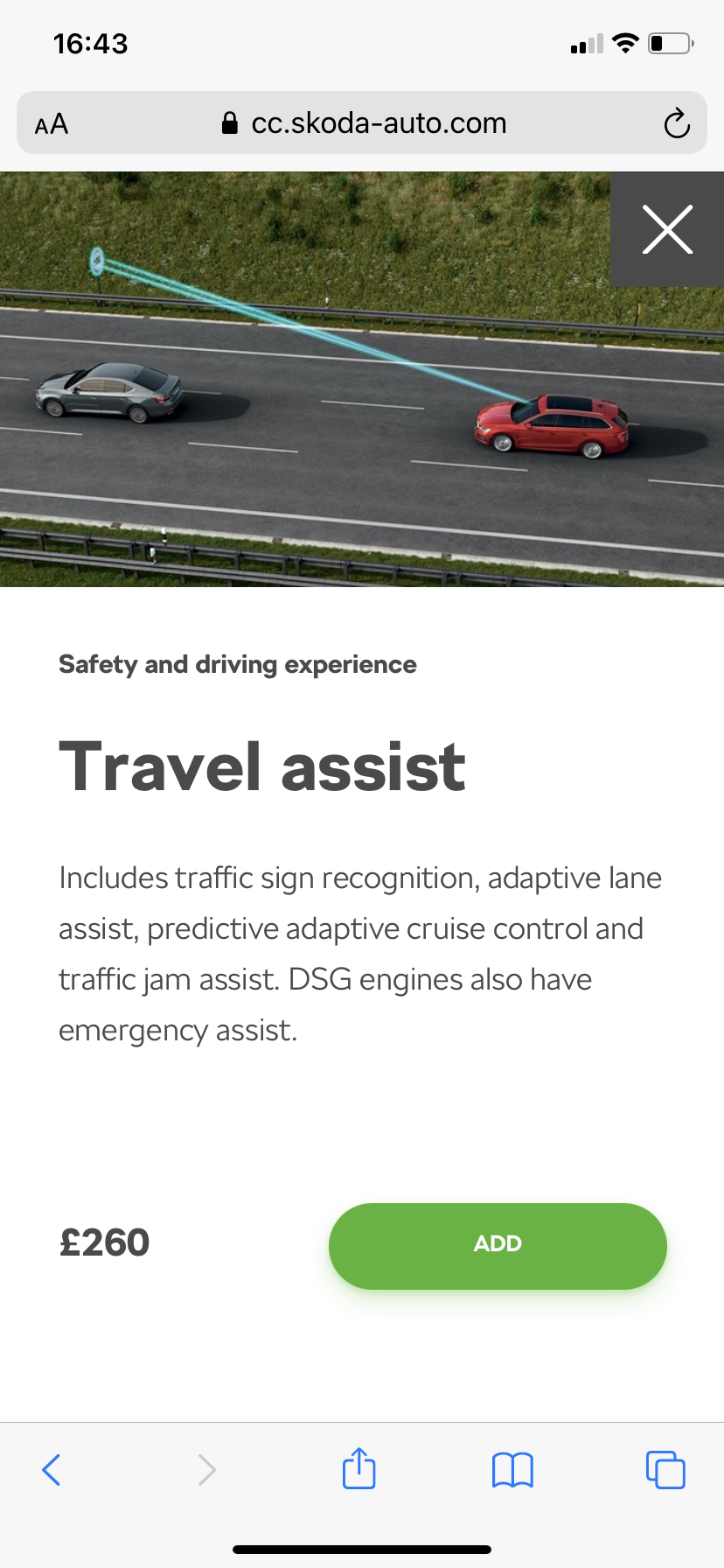

Traffic sign recognition is an option. Part of a pack that comes with lane assist and a heated steering wheel. Did your car come with it spec'd?

I’ve specified a Octavia with the heads up and travel assist so it will be interesting if the traffic signs come up as it is mentioned in the description for travel assist. I’m not holding my breath though...

In the UK at least you have to have the travel assist option in order for the HUD (and sat nav) to show traffic signs.
Err no we don't. It's only on the Sat Nav and that's historic when the map was produced, not dynamic, which can lead you into trouble as they may not be accurate. Another misleading ad from Skoda

My point was that I think it’s to do with whether you have the traffic sign recognition feature which is in the traffic assist option in the UK, if you have that you should have traffic sign recognition.
Can’t be regulatory because plenty of cars in the UK have this feature and I drove one recently.
