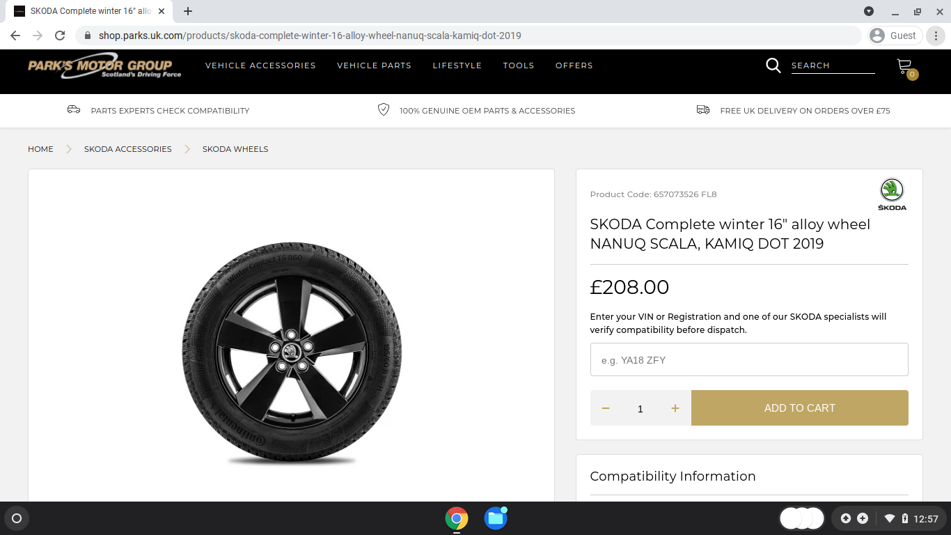

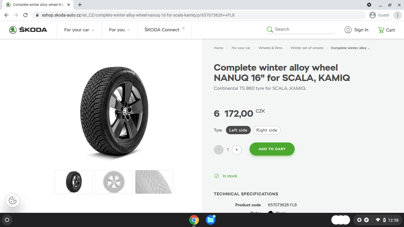

In the Kamiq brochure listed under accessories is 16" Nanuq alloy wheels with winter tyres at £555.00.  They show as suitable for the S, SE & SEL, but not the Monte Carlo.  Not sure why as I assumed there was no wheel (except the design) or suspension difference.
Probably a good value option compared to swapping tyres.
£550 for 4 would be great.
A Scottish Motor group has them at £208 each  wheel/tyre.

The Continental TS860 winter tyre in picture in second example, has been replaced by newer TS870 in size 205/60 R16, so anyone ordering should check the specs.
There is still a TS860 S (the high performance sport version) made in that size
