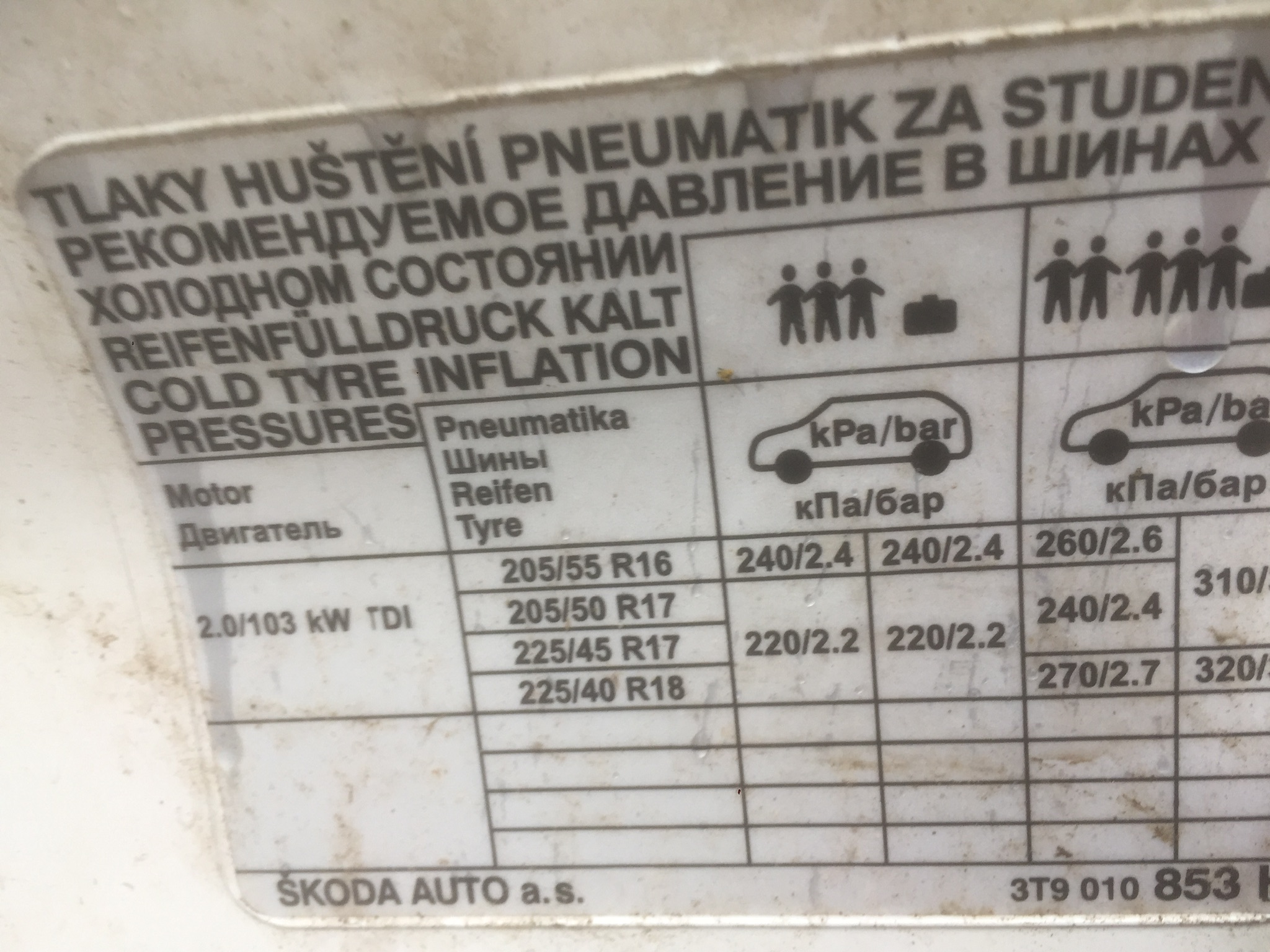

Yes, of course: the summer tyres were Continental 225/40R18 (OE fitment ) running ar 2.2 bar, the winter tyres are Yokohama 205/55R16 at 2.4 bar. I checked the pressures were exactly as per the recommendations myself.

See above. I have checked, and the width is indeed reduced from 225 to 205, so about a 10% reduction. The running pressure for the 16” tyre is also higher at 2.4 bar (as opposed to 2.2 bar for the 18”). The car runs well on the winter tyres, they are certainly quieter (due to the higher aspect ratio I think). It is easier to spin the front wheels with them, particularly in the wet, which is unsurprising.

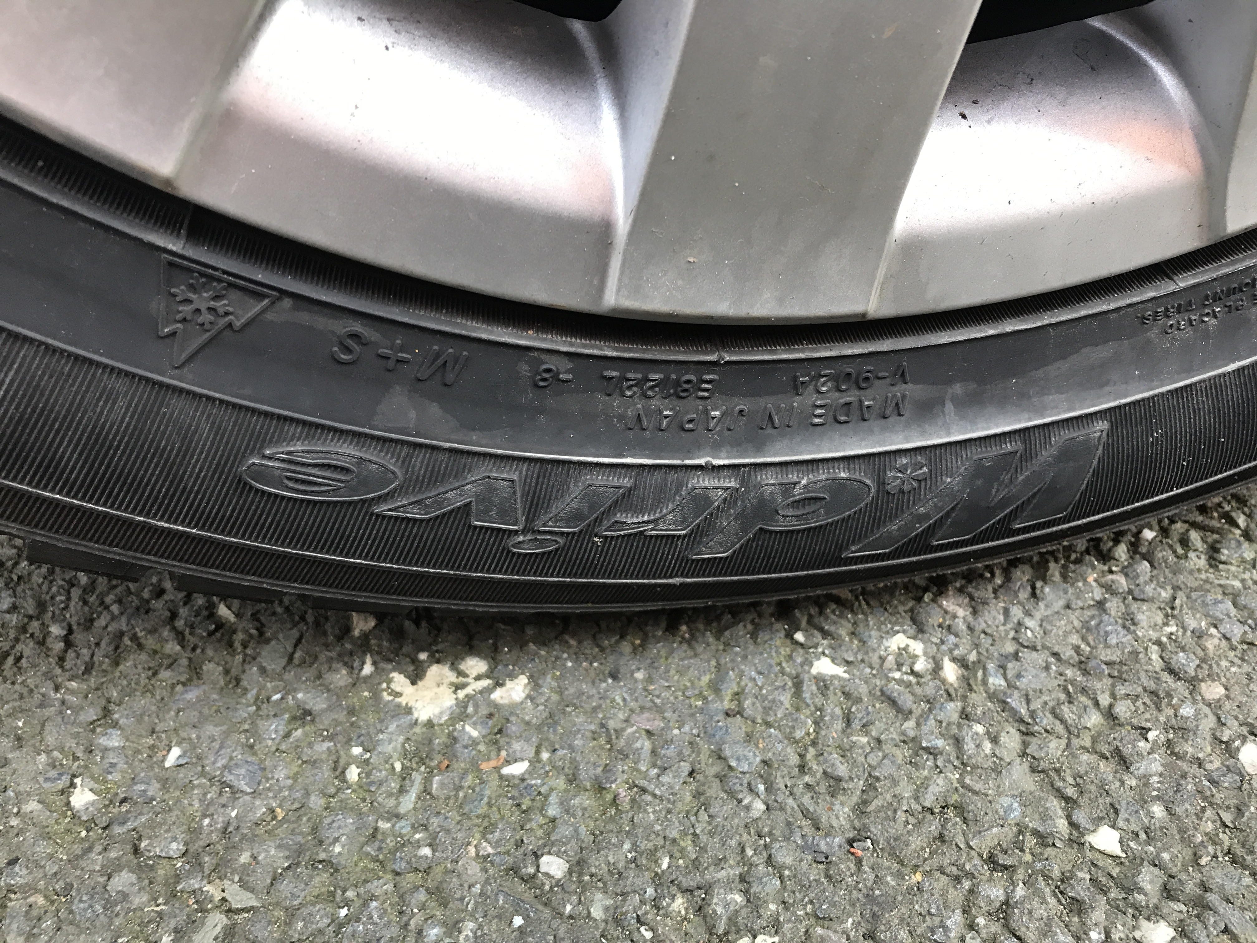

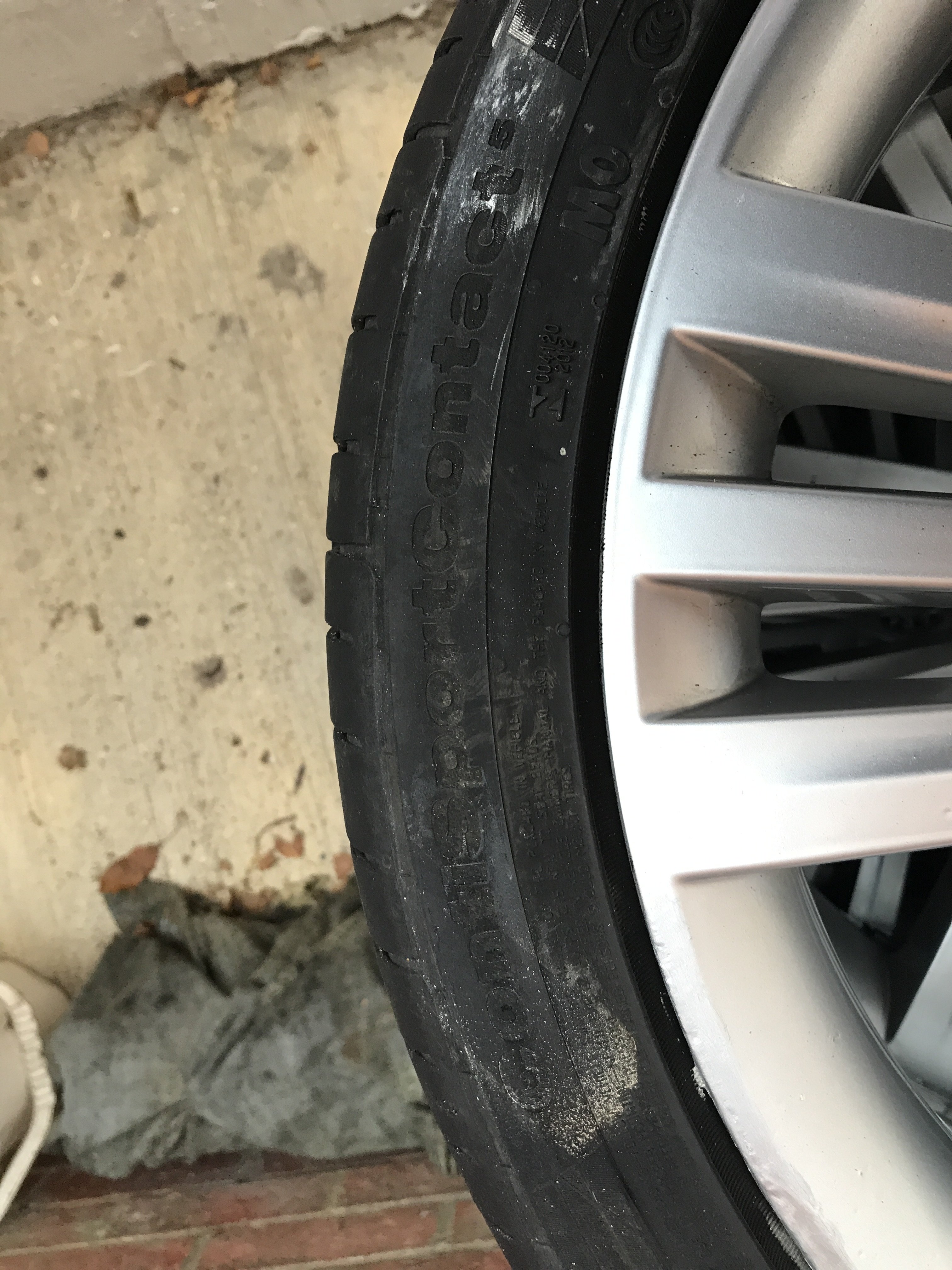

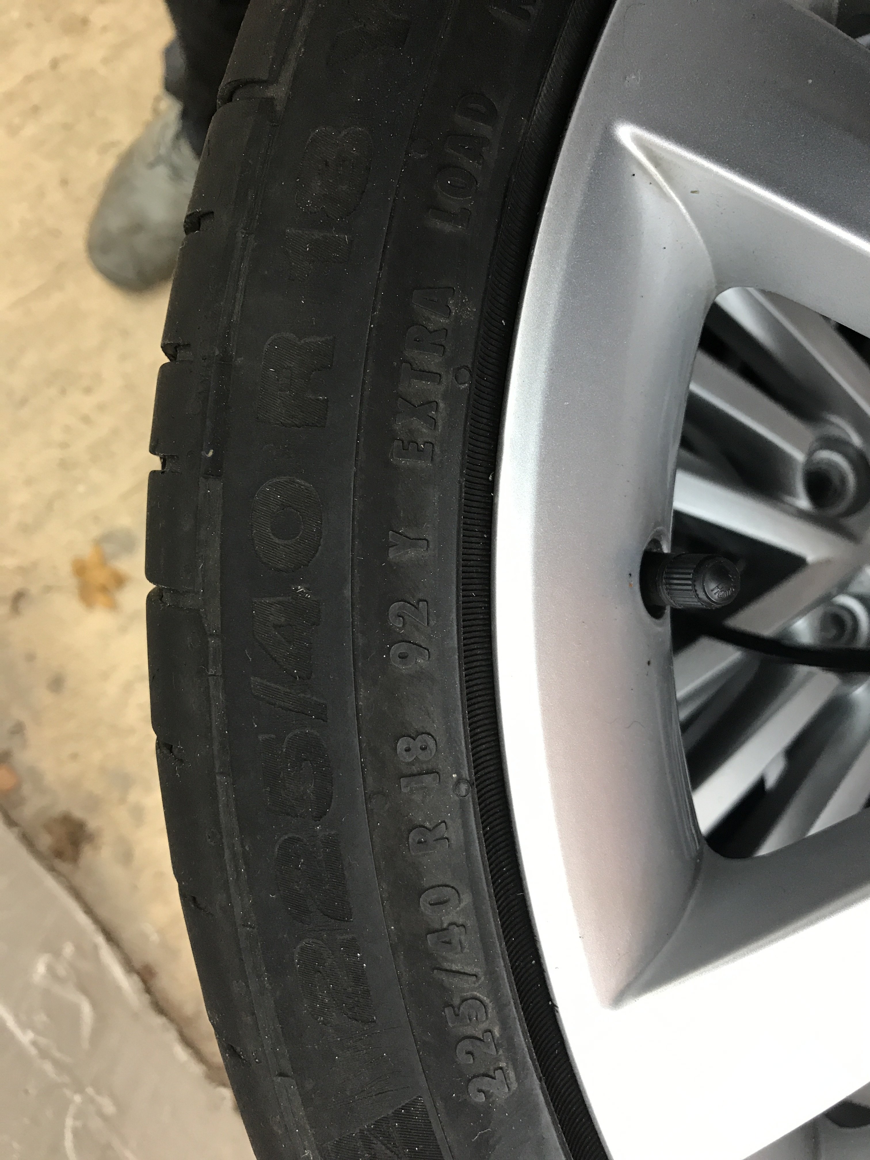

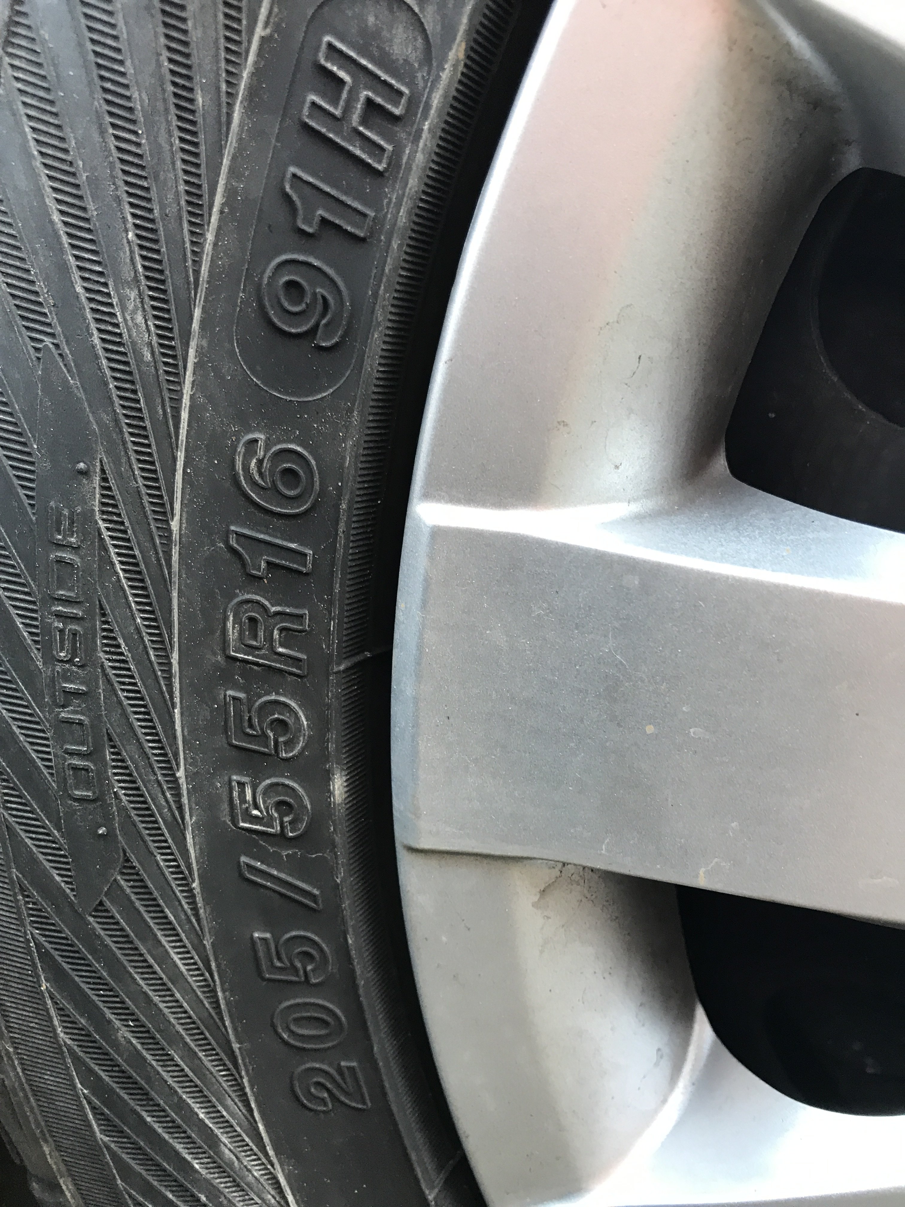

Okay, here are some photos of both tyres, the Continental (18”, on an alloy rim) and the Yokohama winter (on a 16” steel rim).
I measured the consumption using the onboard computer. It was on a route I do quite often from Corby to Pentney (near King’s Lynn) - about a 140 mile trip, probably half dual carriageway and half good A roads. I normally get just about 50 MPG (maybe a tiny bit more) with the summer tyres, driving exactly the same way (60-70 MPH, just me and the dog in the car, full tank of fuel, no stops) gave 58 MPG on the winter tyres.
Akan
Edited by Othen
Spelling
Thanks.  I can see that the Contis are SportContact 5  92Y  MO Extra Load
and the Yokohamas are W.Drive 91H
