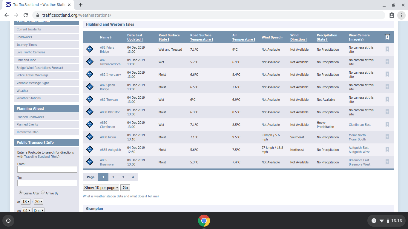

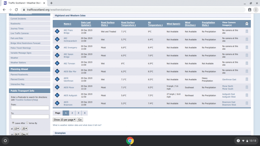

Simple weather factoids concerning driving.
When you listen to the weather people you might well hear the temps in towns and cities.
Towns and cities tend to be where the weather is not at it's severest.   Like near water, sea, rivers, lochs.
Apart from a few places you build, villages, towns and cities & airports where the weather is generally warmer and least prone to fog or freezing fog.
Then they give the Air Temp, that is taken about 2 meters above the ground.
So you want the 'Grass Frost', or Ground temp.    That is what the tyres are driving on, the ground / road.
The Grass Temp / Ground Temp might be 5 or 5 degrees C below the Air Temp.
& the Road temp even lower when measured by a sensor.
Hence you put down salt at around 6*oC when there is moisture there to have turned to brine.    Black ice might occur on roads when the air temp is above freezing temperatures given by the weather people or even 'Ambient Temp Sensors' on vehicles.
As the sun goes down it may not take long for the road temp to go below the air temp by quite a few degrees.
With a frost the road can stay at a low temp when the daylight / sunrise has happened.
A shaded part of the road still moist from the day or night before can be where the Black Ice will form even if the air temp near is high.

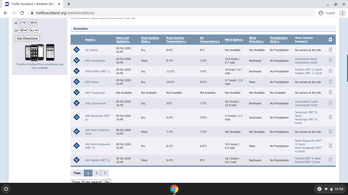

Fiddes just above Stonehaven on the A90 will have some of the lowest 'recorded' road temps quite often in winter without having the lowest air temps.
Bottom an example from l lunch time December 2019.

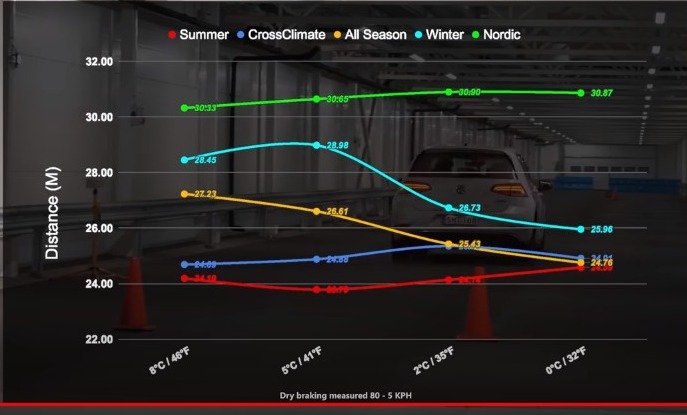

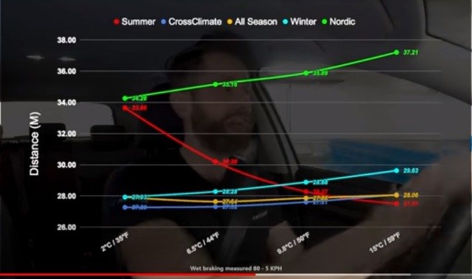

tyrereviews.co.uk did a very interesting test of wet and dry braking at various temperatures.  Summer tyres are fine at low temps IN THE DRY.
On wet roads their grip drops rapidly below 10C.  https://www.youtube.com/watch?v=bKtnczk8Mxk&feature=emb_logo
