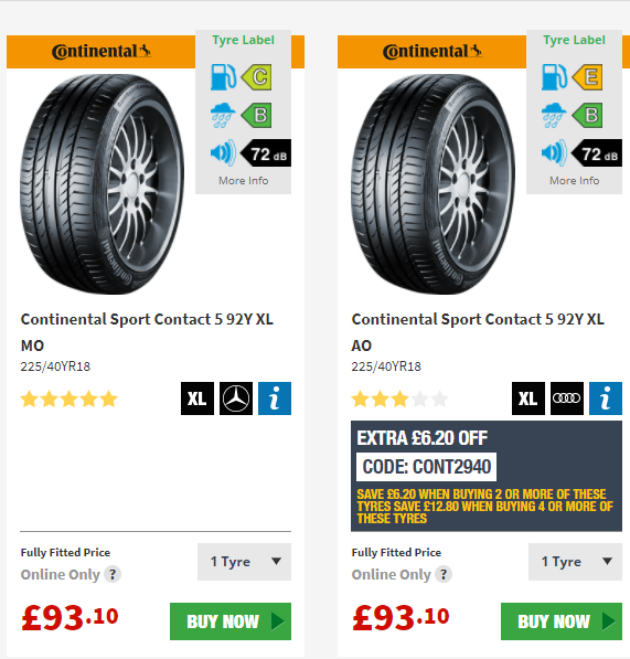

This is interesting, the local F1 Autocentre (where I normally buy my tyres) lists the Sport Contact 5 in both MO and AO flavours... note that the Mercedes version gets 5 stars and the VAG only 3 (which I think says more about the review system than it does the tyres) - see the photo.
Even more interesting are the fuel efficiency labels; one is 'C' and one is 'E' - how is that possible?
Oponeo confirms the labels for MO and AO1
Why does F1 Autocentre put a 'Y' in the tyre designation?
Edited by farty
Are they not speed rated as a Y so up to 186mph?
I noticed that about the fuel efficiency labels - which is one of the reasons I thought the rating system was not up to much.
I don't know enough about tyres to understand what the 'Y' means.

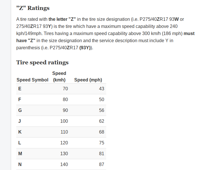

There's a simple table of what the tyre speed rating letters mean here.

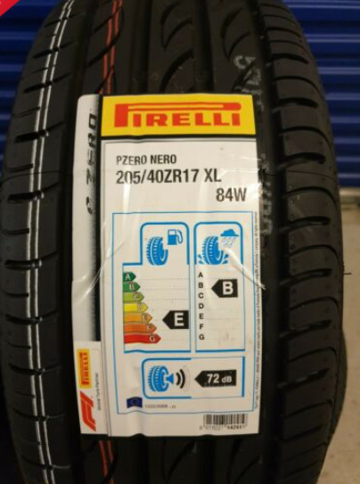

But that does not explain the 'Y' in the middle of the tyre SIZE designation in Ofhen's post at 07.34 today.
Originally the letters increased with speed
however as cars got faster and tyre technology improved some additional letters were used for some intermediate speed limits.
There are now such a large amount of tyre sizes that manufacturers often find it easier to make just a single (high) speed rating, than multiple speeds for a size.  So you might have a 160+ mph rating on a car that only does 115mph
That's the F1 Autocentre showing the Load Rating combined with the Speed Rating.
Load Ratings
The clue is it says 92Y XL - which means the tyre has a Y speed rating (186mph/300km/h) and a 92 XL load rating (630kg, higher than a non-XL version of the same tyre due to stiffer sidewalls).
Load Ratings
You did not read my post carefully.  I'm on about the SIZE designation 225/40YR18.  I asked why this number has a Y in the middle.  The previous explanation covered a Z.
