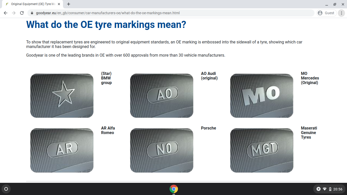

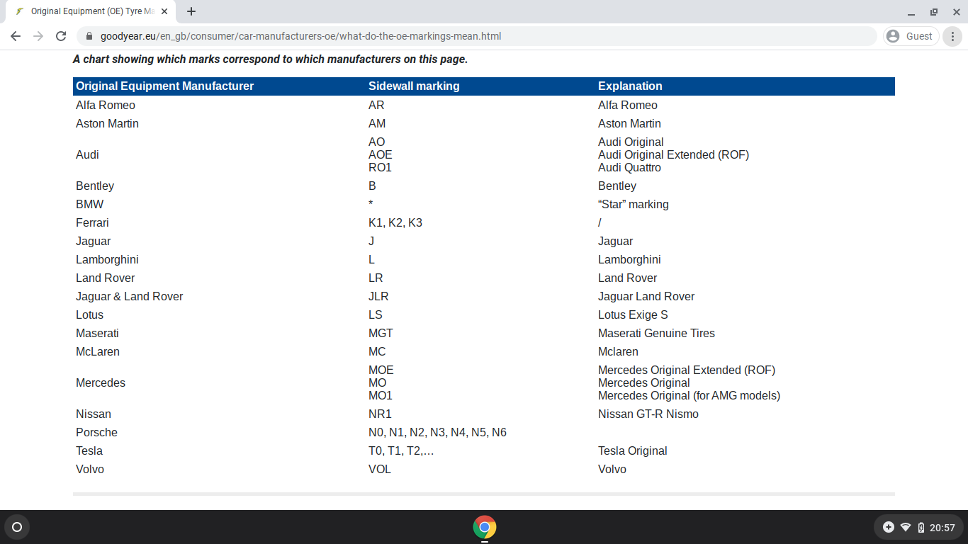

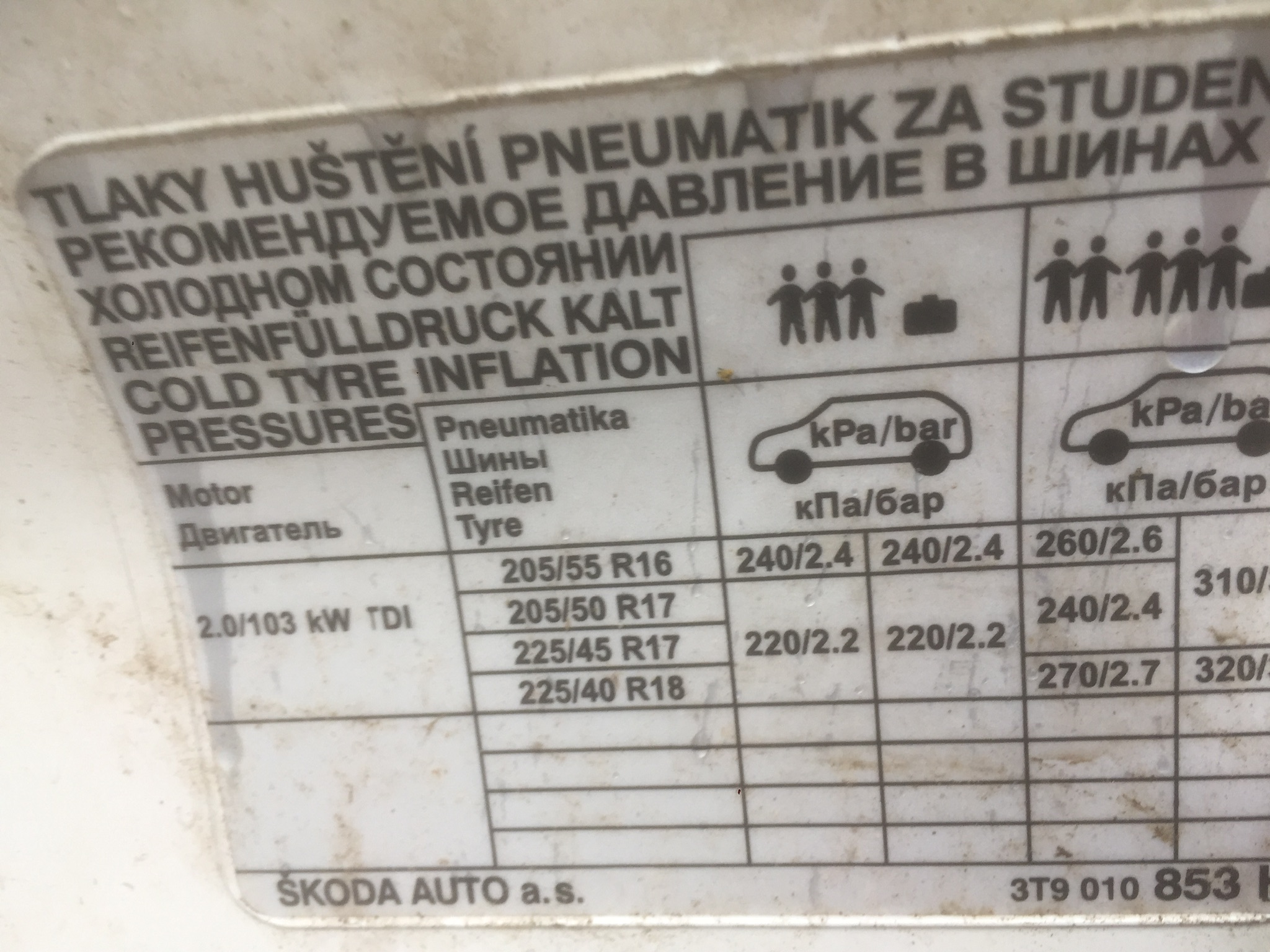

That size is not approved for his car; look at the photo he posted.

Hi,
Thank you for that, but it seems (to me) unlikely that the car should have come with 225/45R18 tyres when the sticker inside the fuel flap lists 225/40R18 (see the photo below). I’ve owned the car from new, it has had a few new tyres over the past 7 years, but I have always had them replaced with the original size.
I think you must be mistaken about the 225/45R18 tyres - I have no idea about the MO bit, the tyres would have been supplied by a reputable garage either to replace a worn out one or a puncture. Does it make any difference?

Ah, that was just my fat fingers typing on an iPad, it should say 225/40R18.
Do we agree that is the right size for the car?

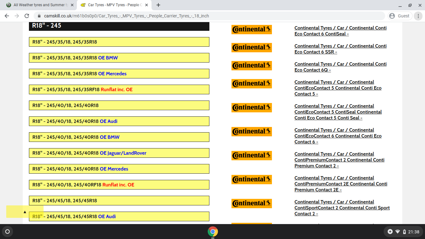

Go to https://www.camskill.co.uk
  You will see the tyres showing the car manufacturers for the same sizes.

Some people want exactly the same tyres that the car came with / exactly the same tyres all round.
In certain cases having the correct size but not the correct manufacture marking can do damage to the car.
We had one car where we advised them NOT to fit the tyres they had ordered.
This caused a £5000.00 repair to be needed on the car. :o
This is not the case with your car.
Thanks, AG Falco

Here are "Mercedes OE" tyres listed on Camskill in the 225/40R18 size. You will see your Continental SportContact 5 tyre on this list.
https://www.camskill.co.uk/m61b0s5056p0/Car_Tyres_-_MPV_Tyres_-_People_Carrier_Tyres_-_18_inch_R18_inch_-_225_40_18_225_40R18_OE_Mercedes
