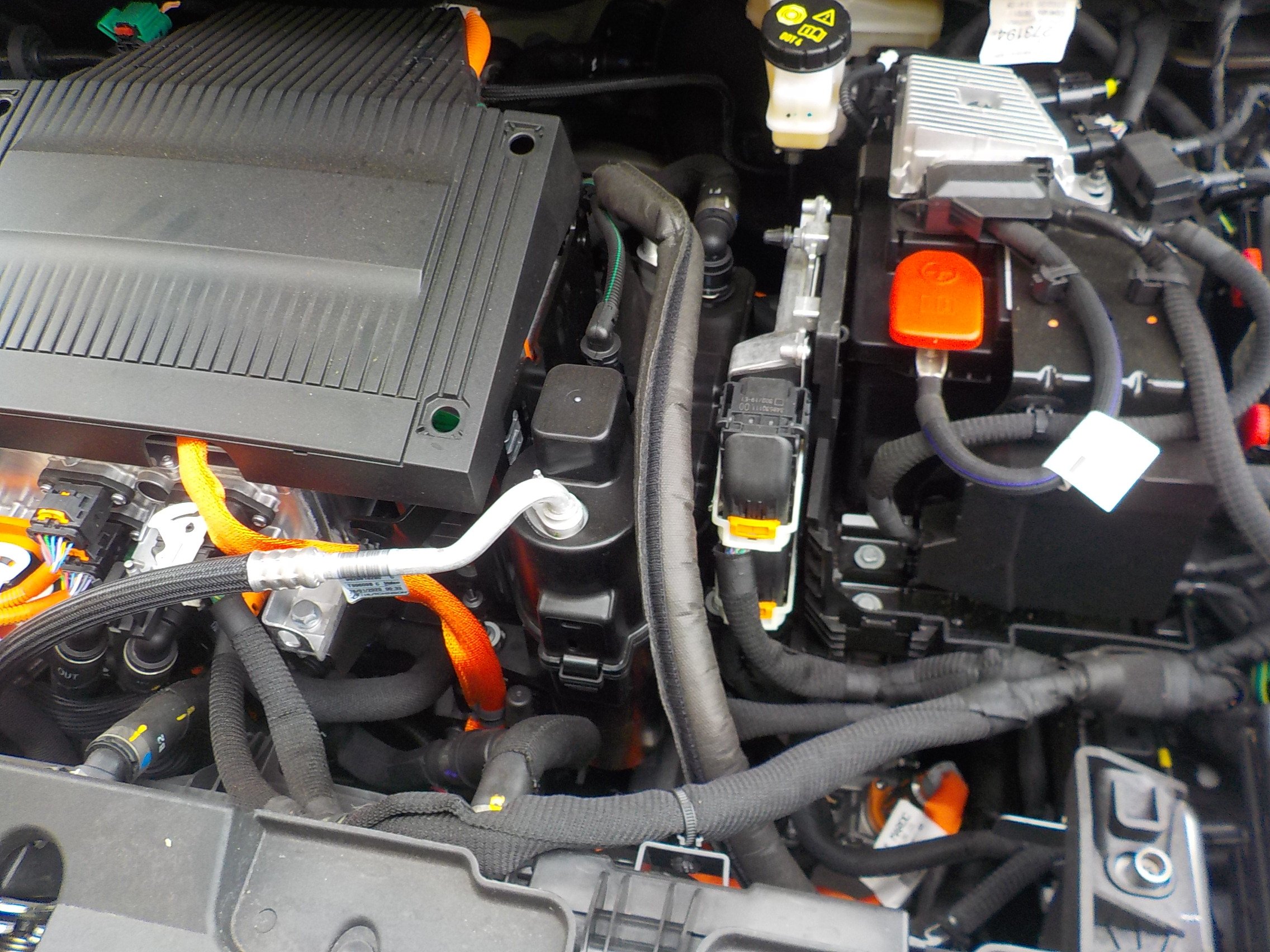

The EV's are coming with 8 year or more warranties on the battery packs and the % left in them after certain periods of time, and the early EV's are 10 years old now and going strong.
Even getting the rust dealt with while the batteries are doing fine.
They do need the standard battery as well though, so they might only be good for 5 years or so.
