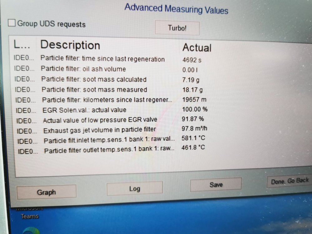

It's doing lots of regens. For example i go for groceries (5km road) the car is in regeneration... I always wait the car to finish the regen. When i return home the car is in regen again...
I bought the car 2 weeks ago. I have a vcds and no errors. The regen starts at 24g. No oil lose...

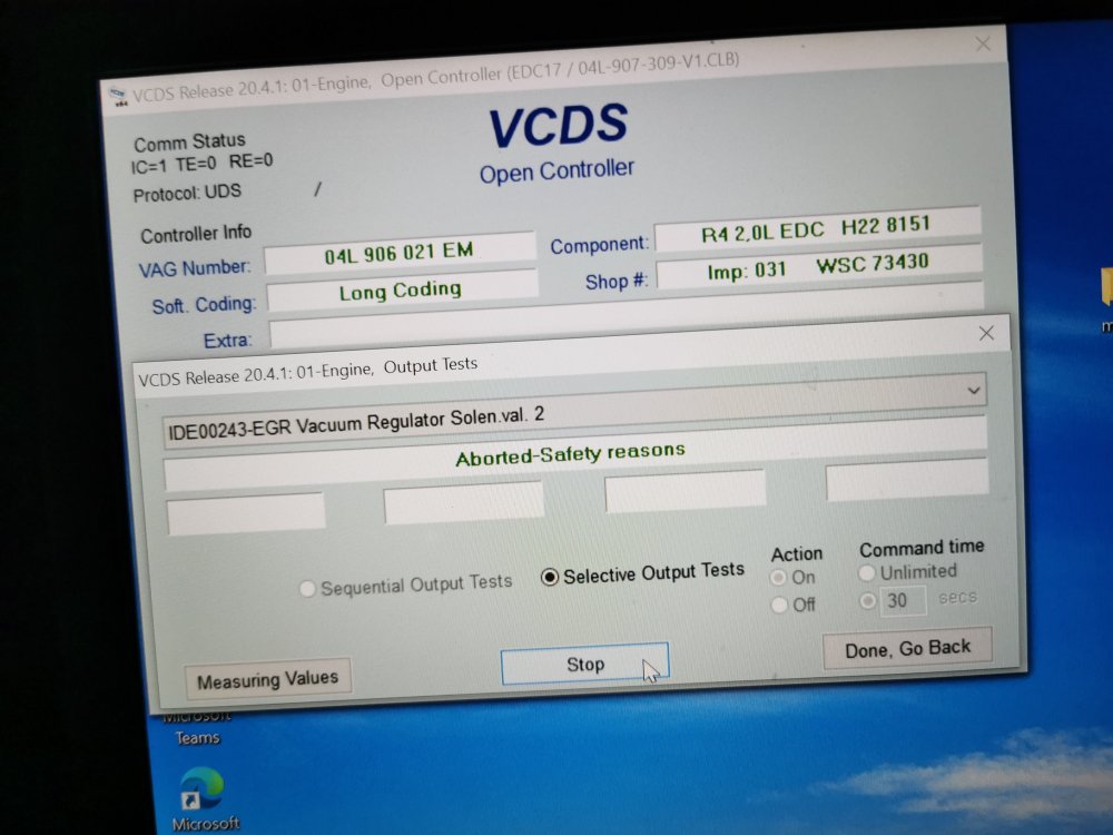

I' ve noticed something strange with the egr vacuum regulator solen.val.2 when i try to do an output test with vcds (aborted safety - reasons)
The actual value of the egr solen val. is always 100%
The value of the low pressure egr valve fluctuates depending of the acceleration, and the test is ok with it.
In 2 weeks i drove it for aprox 3000 km, and first thing i've changed the motor oil... Now with vcds the oil has poor quality.

Have you tested the EGR valve as there is a test on VCDS that checks the operation of the valve. I am not familiar with VCDS or where the test is but it should be on the 01 engine control unit.
i did. the car has 2 egrs. one is low pressure and the other high pressure. the low pressures test was sucsesfull and the othe u can see the result in the upper picture.

Oil ash volume of 0ml seems very unlikely for a 2015 car. How many miles/km has it covered?
It's either a brand new dpf or it might have been cleaned or even removed?
The oil quality being poor is normal for a car on fixed services (10k km/1 year). It doesn't mean the oil is bad 🙂
That value ( oil ash volume) hasnt changed since i have the car. Tested a vw tiguan 2020 2.0 tdi 150 twice and first time vcds mesured the oil ash volume 3.8665427 and the second time 0.00. I thing in certain conditions that part is showned... I don't know.
My car has 227.000 km with full service history.
I've never come across the oil ash volume only reporting occasionally.
I would suggest you update to the latest VCDS release and if there is still a problem with oil ash showing as 0.00ml, start a thread on rosstechs forum.
I have a post here from 2018 with screenshots.

Yesterday I've noticed: left home with 5.5g  in 15 min it made 6.15 whit cooland at 88 degreeds C, and when the coolant was 90 the amount in the filter jumped from 6.15 to 24.00 and the regen begined again 😭😭😭😭😭
