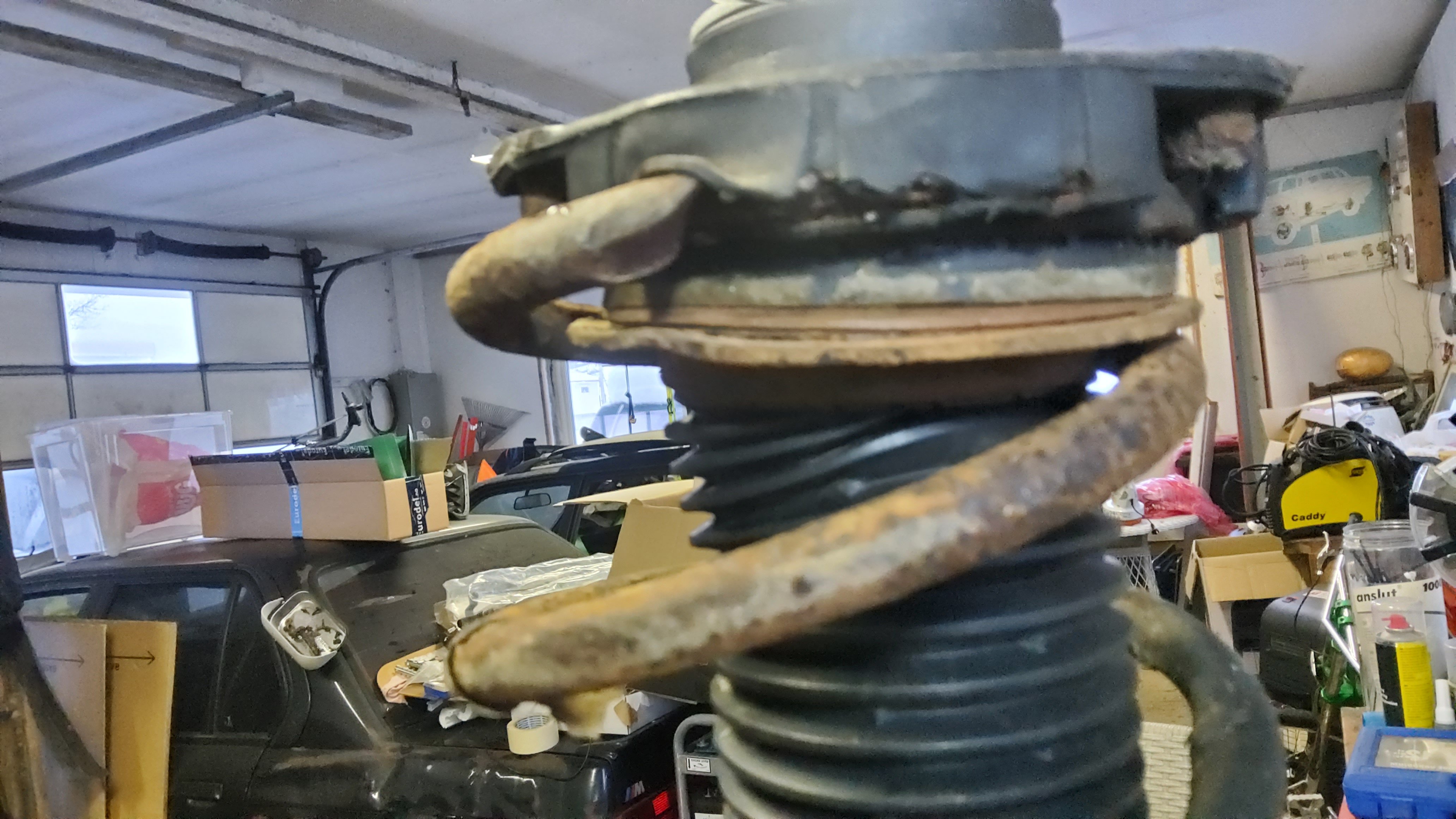

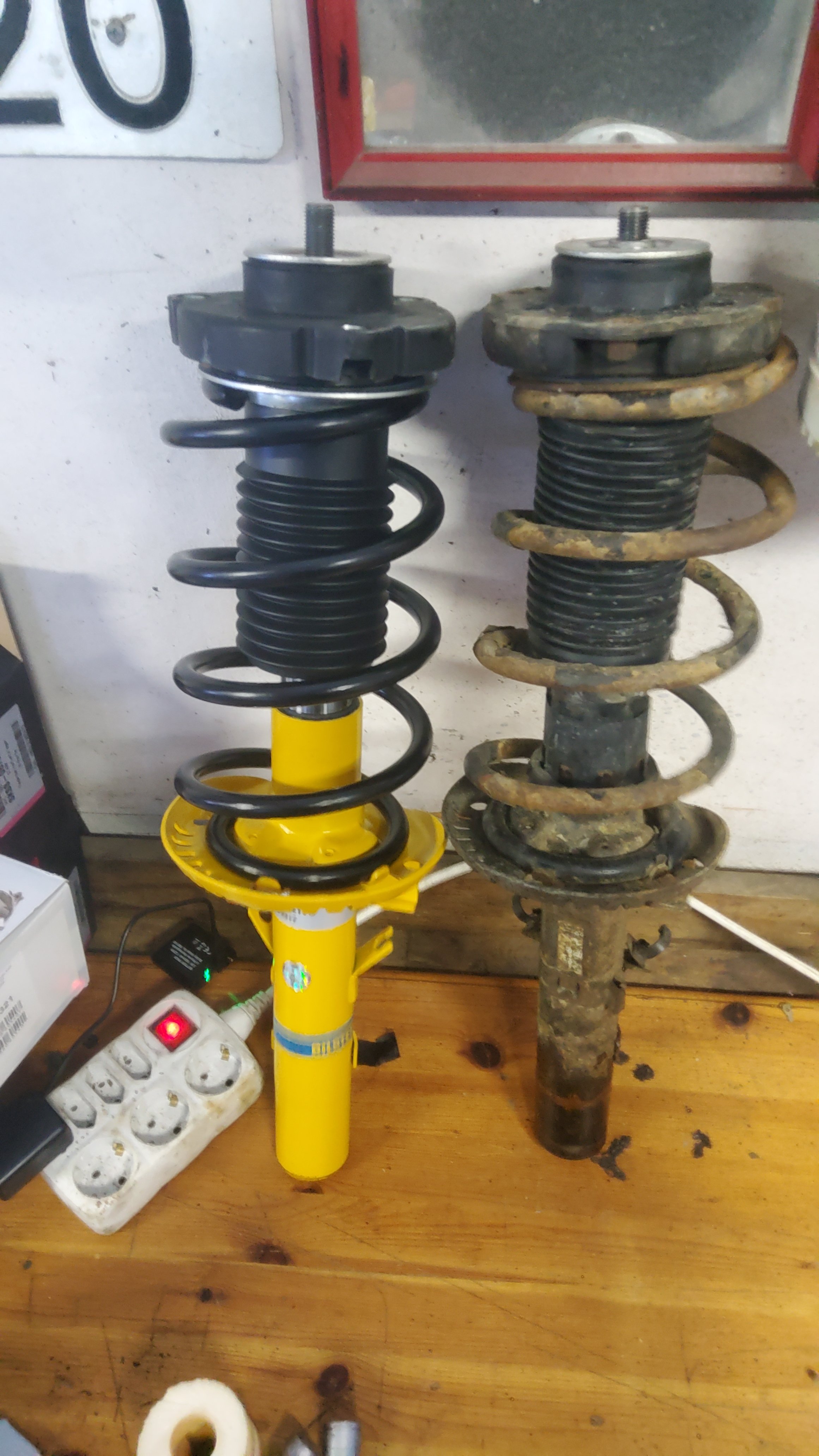

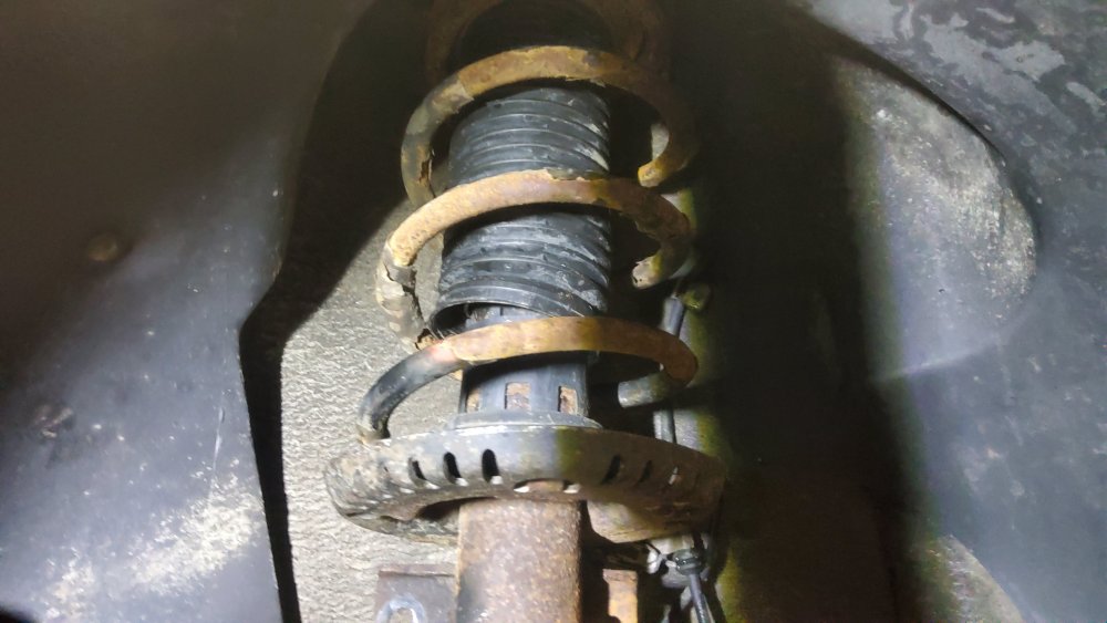

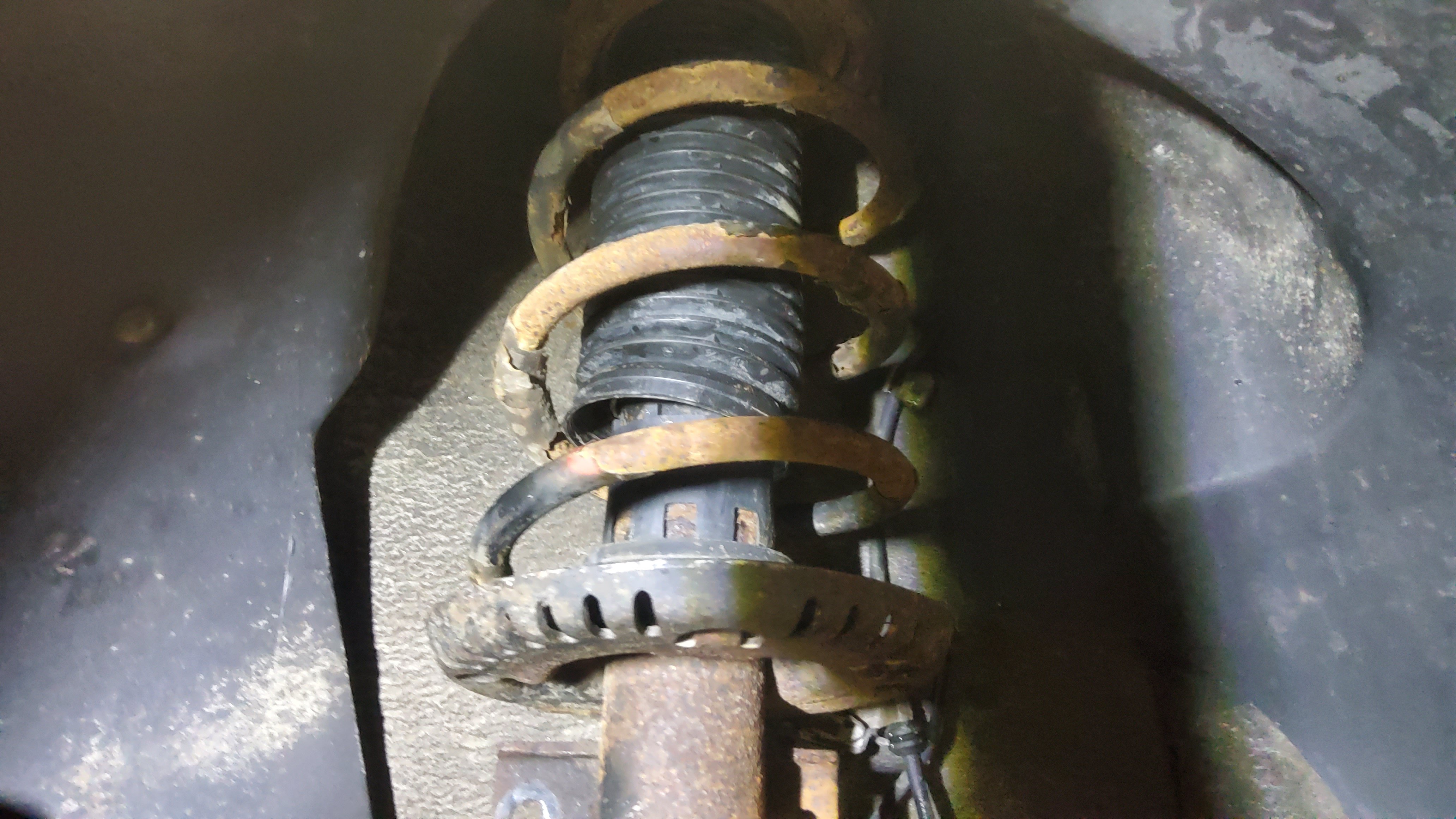

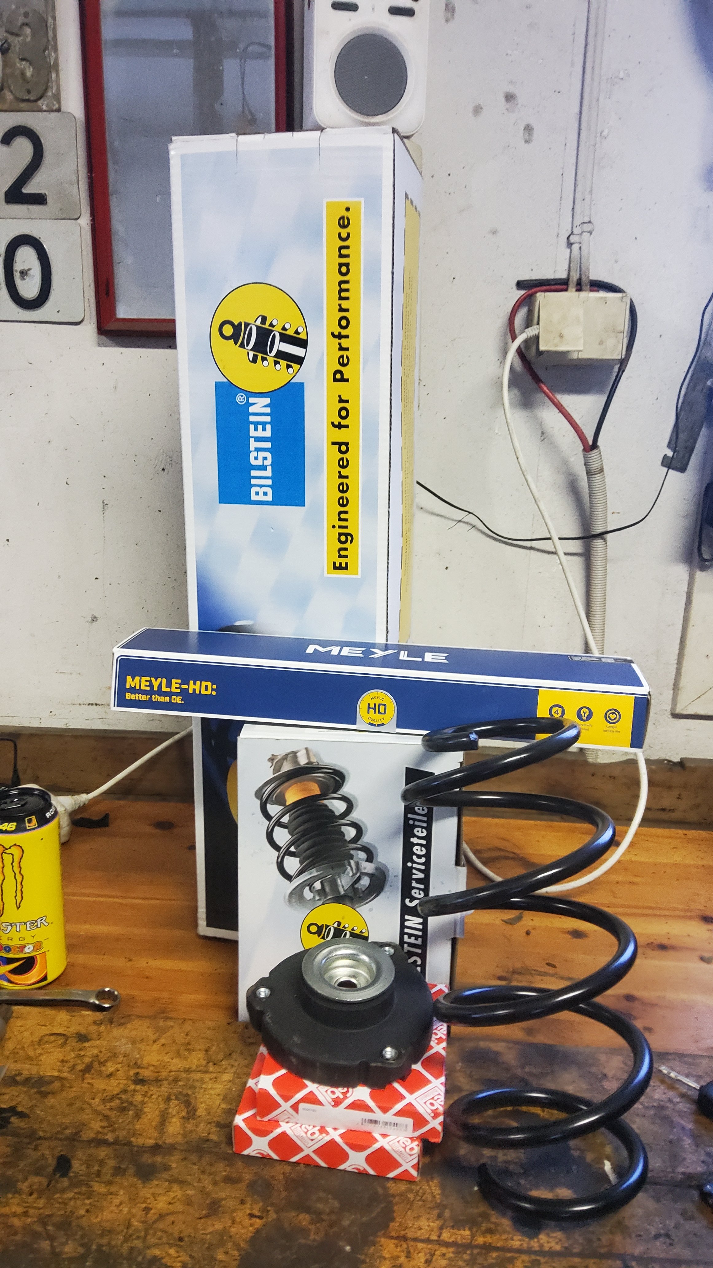

So i just failed a periodic since the bearing on top of my right front shock was busted. I ordered a pair of new ones to replace them but then i saw that i also had a broken spring and a leaky shock!
Look at that! No wonder the car was pulling to one side all the time, and both the bearing where just rust, no oil left in them and barely any metal to speak off.

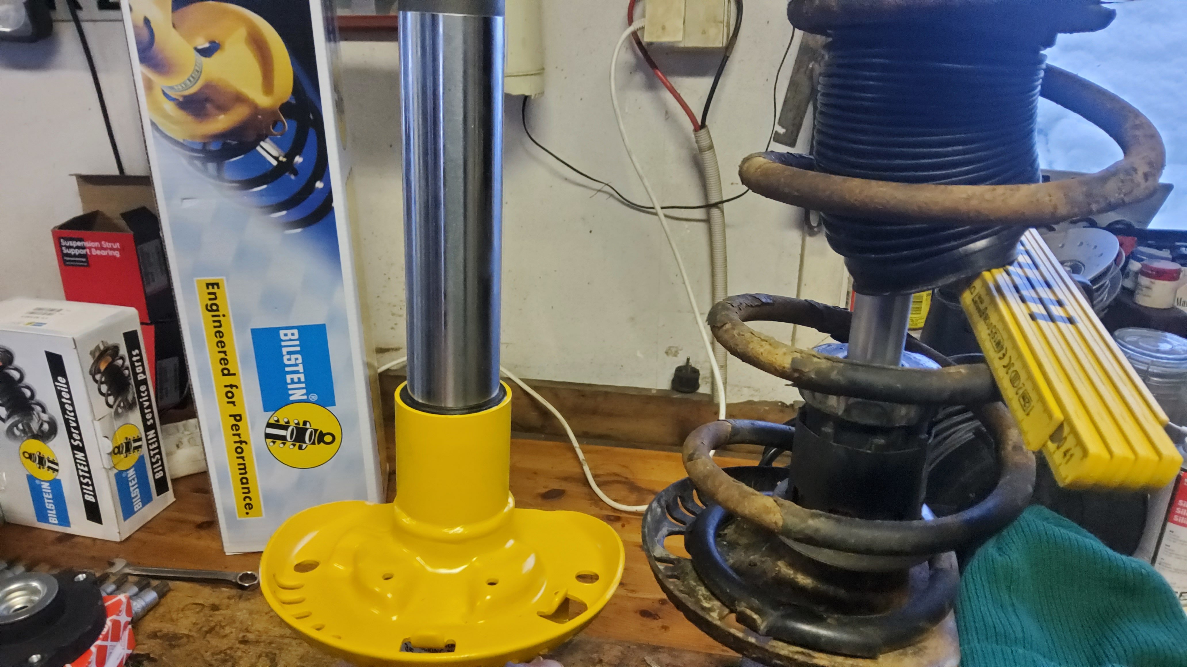

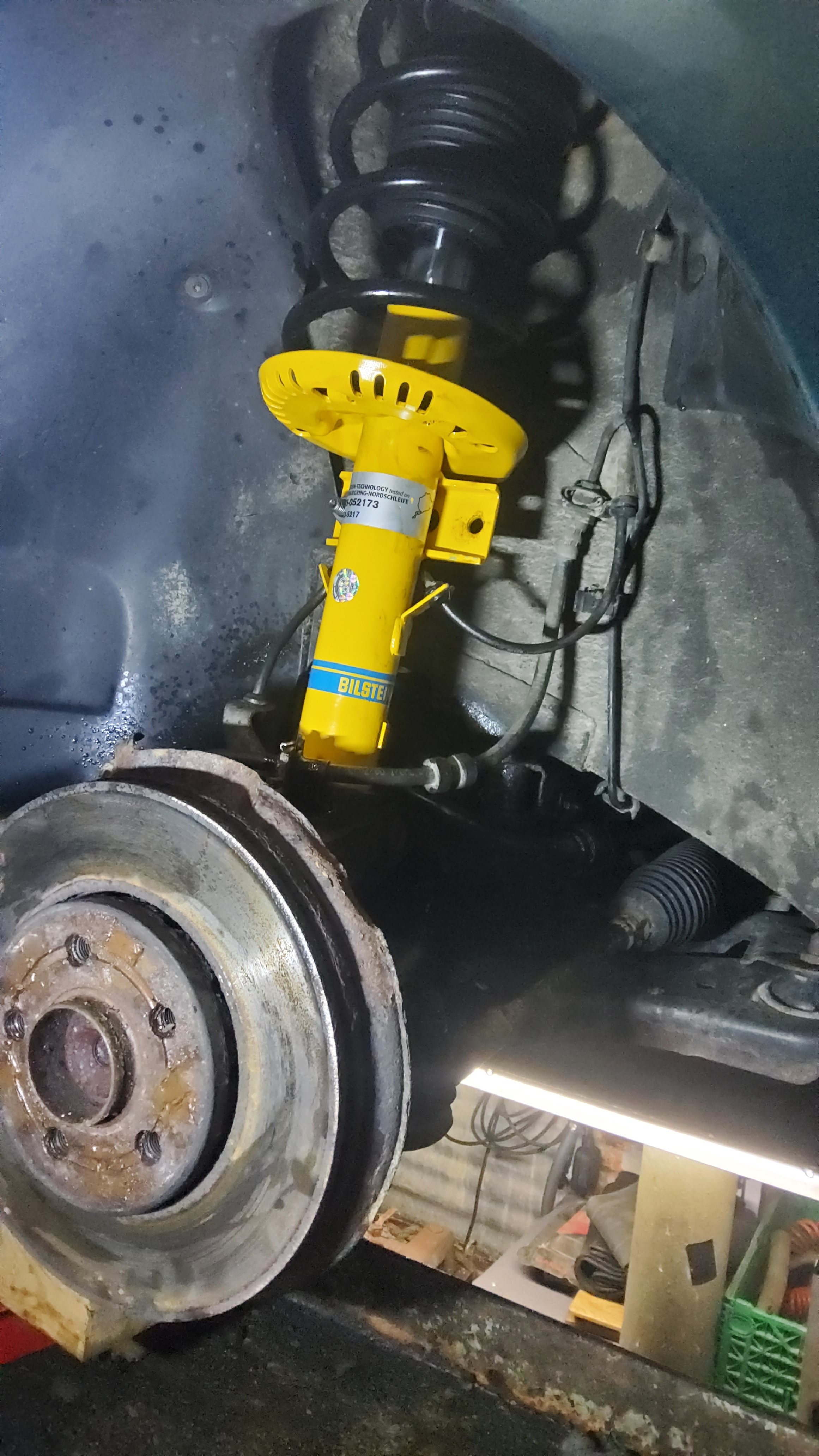

So after some back and forth, and reading up on what to order, huge thanks to Carlston and the information he brings, i ended up with Bilstein B6's and new stock springs.
look at the thickness of these ******s!

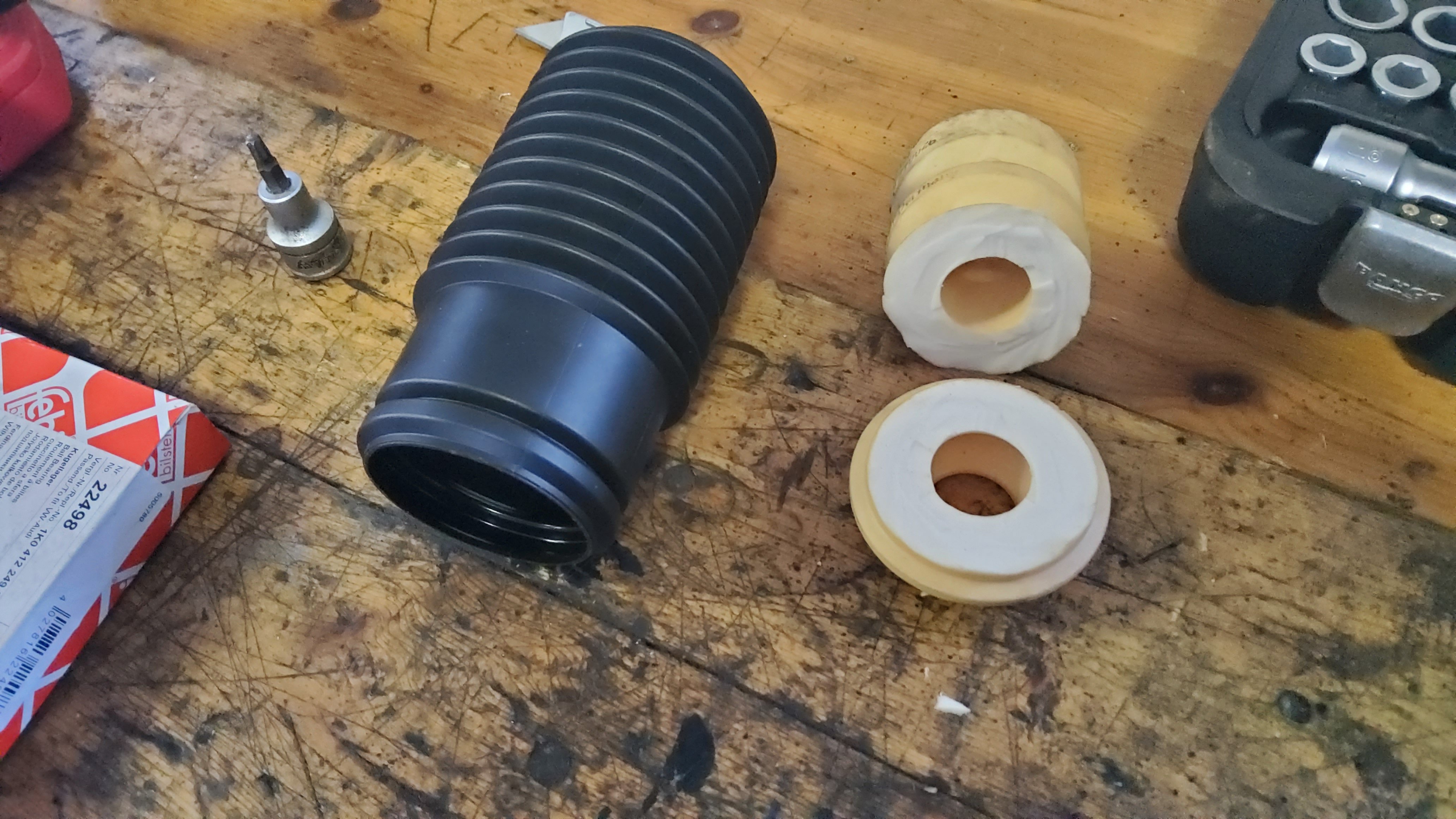

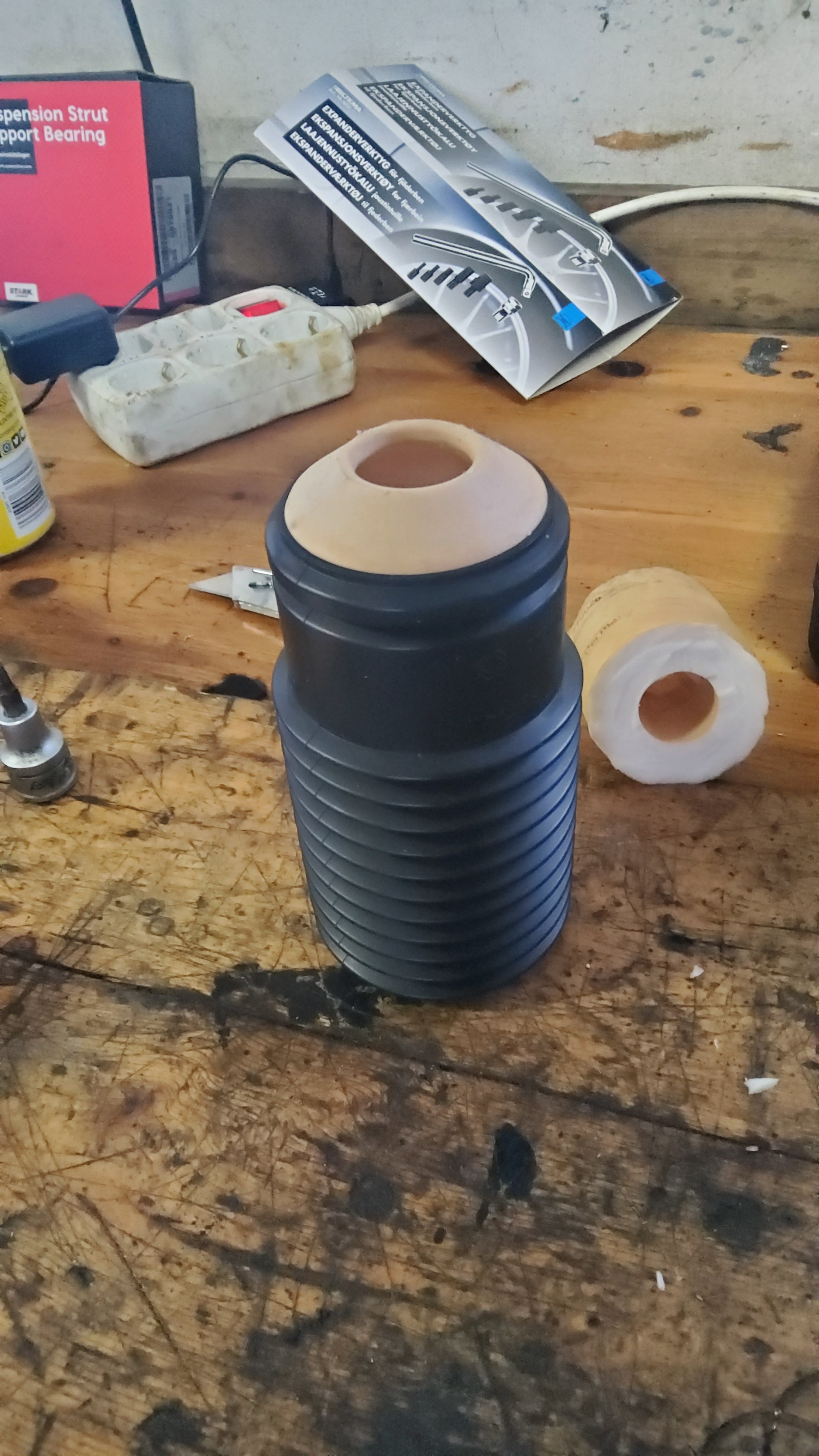

Since the bilsteins dont use those botom out thinges i had to adapt soem to get the dust caps to stay in place, i cut the top of em just so they fit on the tops of the bilsteins:
20220225_105322.thumb.jpg.c1696612854f754b9af5f0ce2dc148fd.jpg20220225_105351.thumb.jpg.cf48f763029e07e4b397ad376270e15c.jpg

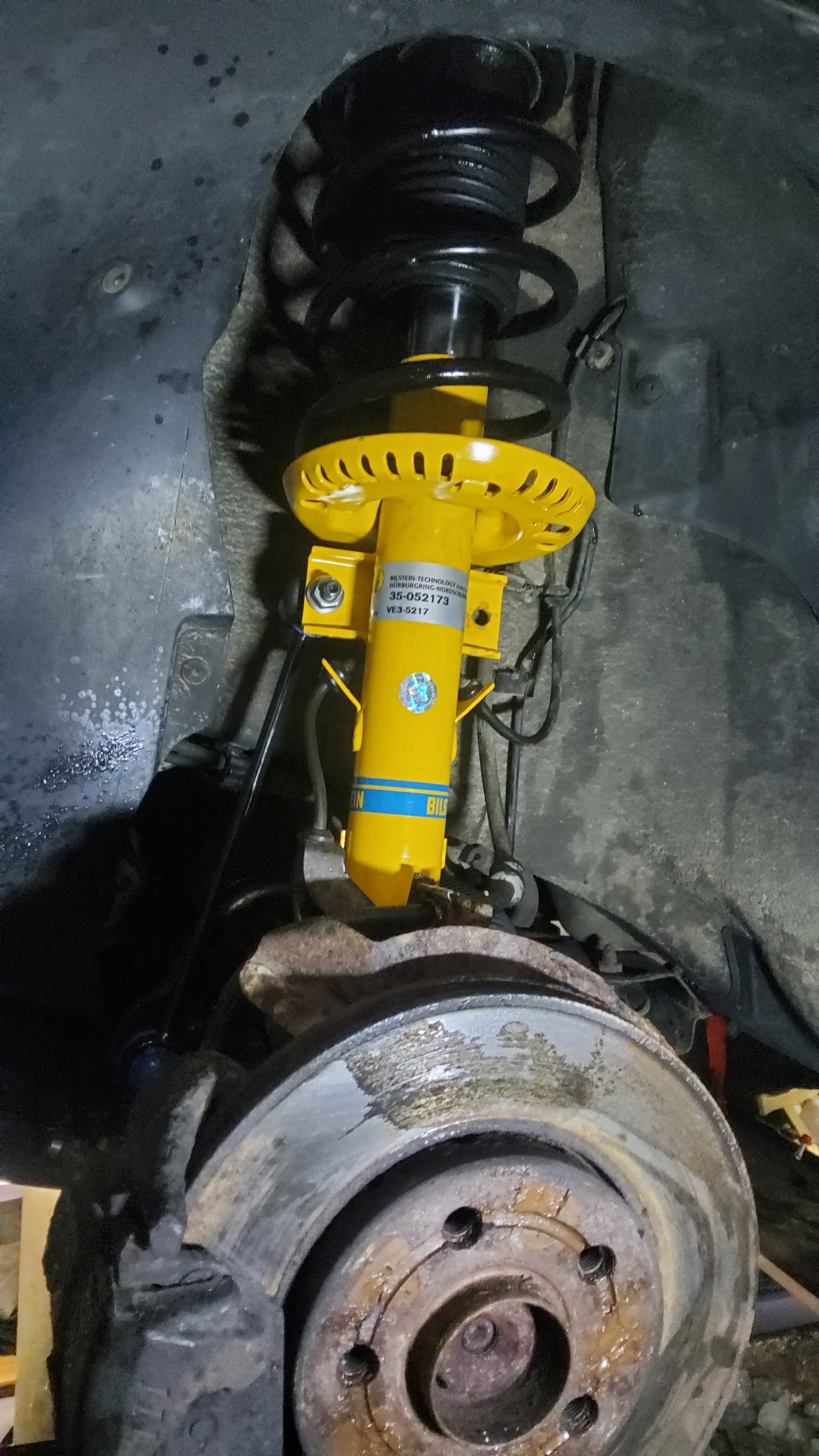

New and old:
Looks quite nice when its finnished=)
Now i have a new periodic in one week, hope i installed it all the right way:S never done something like this before.
You have just removed the active part of the bumpstop and left the piston and seal exposed.
I understand that there was not a lot you could do about it and that Bilstein are selling rubbish if those components cannot be fitted without the butchering, maybe the piston rod is covered with the weight on the car and its difficult to compare them both on the first picture as the spring coil could be hiding that old and new are in fact the same height.
I would be very concerned about the springs being able to become coilbound though.

The Bilsteins are said to have internal bump-stops so i just butchered the ones i had to make the dustboots stay in place.

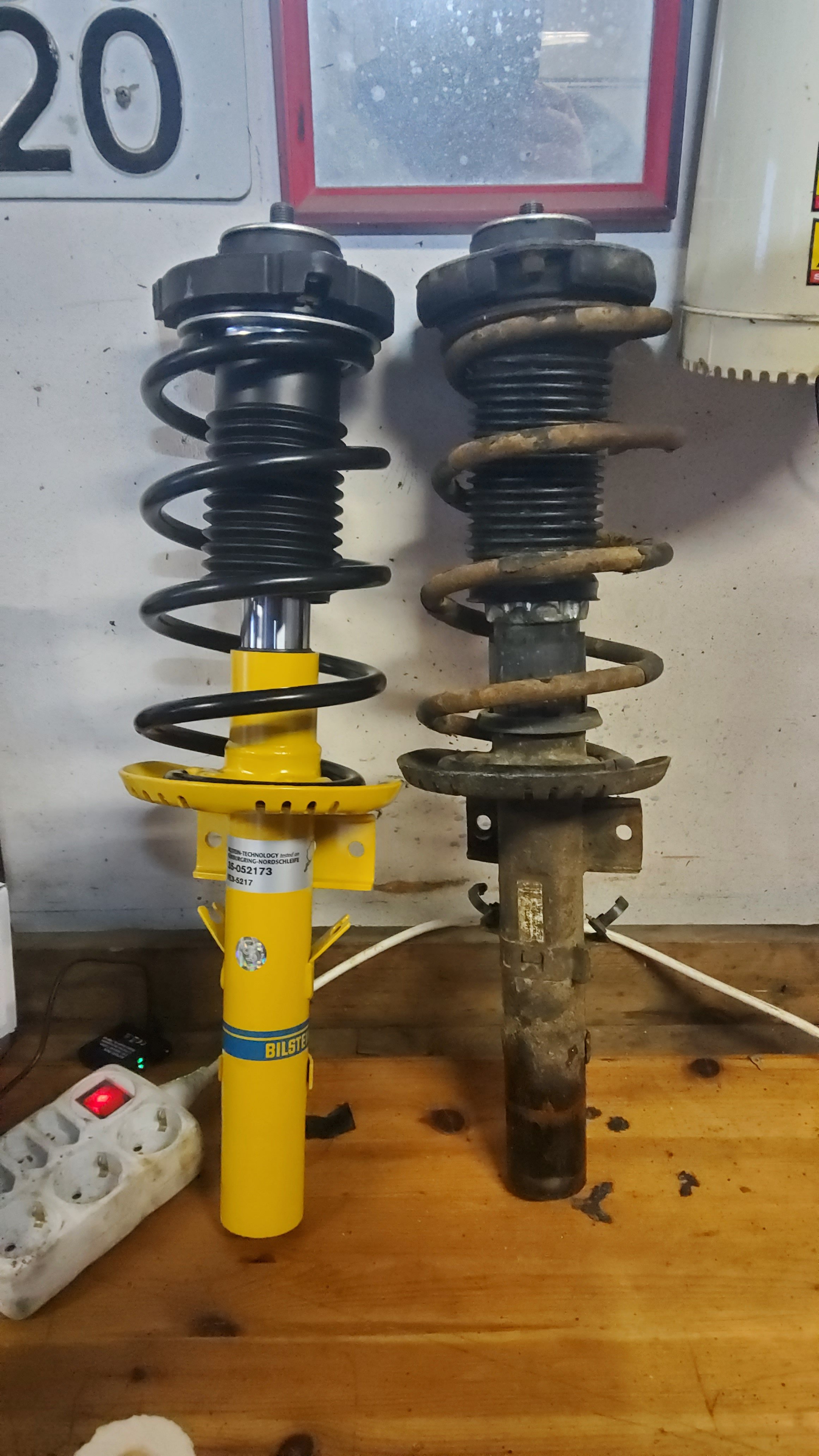

Heres more pictures to compare the old and the new.
20220225_082640.thumb.jpg.3e646b8d8dd956af7924f3346a261c71.jpg20220225_104046.thumb.jpg.f79529fc2f3896b01f134a457ea3ed4d.jpg
The dustcaps do cover the entire piston when the weight is on the car. I also sprayed it down with lanolin(not the piston itself) just since i imagine that's a good thing.
Edited by Truls84
Spelling
The top mount will give compliance and that schlonger of a piston rod is not going to bend, you will know all about it through your backside if it does go coilbound over speed humps etc.
Re the dustshields, Macpherson struts never used to have them, nor bump stops now that I think of it, they didn't last long so the shielding is wise but the struts fitted to Skodas for the last decade have a pitifully short life anyway compared to previous ones, so bad that they created the new mantra of "misting" for leaking.
I reckon they will go the distance.
