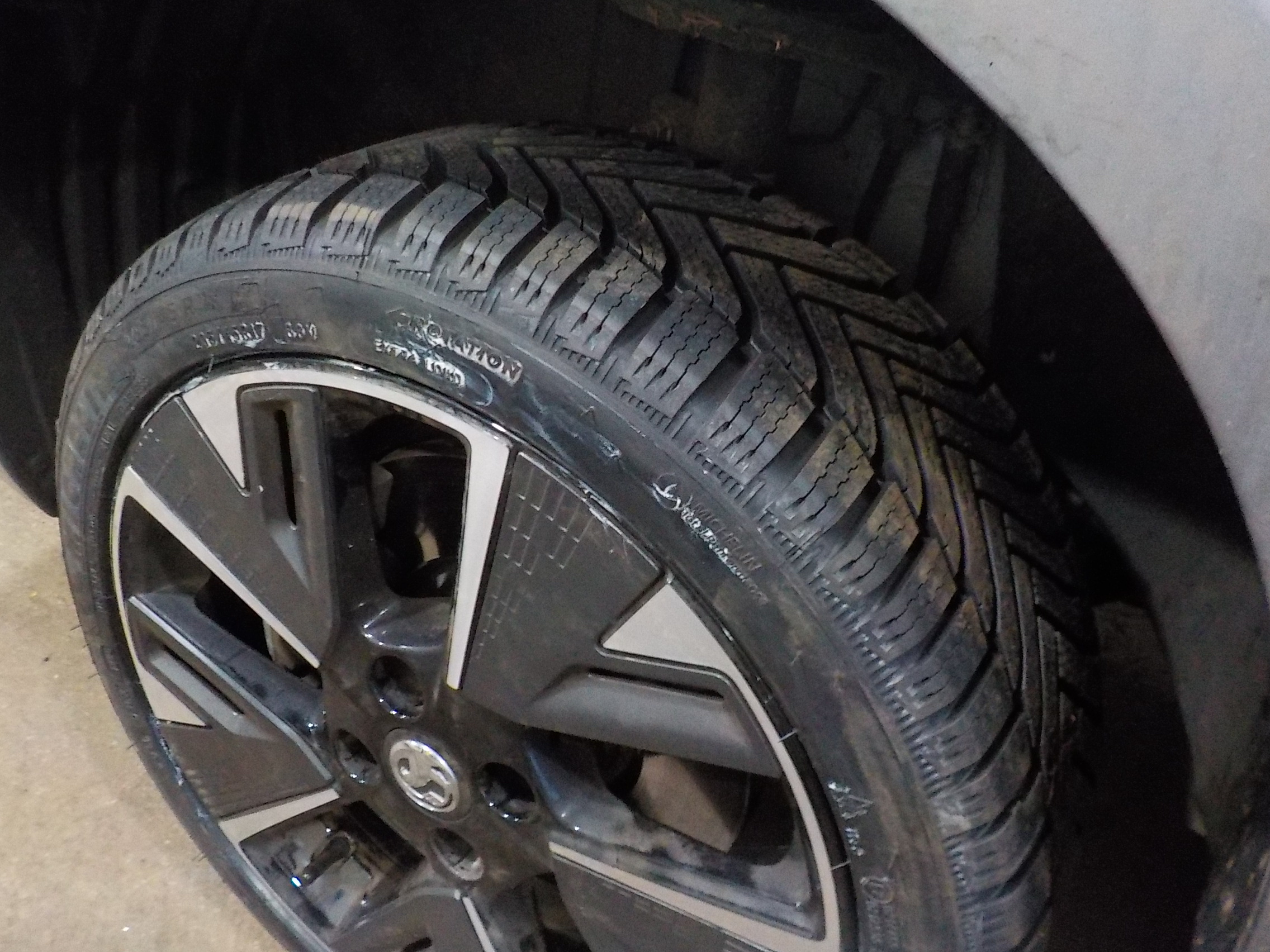

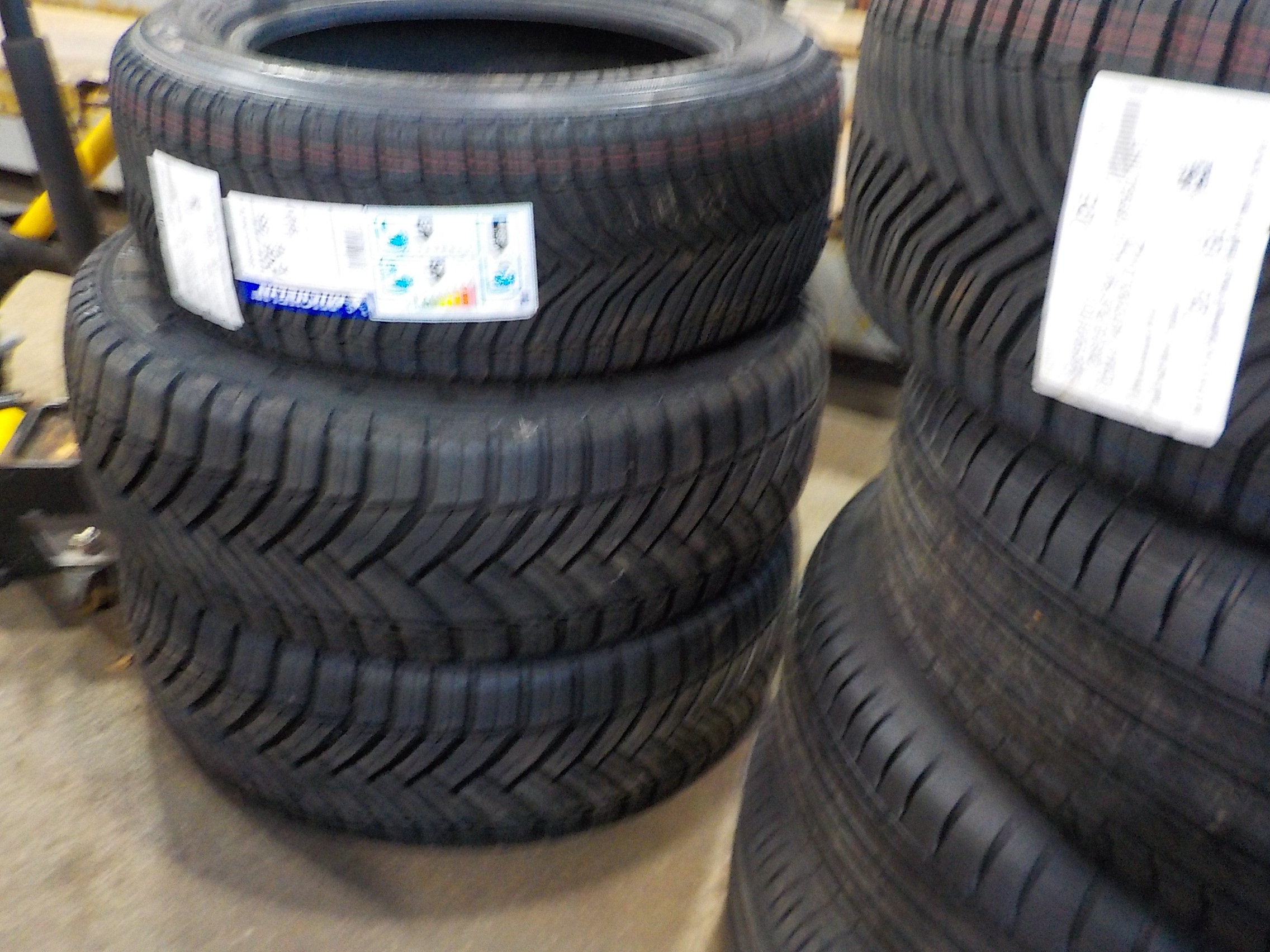

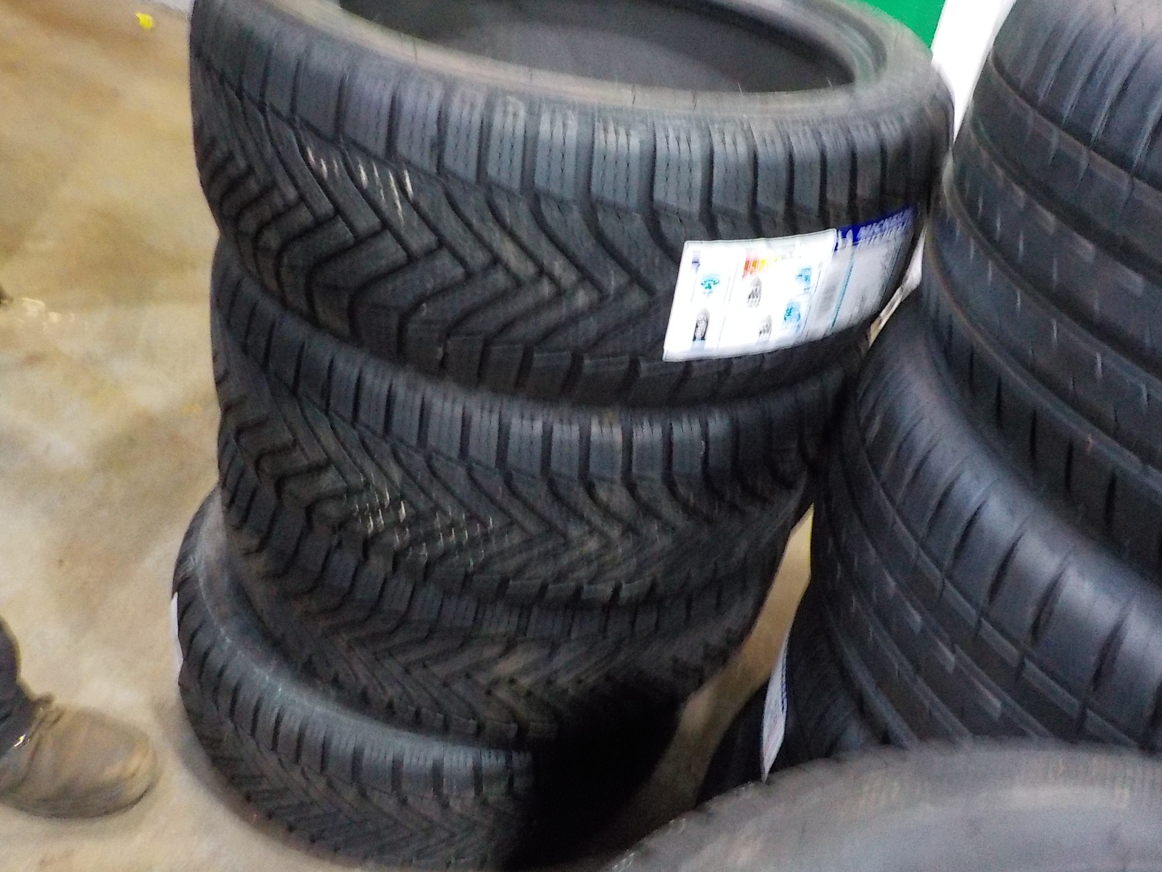

Like the Alpin 6 i have on or CrossClimates SUV's or Agilis CrossClimates  / Aligis Alpins that local to me are getting fitted to vans / commercials / VW Transporters.
Edited by e-Roottoot
Thanks e-Roottoot.  I've polished me specs but those photos still look blurry - it's either my whisky or you old phone :biggrin:

Camera was a bit steamy as a bit of a cold morning.

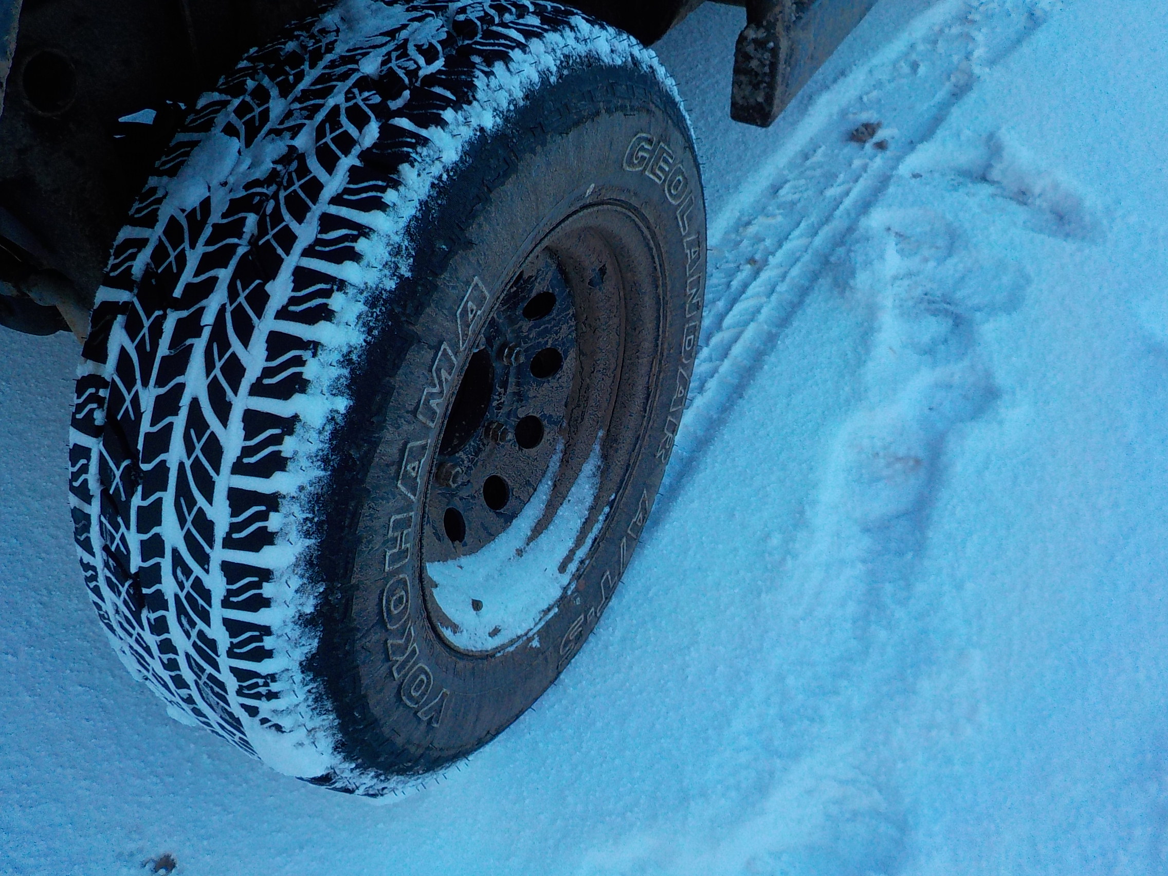

I never used those for my serious winter / offroad car that had to be used on road, i might try them in the future, instead i fitted Yokohama G012  Geolander AT-S as used on the Ariel Nomad as the OEM road tyre fitment.
They had a high speed and load rating but actually in snow they were just so so.

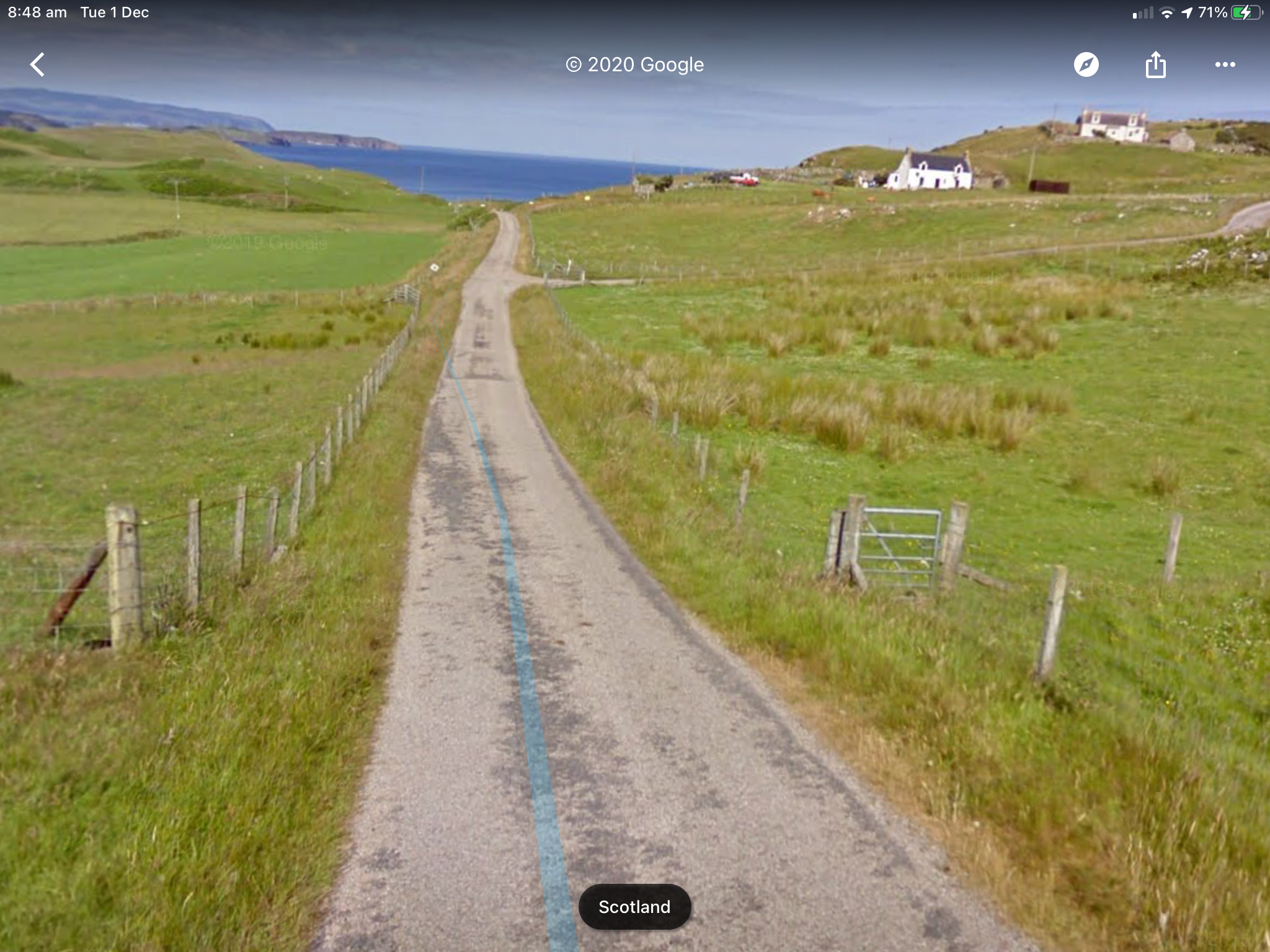

Is this the kind of road you are talking about?
Boooooooootiful part of the world, makes my location (Grantown on Spey) seem positively southern!
Yes!
Her tyre was damaged just north of Talmine.  We have some bone-jarring potholes.  This is the exact spot https://w3w.co/pencils.encroach.fewer
From which, I was able to tell a garage where to find her.  He collected the wheel, went back to Tongue and fitted a new tyre there - lucky he had one the right size.  Then he drove back to fit it.  Said he's keps busy doing punctures!

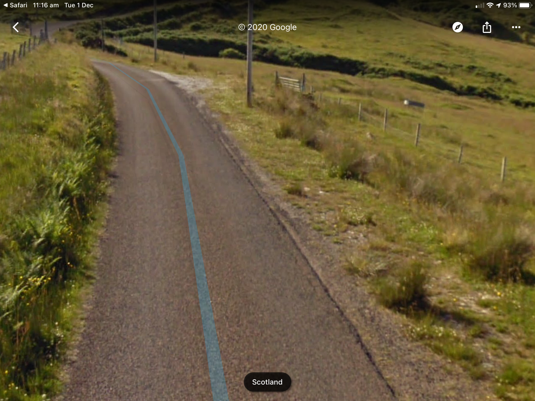

wonder if that sharp edge to the tarmac is the culprit.  Hit that wrong and it’ll certainly do some damage to the inner wall of a tyre.

Very likely.  She does swerve onto the verge quite often for oncoming traffic and tail-gaters.  And it was a nearside tyre.
