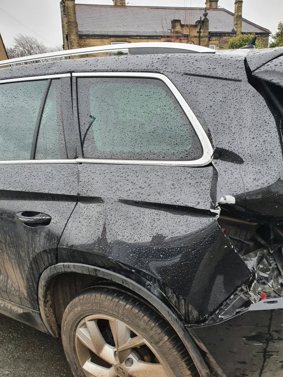

Roof is undamaged, what the gloved hand is pointing at is a seperate panel, when rear 1/4 panel is portapowered back into alignment before removal and replacement it will probably lift the rear corner of the roof if it is pulled down, difficult to see from the photograph, at best there may be a PDR ding remaining, no filler or paintwork required to roof but the other panels will be painted anyway so no real problem.
100% it will be repaired and most likely the buyer will not even inspect it having seen all that he needs to like me from these photographs which are more detailed than before and bear out what I thought from seeing the others.
