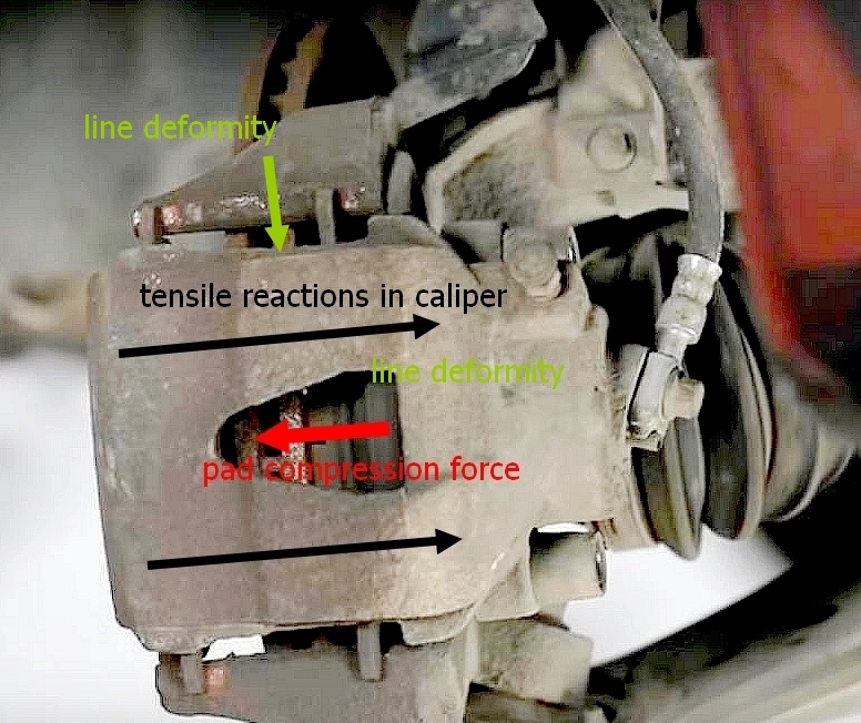

Is that a big crack along the calliper?
  • Sponsor
That's a very good question. Can't be though, can it?
It's a huge crack and another smaller one, that caliper needs replacing urgently.
Some idiot has smashed hell out of it with a lump hammer.
Shadow line from the flash. :)

the thin black line along the caliper to the left of the pic, really does look like a crack rather than a shadow line though

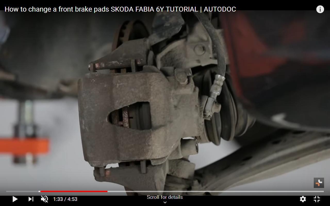

just finished doing this shot off a youtube so i could get my head round the whole assembly and how the pads are changed...would have to do it myself to appreciate how easy it is in the video
cool bit of design

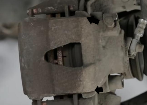

In your last image from that video we can see the vertical/horizontal edge in the casting that we were looking straight down on before, giving the crack illusion. Black arrows added to attempt to show where I mean.

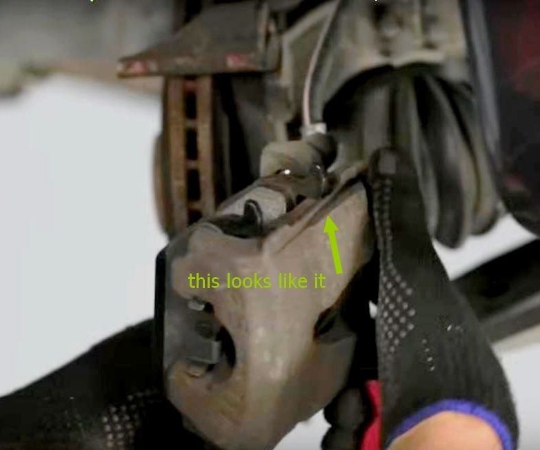

i have looked at automotive disc brake calipers and got ductile iron...as opposed to cast iron which can fracture...?
i am hoping this line is from process which made the caliper..perhaps drop forged and not in a stressed area when the caliper compresses the disc with the pads
i will put a stanley knife blade in it to see if its deep

I promise you that there is no crack, you're just looking down on that right-angle feature of the casting. At the outer end of your first photo you can just make out the vertical section

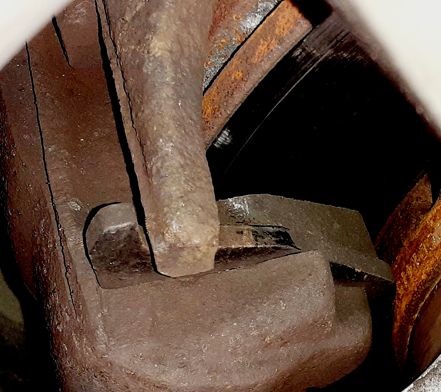

i just had another clip done and its pretty clear here
bit thanks to you...got my brain in gear....
