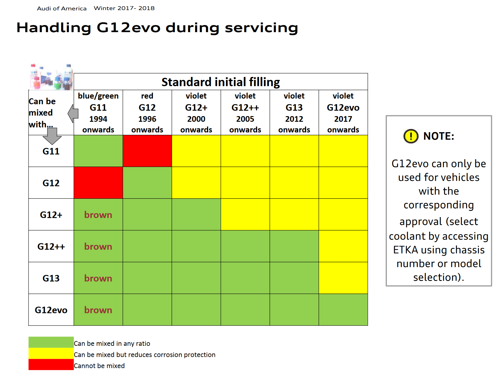

No I don't. Only had the car since December last year, so not sure. Will have to check the coolant container for any other markings.
That's a good idea. I found this chart yesterday, it's a little illuminating on coolant and corrosion protection.
Hopefully you've got G12evo in there.

You'd think so, but now I'm worried about internal corrosion and looking ahead to swapping my G13 coolant for G12evo. :D
