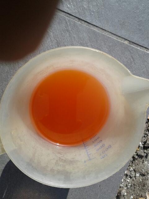

The coolant looks strongly contaminated:

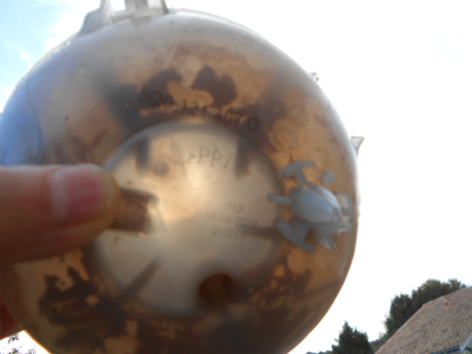

I've read the 8 pages of this thread. The P/N of the tank is 5Q0 121 407G. I haven't plunged my finger in the tank to check if there's any residue of the silikat bag. After a quick glance, there don't seem to be any bag at all. The tank seem to be like this:
But the level sensor has plastic covered electrodes.
I've checked on ifinterface.com (online ETKA), the coolant tank P/N has been replaced by 5T0 121 407T

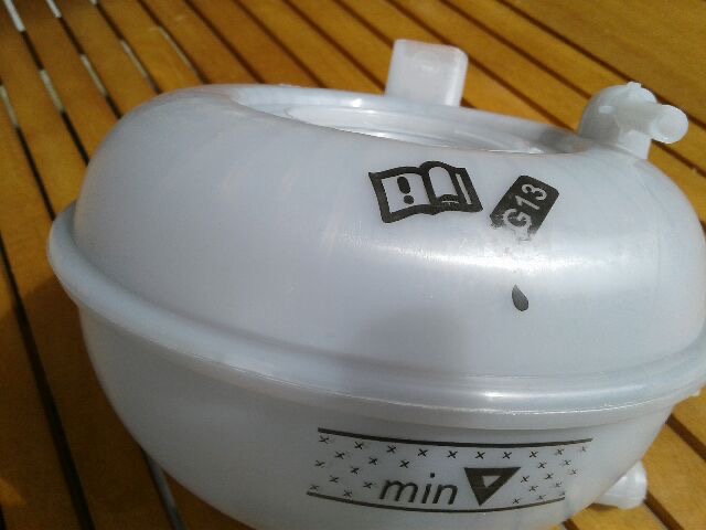

Step 8: Install the new tank (5Q0 121 407T - without any silikat bag in it).

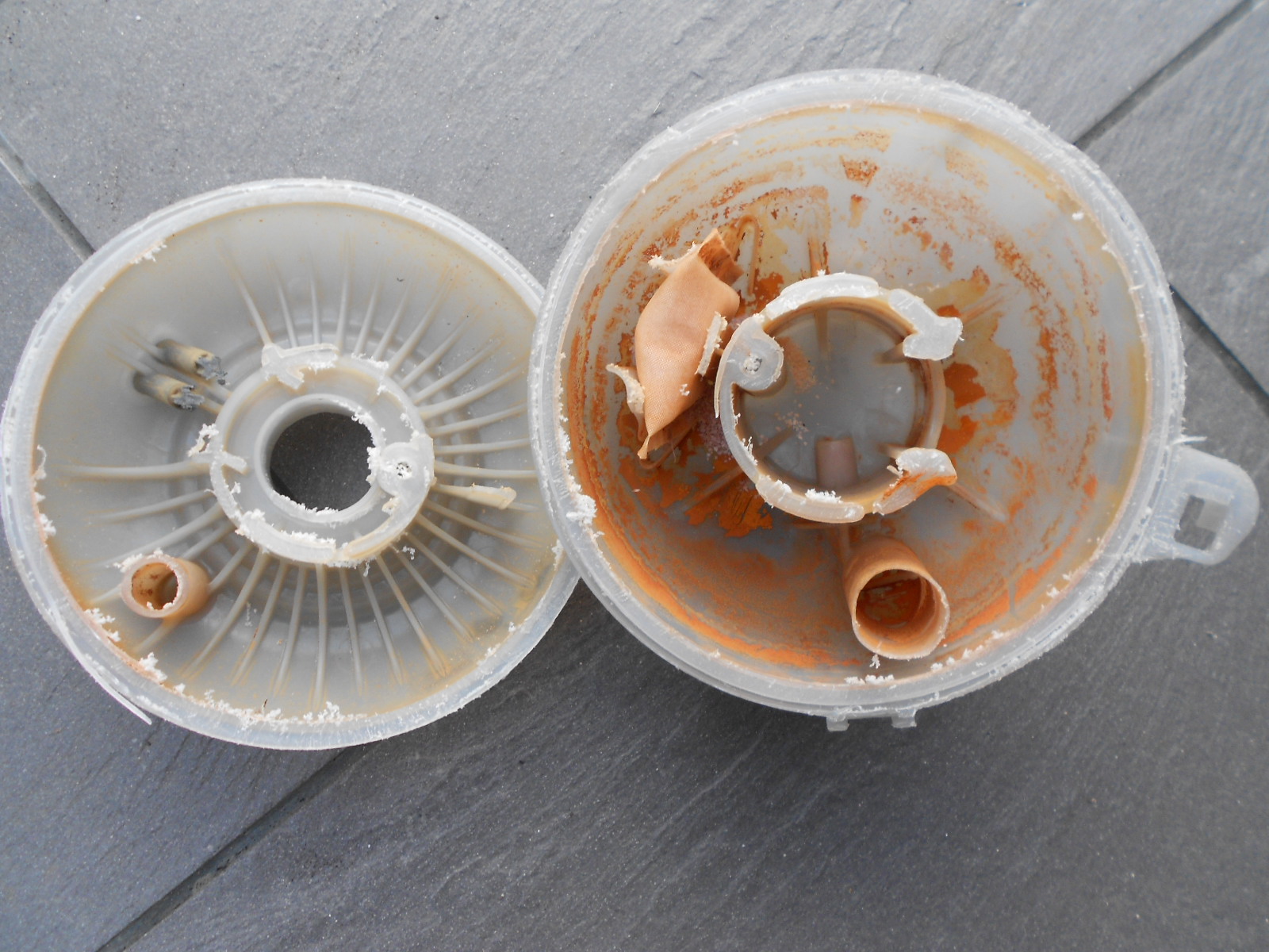

Old tank before cleaning: :o :sick:dscn0411-57c7918.jpg
Old coolant (No, it's not apricot juice! :D):
Old tank, and its bl**dy silikat bag:
New tank ('mit Silikat' indication has disappeared):

@foregonereality I deserve no congratulations. It was my dad's work... ;)
He told me the bag was OK. It has only torn of when he tried to cut the tank in 2 pieces.

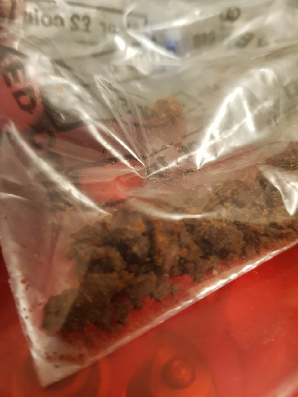

cant add a pic
This is whats running around my coolant system
That looks like muck, not silica. Might it be worth getting it analysed at a lab to verify its contents - reason being that if it's a manufacturing defect then surely the onus would be on vag to fix the problem without cost to you?
Yep that does look a lot more like casting sand or muck than silica.
As above, I would consider sending it to a lab to confirm what it is.
That was colected by an inline filter in 48 hours after the vehicle was flushed nd clean
The silica in the bag was clean almost clear in colour,  hence the thoughts on casting sand.
