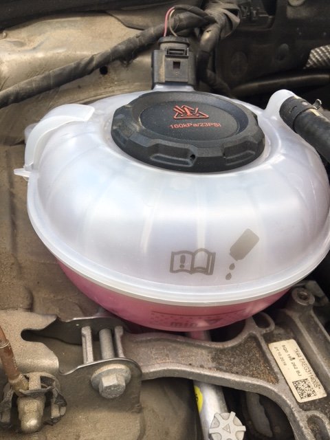

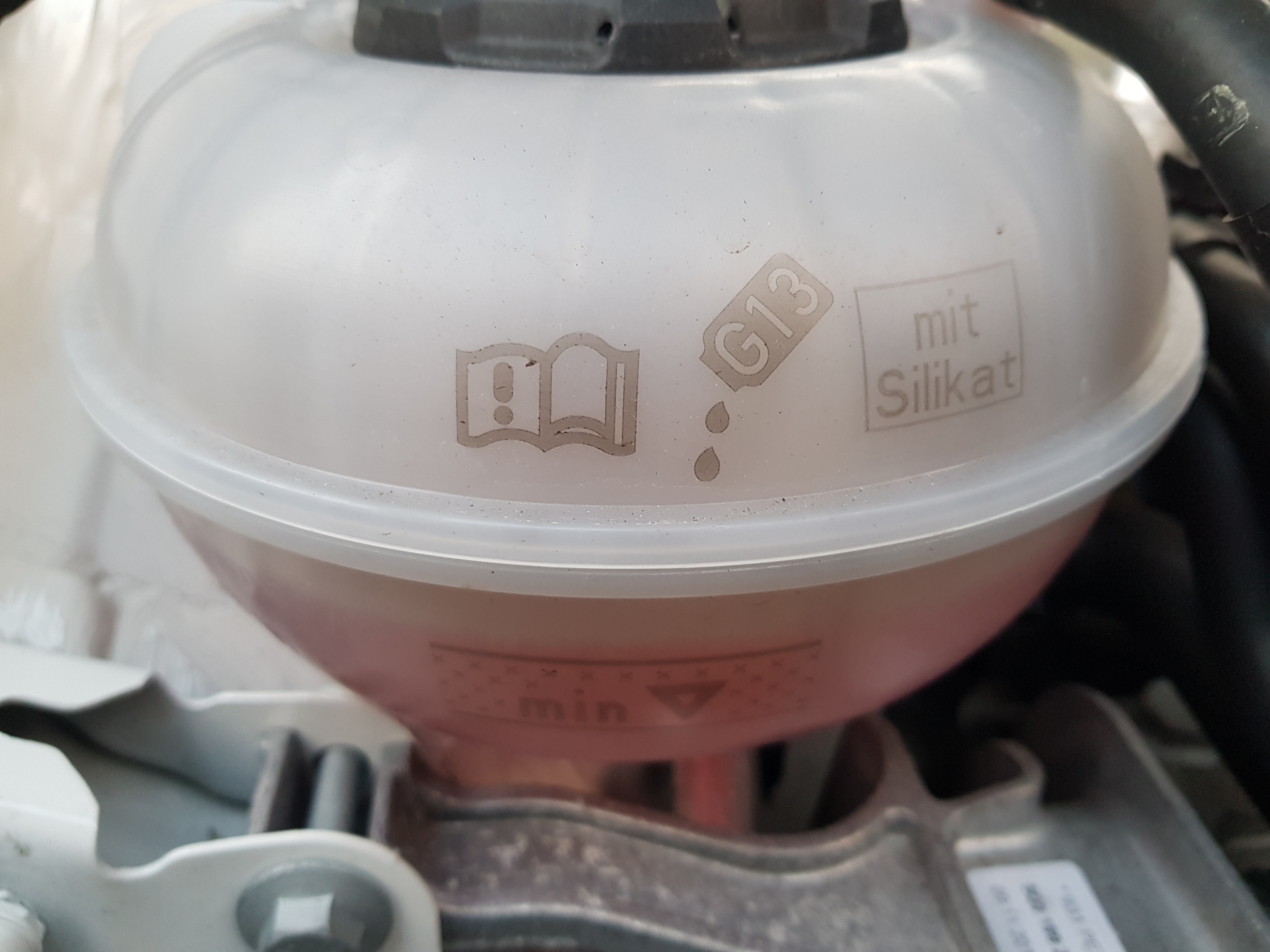

Quick question. I have a 2020 Octavia 245 VRS. I have checked the coolant reservoir and it does not have the text on the outside warning about the silicone bag and appears to be single skin. I also cannot see a bag. I may have just answered my own question but can I assume from that I have nothing to worry about?
Mine doesn’t have “MIT Silikat” text and no bag.
Just remember to change the coolant every 5 years or 60,000 miles.
No problem with that at all just relieved if it sounds like I haven't got one of these silicone bags floating around in the reservoir
I think you'll be alright. I don't think they continued with this 'design flaw' up to 2020.

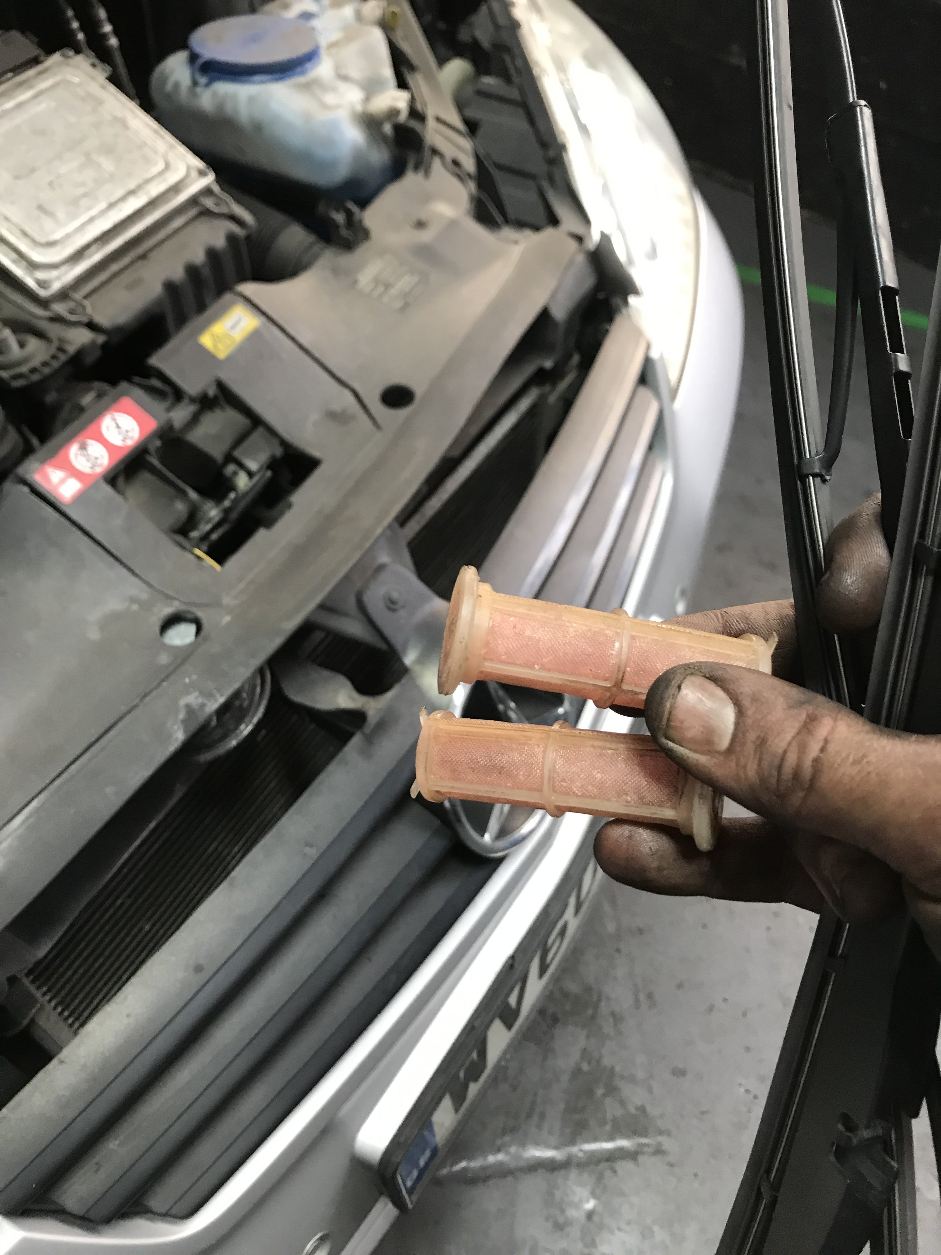

On 25/02/2021 at 22:11, cheezemonkhai said:
That was used in a tt I think and they can be replaced too. You could buy the parts to change the two cylinders.
It’s not new, but old, possibly the original design.
They were also using this type in 2010.... changed my mates cambelt and water-pump on his Audi S3 last week and these fell out the empty expansion tank.
At least they look more robust than the bags... Maybe the bag design was a cost saving exercise for manufacturer.
That’s the ones.
The design I saw there was a plastic semicircular pair of clips for each of the cylinders on the bottom of the tank.

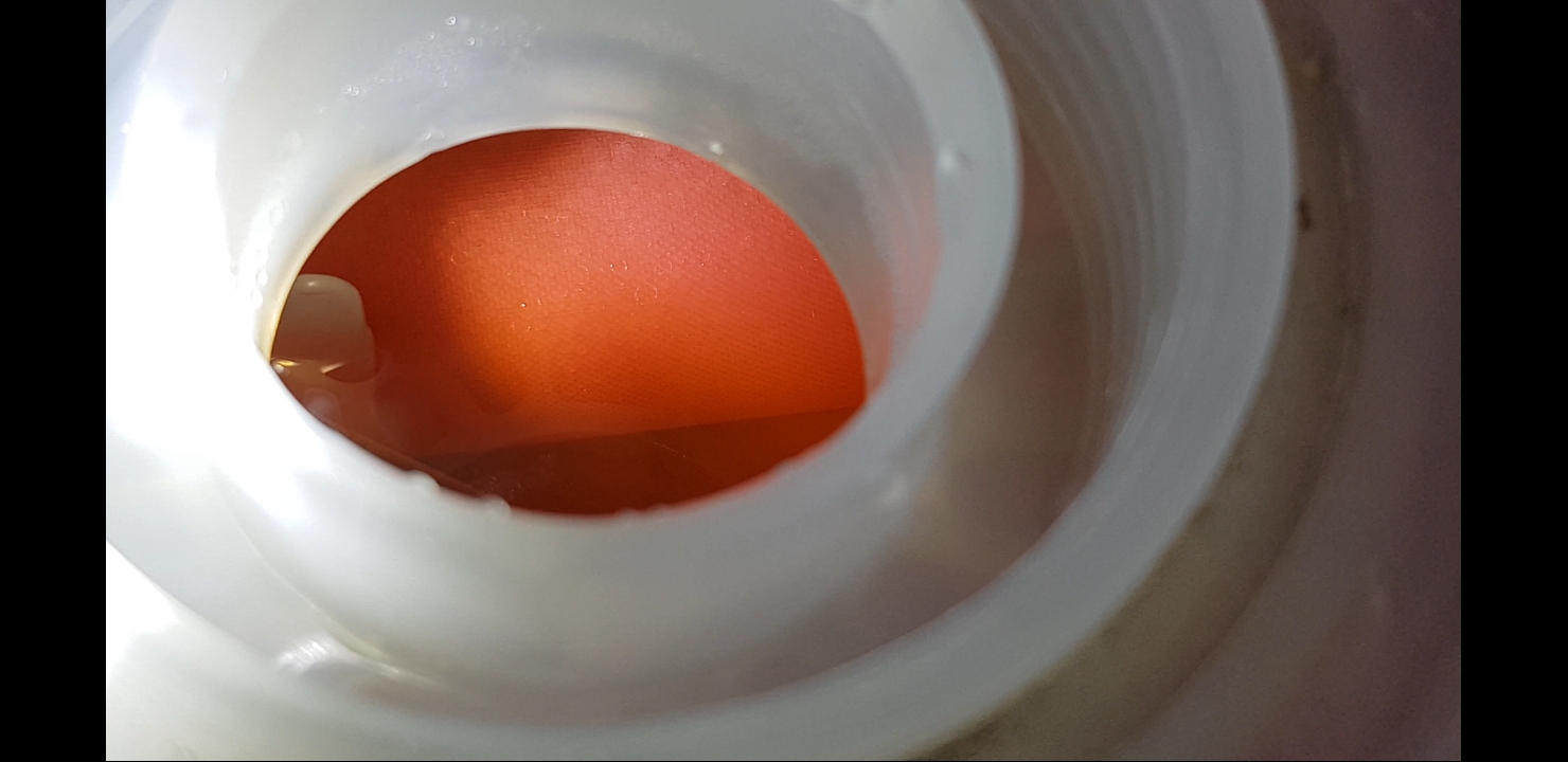

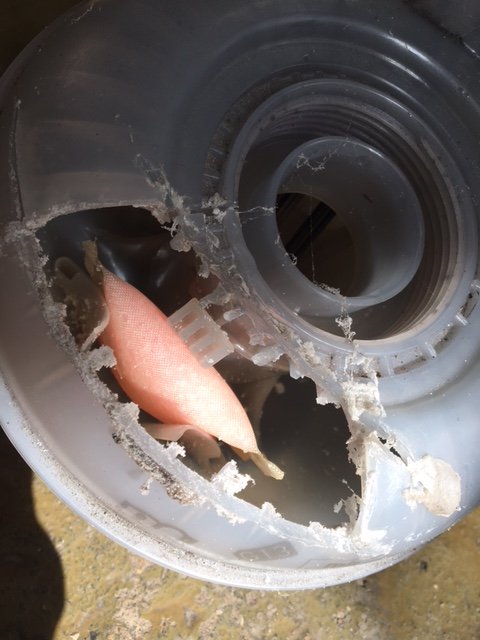

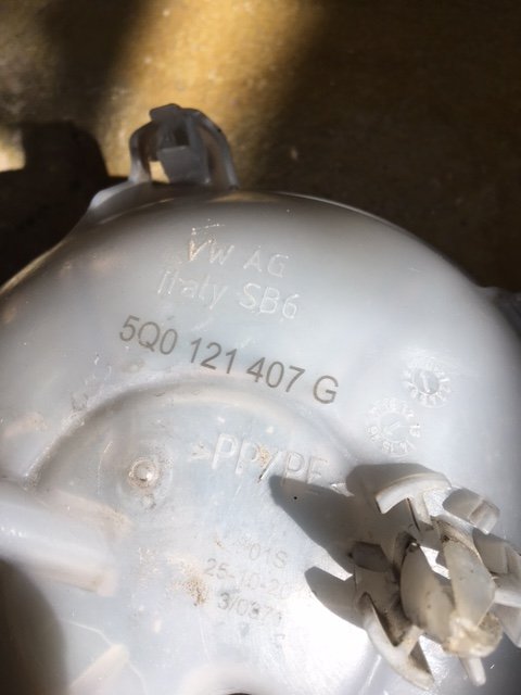

Went silica-bagless yesterday. Original tank was with G in the end and bag was inside walls (=impossible to take it out from fill hole).
After 4 years and 100k km bag looks in good condition.
This is really helpful, as I think I have a similar set-up where you can't just fish the bag out with your fingers like the videos suggest.
I wonder how robust this bag actually is, when clamped in that position?

This image is exactly like my parents Octavia - you need someone with slender fingers or a pliers that isn't too sharp to get a hold of it and pull it out carefully. The alternative is to take out the tank and then fish it out manually without any fear of it contaminating the system.
My own one was the double sealed wall so you could not see it inside the tank without cutting it out. I replaced the tank completely and sold the older one.
Yes, take the tank out (5 min job) and then you can be as rough as you like with needle nose pliers butchering the bag until you get it. Give it a rinse under the tap if the bag splits before re-fitting the tank. I wouldn't risk fishing it out in situ in case you split it. It wouldn't take much of the granules to block a heater matrix I wouldn't have thought.
