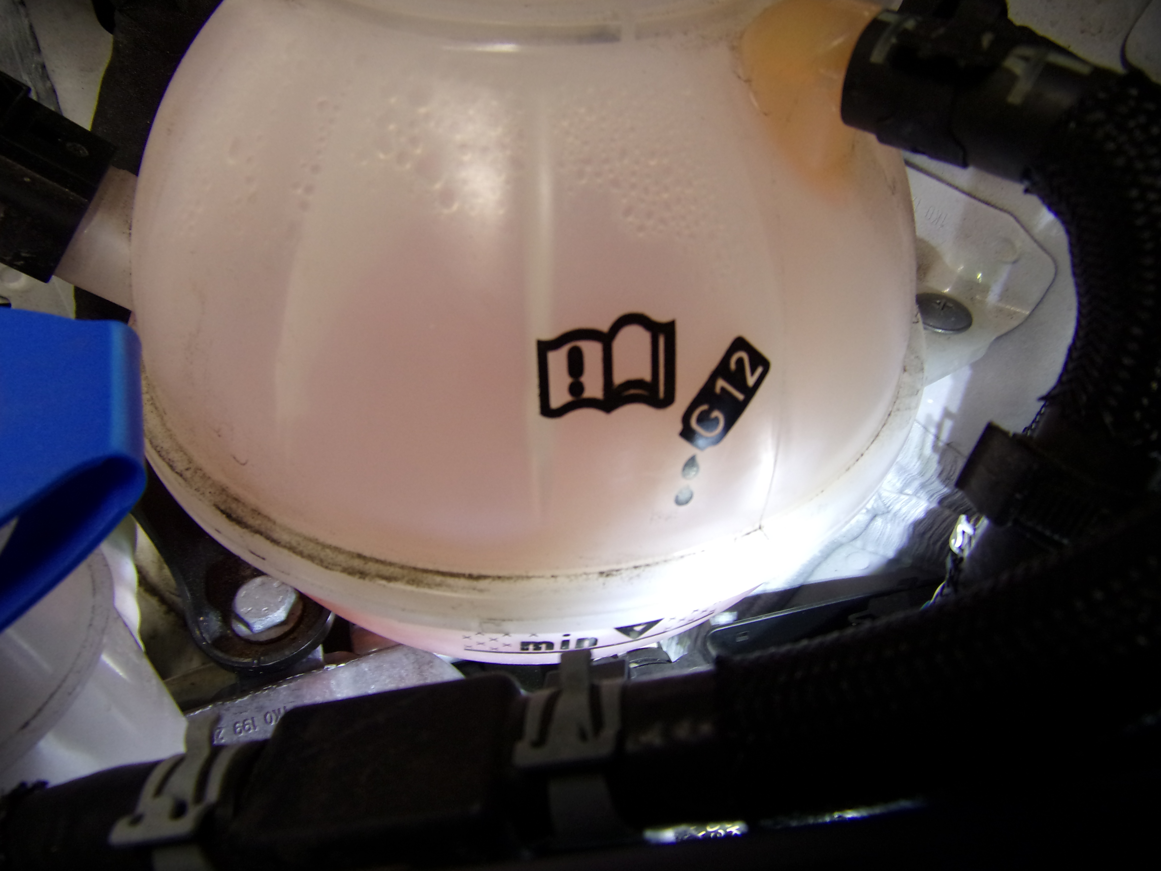

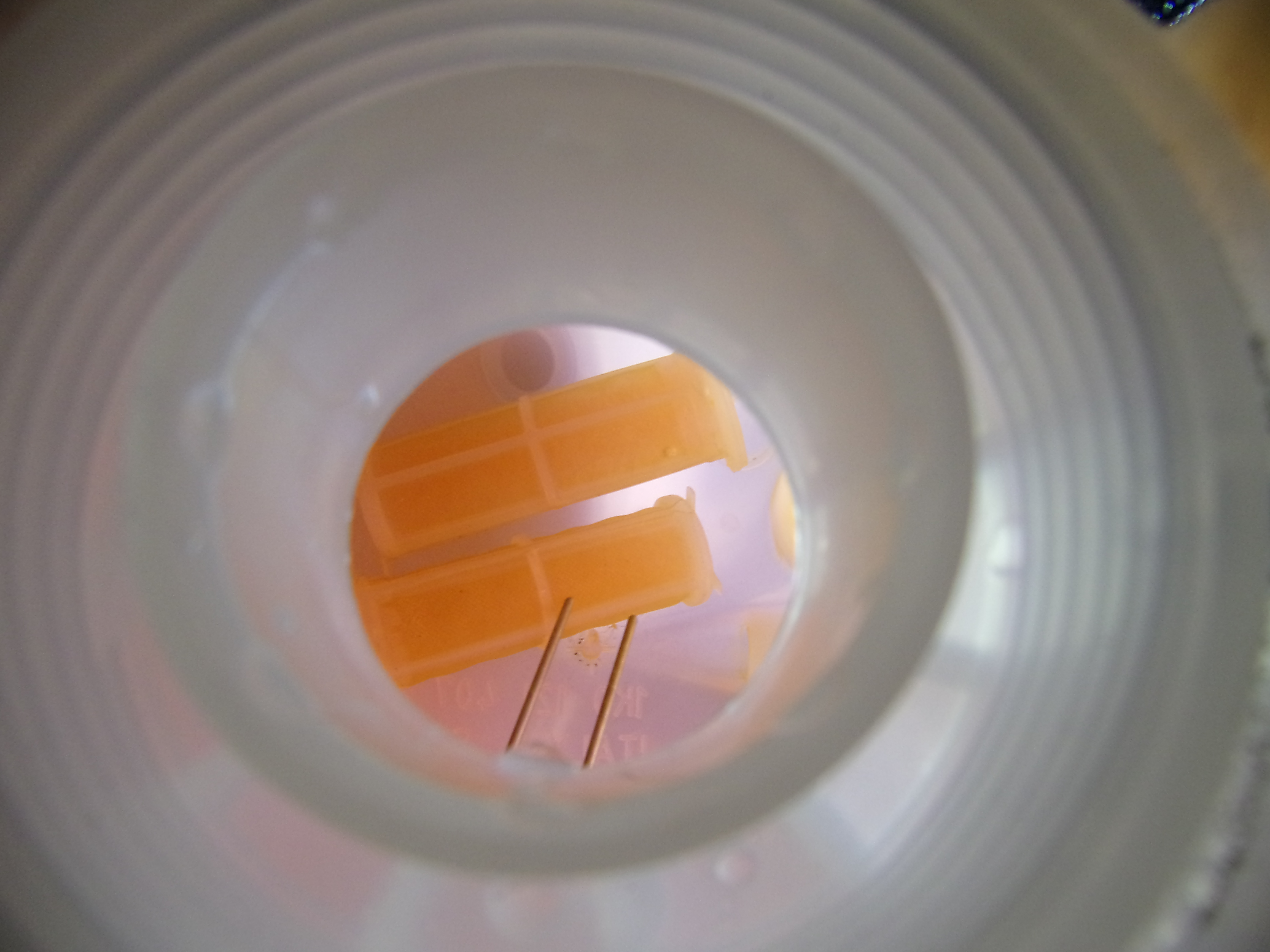

just wondering if vag have changed things, photos below of the coolant tank in my caddy van 2019, there's no tea bag but there's 2 cylinders in there.
Its a "New variant" :D

has the silicate bag been replaced with the 2 cylinders like in the photo i posted above, if so, maybe vag will sell you the cylinders. coolant would then  still be for life and not every 5 years.
That was used in a tt I think and they can be replaced too. You could buy the parts to change the two cylinders.
It’s not new, but old, possibly the original design.

a bit strange , the cylinders being replaced by a teabag, seems like a backward step to me ,bags are more likely to burst, like we are seeing

What's the (full) part number of that expansion tank? Looks like it's moulded into the plastic of the outside of the bottom, so may take a phonecam picture to see.
Can see 1K0 121 407 backwards through the plastic in your first photo (I think), but not what letter follows the 7.
And is there a part number on the cylinders (assuming they come out as easily as it appears)?
I would've thought that a cooling system with any type of containers of 'future blockage creator' material was a backward step, but they must be having to counteract some other 'new' problem that's been designed in, I reckon.

The oldest design I saw had two cylinders which pressed into clips on the bottom of the tank.
Come some defined point or if they ran out they could be removed and replaced with new ones.
Odd that that tank pictures states g12 not g12+/++ etc though.
1ko 121 407 A is the tank number
done a bit of googling and the part no for the cylinders is  4eo 121 176  they call them silicate cartridges, about £12 - £14 at the stealers.
