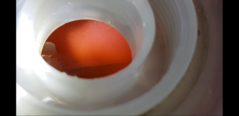

Its quite easy really, but it depends on the coolant tank used.  There are three types out there.  First tank has no teabag and no option for a Silica teabag - single skinned - best option.  Second one is a single-skinned tank, but with a silica teabag.  This is good, because the silica teabag can be fished out (carefully) by a (small) pair of hands or carefully with some thin-nosed pliers [take care not to split the bag].  The third one is the most difficult.  Its a double-skinned tank with the silica teabag in-between the two layers of plastic....no hope....forget it....get yourself a new single-skinned tank.
As to which one you have, I cannot answer that; it almost seems completely random on what was available at the time.  You will have to investigate yourself.

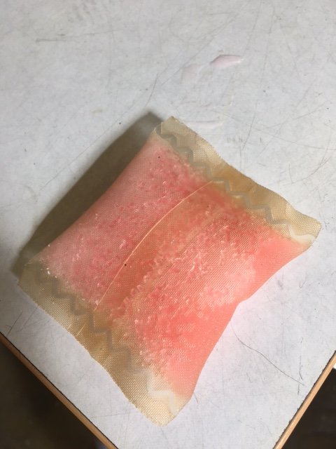

Min had split on a 2015 car with under 40k miles. I didn't video the removal, but do tell you how to take off the expansion bottle so that if you break the bag, it won't do any harm.
HTH

Good enough for me :thumbup:  I've just been out and oiked my silikat bag out.  Needed point nosed pliers to gently manoeuvre it to a portrait style vertical position, but then it came out with ease.  I'd be surprised if it took more that a minute, all in.  Bag was thankfully intact and undamaged.
Gaz

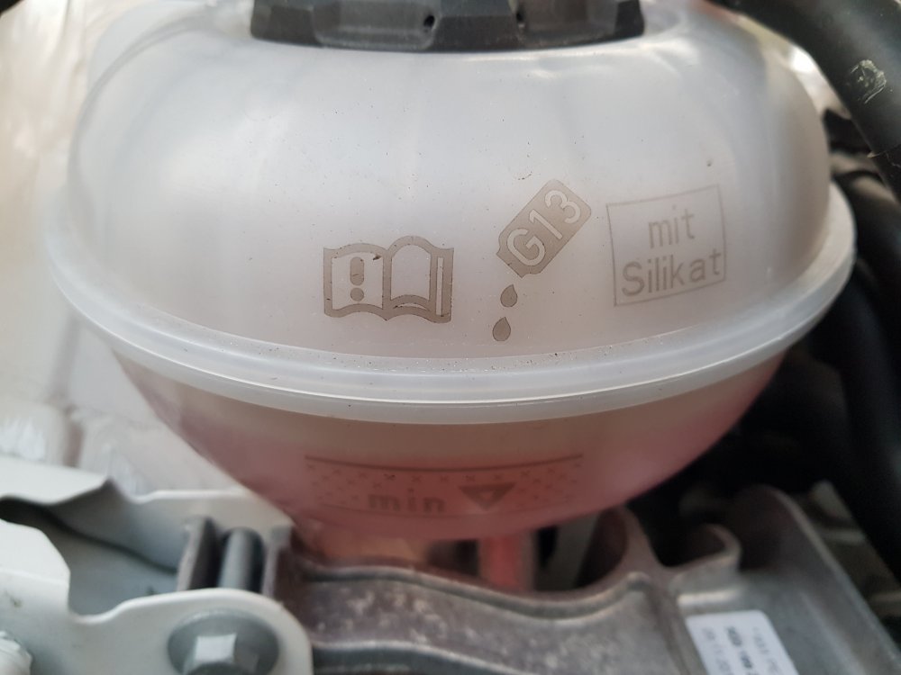

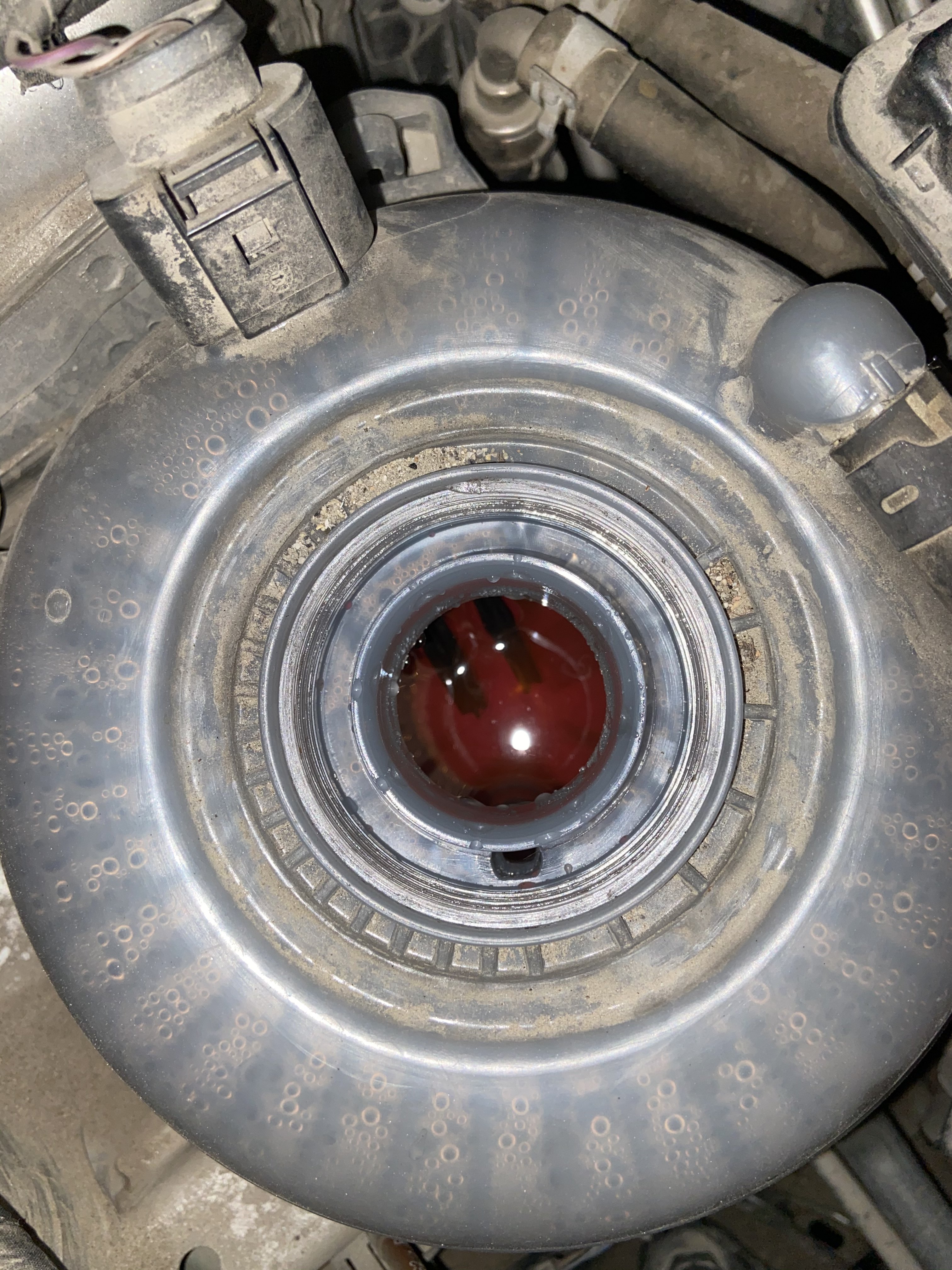

I decided to remove the silica bag on my car today after seeing the “mit silikat” label on the expansion tank, but unfortunately mine isn’t in the inner reservoir... Wondering is it in the outer one meaning that I have to replace the whole expansion tank, or it was removed by the dealer at some point?

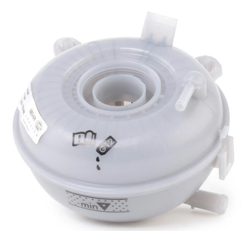

Btw have you noticed that those expansion tanks without silica bags have label saying G12 coolant; those with the bag inside are labeled with G13. Is the coolant type related to the existence of such bag or I’m overthinking it? :thinking:
The new VW genuine one doesn’t have g13 or g12 on it.

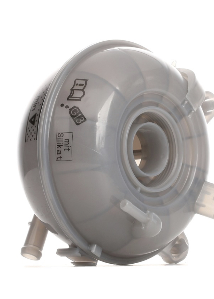

Do you guys know the exact part number? Stealer have 10x expansion tank models ending with different letter 5Q0121407[A,D,F,G,J,M,P,Q,S,T]? Wondering which one excludes the silica bag in it? :D
I won’t comment the coolant type, because I saw a coolant newer than G13, but named with previous number - G12-Evo... I think this one is only for Hybrid/Electrical vehicles, but I don’t think they know either :D

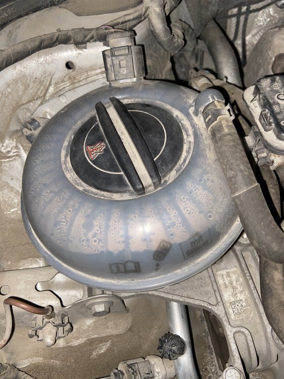

Does it depend on the engine type too? My 1.2 TSI has a double double walled tank but it does not say “mit silikat”.
Edited by Rodge
Mine 1.8tsi has G13 mit silikat and there is a bag on the engine side.
It is completely random on what tank you have.  Some have them...other's don't.

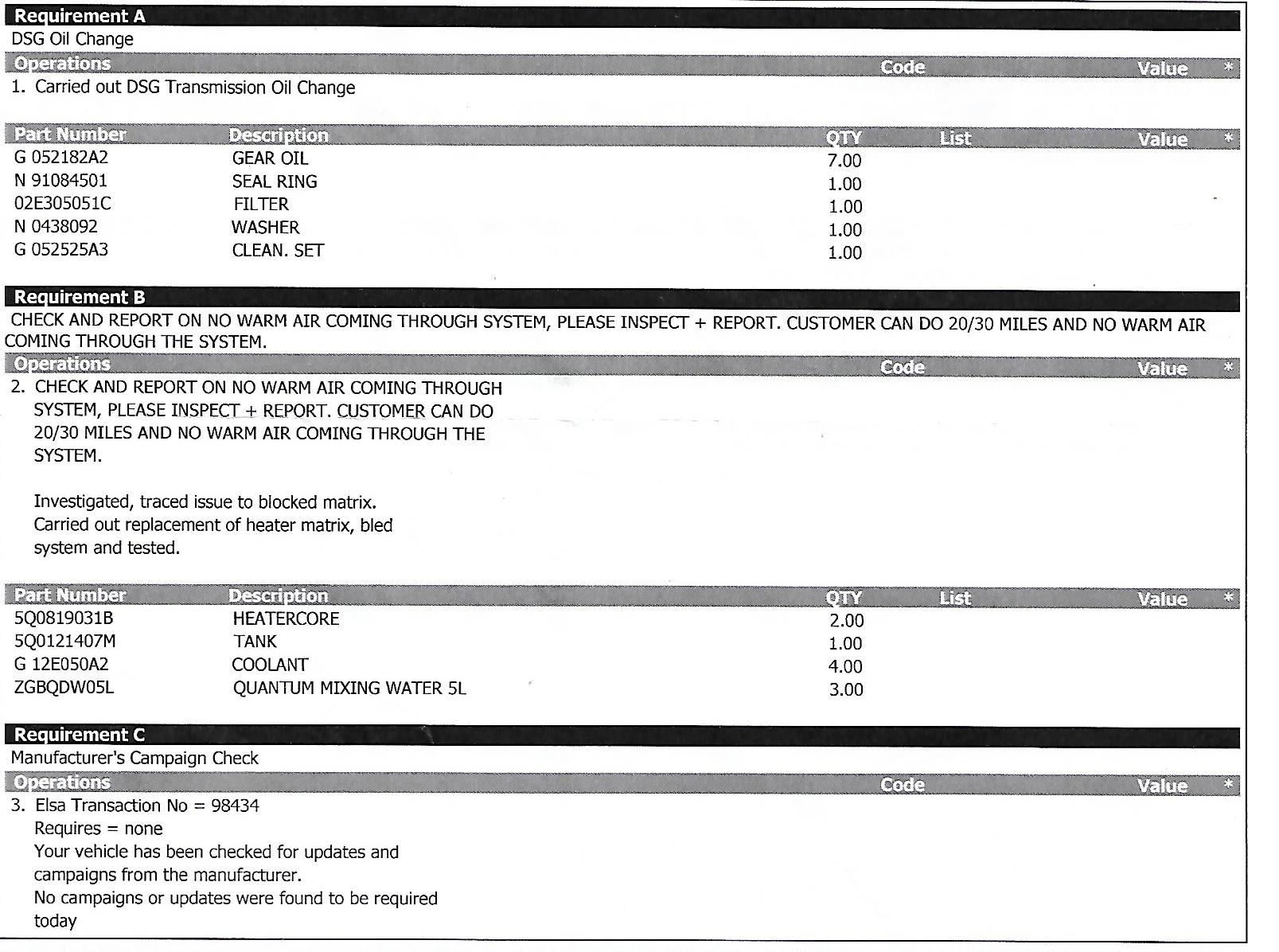

Just had my 2014 2.0tdi done under warranty, it took them 3 weeks, two heater cores and countless flushes to get rid of the crap.
Thanks @Blootoon!

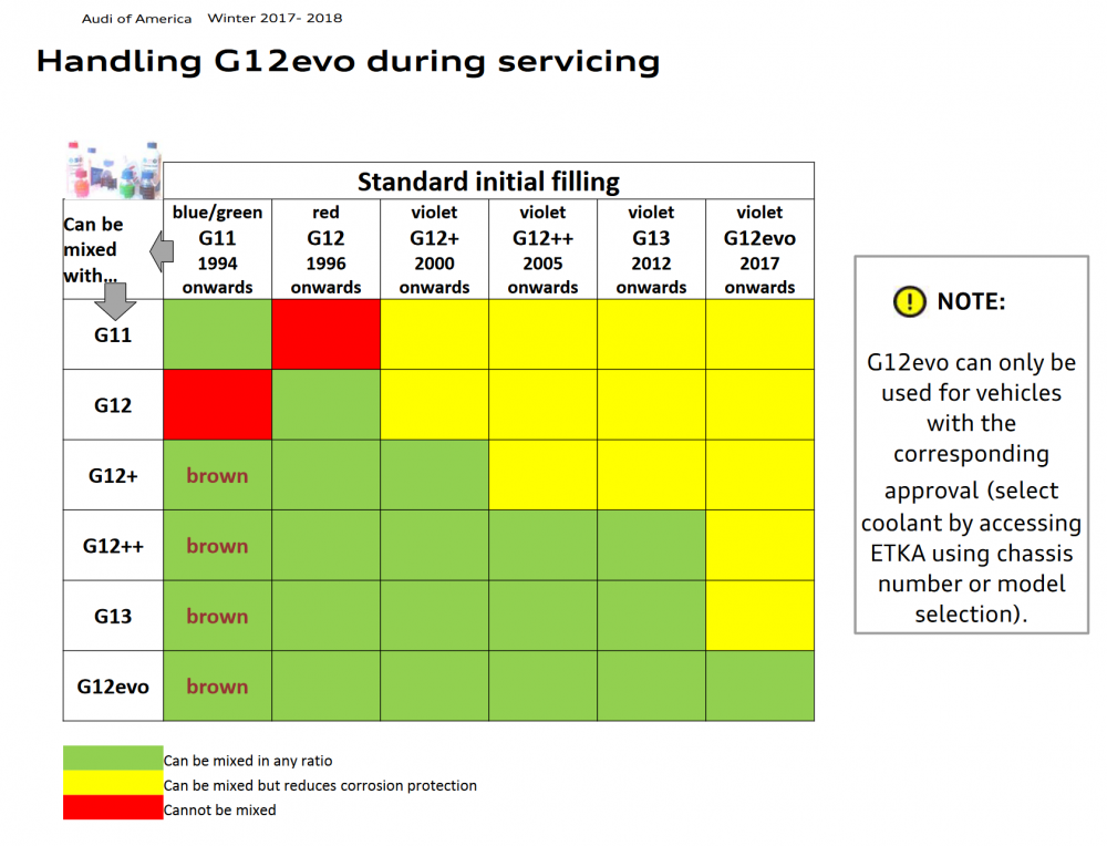

I'm a bit confused why they put G12evo coolant in his car( p/n G12E050A2 )?
Does the G12evo compensate the lack of silica bag in the expansion tank? 2019 Octavias with the new expansion tank from the factory(5Q0121407M) having no silica bag in it, exit with G13.
