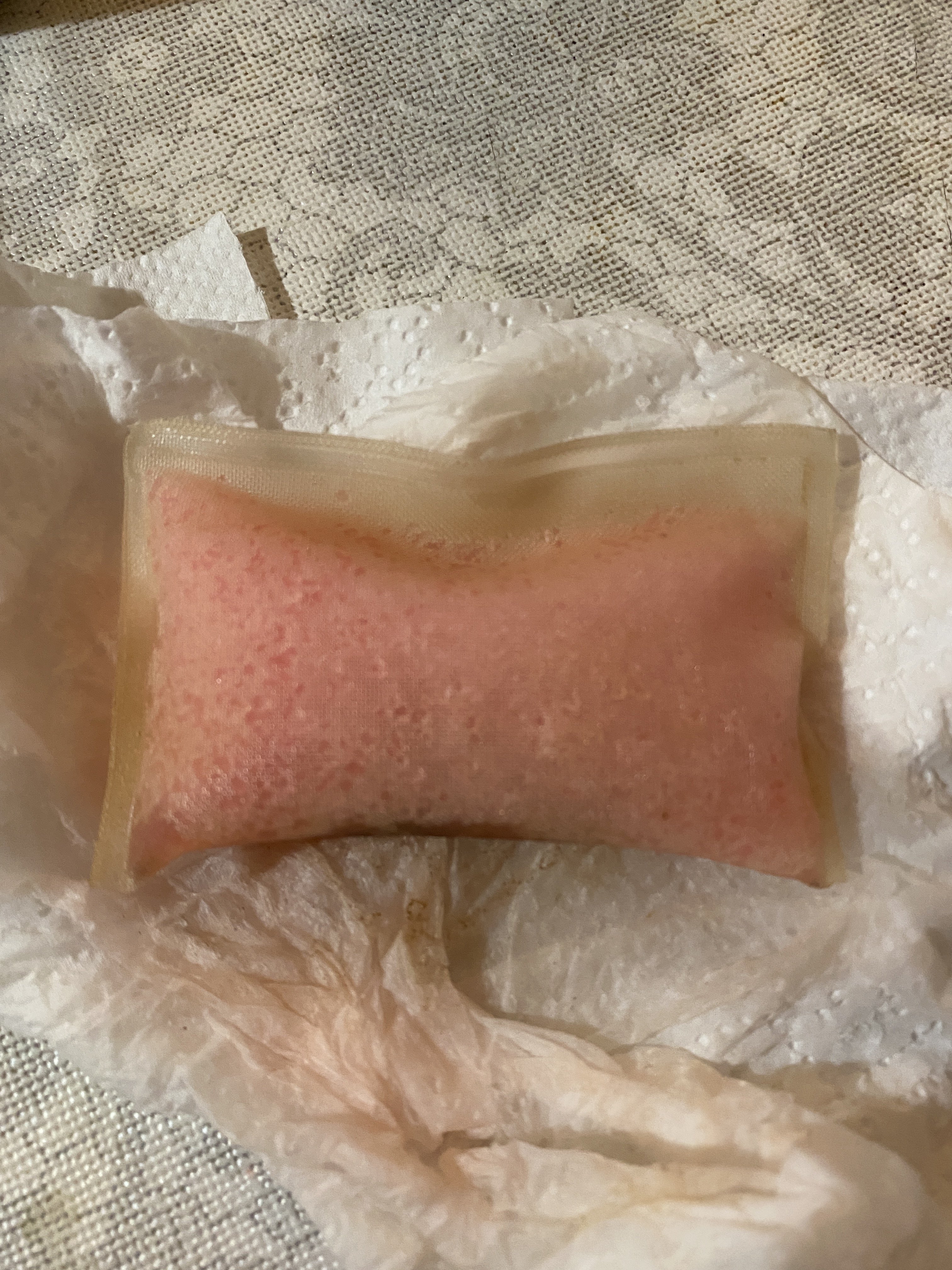

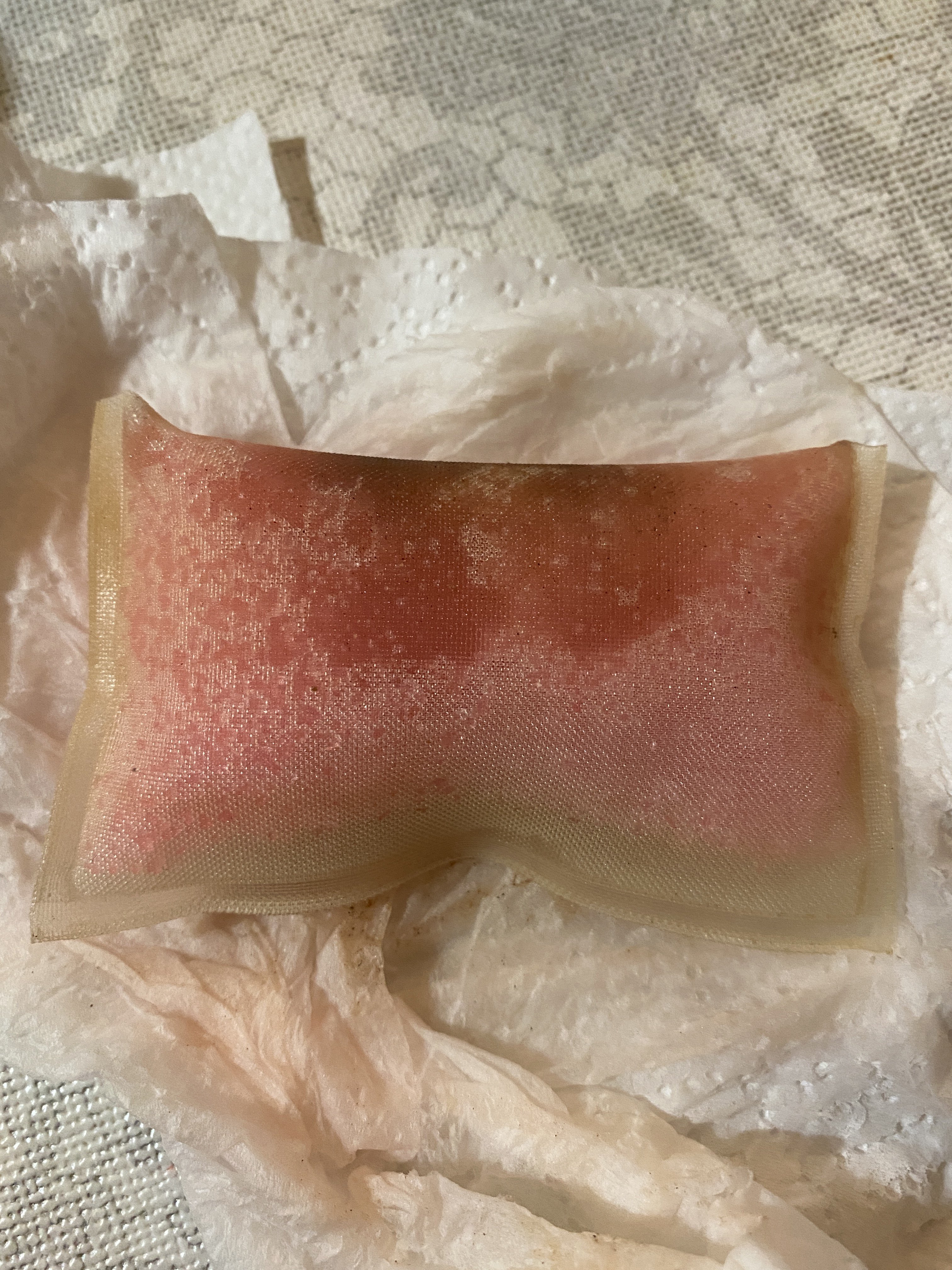

Used long pliers and fingers. It was very easy to wiggle it out into the tank and a bit harder to actually pull it out of the tank. Under a minute job with tank I have.

As several have already mentioned, I managed to remove mine with long nose pliers, scratched fingers and patience. Wasn’t too difficult, the hard part was getting the bag safely through the neck of the bottle. Gentle movements to avoid tearing it, but success, followed by topping up with a little G13.
