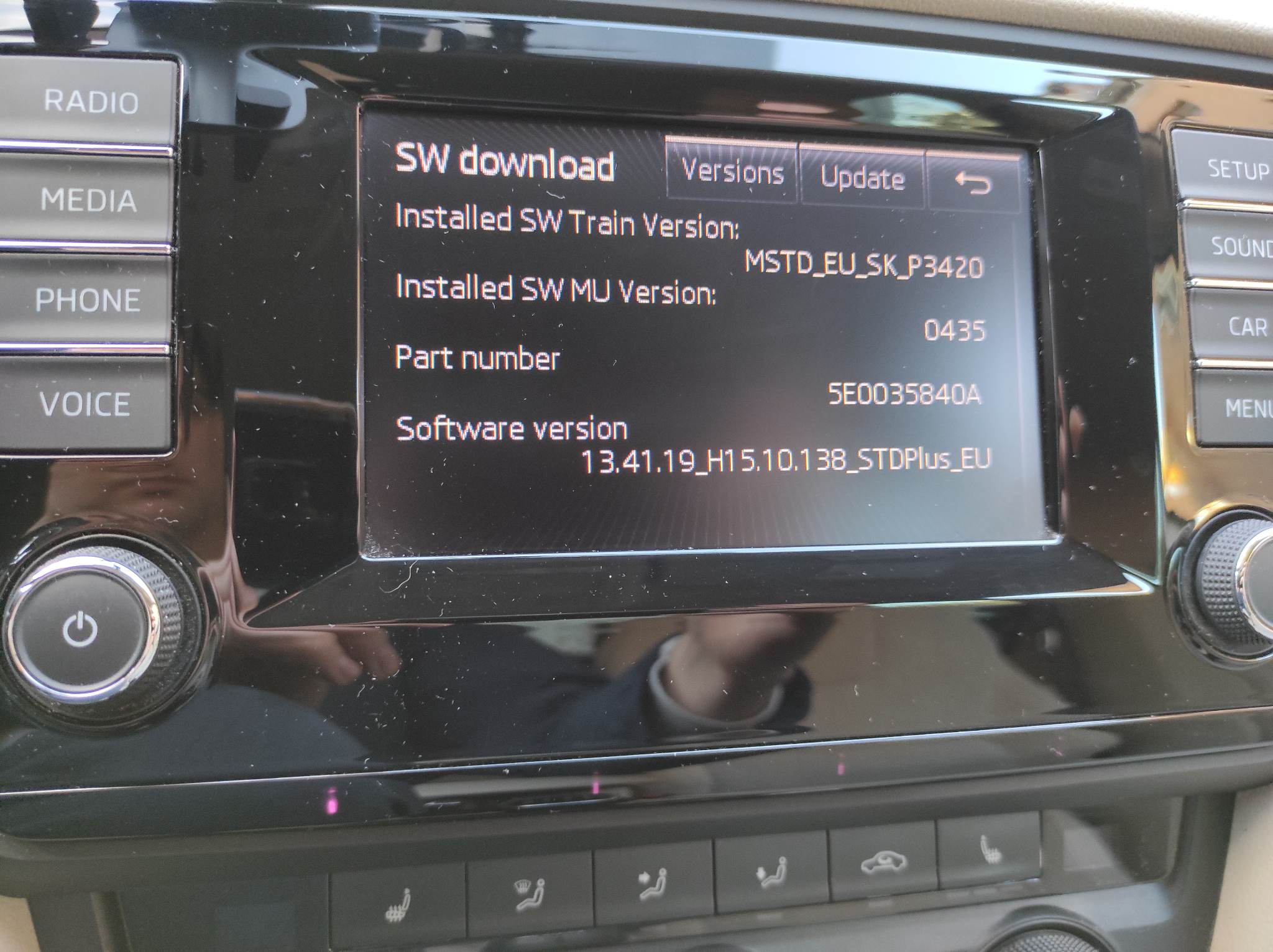

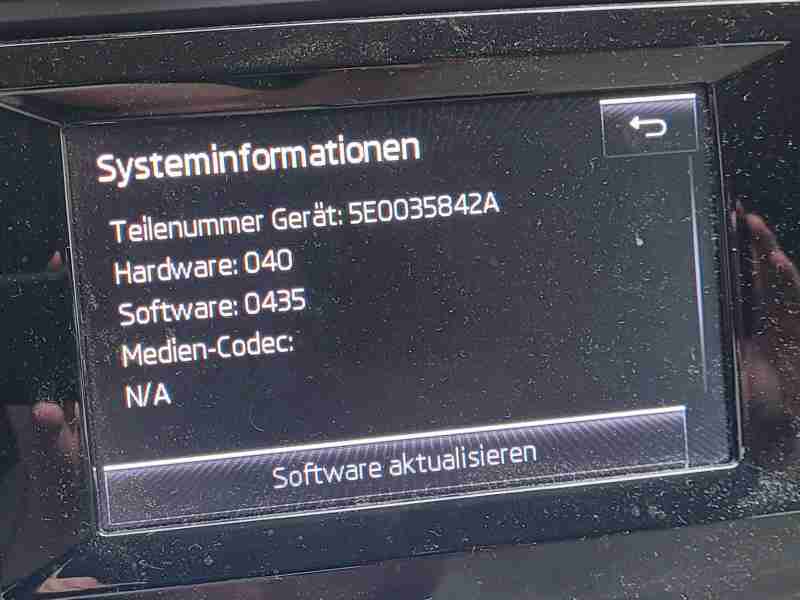

Hi, i would like to update my Bolero unit, details below. Are there any unlockable functions?
Yes, you can have an update to 0490 version, no idea of any functions you can activate.

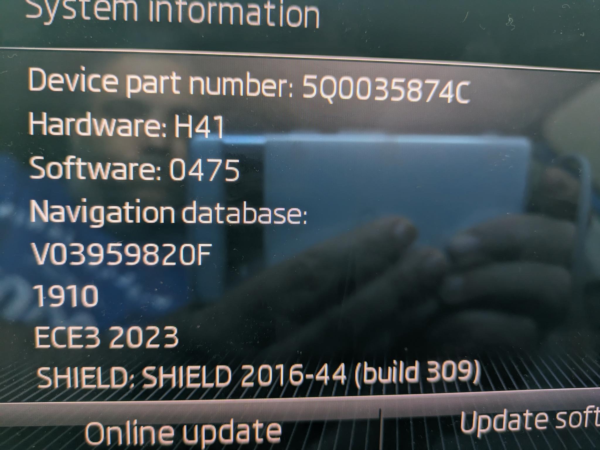

Hello, could you please send me an update for this one?
Thanks in advance!
Thanks in advance!
Yes I can send you an update

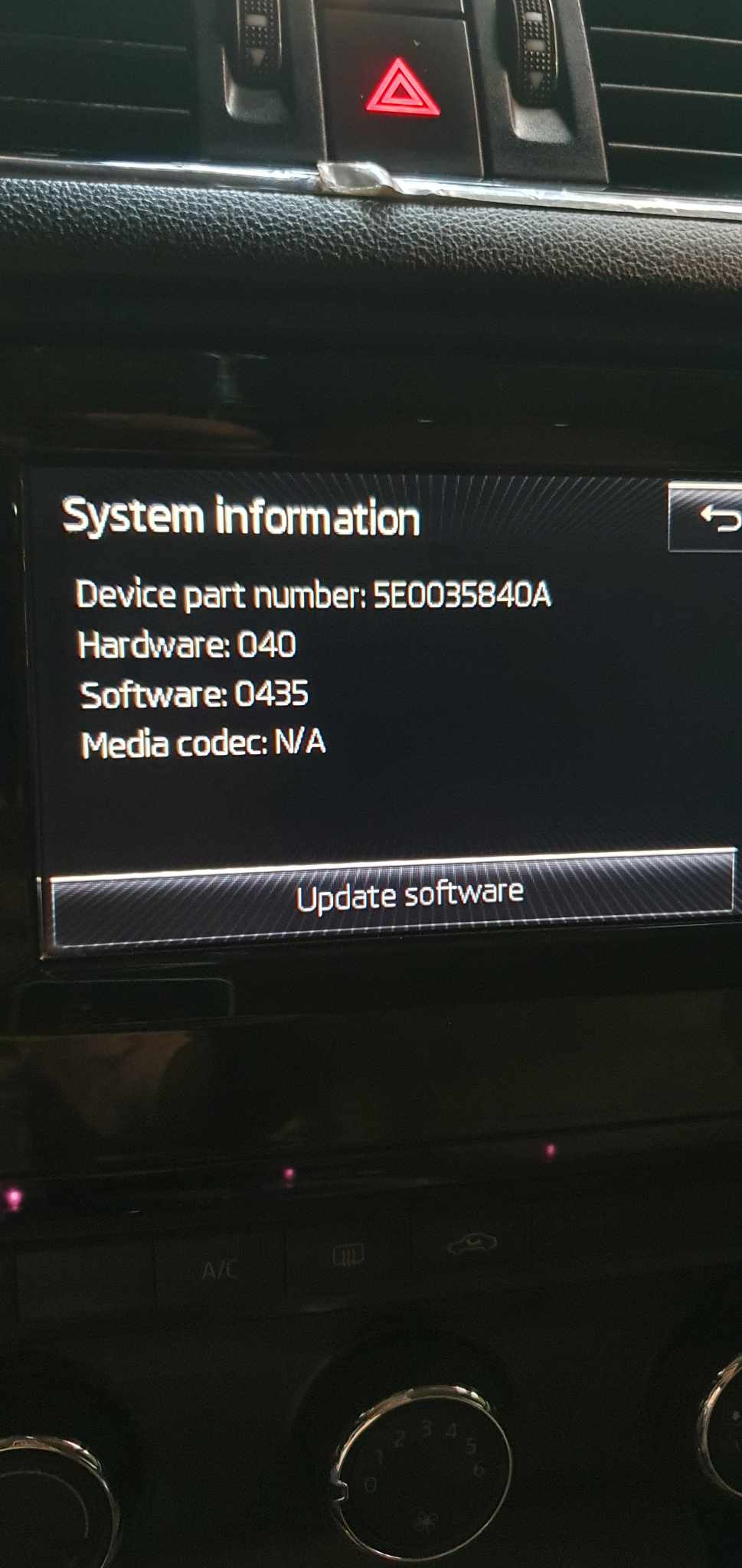

this my device any help with link
i download these file but SD not working?
can this be done by USB?
This should be done with SD, started from Service Menu (lon press MENU button)

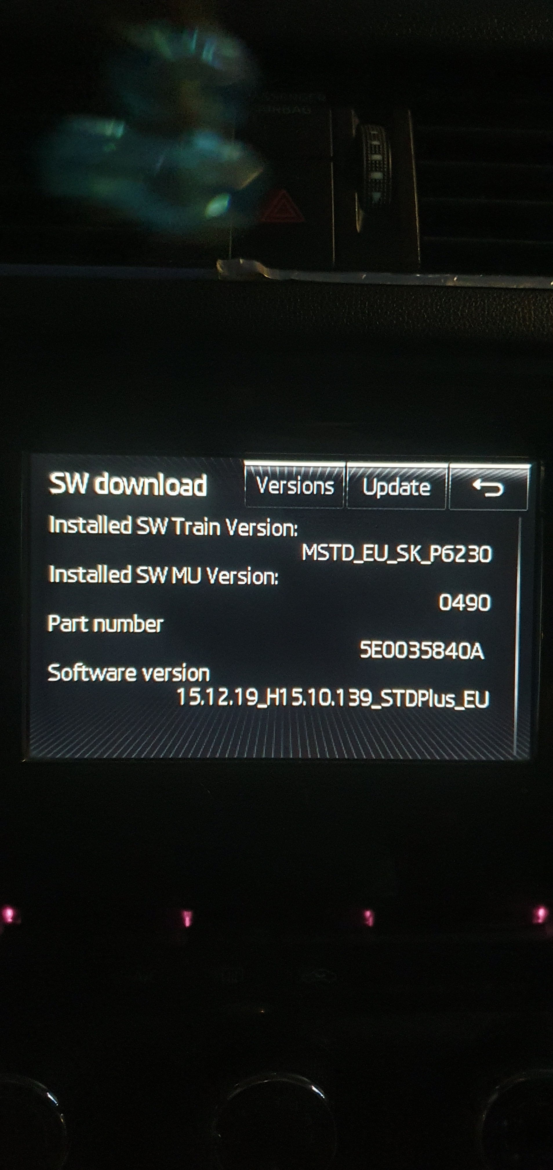

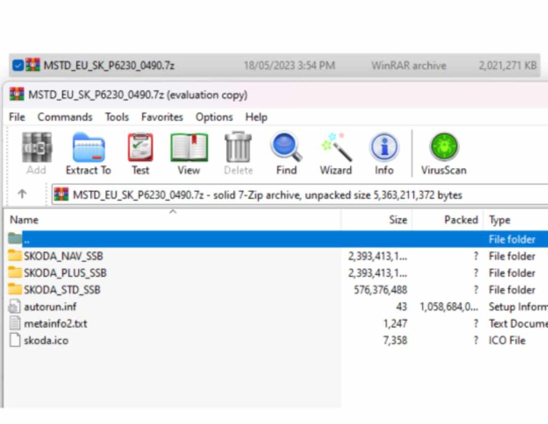

You need to extract that compressed 7z file to the root of an SD Card, so extract all to M: for example.
And as said by Pab567, you need to be in engineering menu... so press and hold Menu/Setup button for 10 seconds to find page where Software Train is seen, and use that update button.
Forget about USB
The correct screen shown here, and press the update button in this location.

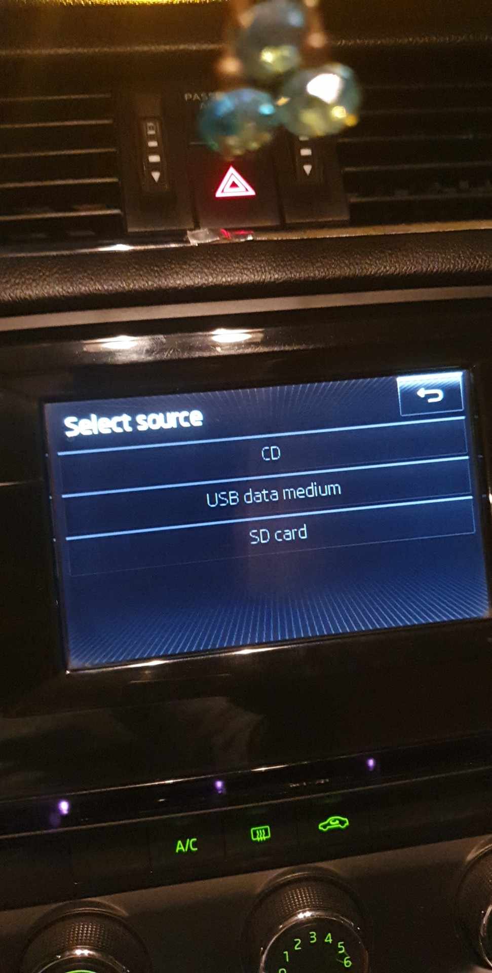

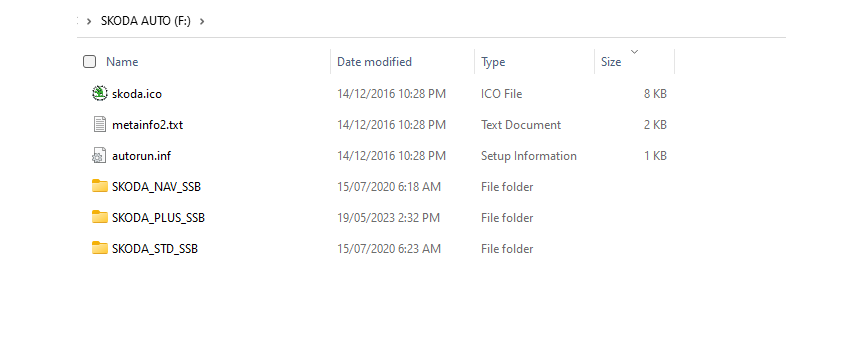

this what i found no SD card Slelected
i format SD card form windows and just copy file to it
what do u mean by Root of SD card?
By "root" of SD Card, this means the bottom folder.
Some will make the mistake of creating this kind of path
F:\MSTD_EU_SK_P6230_0490
When it should be extracted to...
F:\
As seen in your image above

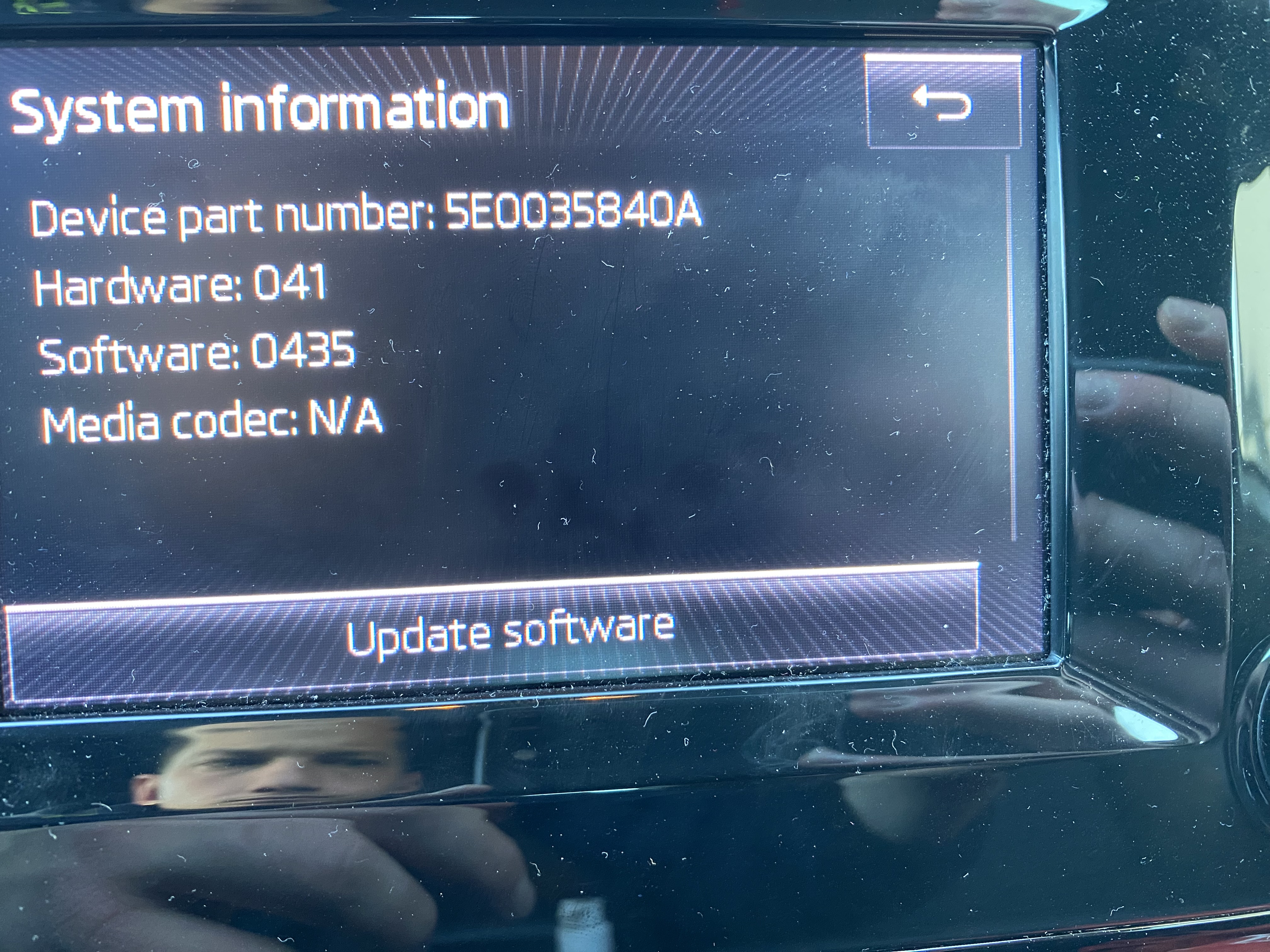

Hello some version for MEN2_EU_SK_P4350L cant find any on mib-helper
7675784.thumb.jpeg.844528c0465cab19fe83f7cd992d7a9b.jpegHello,
Update for this one if available?
Having problems getting android auto to work with it.
Thanks in advance!
@batgruyo I will send you a link to 0480 version
