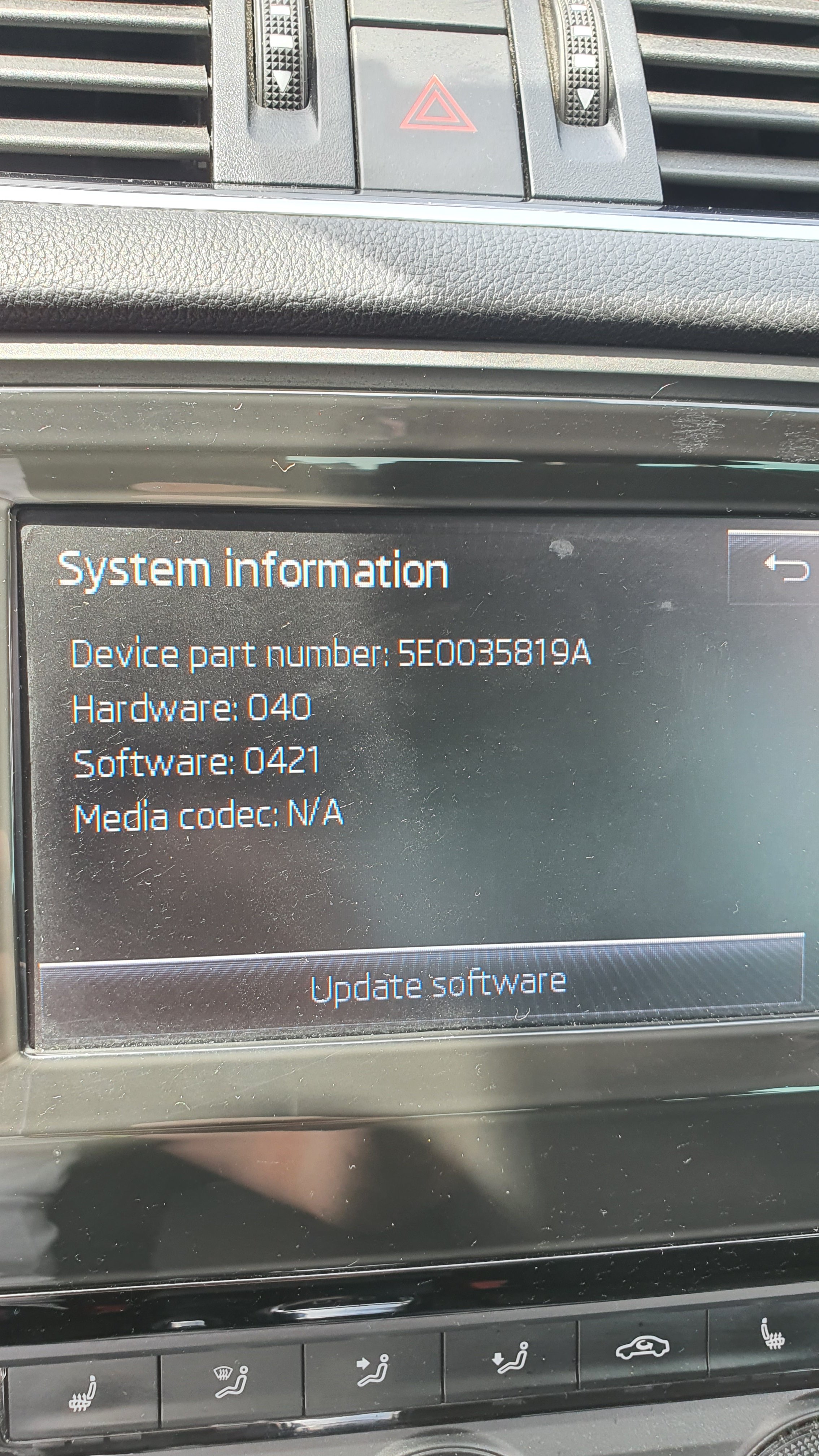

Hi, would you send me update for this one?
P.S. No need, found it and successfully updated.

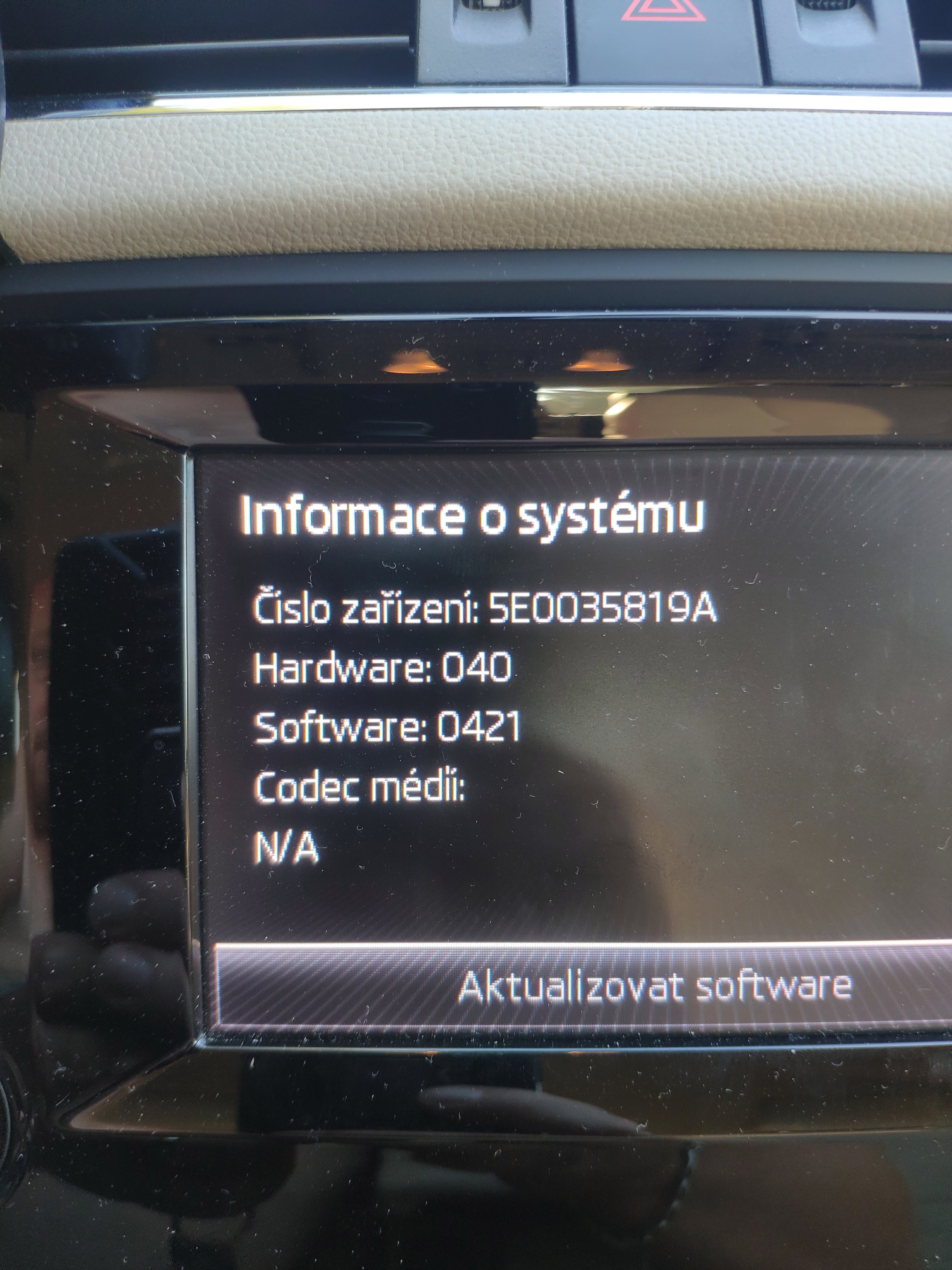

Thx

You should hold down the menu key and enter special mode to get Software Train information
I think you have MSTD_EU_SK_P6230_0421 written as your Software Train
MSTD_EU_SK_P6230_0490 is available

Hi, I have _P3163...
I shall send you a private message in a few minutes
MU is "version"
Edited by varooom

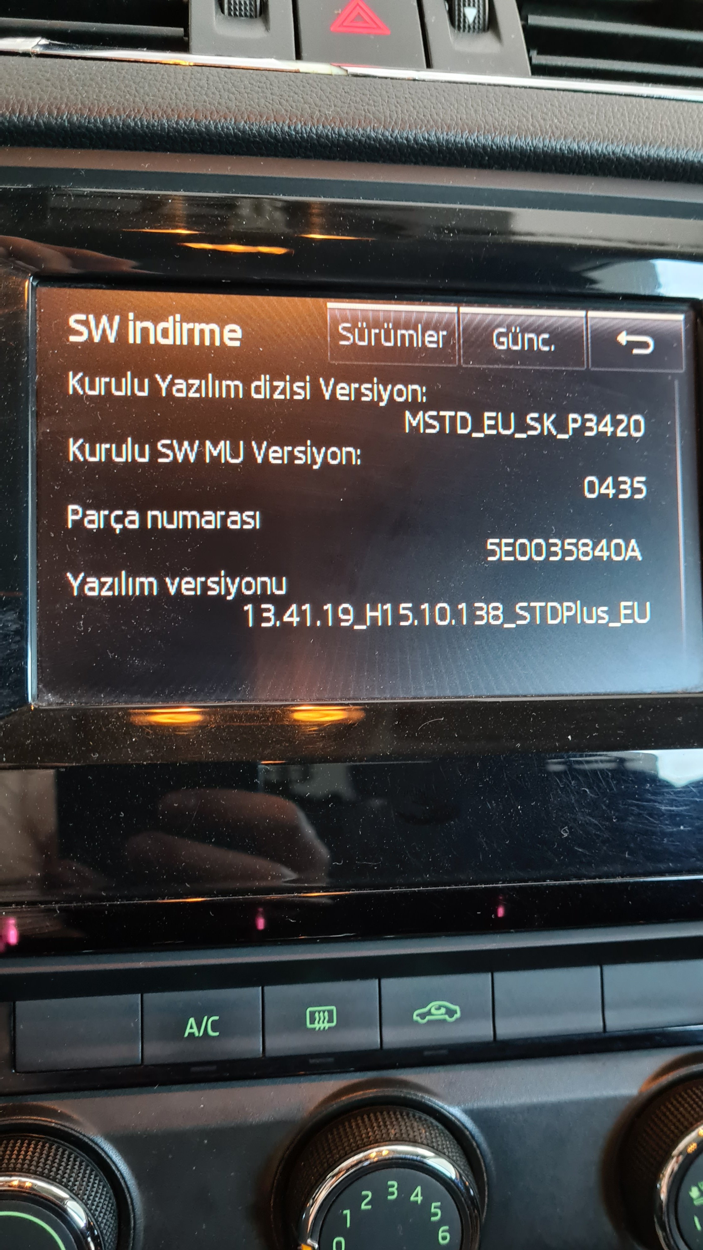

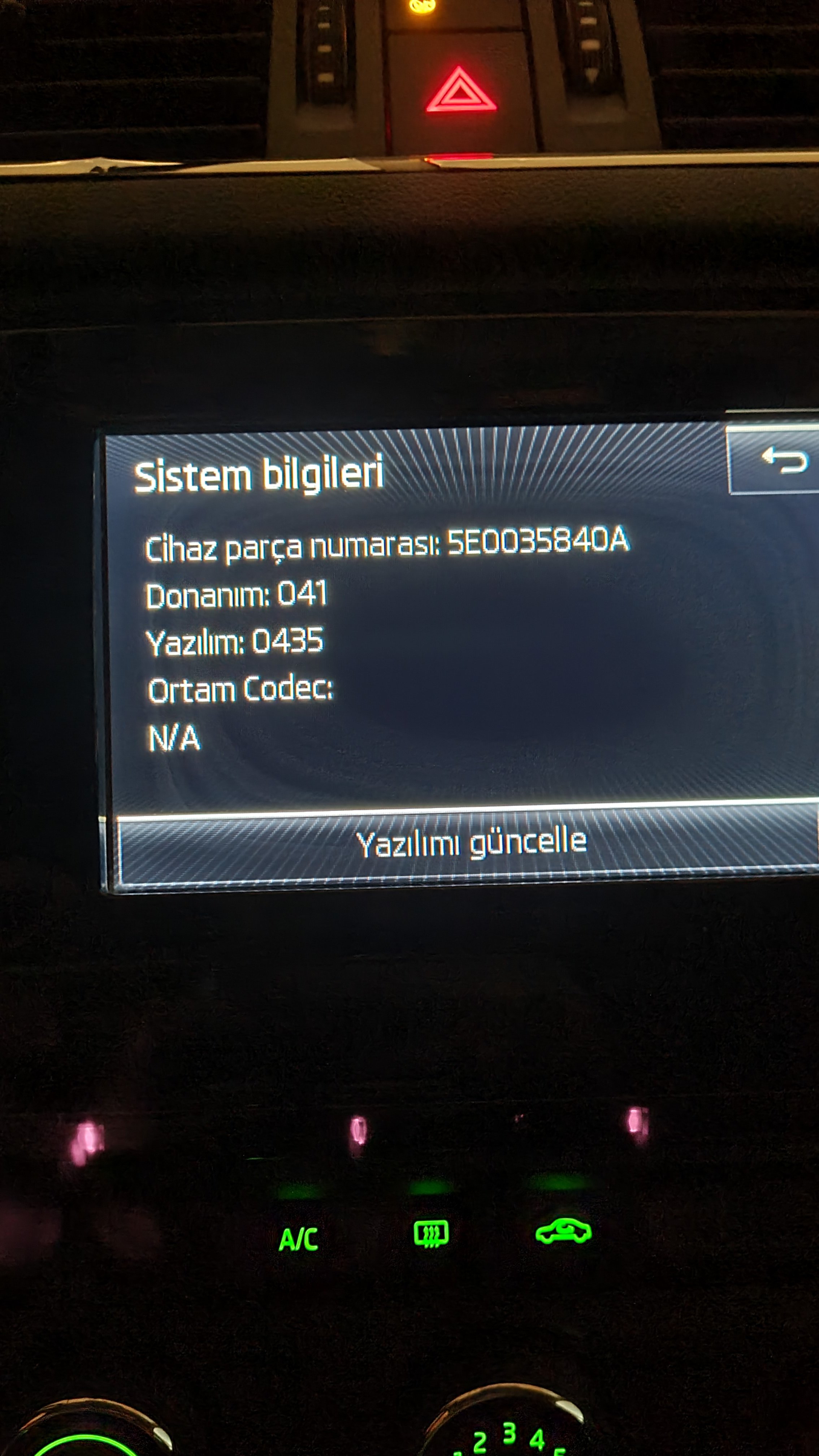

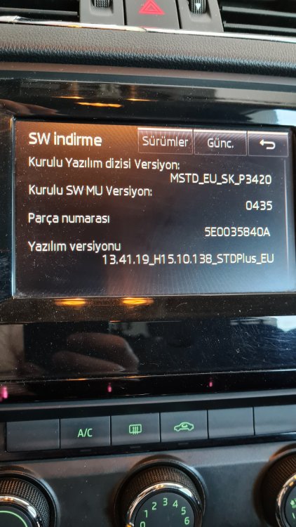

Hello, can you help me for update file
Current Software Version 0435
@Maestroy You should hold down your menu button to get into the hidden menu
Will need to see your Software Train, to make sure correct file is sent.
It should look like this - MSTD_EU_SK_Pxxxx
Also you must be able to enter this hidden menu for update, no other location works.
And welcome to the forum
2 hours ago, Maestroy said:
P3420
@varooom
MU 0490 is available, and I will send you a private message in next few minutes @Maestroy

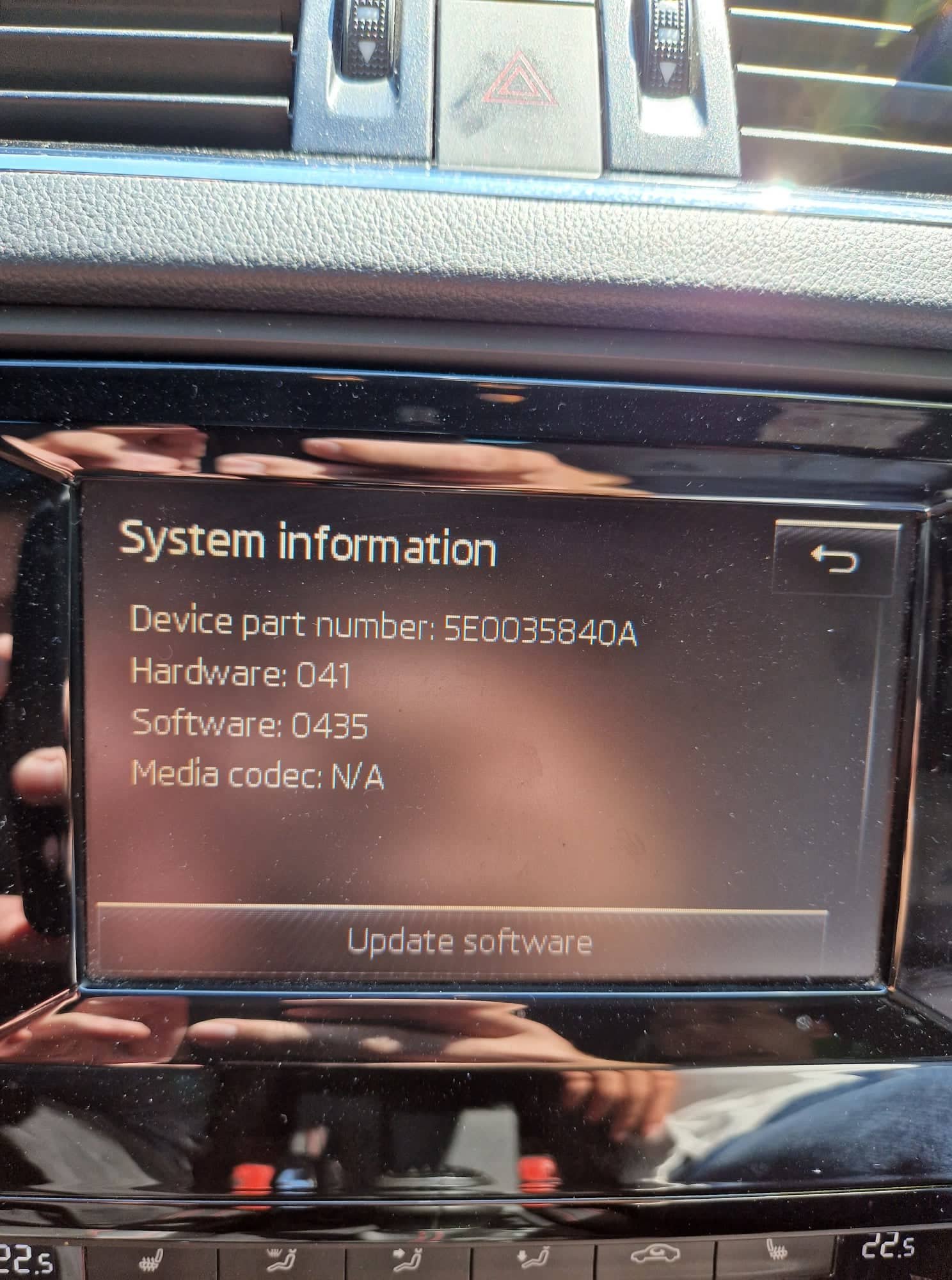

I would be super thankful if you could provide me with a link for a sw update of unit with part number: 5E0 035 840 A  --> if there is any new version.
It is running awfully slow at some times.
If anybody knows i would like to ask if it is possible to change the screen with a part number: 5E0 919 605 H
Thanks for any advice given, I would be very happy if I could update this unit, so maybe it will work better.
Regards.

As I am here, I can send you the firmware for this.
If you look up a few posts, you will see that you are in the wrong screen for update of firmware.
You are needing to press and hold Menu button down until you enter the hidden menu where you can see Software Train, and the REAL update button.
@pab567 I can send the firmware as you are probably offline, though he has question about changing of screen your expertise would answer.
5E0919605H is MIB2 screen so glove box unit must be exchanged as well

Thanks for the answer, so that screen is not going to work for my case. It is hard to find a good replacement because of the CANTON speakers and amplifier, the android upgrade is not possible...  Are there any replacement screens for the  5E0035840A unit? -- is there any compatibility list available, so I could find a replacement... (touch doesnt work on a small area and it's frustrating)
Thank you for your reply and advice.
Nope, they are not... If you have CANTON then stil you can get Android Auto and Apple CarPlay - you need to retrofit display unit, glove box unit, CANTON power amplifier and USB.

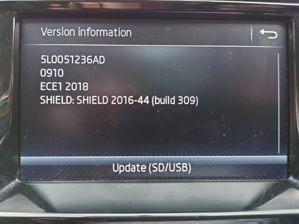

@pab567

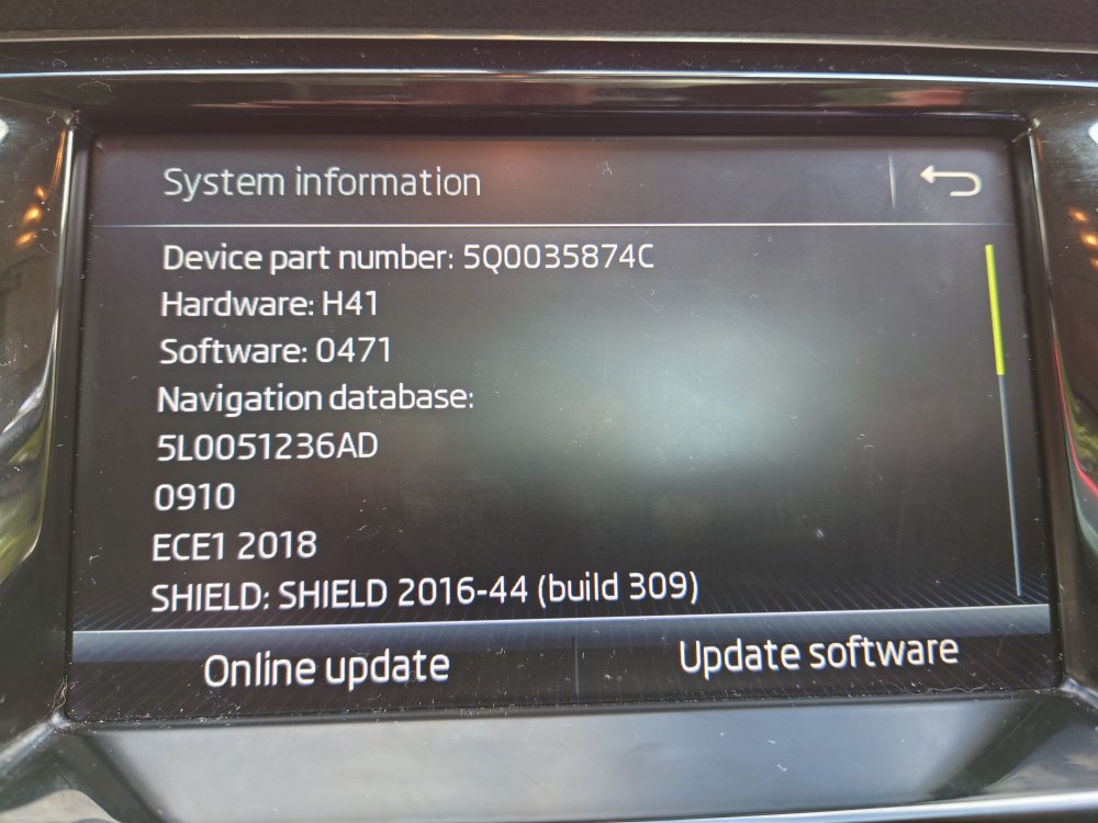

Hi, sterling work you're doing!
Do you have a link to update the below?
What you sent is maps info - do you ask about maps or firmware?
Thanks so much for your reply.
Initially I was looking to update my maps but to be honest I don't really know what I'm doing!
I've just brought a 2018 Skoda Fabia Mote Carlo.
What would a firmware update give me?

I was not sure if @pab567 was responding or busy with work, but firmware can fix issues with say Bluetooth connectivity and other issues that you may experience in time.
Sadly they don't exactly publish a changelog of faults with new firmwares, you have to read TPI (Technical Product Information) document to piece together the possible changes.
So you may or may not need a new firmware, but sometimes it's a good idea to update along with the maps so you can know you should have less errors.
Maps can be found by inputting VIN here, https://updateportal.skoda-auto.com/ and we also have links in the forum that you can optional use VW maps (newer generally and you can use happily on the unit as they share technology)
p.s. If you hold down your Menu button, you enter the section where you can update your firmware, and read what Software Train is installed.
If you are curious about the existence of an update, then this is the image you will need to supply.
Edited by varooom

FW download link you have on PM, maps can be downloaded from Update Portal
