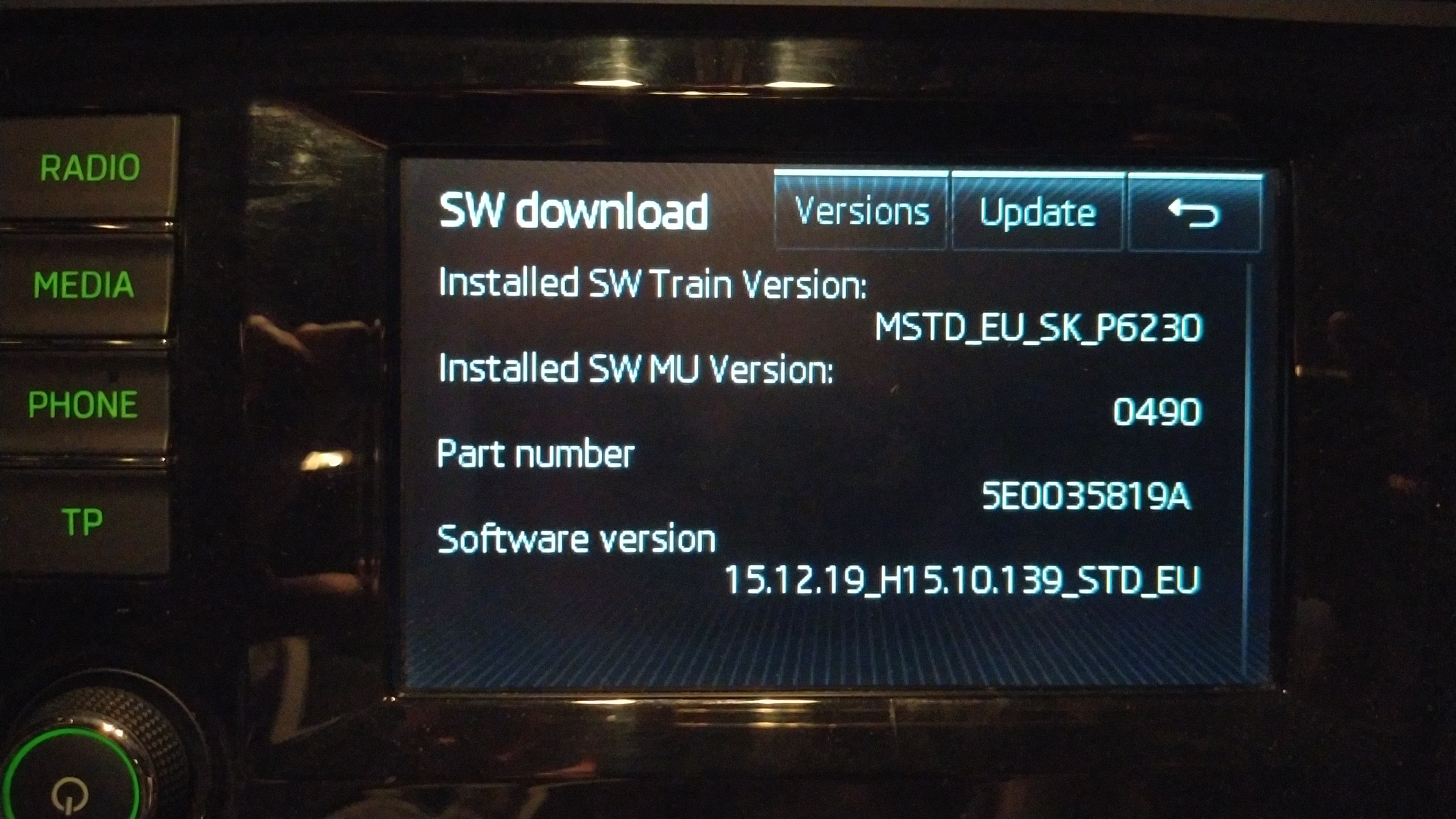

Download FW https://easyupload.io/p9xaox MSTD_EU_SK_P6230 (0490)
Unpack archive to sd card or pendrive (min 8 GB) fat32 file system
Unpack files directly to root folder of mass storage so the car could see it
Prepare charger for battery in your car
Connect charger so battery will not lose voltage when update will proceed
Turn ignition on, engine off
Press menu button for about 3-5 sec
Get into service menu
Choose right mass storage usb/sd card
Follow instructions
DONT'T turn ignition off while update
All at your own risk - there is small risk that you can brick your unit
Good luck

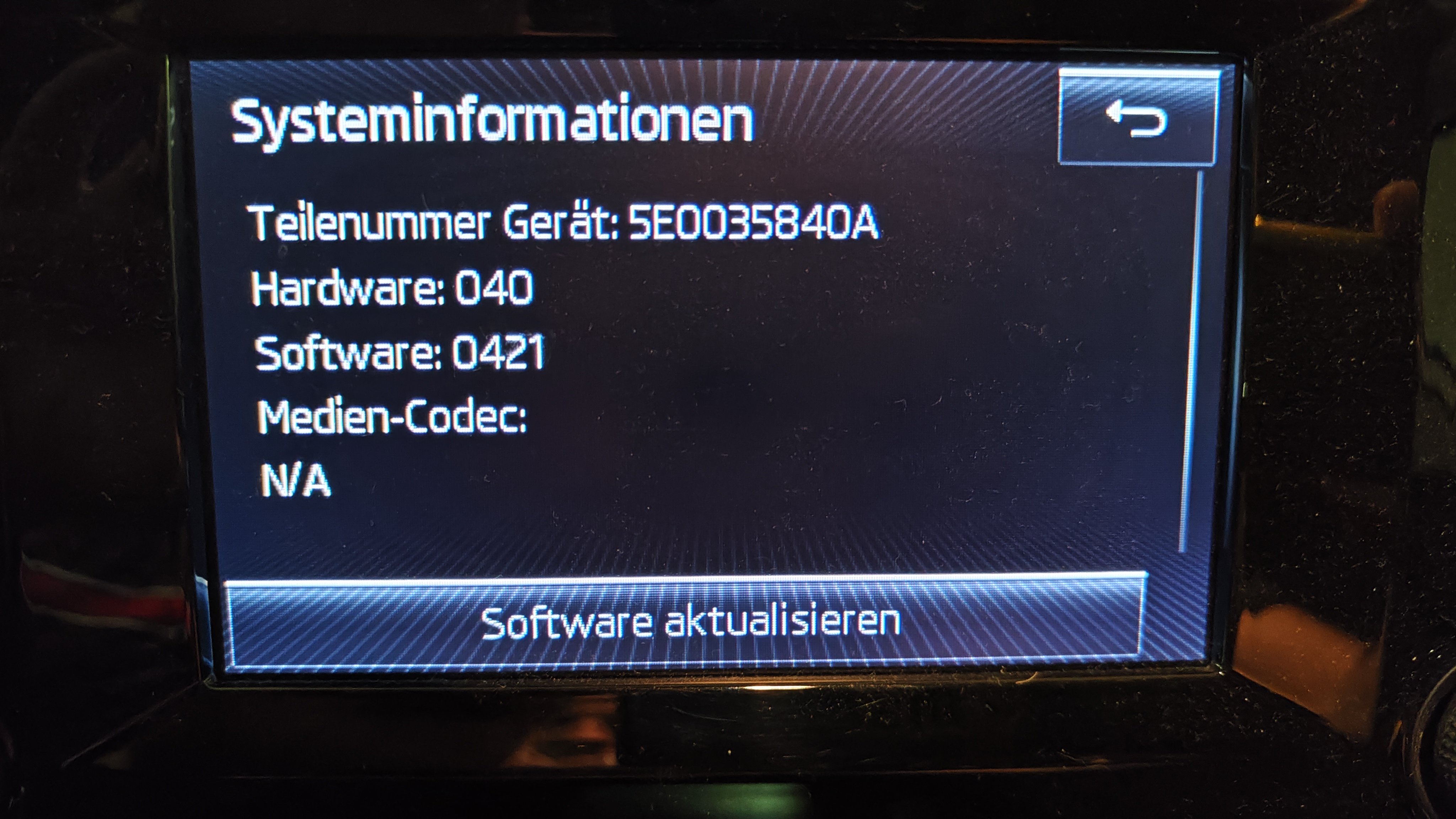

Hi,
@pab567 have you please a link for a software update for Bolero2? My current version is 5E0035840A,
Hardware 040,
Software 0421.
My car language is German.
Many thanks in advance!

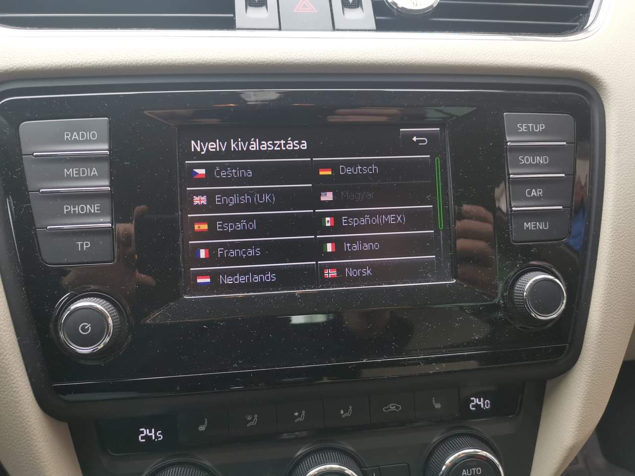

On 2023. 10. 29. at 19:44, Bazsa77 said:
Helló!
Az első két kép az enyém.
Hogy tudnék ehhez magyart adni, mint a második két képen?
Ezenkívül a MirrorLink vagy az Android Auto aktiválható valahogy?
Helló!

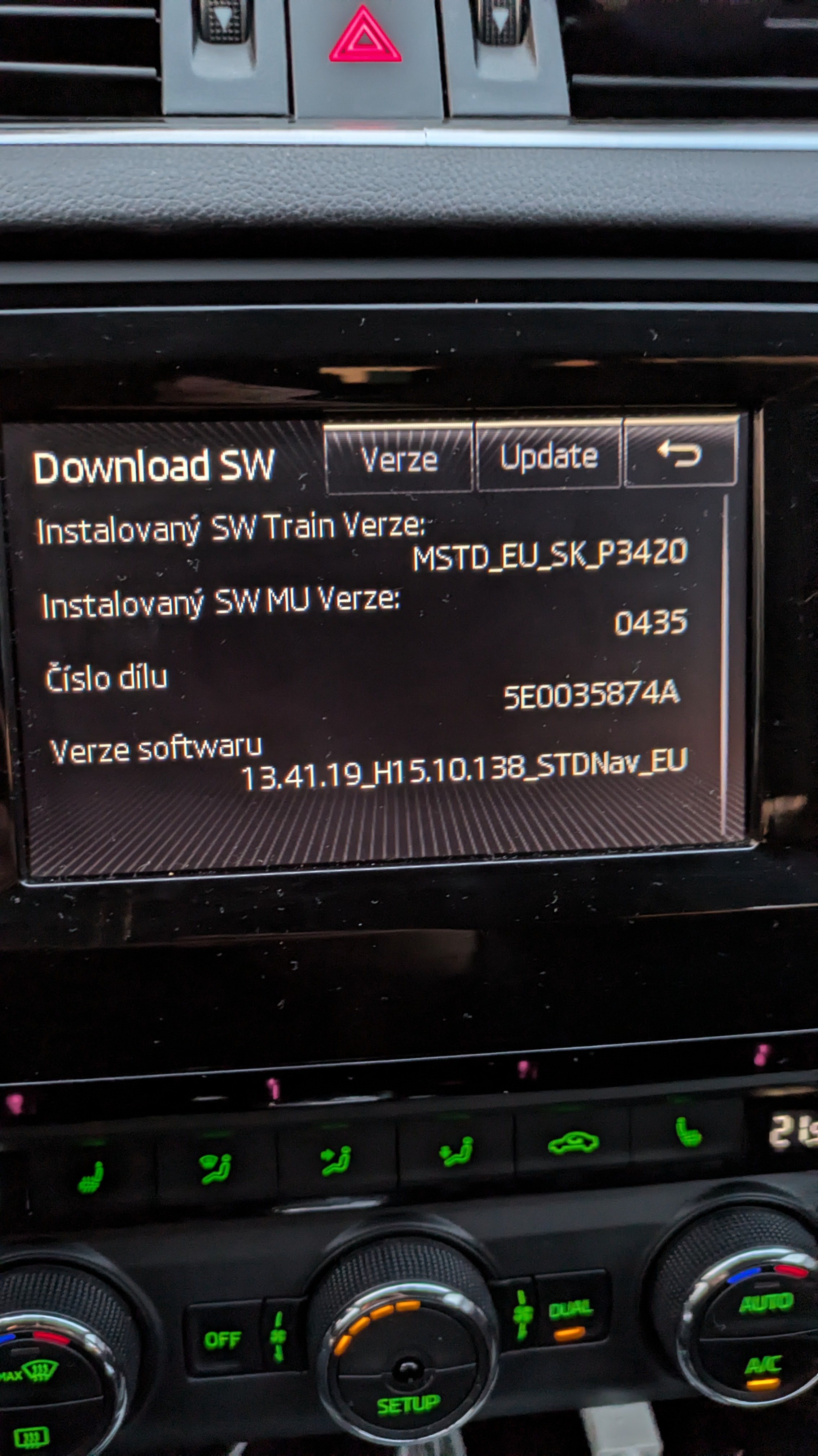

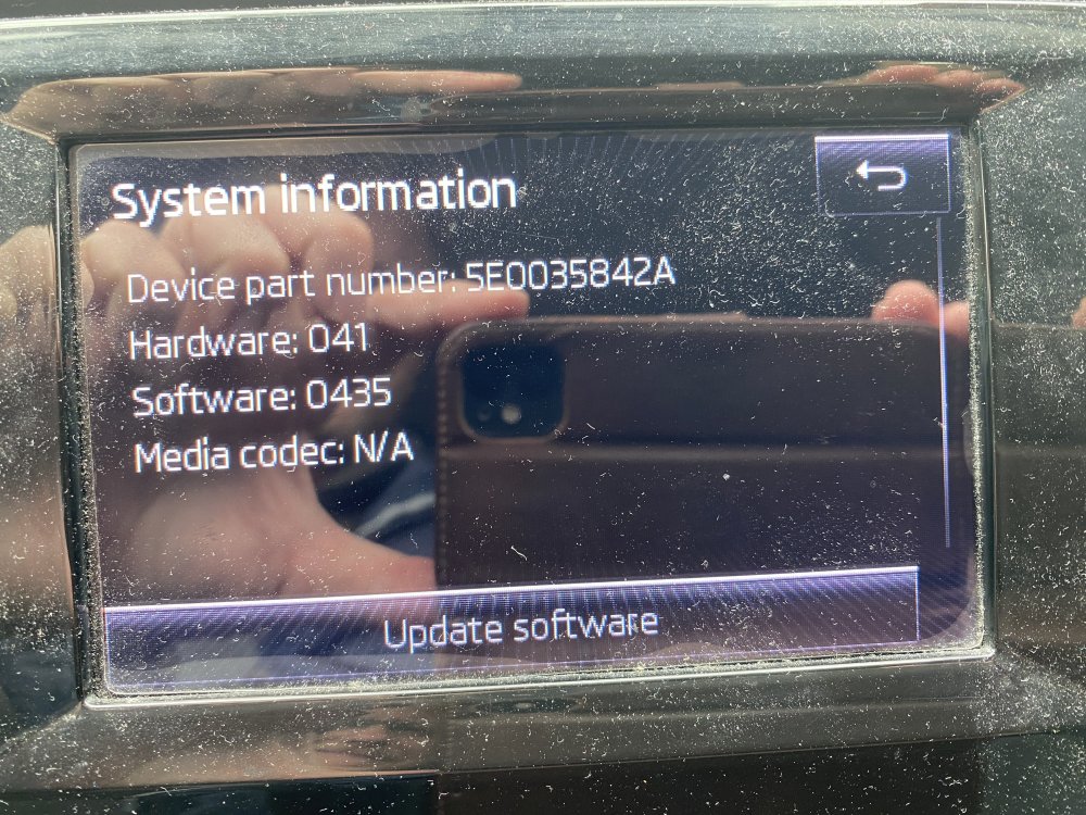

YA khochu obnovit' mul'timedia moyego avtomobilya Skoda Octavia 2014 goda.
Mozhete li vy pomoch' s versiyey MIB1 0435?
