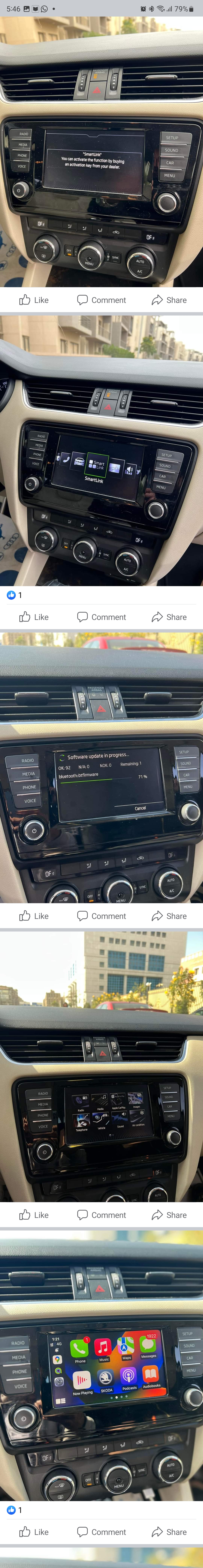

Hi @pab567,
Appreciate your help if there is an update for my unit, and whether this update will unlock smart link or not, as I've learned that there are software updates that could unlock this function.
Someone actually updated similar unit and has the Smartlink working (attached the screenshot)  but have no idea which software is that.
Thank you in advance.20230209_171559.thumb.jpg.70702165aed53e19752a4a50dae45f65.jpg20230209_171607.thumb.jpg.a8335203e9e038c398a041184c8231b9.jpg20230209_171617.thumb.jpg.f6dac49cd3ccf5869073803df02ebb8d.jpgScreenshot_20230209_174656_Facebook.thumb.jpg.6ab8134d810afcfa8eeddc4af4fa888a.jpg
You have a mib2. Use the mib2std toolbox or update to 253 and install the 253 pre patched file to activate smartlink. All avaliable online for free.
The screnshots you have shown they have also updated to 4xx.

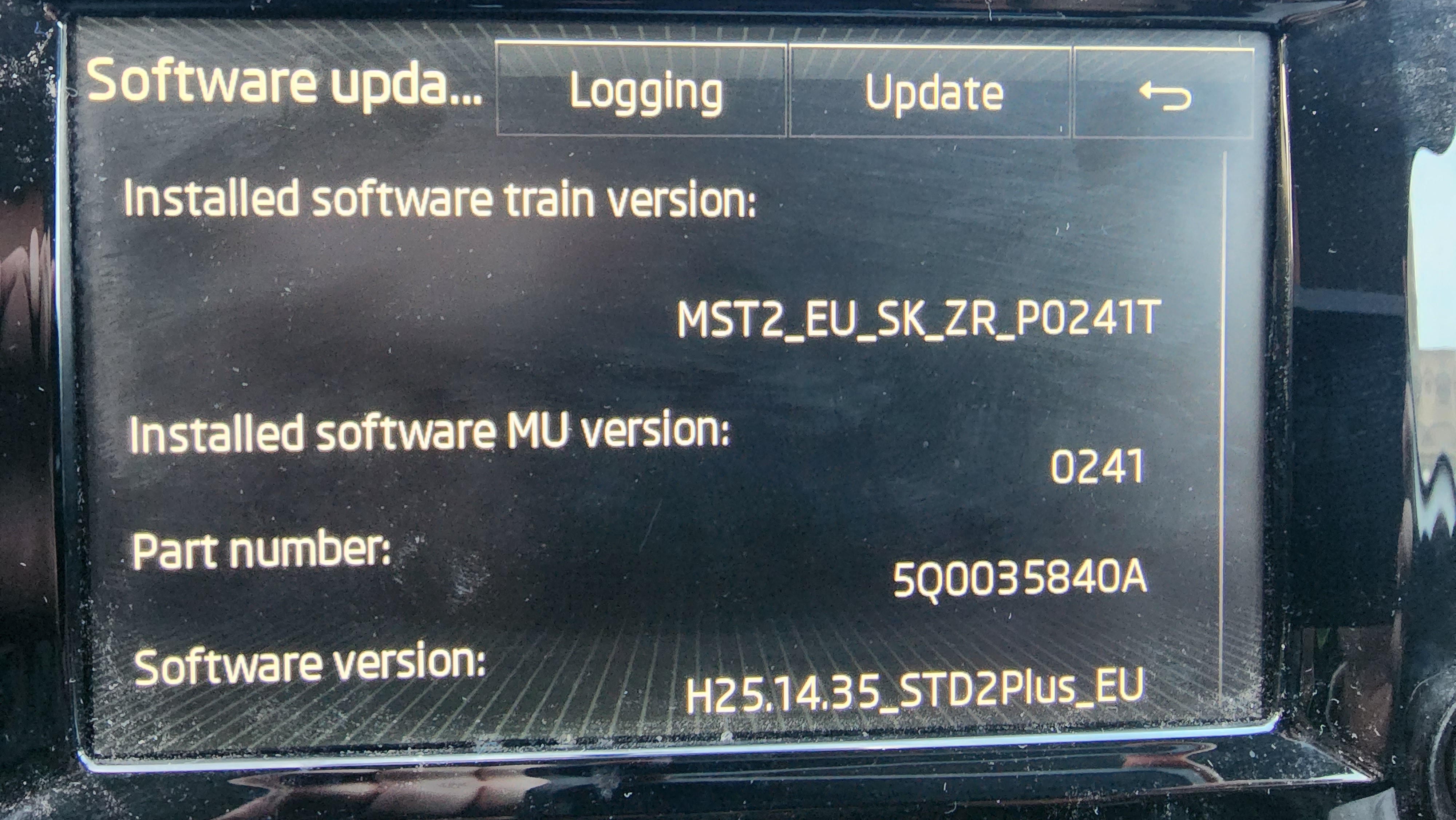

how can help with a update to my infotaiment plz ???
Welcome, you should press and hold the Menu/Setup button for 10 seconds to enter the hidden engineering menu.
MST2_EU_SK_ZR_P0241T  <-- Hopefully you find this version
MST2_EU_SK_ZR_P0253T  <-- Available
The screen you find is the update location also, so it will be a good idea to find it now.
