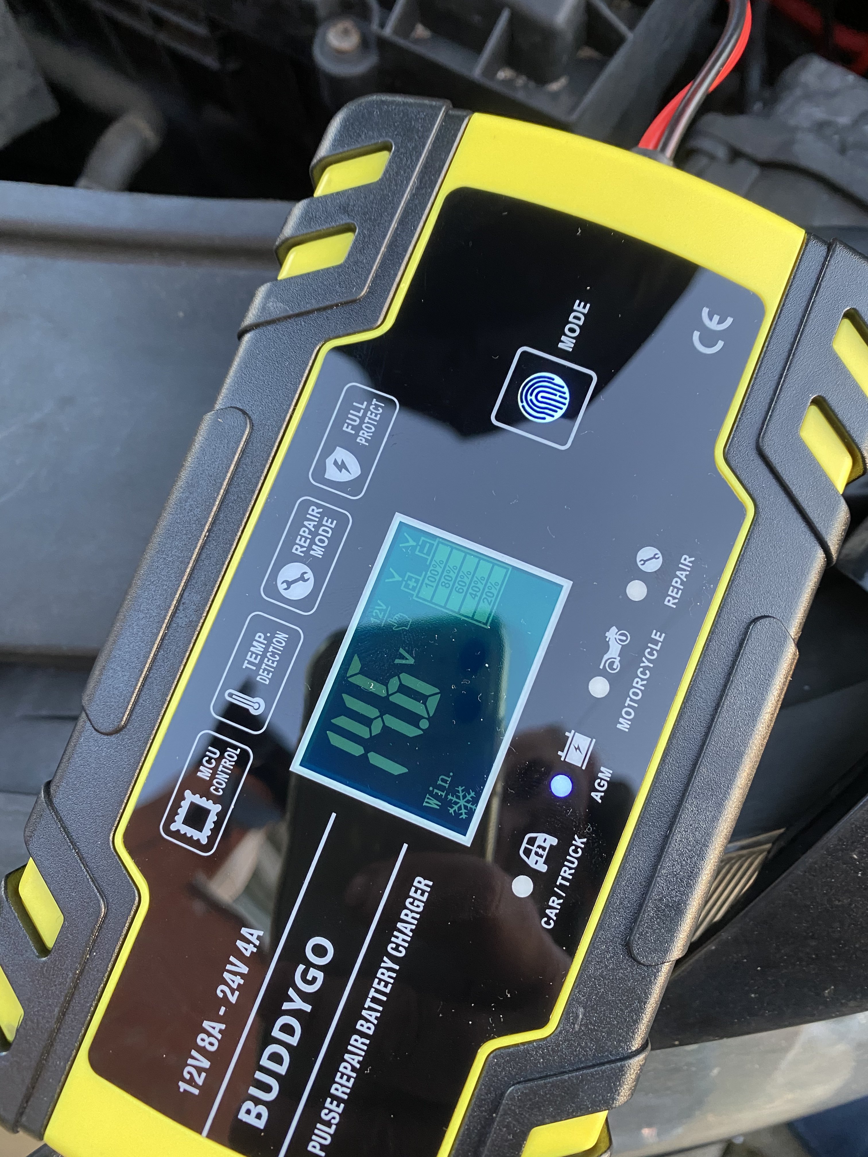

My charger (details above) has arrived. Plugged in and off we go. It’s in AGM mode as opposed to repair mode.  Battery was showing at 40% so let’s see how we get on.
stats:
14.6v
3.0A
5’C
winter mode.
stats:
14.6v
3.0A
5’C
winter mode.
