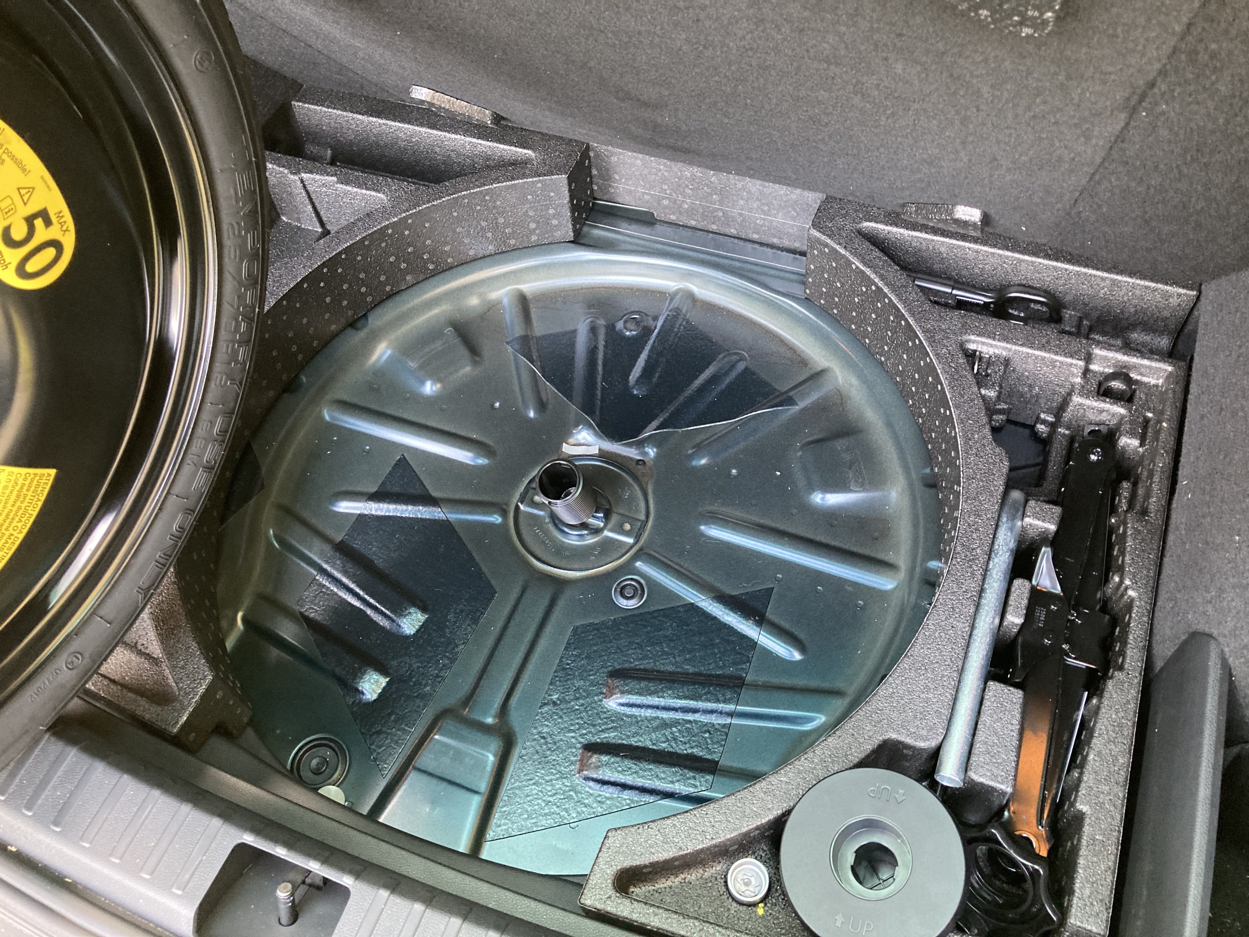

Is the spare wheel loose
There is a large screw that sticks up from the bottom of spare wheel well.  My memory is that it is a bayonet fitting (like a light bulb) except it can turn all the way around and fixes in two positions. In the loose position it will lift out.
There should then be a second black plastic "top hat" that screws down on the screw above fixing the wheel in place . The "top hat" also supports the boot floor.
If you have the "top hat" piece in position and the two are turning together, then in the resistance position try unscrewing it while pulling.

DSL's picture is like mine showing the "top hat" unscrewed (and sitting at the bottom right hand corner).  The centre screw wobbles enabling you to get the spare in the optimal position before tightening.
tom
Yep, as here with spare in place.
The spare is slightly undersized for my standard sized tyres, curious as VAG do a spare that is exactly the right size/rolling circumference.   :angry:  Not really an issue for me as I carry a full sized alloy wheel in there. :thumbup:
