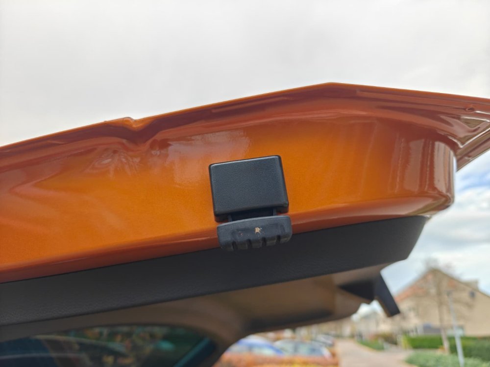

So...is it the trim or the actual tailgate itself?
My first call stands, the bump stop on that side.  I don't know how to adjust it.
https://500px.com/photo/1027904224
Hope the photo works. I'm using 500PX and can't figure how to find the link on their website to get the photo to appear here.
I got it to an email draft and copied the link from there
tom
Edited by Sanqhar
16 hours ago, gigolo456 said:
Last resort was to press the butt of the handle HARD against the intersection of the boot floor and the actual tailgate, ie directly below the rubber pull-down handle, so just between plastic boot floor lip and the tailgate!! Low and behold, NOISE COMPLETELY VANISHED!!!!
Glad the old broom ploy worked for you! I can't get to our Karoq at present and hence can't advise on tailgate locking mechanism/catch adjustment. In theory, you are forcing tailgate away from car body wiith the broom which would indicate that the bump stops (assuming there are any) are not extended sufficiently to maintain pressure on the lock catch when it's connecting to the 'hoop' on the car. The tailgate seals probably provide a degree of pressure, but not enough when you hit a bump and cause the tailgate to move.
Unless someone else here can help more re adjustment of bump stops or whatever else is involved, I'd video the noise with and without interaction of the broom and show it to your dealer so they can't say 'can't replicate any noise/rattle sir'.
Just seen Sanqhar's photo. Assuming the bump stops could be adjusted, I'd move both sides equally so as not to result in unequal pressure between the two sides of the tailgate. If there is no adjusting the bump stops, then the locking catch/mechanism needs to be adjusted to pull the tailgate tighter to the car/bump stops. That I would leave to the dealer in all honesty.
Edited by VRT24
Spelling
I have looked and searched but so far have not seen how to adjust them.
tom
Edited by Sanqhar

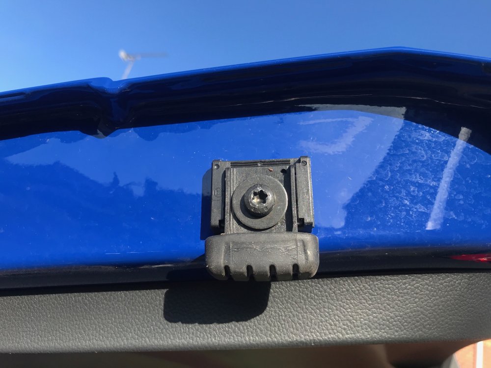

Making heavy weather of this guys........just pull the cover off with your fingers from the top and adjust as required......
Thanks  Berisford I couldn't find it anywhere.
gigolo456Judging by the ridges that can be seen it looks like it can be moved a millimetre at a time.
Count the ridges before you start so you can put it back to original if it doesn't work
tom
Edited by Sanqhar
Cheers, thank you! I'm assuming then that once the screw is loosened, you simply need to pull the rubber stopper down/up as required, and then pop the cover back on?
Thanks again..
Thanks again..
That's the way it looks to me.
You'll need a Torx bit, not an Allen key.
tom
tom
Cheers! Will try and adjust sometime this week when I can pluck up the courage lol!!
At least I know now (hopefully) how to potentially resolve it!!
I'm working off the premise that I'll need to lengthen the boot stops..
Adjustment is really critical, and watch for the lock catch getting too tight.
Cheers, will do my best!! Coincidentally, spoke to Skoda technician earlier, a mate from my golf club, and he's advised when I do adjust that screw in the boot stops that I loosen it, and then actually pull OUT towards me, then re-tighten!
I was under the impression that when I loosened said screw, I was actually moving the stopper vertically down so to speak!!
Surely if I'm pulling it out towards me and then re-tighten, it will simply go back to exactly where it was lol?? :blink:
Pull it out slightly to clear, move the rubber mount by one tooth and then tighten again. The stew locks it in the new position
Cheers, when you say move the mount by one tooth, will I know what you mean once I finally get round to doing it lol?? I'm assuming that as it's one tooth, it's easy to adjust both sides the same amount?
Apologies for being hopeless at what is probably very straight forward for most people..
Both components, the one fastened to the bodywork and the one held by the small Torx bolt have ridges in ‘em that ‘lock’ into each other to help secure firmly - it’ll be obvious when you slacken off. However, as someone previously mentioned, be sure to note where it is now, that is, how many groves/ridges are visible before you start.
As you loosen the Torx screws, try to keep the bumpstops in place, otherwise they'll drop away from their original position and you'll have the devil's own job to know or go back to where you start from. Three hands will help!
Try one side at a time,  then the other, then back to the first one, making tiny adjustments and check after every one. It will take time but otherwise you'll just be getting lost.  I thought my rattle was some loose trim or a rear seat catch, until I tried the bump stops. If I recall correctly one was out a different direction than the other.
(There is another thread on here unconnected with boot rattles, about the bottom corners of the hatch not lining up properly to the bumper, out by a couple of mm. I've looked at several cars at my local dealers and they all vary, but it is a narrow range. Your adjustments might or might not produce a slight gap. However it's only noticeable if you know it exists and look for it. Having seen the horrendous and laughable panel gaps and trim misalignments on a Tesla S down my road, a car costing around three times my Karoq, I think I've got the better deal.)
