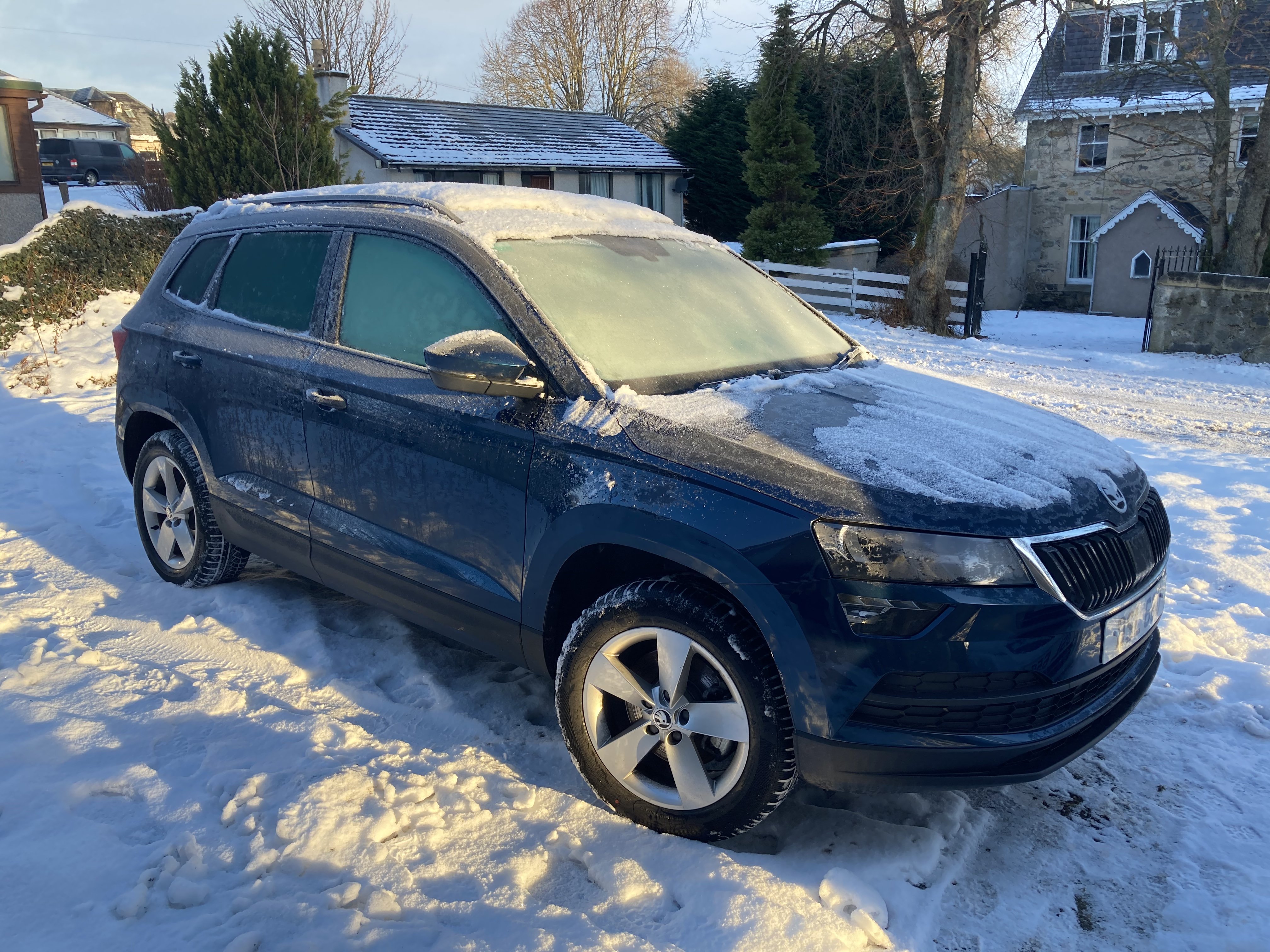

PS Pic of car on driveway yesterday when it was -6c.  Then it was positively grippy cf when the compacted snow turned to ice, then it melted slightly then froze solid.  Snow is never really an issue for me, it’s the ice that makes things interesting.   B)
