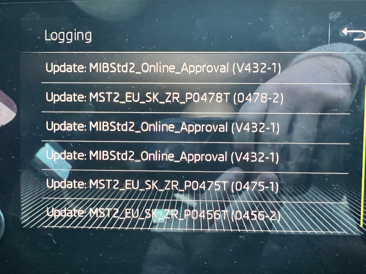

The latest SW Train is 0480, but that probably won't clear those codes out.
Can you check the SW Train history, so we know where it start at originally 02xx 03xx 04xx version.
Where would I find this?
In engineering menu, you can find an update history, unless it was cleared.
Firmware 0480 is by PM, but it would be nice to know the previous firmware stored.

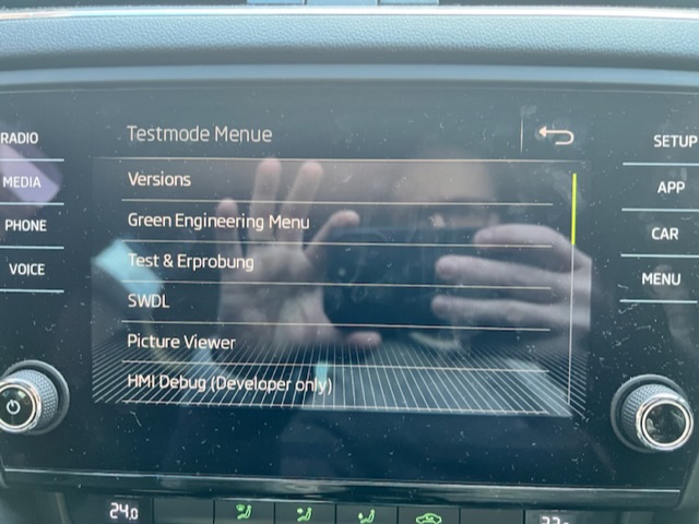

Is this it?
Just now, somedudebob said:
Yes, it shows a history, and also the use of a MIB Toolkit to hack unit (no complaints there)

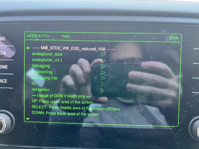

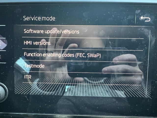

Is your Developer menu still available where you can see your MIB Tools?
I guess that’s this?

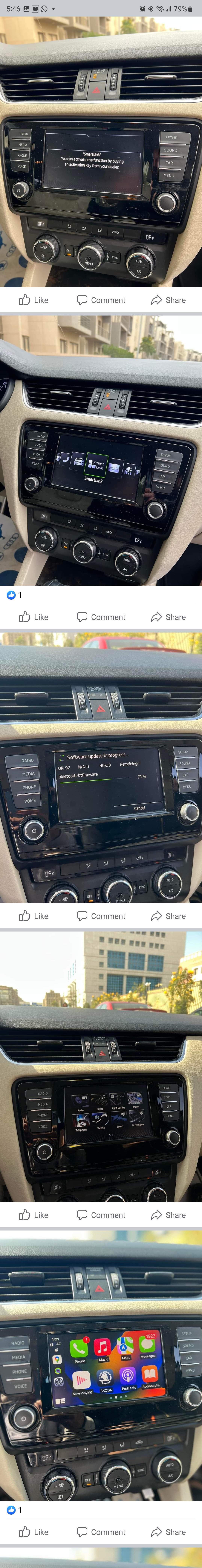

Hi @varooom,
Could you please let me know if there is an update for my infotainment system? Also is it possible to update it with another software that has Smartlink enabled as I've seen a post online with a similar unit that got updated (attached a screenshot)
Thank you.20230209_171559.thumb.jpg.738665af0a8978a97e639e53d7288029.jpg20230209_171607.thumb.jpg.5b36e90d06b572d5d4c07dbeabe1ddda.jpg20230209_171617.thumb.jpg.be8dc1f07680b4b077af34e55c10d01f.jpg20230209_171607.thumb.jpg.5b36e90d06b572d5d4c07dbeabe1ddda.jpg20230209_171617.thumb.jpg.be8dc1f07680b4b077af34e55c10d01f.jpgScreenshot_20230209_174656_Facebook.thumb.jpg.29c2fc3c9b2537d9fe81b4b9e4f91799.jpg
@ASamir86You have already asked the question to Pab567, so patience is key as he will be working.  The firmware you have now has the ability already inside for Smart link etc, but it has to be enabled.
Scroll up a few posts and see the process, you must have developer mode enabled, or you cannot use the free activation method.
Firmware update to version 0253 is available, but you will have to await Pab567 as you asked him first.

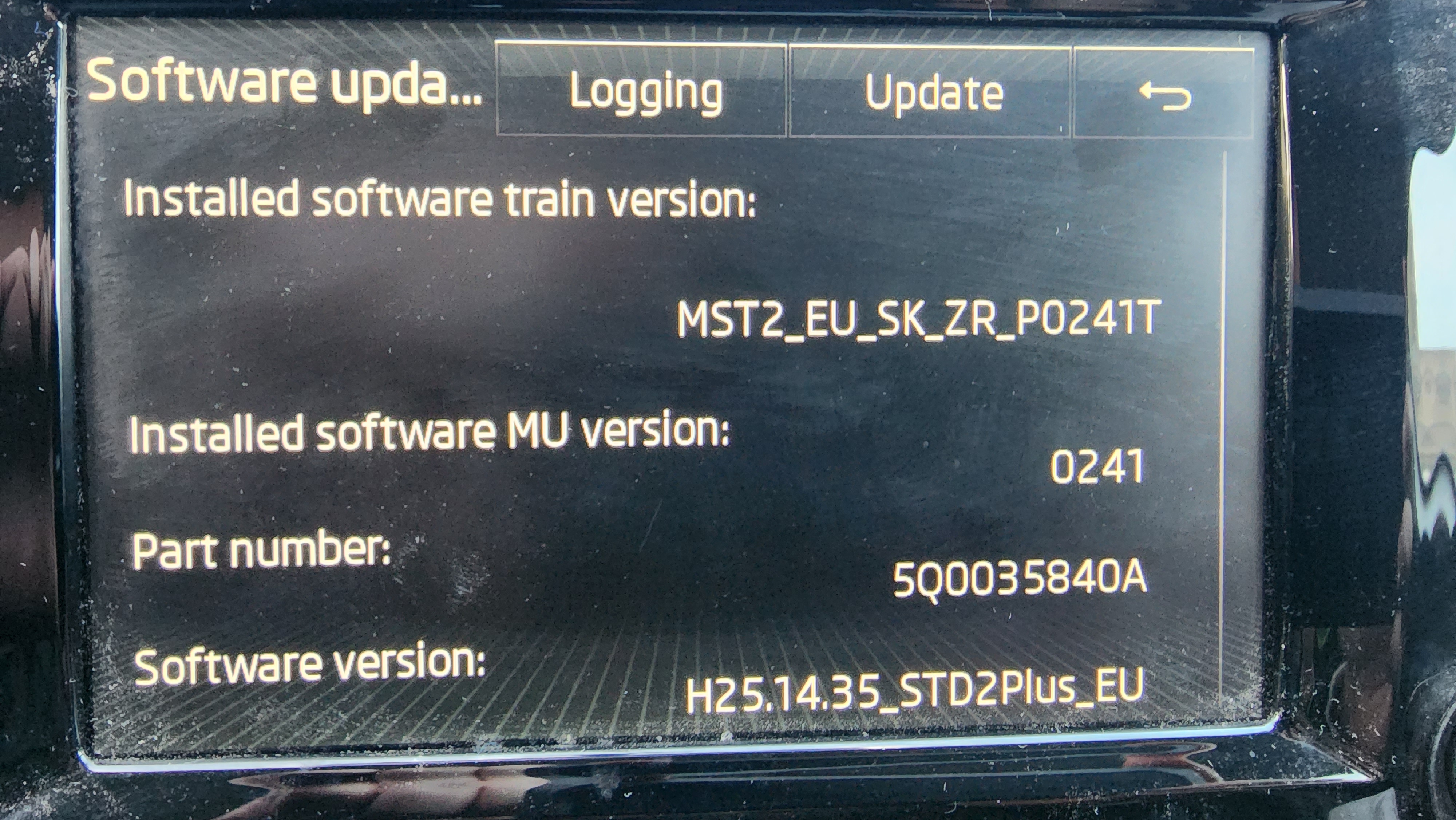

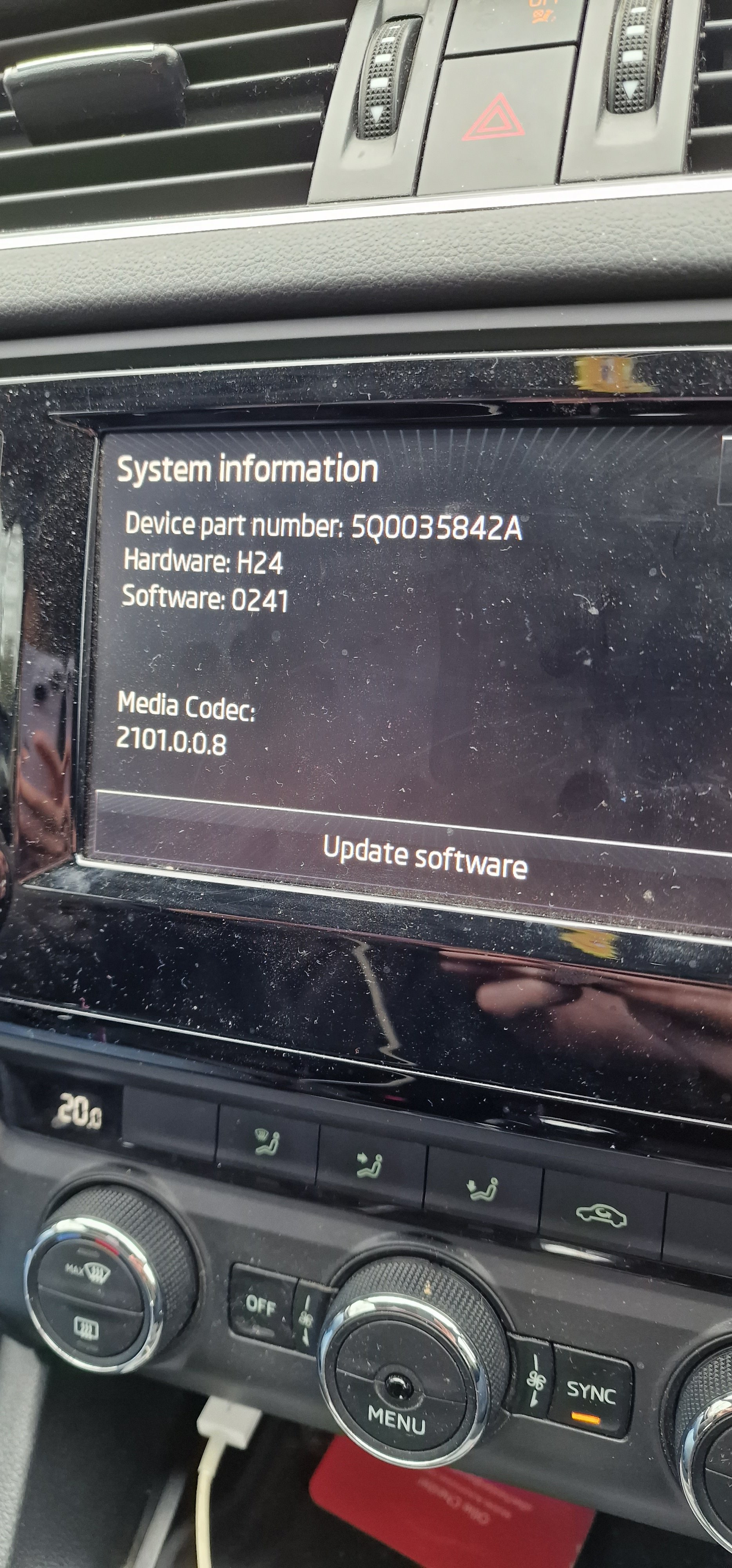

Could it be possible to get firmware fupdate for this one:
You can get updated to 0253 version.
This can be sent via PM.
Thanks! Update was successful.

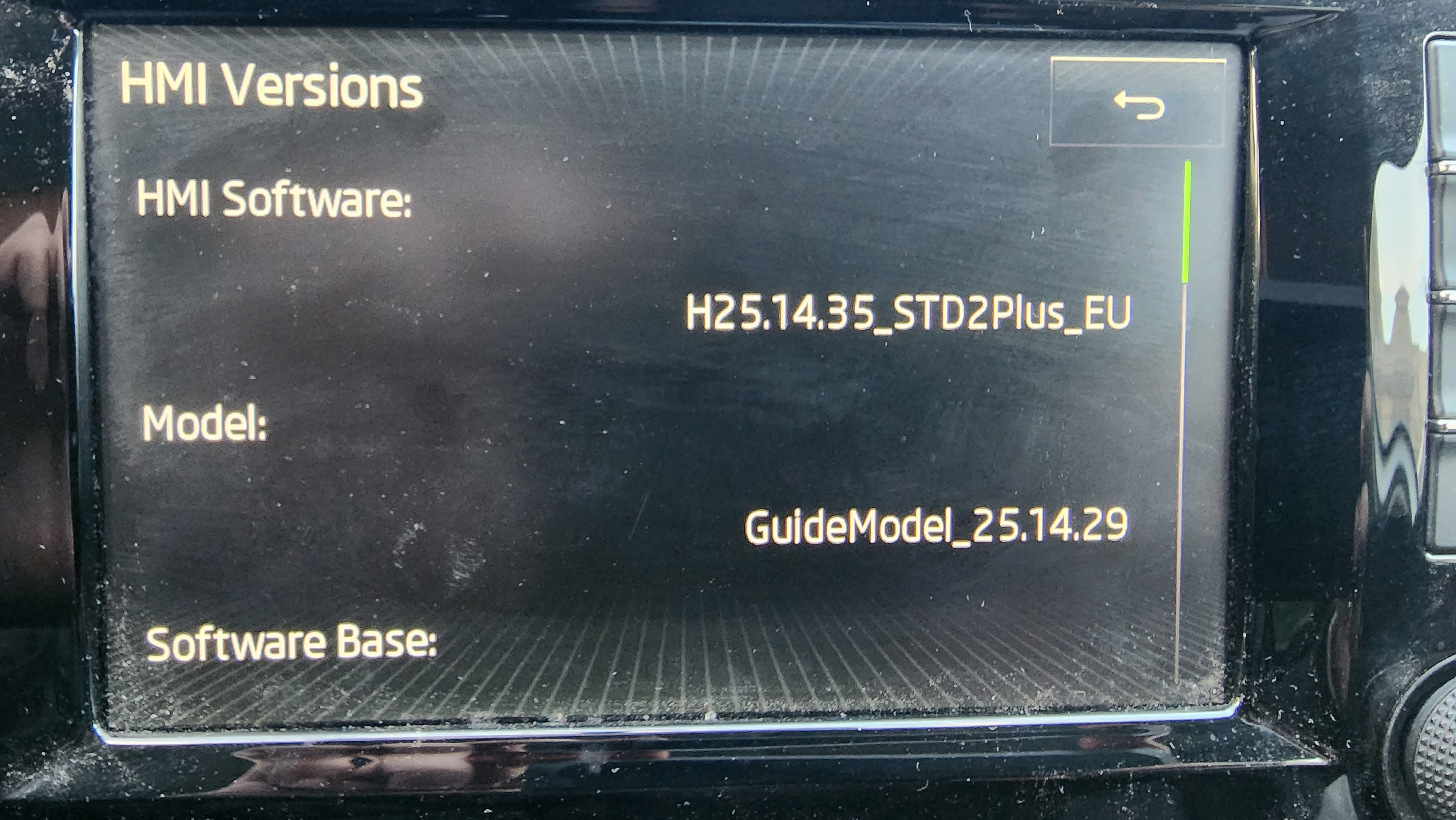

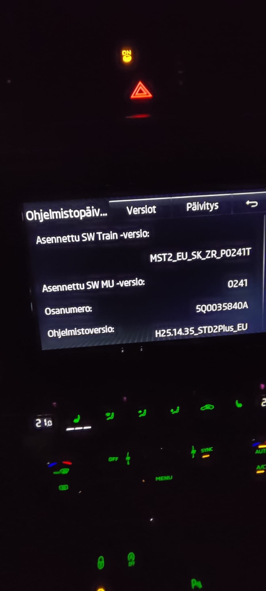

Anyone know if I already have smartlink enabled via dealer but am having problems with my Android Auto connection whether updating the software will help fix? Samsung s22 ultra, AA works for about 15 min then gets stuck in a disconnect loop no matter which cables I am using. Also I presume that wont have to re-enable smartlink after upgrading the software?
Thanks in advance!
Thanks in advance!

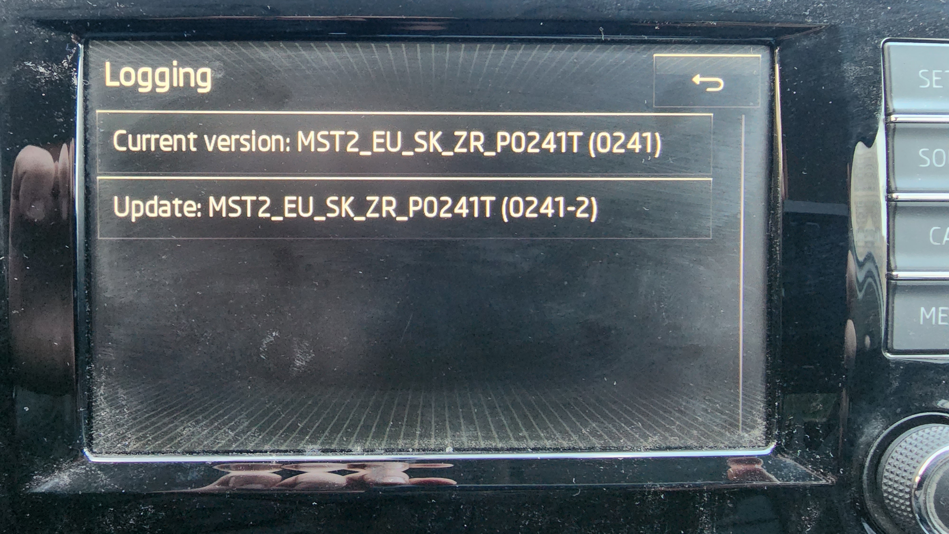

Should add that current version MST2_EU_SK_ZR_P0241T (0241)
Update: MST_EU_SK_ZR_P0241T (0241-2)
Thanks in advance!
If it was enabled by dealer, it should be retained post update.
The latest version is 0253, I will PM you a link.
Updated no problem from SD thanks @varooom(USB didn't work interestingly. Still have the same problems however so wonder if it is a USB issue rather than infotainment system?
USB port/cable or some nuts phone issue.
