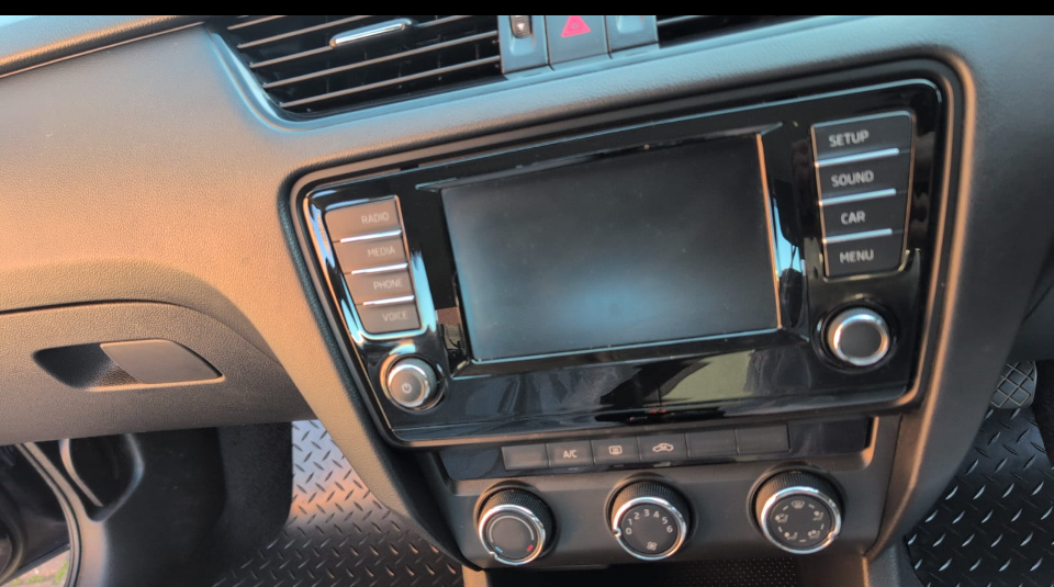

I have a 14 Octavia Elegance (not estate) with the MIB1, 6in screen with buttons.
Wanting to upgrade to a MIB2 glovebox unit along with an 8in screen (either original or facelift)
Aware I would need to upgrade the USB as well. I also don't have a canton system.
I'm not fussed about CDs/ Video playback. But wireless android car play, google maps on the screen, and not losing any functionality is what I am looking for.
For someone who is not very tech savvy, all the different variation of model numbers can be a bit overwhelming.
Was wondering if somebody could kindly post the correct model numbers that would be suitable for my car, so I can scour the net and ebay looking for second hand parts.

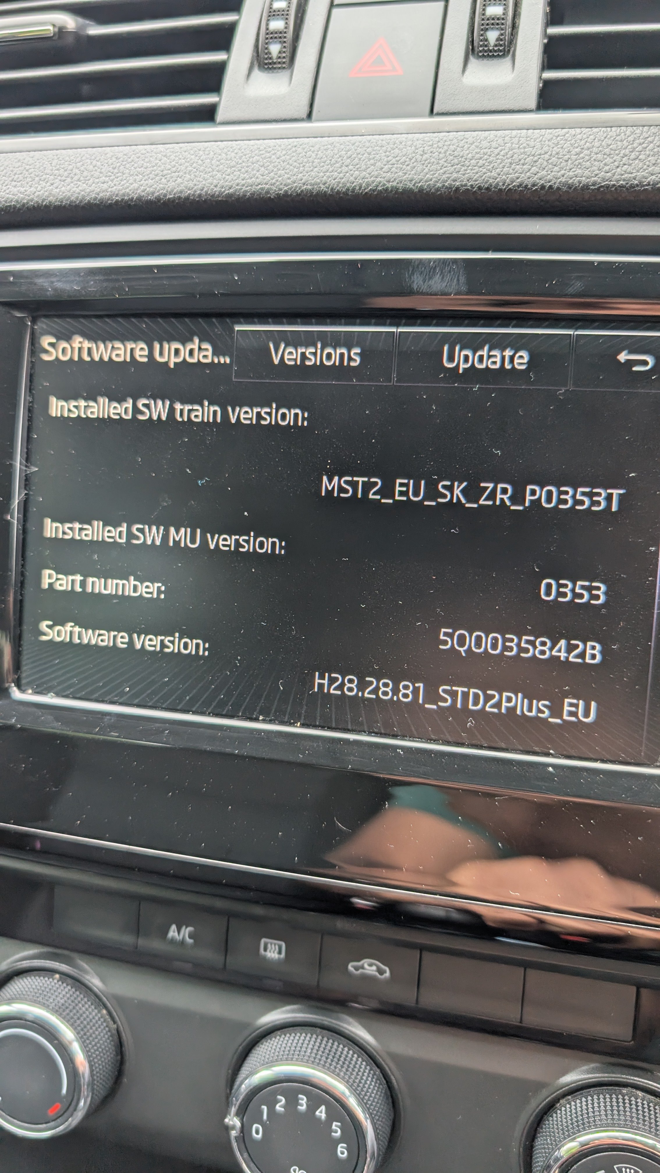

Posting here for the first time. I have a Skoda Octavia 2016, 1.0 TSI, base model. I am from UK and I was wondering if there any update file available for the infotainment system in my car.
I am looking to activate apple car play and android auto through smartlink option.
The sw version and part number are give below.;
MST2_EU_SK_ZR_P0353T
5Q0035842B
I am also confused regarding what type of system is this. Is it a bolero or Columbus?
Thanks in advance.
5Q0035842B
You have Bolero MIB2, with DAB/DAB+, MY17. I sent you link to SW upgrade in PM. Unfortunately, activation of SmartLink in this unit can't be done from SD, it requires unit to be opened and soldered. If you are interested pls contact me in PM.

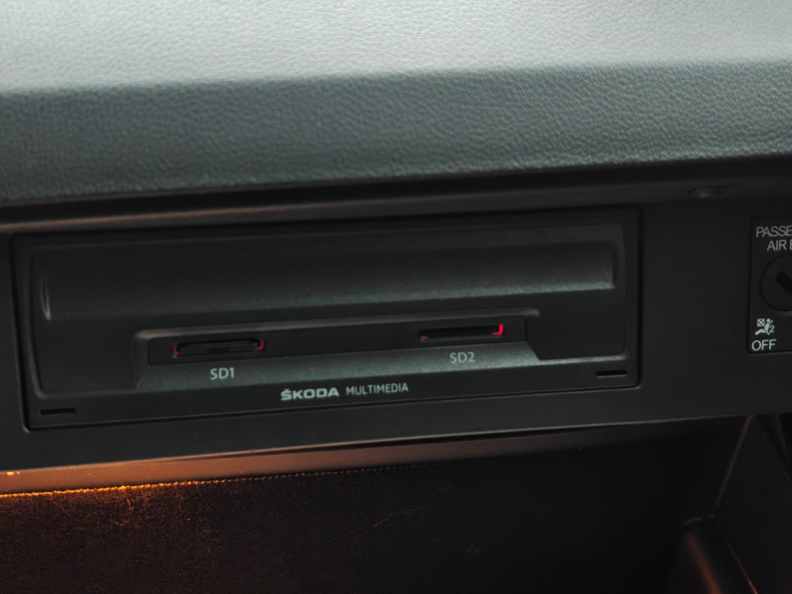

Can I use display 5E0919605M with my glove box unit MIB1 Amundsen (2 SD)? I found one cheap on eBay.
Now I have 5E0035874A.

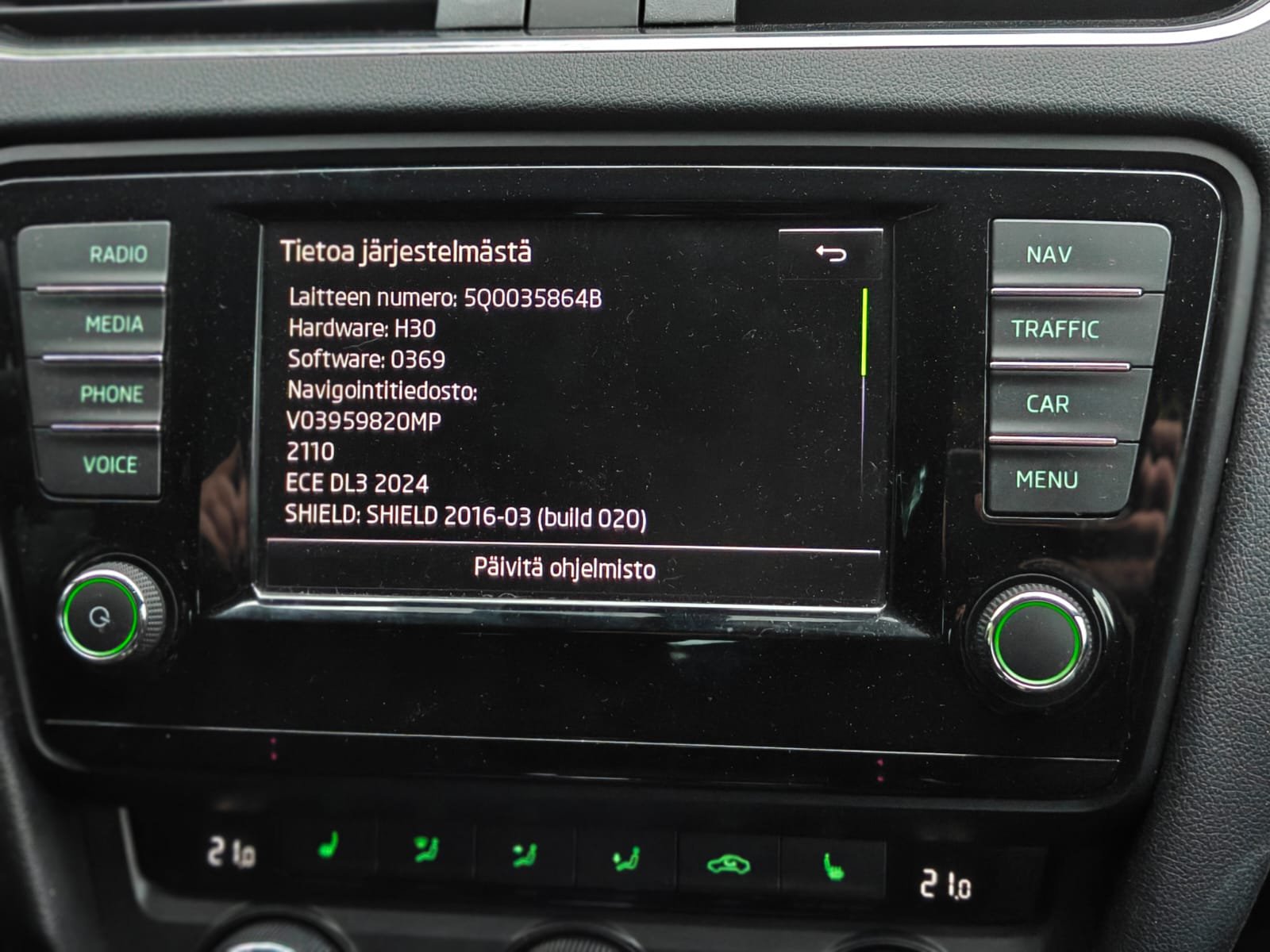

Hello, ive recently upgraded to a facelift version of the 17 Octavia Scout and was wondering if there is any update for my software available.
Installed SW train version: MS2_EU_SK_ZR_P0363T
Installed SW MU version: 0363
Part Number: 5Q0035874B
Software Version: H28.28.185_STD2NAV_EU

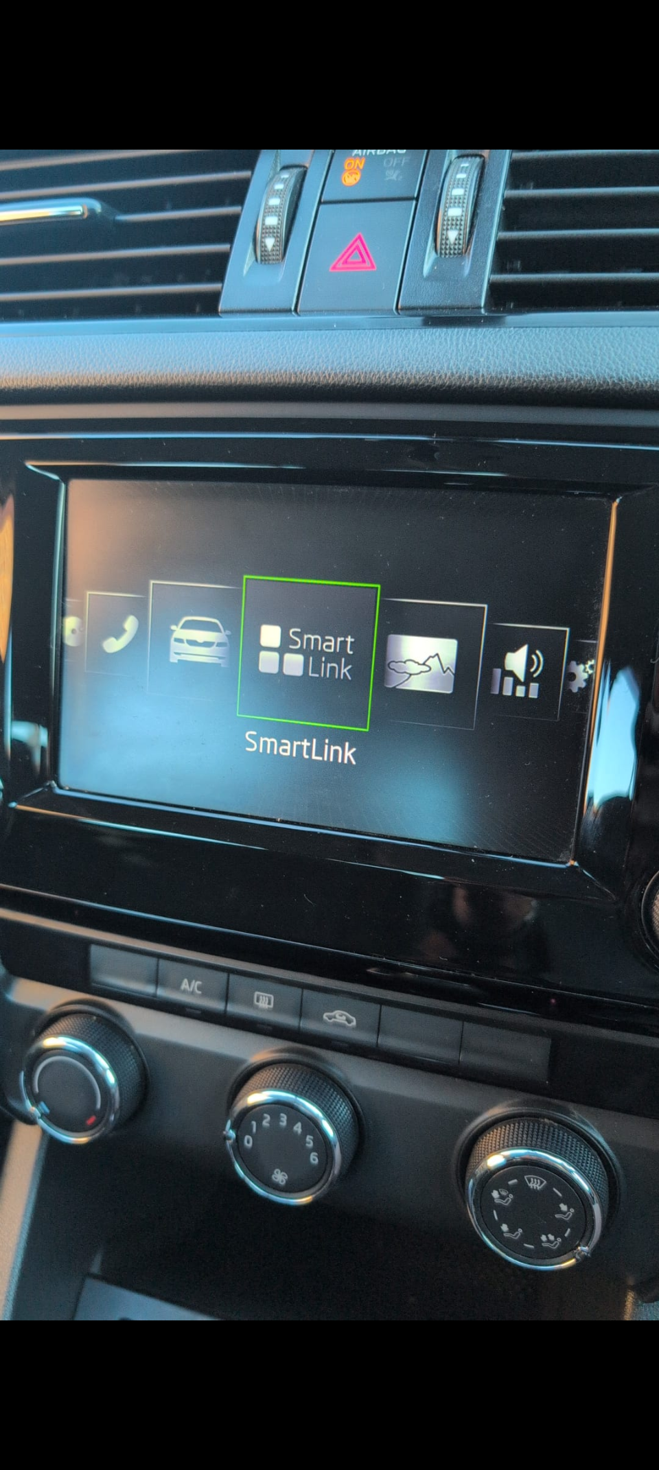

Hi, I have the Swing radio. Would like to get the blue tooth upgrade and maybe smartlink. @pab567
My vin TMBJB9NE0Exxxxxxx Skoda octavia mk3. I read that I need to buy an info box and a new radio face (Amundsen). But which? =(

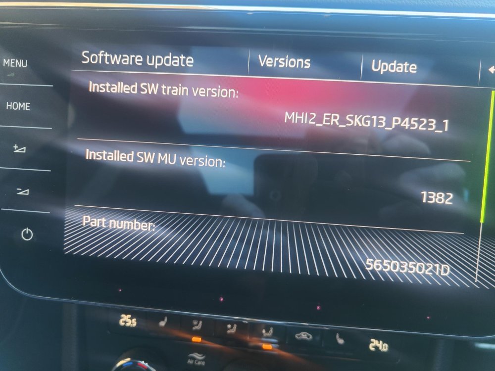

Hi All
currently having some Smartlink connection issues with my Columbus head unit and wondered if simply enough a software update might help, I've had the superb 5 years and never updated the software, could someone supply a link & advise on how to do this please.IMG20260222074955.jpgIMG20260222090300.jpg
You can't, to use 5E0919605M you must have your glove box unit replaced as well.

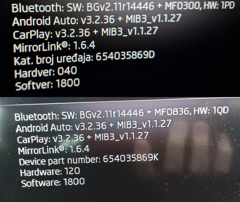

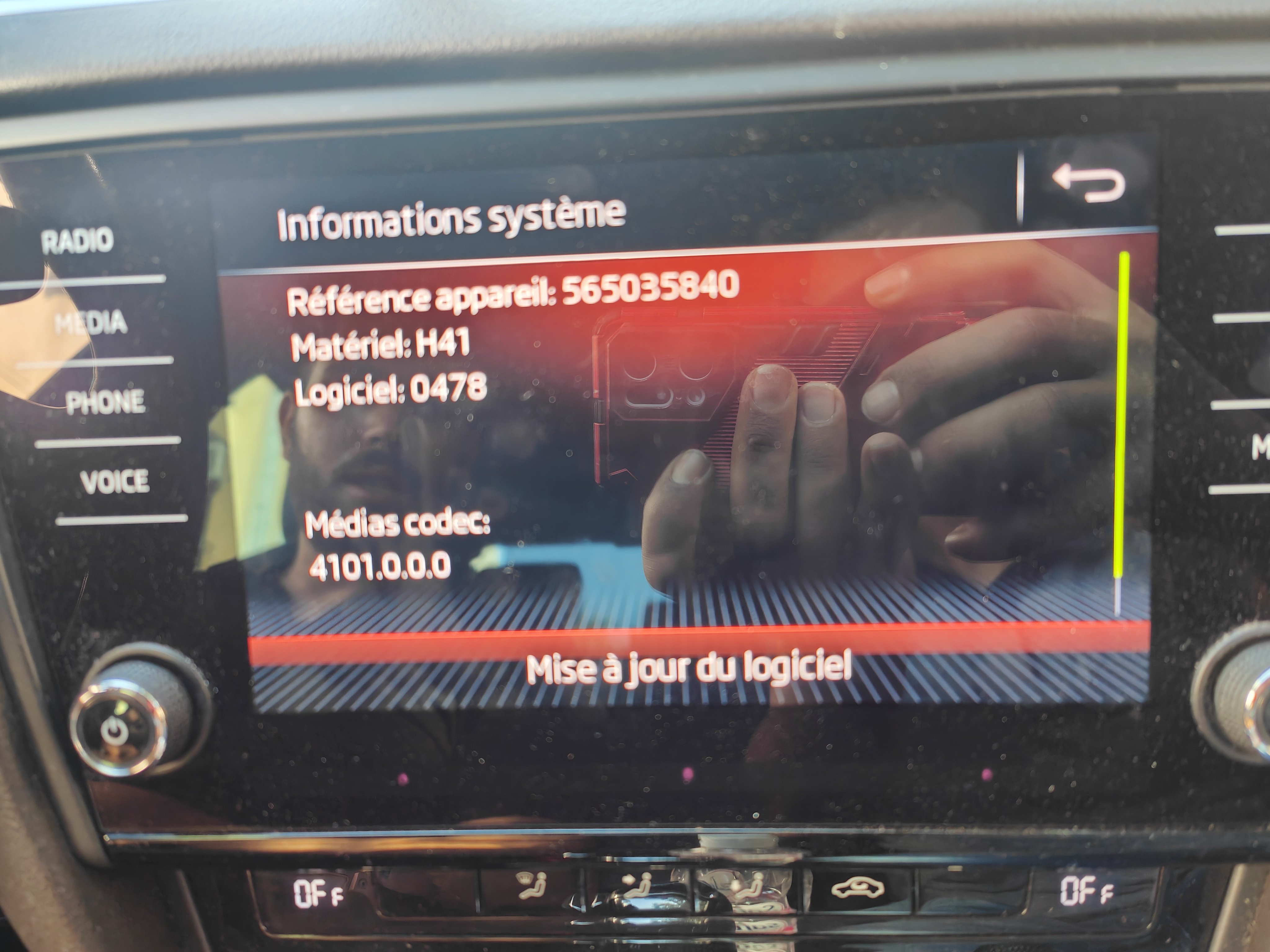

Hi all, can someone tell me what is difference between this 2 versions?
I have upper version radio, and the camera doesnt work (black white image, and no trajectory(retrofit from aliexpress - sinosmart)
but the bottom one works. ( from the post from Scala retrofit reverse camera)
If anyone knows, thanks!
