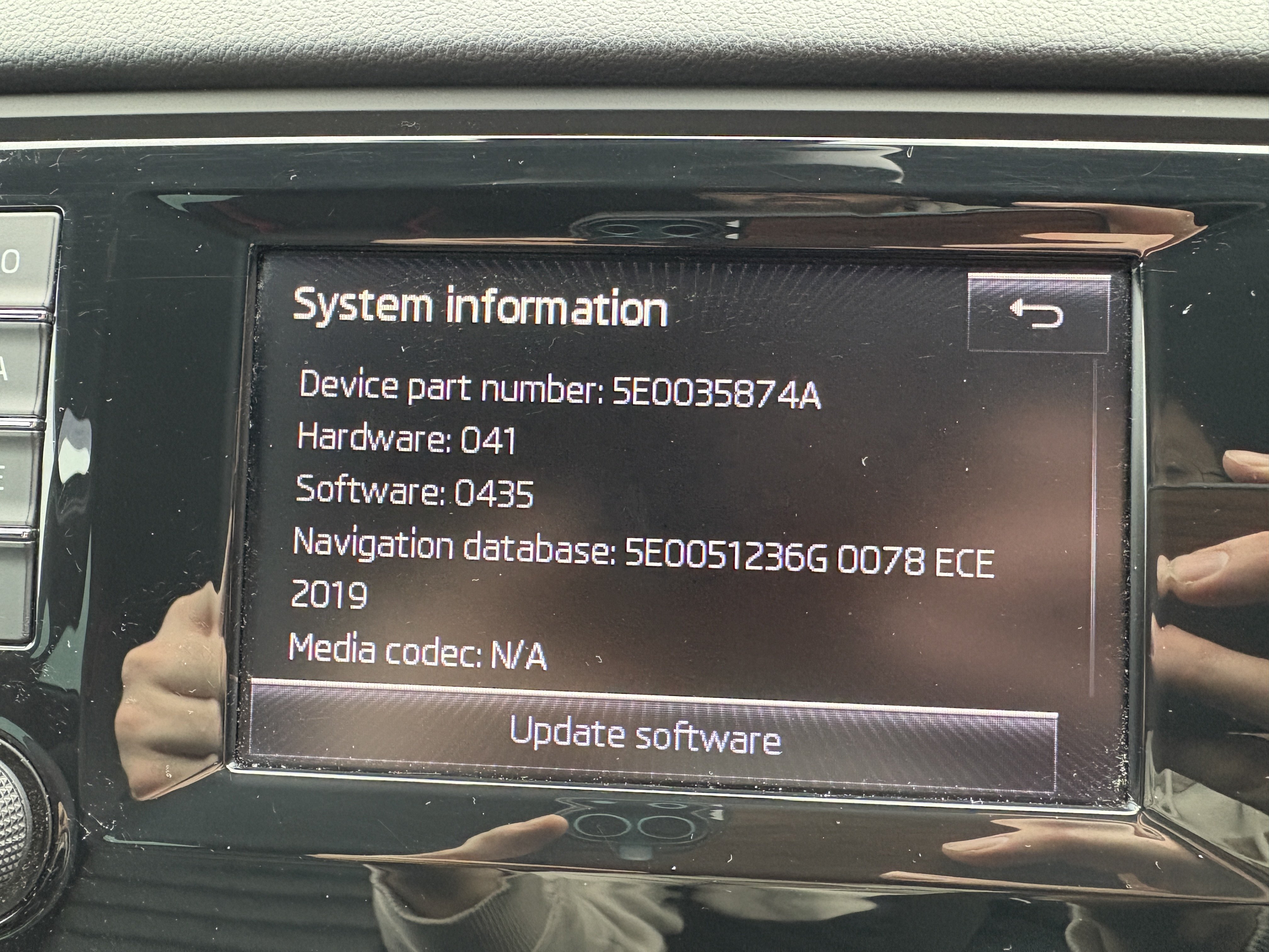

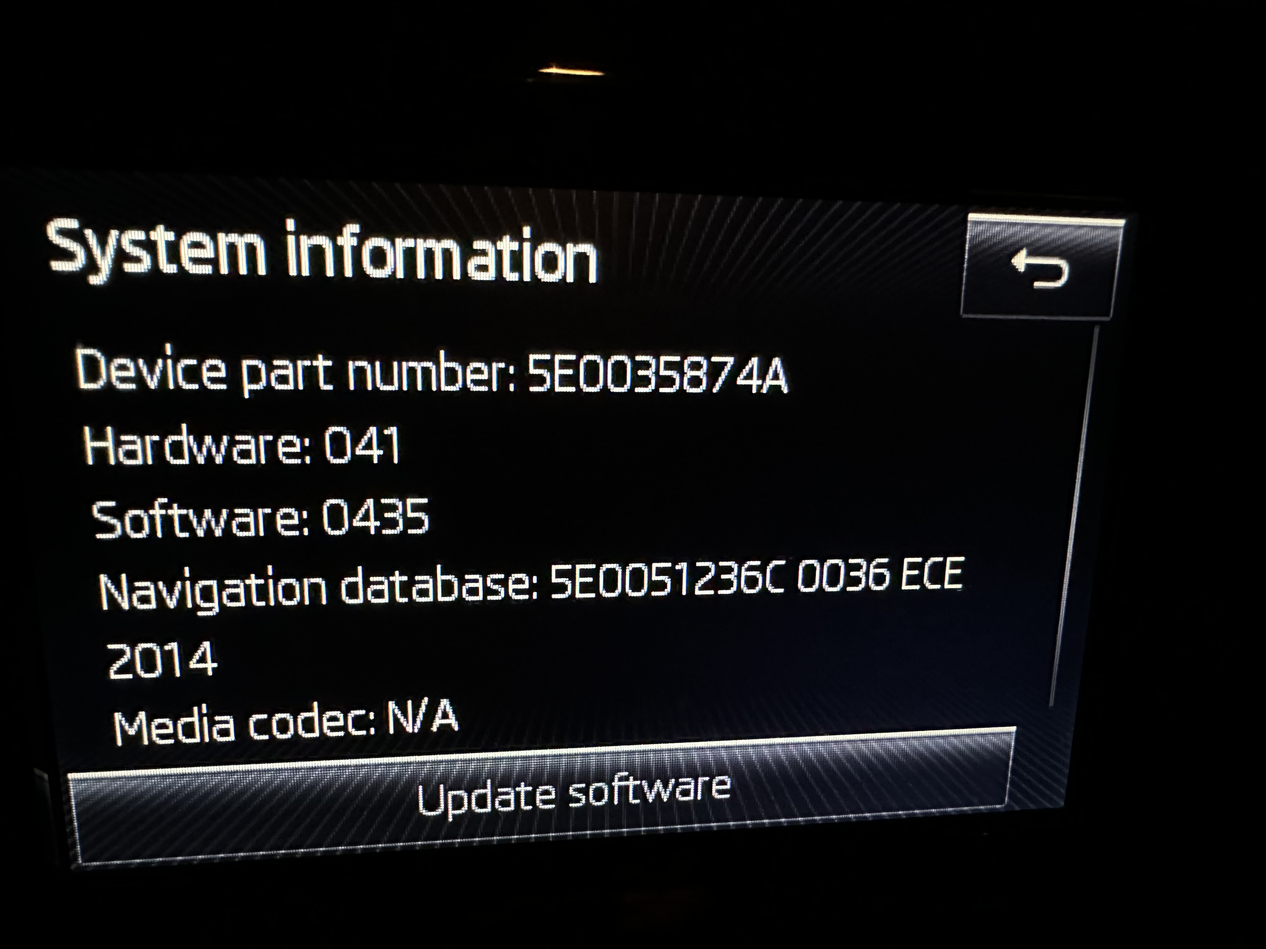

I didn’t want to start a new thread for my question as I’m sure it’s been asked before many times, I just cannot find the correct combination of info to help me out.
I’m hoping @pab567 can help me out by hooking me up for a quote on upgrade options for my vehicle. I have VIN number on hand ready to go. Here are screen shots of my current setup:
VIN?
21 minutes ago, pab567 said:
VIN?
TMBKK7NE1F0045683
So now you have AMundsen MIB1, with Bluetooth, with DAB, part number 5E0035874A, with USB 5Q0035726B and fortunately you don't have CANTON sound system.

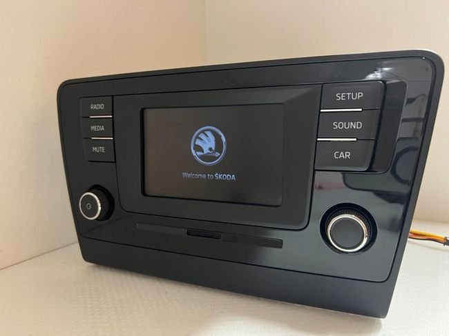

Hi!
Looking into buying MK3 2017 Octavia. It seems to have newer Swing but I am trying to make sense if its Android Auto compatible. Seller does not know.
In car manual Smartlink and Android Auto is mentioned. Added a picture how it looks, but has instead of the APP button its written SOUND. That is making me doubt, could be some earlier version which does not support Android Auto? Car VIN: TMBJ P7NE7 J00 59996
Thank You in advance and nice to see so big community just for Skoda!
