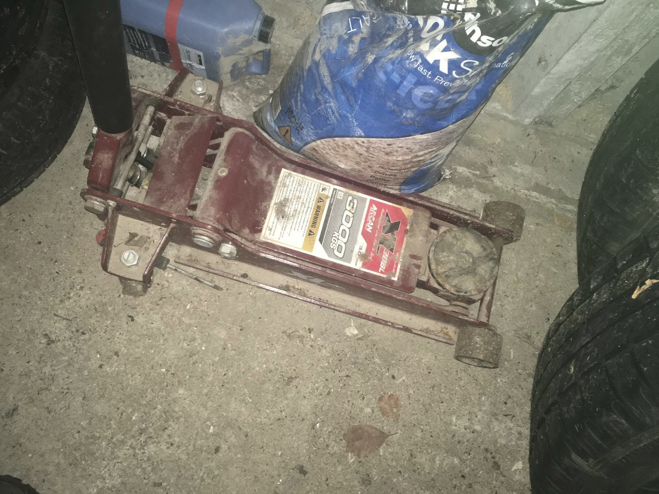

Have a look at Arcan 3t trolley jacks, usually available from Costco.  I haven’t used mine on my Karoq but it’s got easily enough reach for Disco 3s with air suspension and goes low enough for low slung cars.  I’ve had mine for over 10 years and it has been superb. :thumbup:
You'll also find that the Karoq won't get as many punctures as your Bugatti either. ;)
PS Here’s a pic of mine I’d forgotten even existed!  Amazing what a Google search will bring up.  :D
